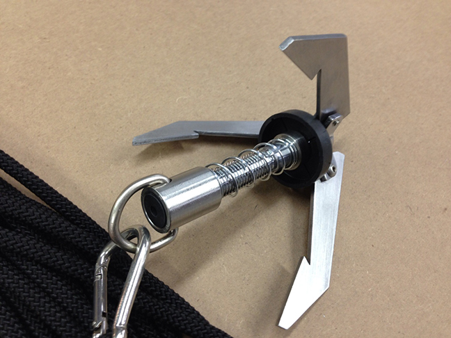

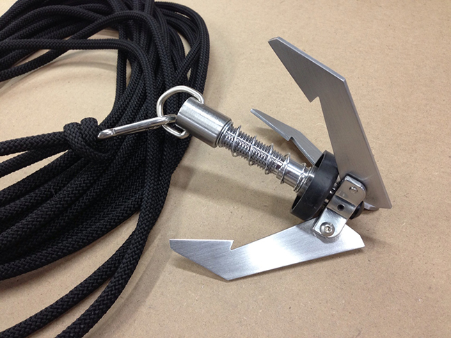

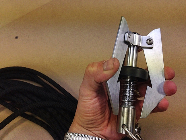

I built this one out of found items and 1/8" steel for the blades. It's spring-loaded with retracting blades. Its heft is really satisfying. I have no plans to try to ascend a damn thing with it. But it looks wicked hanging on my shop wall.

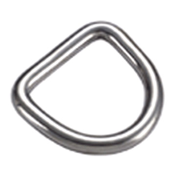

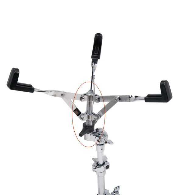

No build pics (it was a quick build) but I can clue you in on some parts. Honestly, the ah-ha moment was looking at a cheap ($40) snare drum stand at a music store. I wanted something existing to serve as the "hub" for the three blades. The top piece of the snare stand was perfect. I simply hacked the top off the stand. This is the body for the grapple. The blades were hand cut from 1/8 sheet steel. Easier than it sounds. The bottom piece is a coupling piece for electrical conduit from the hardware store. Then a D-ring, a spring. It all came together quite quickly. I'm still looking to add a mechanism to latch it in the closed position and have it snap open with a button.
