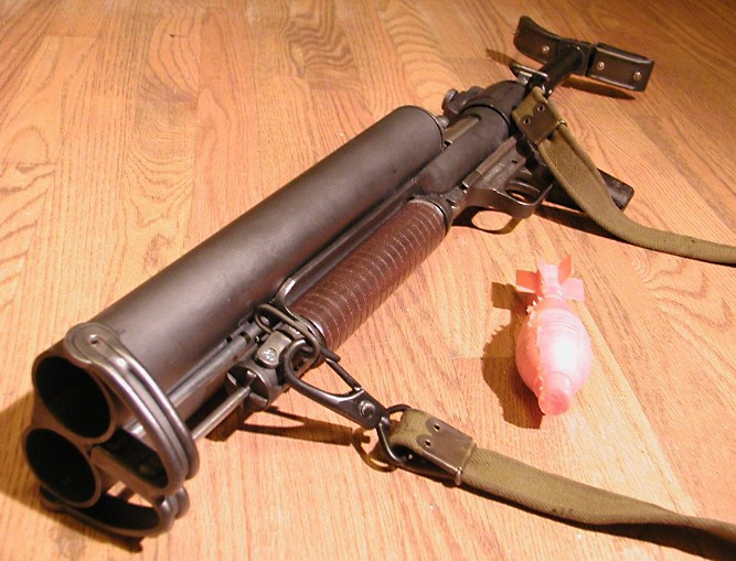

This is graphite on flat black paint (plus a little light dry-brushing on the edges) over steel, 3d print, Apoxie, and styrene:

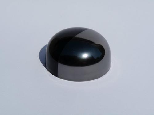

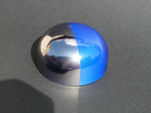

I also have seen youtube videos where it was rubbed on gloss black paint achieving a near chrome finish. However, another video had a spray coating which dulled the reflectivity a bit.
