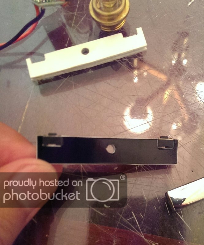

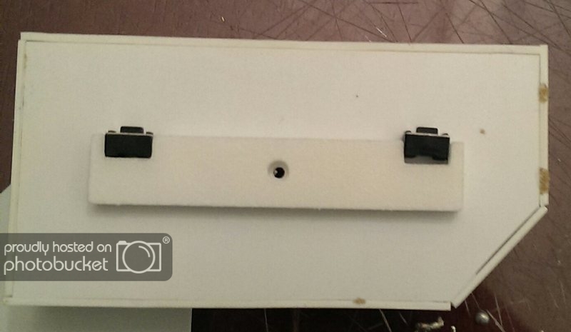

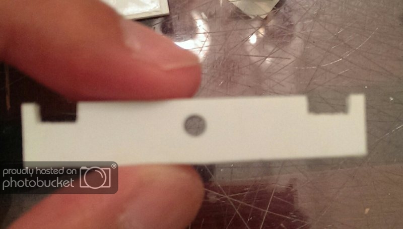

Here is the layout for the Switch holder.

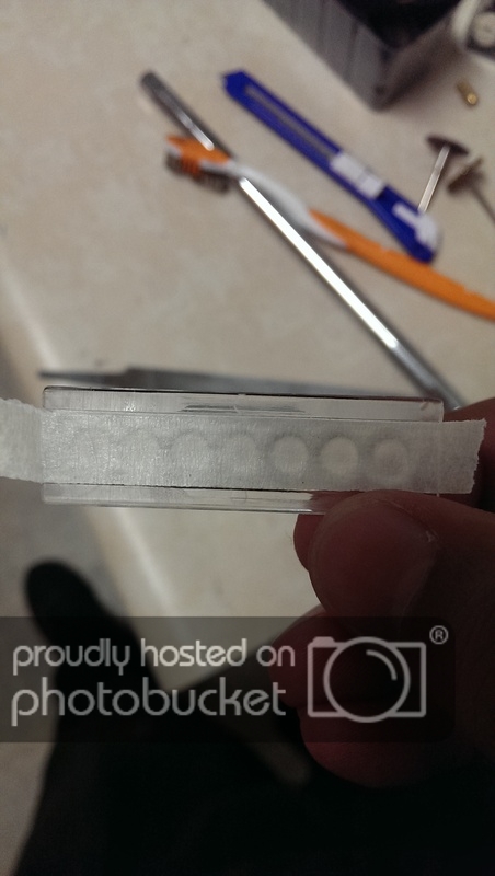

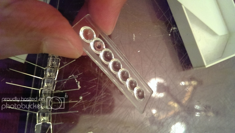

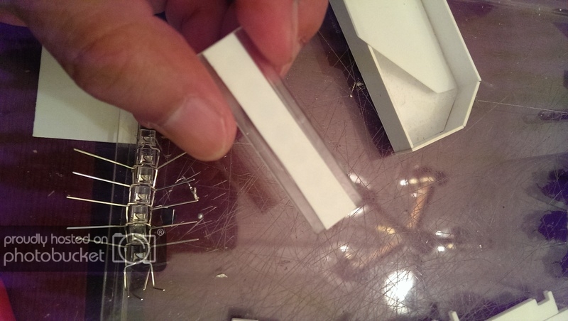

Update, There are 2 types of bubble lens, one is just flat, another has 2 side ridges.
If you have the side ridges and the lens can not be pushed down, Here is the fix..

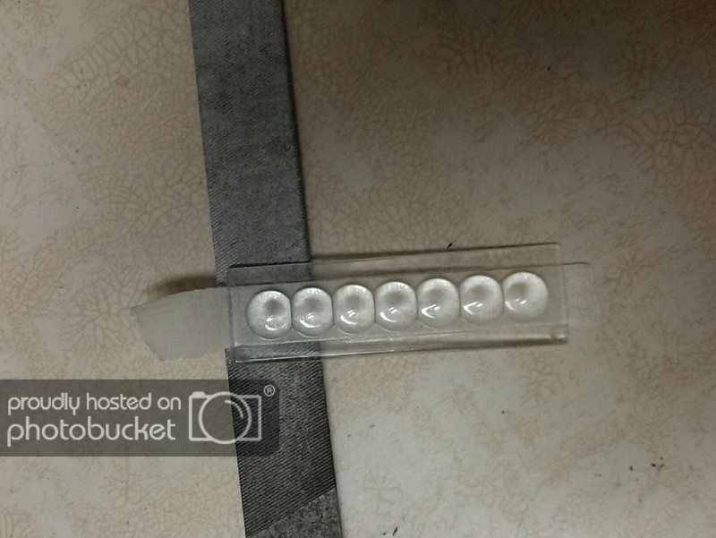

First off, put a piece of masking tape down the middle of the stirp, and slightly sand the ends.
I did from the two bubbles on each side so that there is kinda an arch in the middle.
If need be put a very thin piece of plastic down the middle of the strip.
The Switches are adjustable if needed. The pressure of the clamp will hold the switch in place. a small dab of superglue will help also in you want.

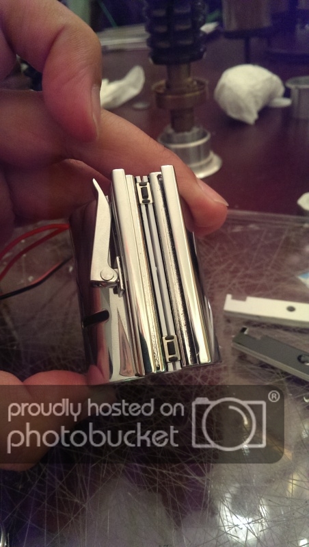

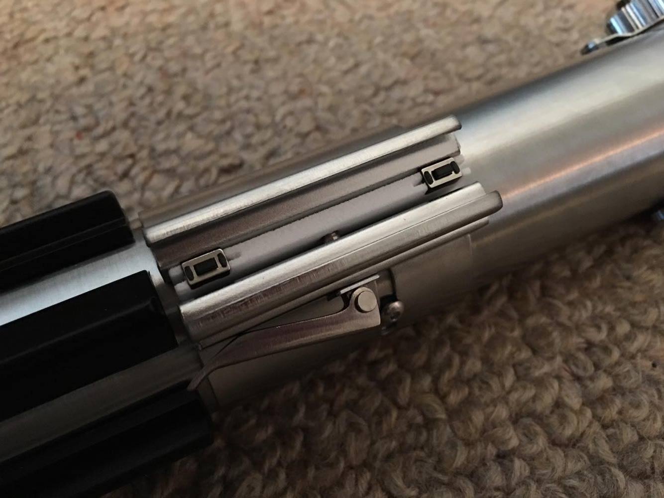

Got mine yesterday - but question; should I try to tighten the lever screw one more revolution? Graflex 2.0 clamp...
Hi,
yes it will take another rotation, if you need to circle out the square piece on the bar so that you can turn the lever more.
