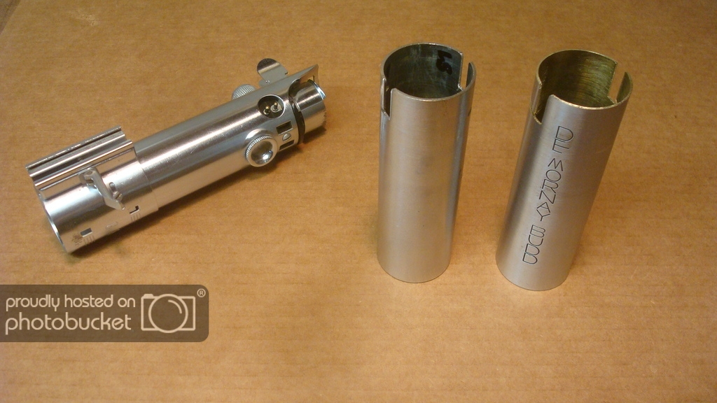

I'm currently working on two TFA Graflex conversions, but one is a 3 cell and the other is a two cell.
Not a problem, off to the spare parts box. A while back, I bought this DeMornay-Budd package deal. I moved the upper component to the 3 cell bottom, which gave me a 2 cell bottom as a leftover.
The diameter is right and the finish is close enough for me, so off to cutting I went.
Not much to it. I made a paper/pencil rubbing of the Graflex slots and recreated them on the DB 2 cell bottom.
What about the logo, you ask? Not a problem. The grip at the 9 'oclock position will cover it once it's installed.

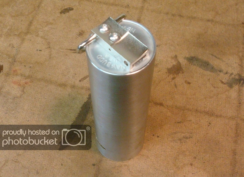

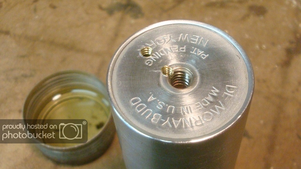

Drilling/tapping the holes for the Kobold/d-ring just barely worked. I don't think rivets would have worked here.
I don't have a correct ANH style d-ring, so maybe someone here can tell us if one would work on these, judging from my pictures.
