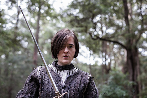

Long over-due update on Needle:
Wanted to experiment with another idea for the blade of Needle to see how sturdy it could be - resin casting. This involved:
  1. Mold made with one piece of 3mm foamed PVC board (aka sintra), scored into 3 sections for each side of the triangular profile
  2. Sealed/prepped the inside surfaces with J-Wax mold release
  3. Temporarily joined the edges together with hot glue followed by tape
  4. Mounted the tip to a stand/base
  5. Cast with Supercast rigid polyurethane resin (bought from Barnes), fibreglass fishing rod embedded inside for a reinforcing core
After pouring in the resin I thought this was going to be a complete failure, it wasn't perfect but I think I made it work.
The fishing rod was too close to the surface so I couldn't sand in much for the grooves. There were a few thin areas so I opened them up and filled in the holes with more resin. Did some repair work on the tip with Apoxie Sculpt. The blade is flexible and very light. It was an interesting experiment.
Pictured below is the raw cast followed by the finished version. Huge improvement over the previous worbla version anyway. I'm not too worried about it breaking so far as long as I'm careful with it and protect it really well when transporting it.
Also improved the finish on the cross-guard and pommel by making it smoother and replaced the grip with leather that had a great pattern in it.
I thought I was satisfied with the blade finish but now I'm thinking I might need to make it look more shiny/polished. It does have a nice shine to it when held near a light.

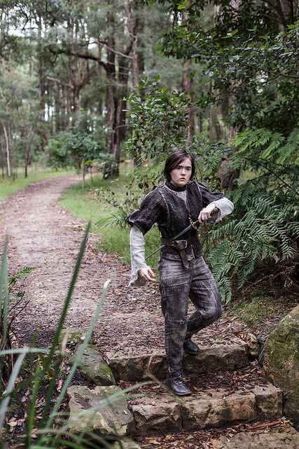

PANTS:
  • Fabric: linen; fabric weight: approx. 290g/sqm / 10.2 oz)
  • Altered pattern Butterick 5614
  • Distressing done with sandpaper
  • Airbrushed the dirty areas with a custom mix of Createx paint
Felt that the linen I used for the first pants I made was too light-weight. Re-made them with a heavier linen (bought from an Etsy seller). Still not sure if it's spot on but I'm happier with it now.
Here's a side-by-side comparison:
V2 on the left - - (fabric weight: approx. 290g/sqm / 10.2 oz)
V1 on the right - - (fabric weight: approx. 212g/sqm / 7.5 oz)
I love the coarser texture of the heavier-weight linen.
Going to take some photos of the whole outfit together with Needle soon which will conclude this build for the time being. :D

Even though this thread should have just been for the costume I might as well conclude the previous progress of Needle here with this final update.
Sanded off the previous silver spray paint, sprayed a new undercoat/base of Krylon Fusion Satin Black (wet sanded to 2000 grit) then applied silver Rub n Buff. (Also, European Gold on the pommel and cross-guard). Huge improvement! Looks much more like steel now, more reflective. It's not perfect but at least some of the flaws can pass as weathering - so over it at this point. :p
Video which shows the metallic finish better:
Project Arya is finally finished! HURRAY!!! I recently did 2 location photoshoots, so happy with this result! Here are some photos from the shoot I did by myself (DSLR mounted on a tripod, remotely controlled via a phone app):
