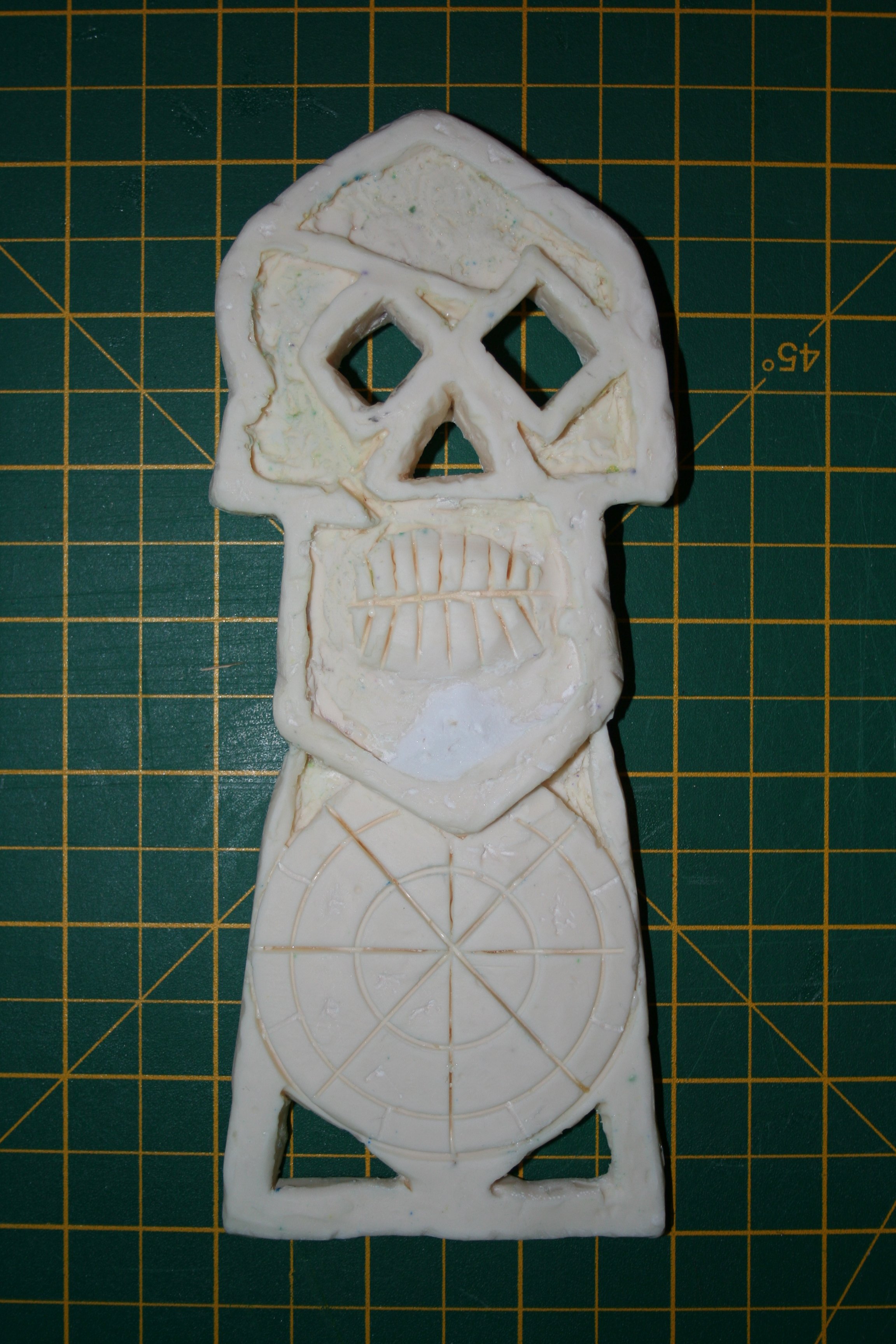

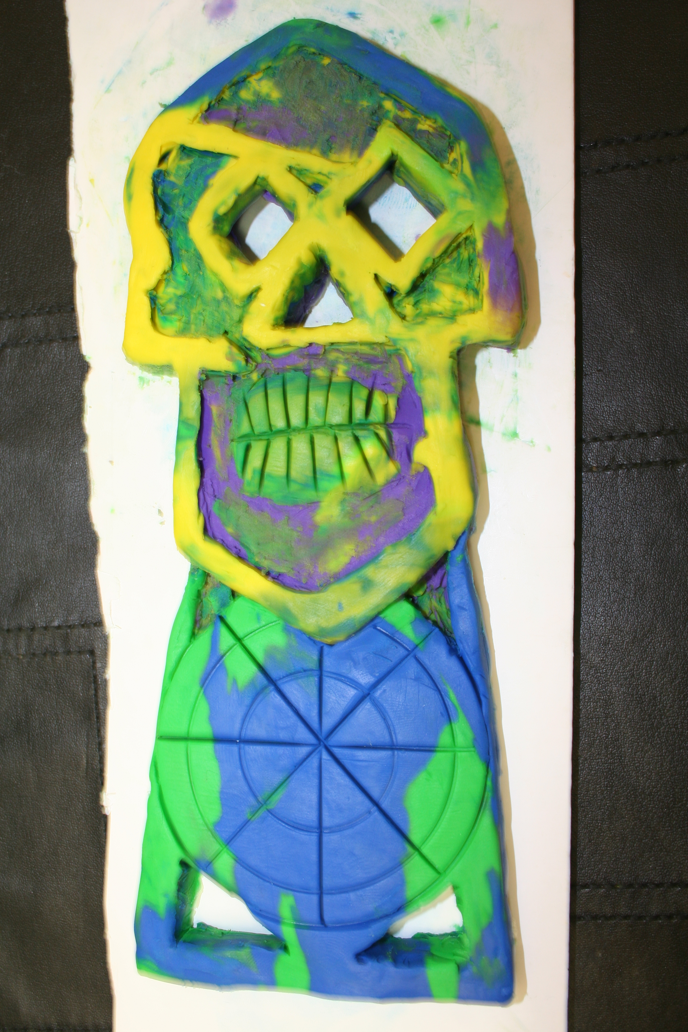

I then sculpted using plasticine and came up with this...

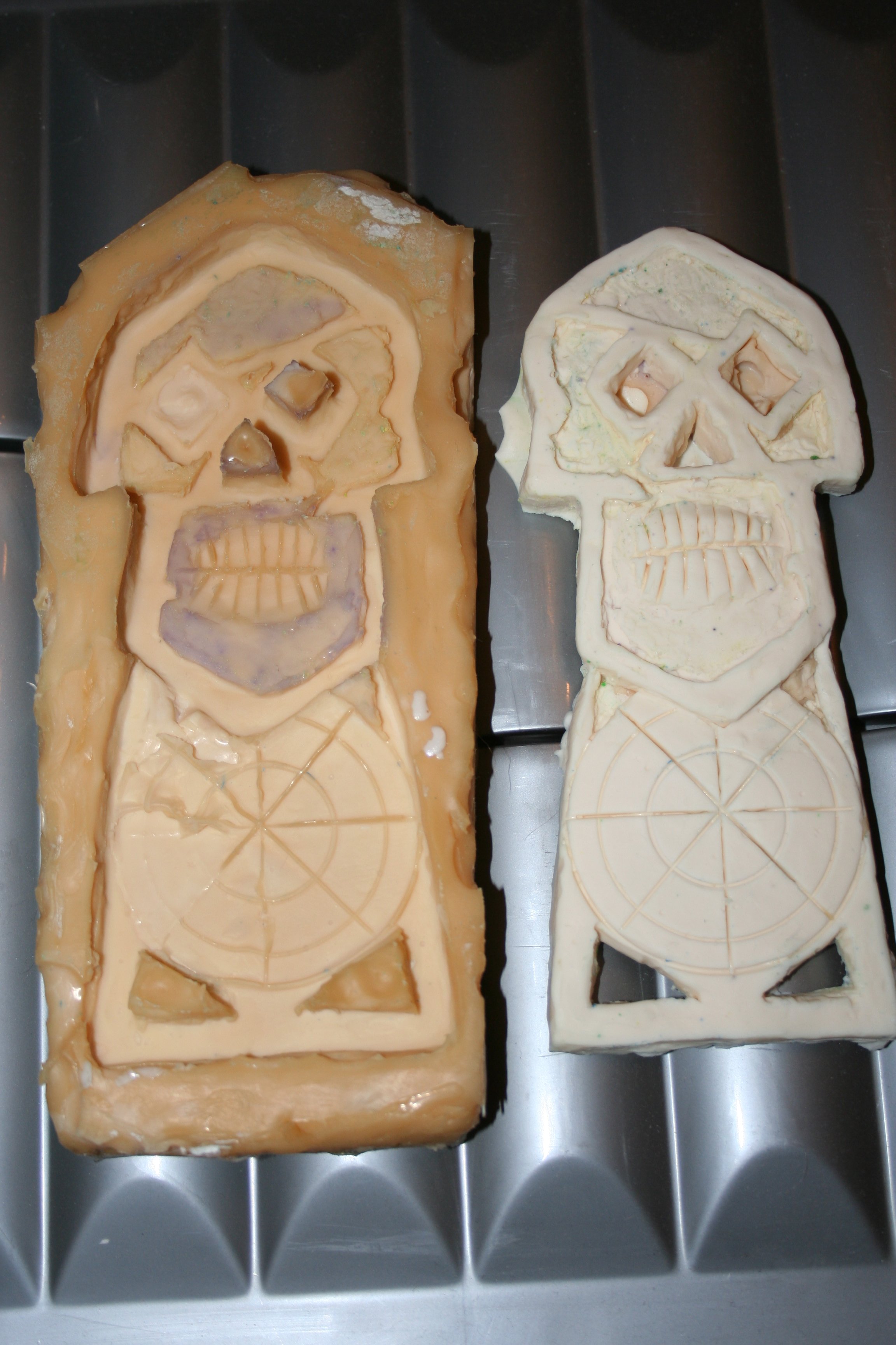

I used latex to make a mould (I know it's not the ideal material for this but I happened to have a litre bottle of latex for another project and I haven't found any cheap sources of silicone in the UK yet). I then cast a resin piece from the mould. This is my first ever mould so really pleased with the resul. A few air bubbles here and there and a little flashing but nothing serious. The mould was completely destroyed but pretty much expected that from latex.
Now tidied up the bones and used some filler to add a little to the chin which I realised I missed off in the original sculpt. Weathered the piece by cutting into it randomly with an engraving bit on my multi rotary tool (i.e. Ryobi's version of a Dremel! - I used to work for Ryobi so have lots of their tools:)).

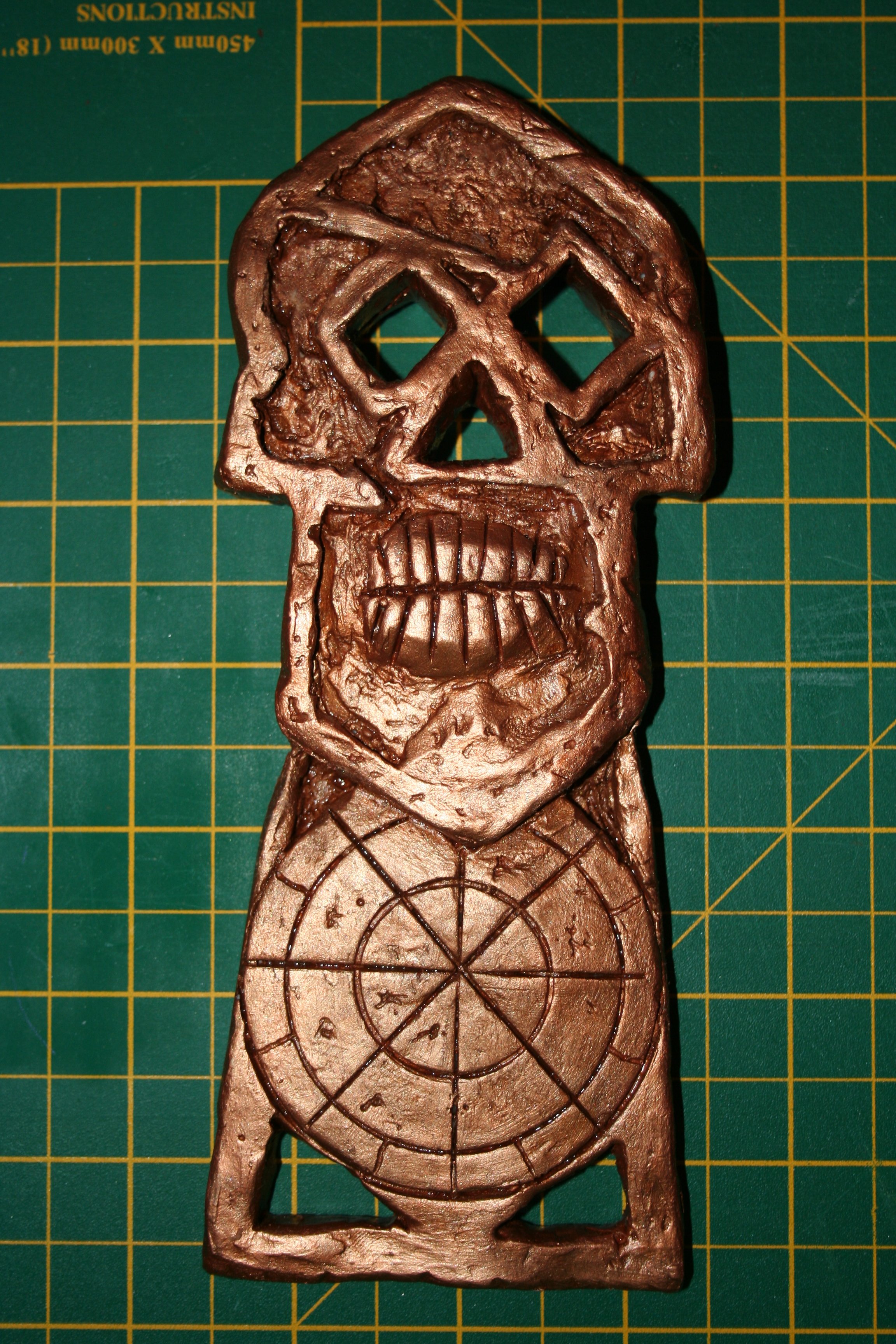

Now painted copper colour with dark wash and some light dry brushing to bring out the detail.
It now just needs a bit (or a lot) of aging with the verdigris patina. So if you have any advice on how to do that it would be very welcome.

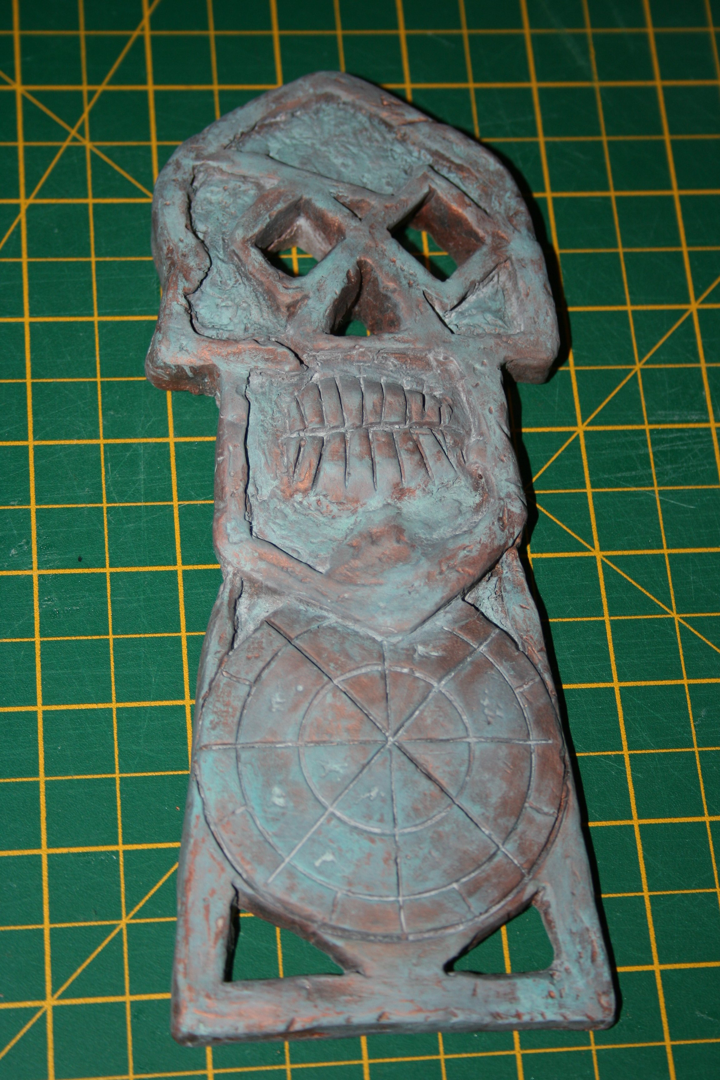

I tried using the patina Rub N Buff and the colour is amazing but it looked a bit too bright and clean...
so I hit it with some powdered pastel (gray is it was the only appropriate colour I had) to simulate all the dust and dirt it's accumulated over the years! It looks a lot better afterwards, far from perfect but for my first proper effort I'm pretty pleased and I've learned quite a bit. Thanks again for your suggestions.
