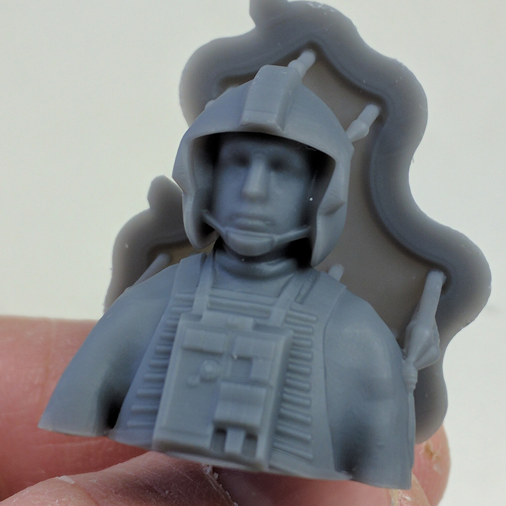

Gus over at www.Falcon3dparts.com is working on a rebel pilot figure to replace the default filming miniature for those interested. Here are some pics of his 3D printed prototype that I trimmed to fit the model. I believe the finished figure he will be selling in his store will be modified to match my trimming. I also filed a little off the lower back of the cockpit seat to make room for the new pilot. The figure does not come with a visor but that can be made with clear plastic tinted yellow and glued into place.

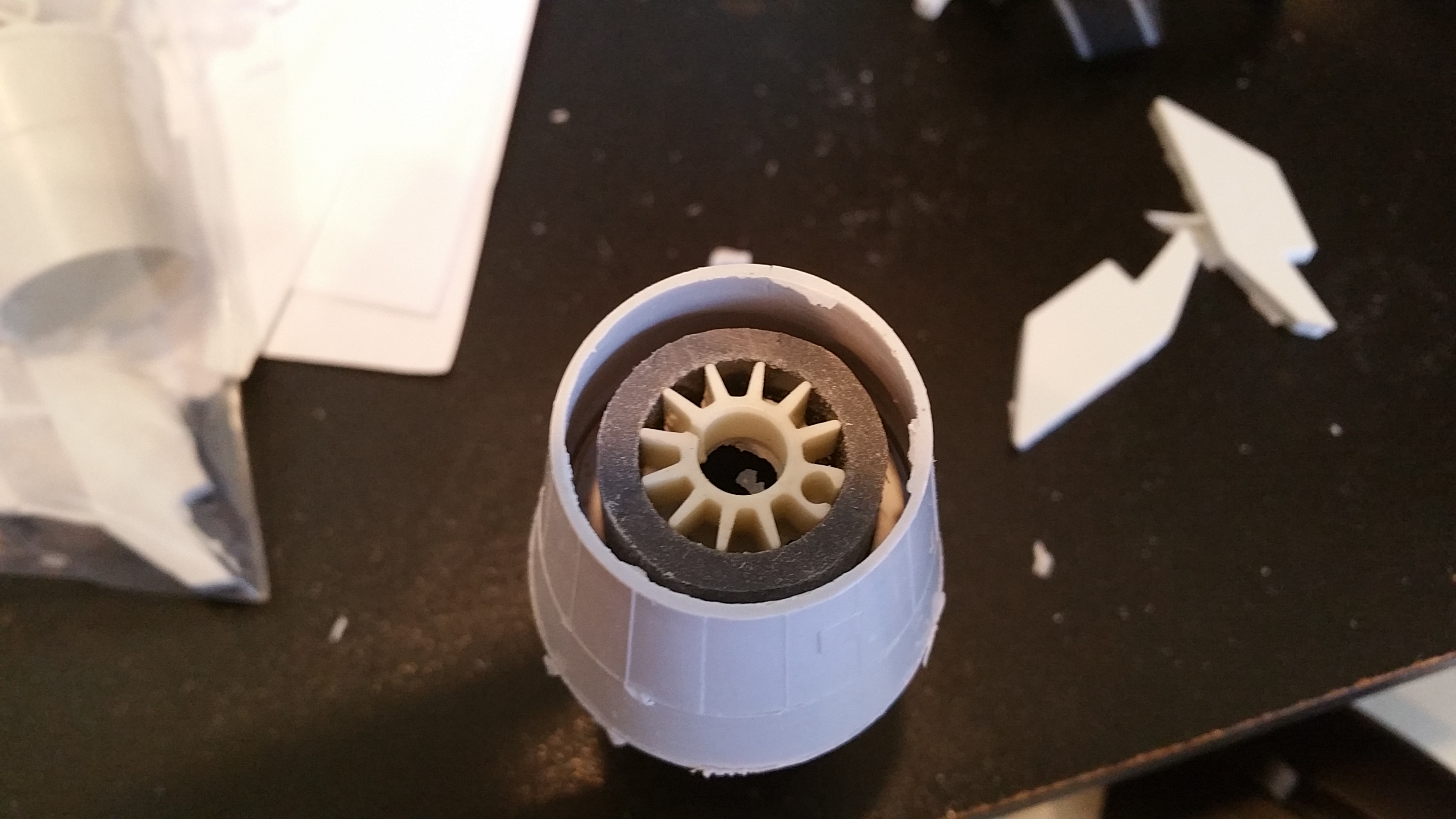

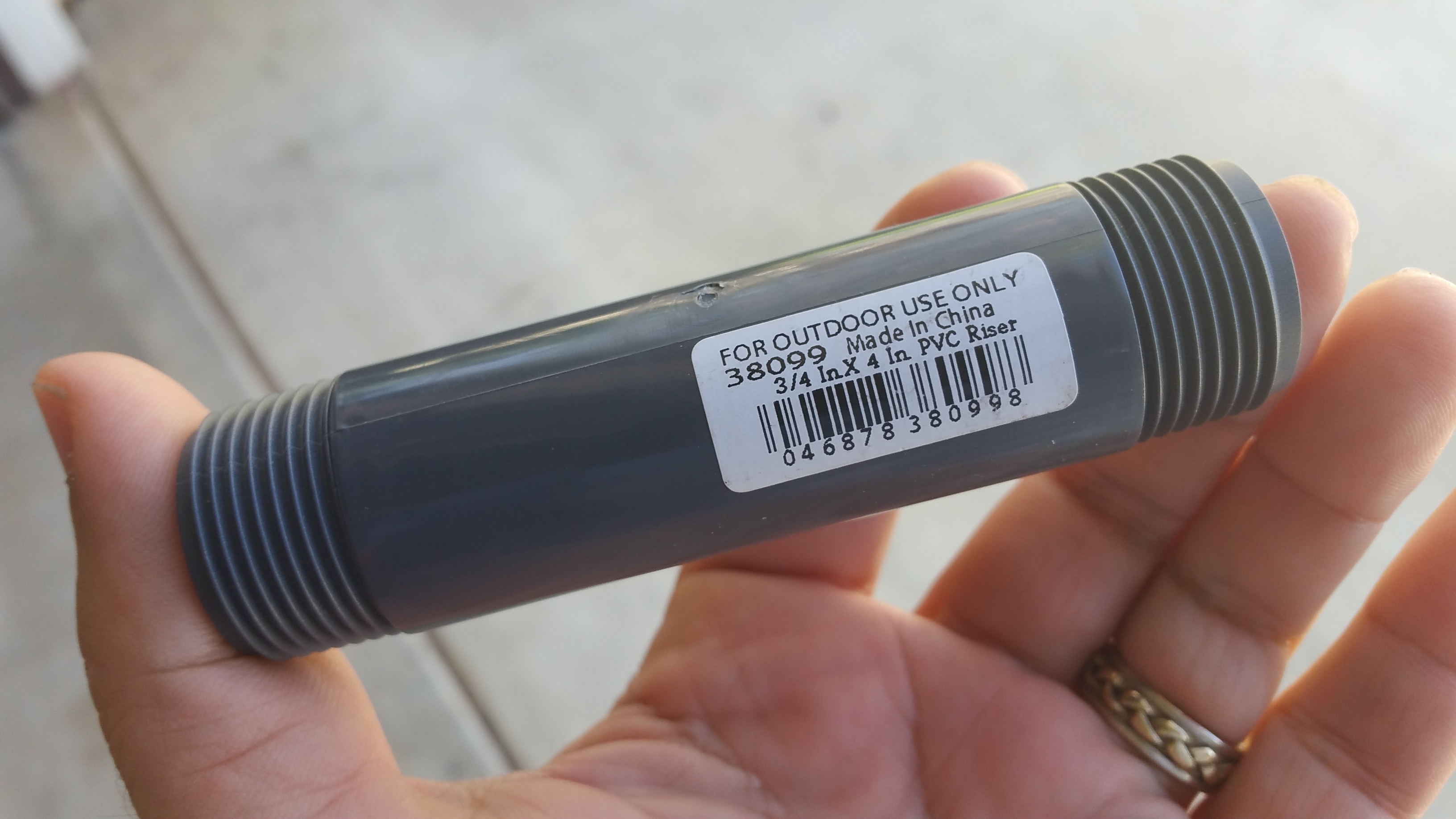

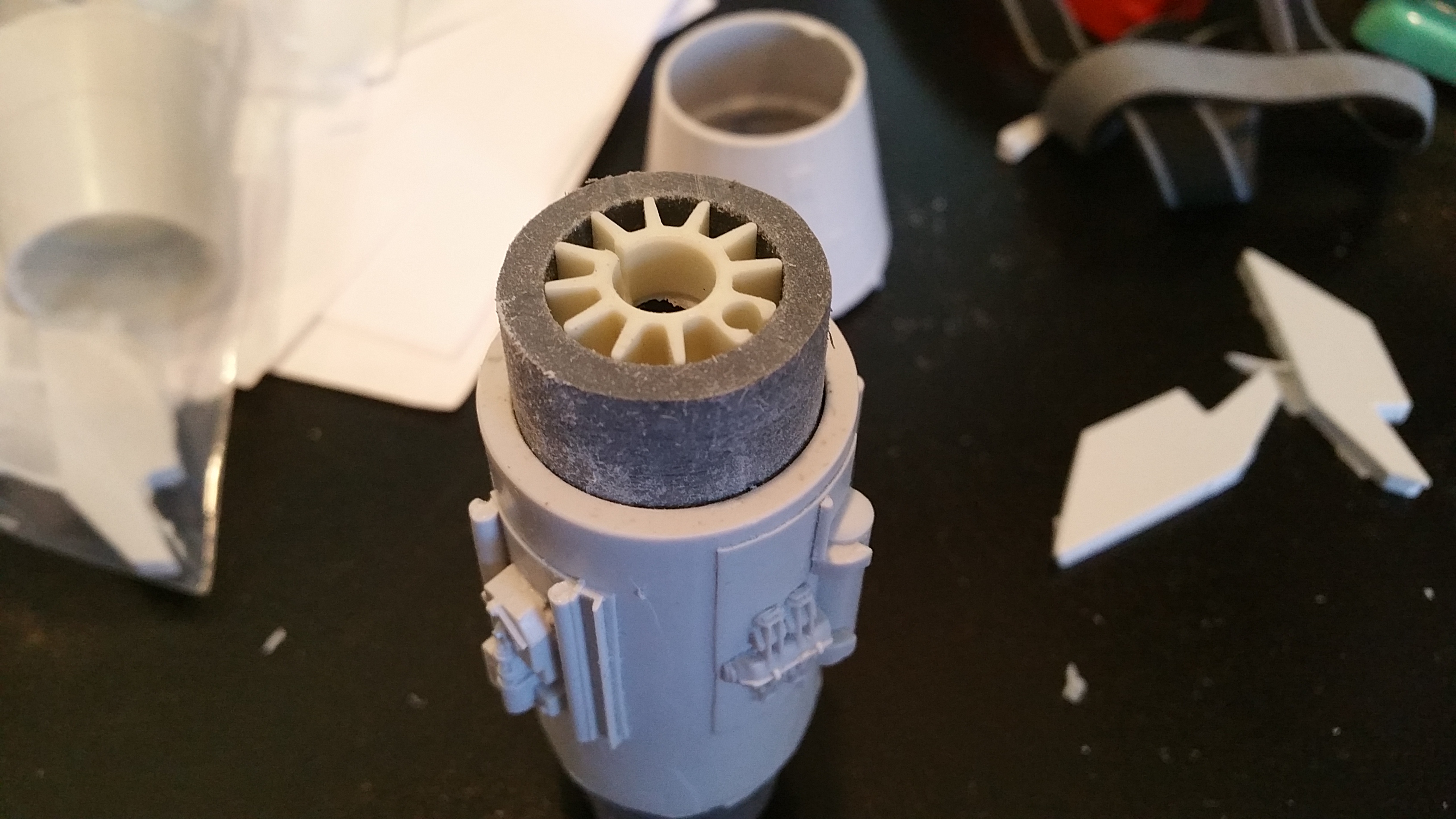

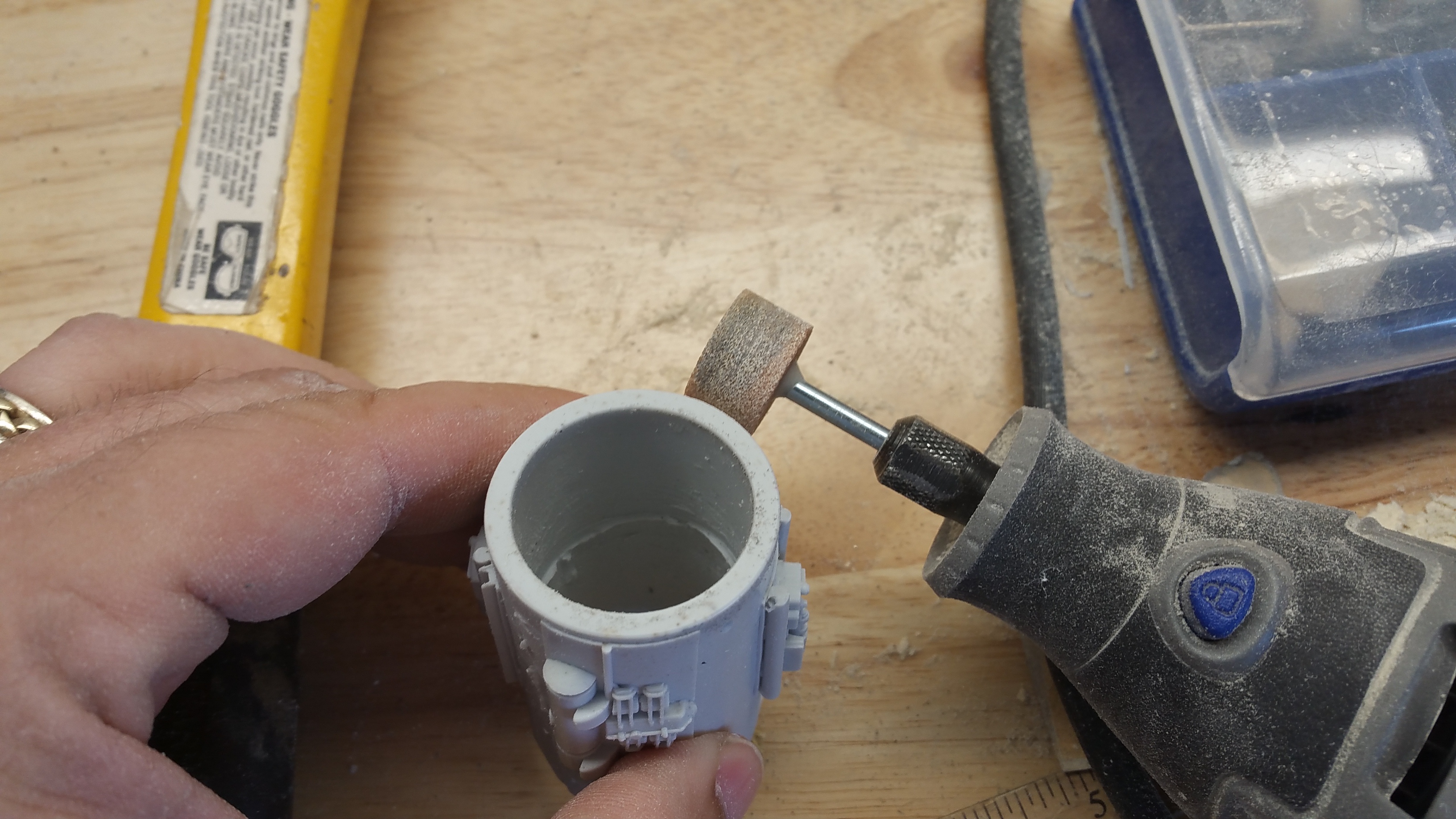

Just wanted to post another option for the engine nozzles. I picked up this 3/4" diameter 4" riser today at my local hardware store in the sprinkler area. It works pretty good. It fits the heat sink perfect and you don't have to come up with spacers to hold it within the engine casing. I did have to sand the little lip inside of the casing so that it would fit, but worked out pretty nice. Sorry, I haven't sanded everything pretty yet.

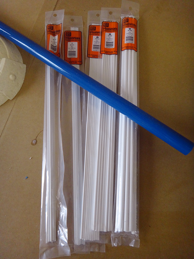

I ordered just 1 pack of each and this is what I got. LOTS of tubes!
Just to clear this up, in my head, is it tb-28 or tb-48 you need, or is it both?
I know one is TB-28 but I do not know how many you need. I do not think I have seen tb-48. My brain is hurting :) Psimon, I think that looks like one of each should be plenty plus leftovers for other projects :) I assume they bend easily ?
The engine mount is TB-28 (P-B-28 on my order sheet). It is very long, about 3 feet and you only need a few inches for the kit.
