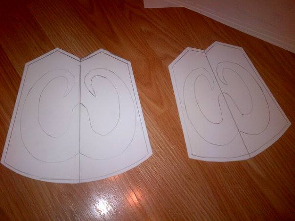

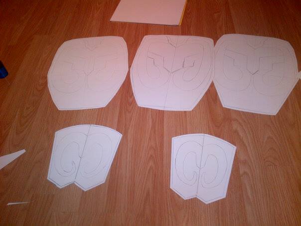

at first i free handed a drawing of the first piece to get an idea for size. of course since i free handed it it was far from symmetrical.
I then cut it out and cut it in half.

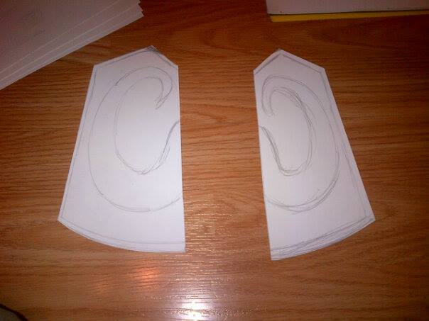

i could then trace out both sides onto a new piece of paper and have symmetrical templates. I decided one was to thin and went with the other.

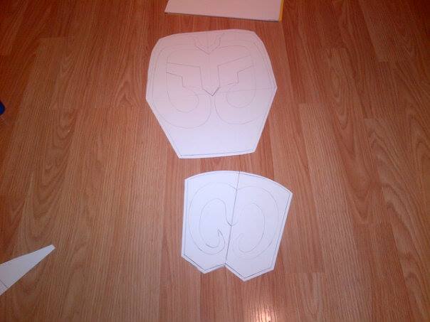

I then did the same with the large piece and also created a third template by adjusting the straightness of the edges on one of the templates.

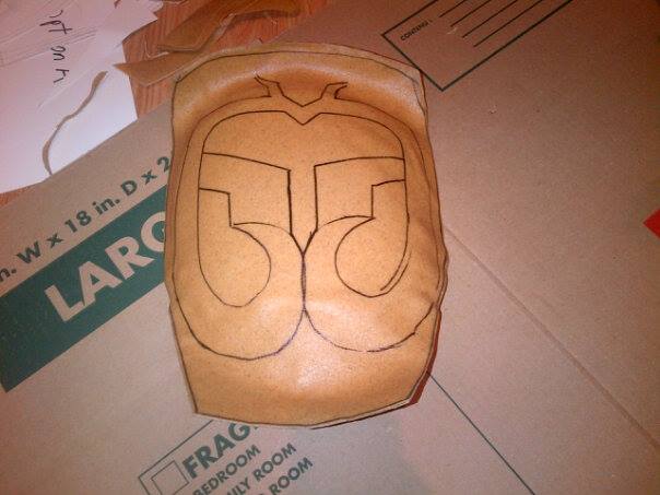

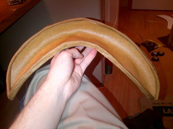

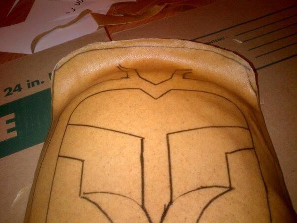

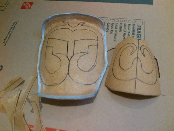

then decided on the most accurate pieces these look pretty much bang on. then they were traced onto foam and cut out then cut out of worbla and put together. currently i am working on the larger piece it still needs a little bit more shaping but I hope to finish both these pieces by the end of the weekend.

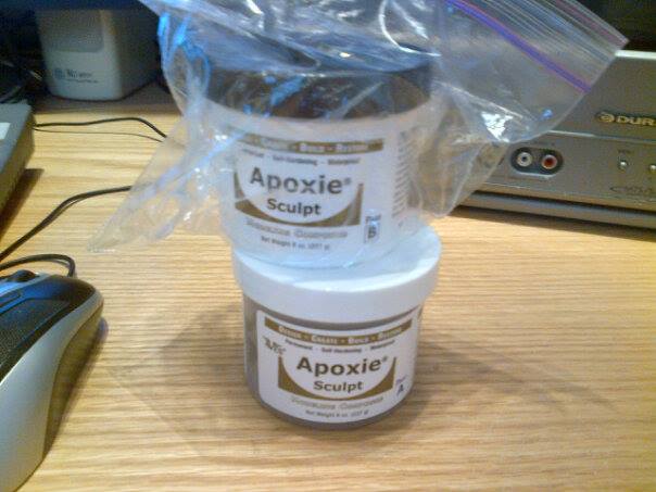

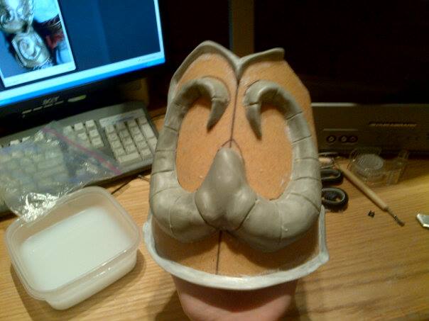

I've been using Aves Apoxie Sculpt for all my sculpting purposes and I must say that this stuff is amazing. I had some from years ago laying around the house but unfortunately it had dried up and I couldnt use it anymore so I had to order more. I started out trying to sculpt the rim on the large piece it came out ok I suppose, I think I still have more work to do on it to make it acceptable.

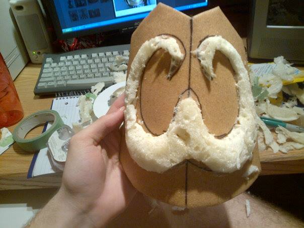

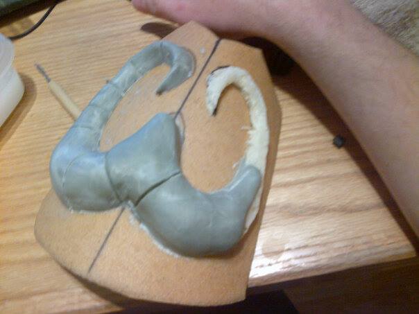

I decided to try something new and try the horns first on the smaller piece i thought it would take far to much sculpt to build it all so i bought some expanding foam and taped off the horn areas to get the base. After the expanding foam had dried and much MUCH carving later i had this.

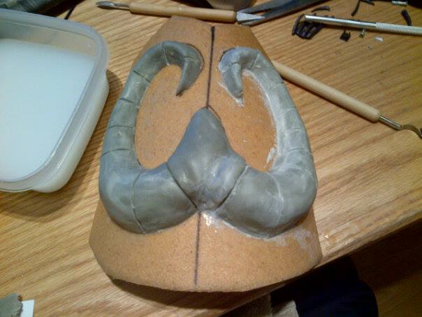

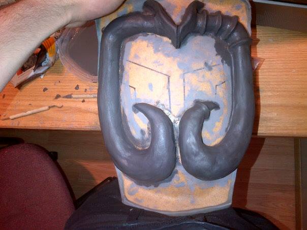

Then I began sculpting.
I still need to finish the rim as I was running out of places to hold onto the thing while the sculpt dries. I will hopefully do more tonight. Thanks for looking let me know what you think.

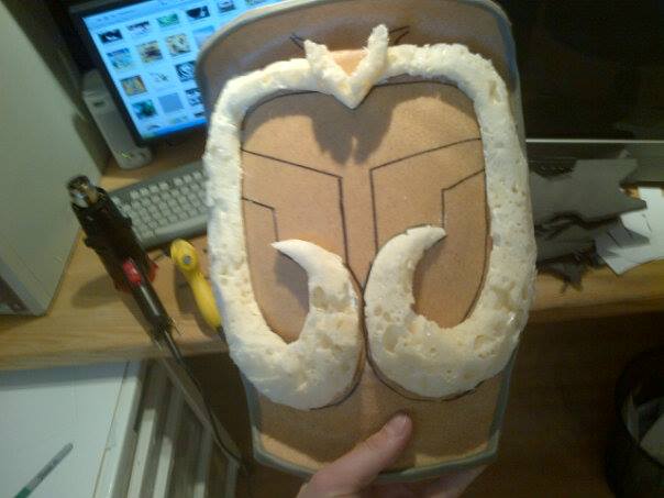

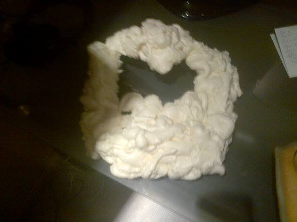

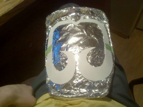

I wrapped the whole thing in tin foil and cut out the horns I had drawn on my templates and taped them to the foil then covered it all in foam.

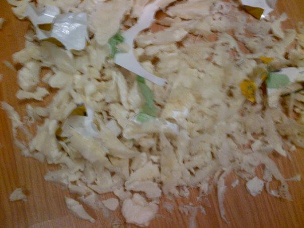

it did what I was hoping and after it was mostly dry I was able to remove the foil from the piece. The idea is that when this completely dries (tomorrow) I will be able to pull the tin foil off of the bottom of the foam but the paper template will be stuck to it. I will then be able to see exactly where the foam needs to be cut away and I can carve it to shape. also since the foam was sprayed while the foil was around the piece It should have the perfect curve to be attached to the piece, then sculpt over and finished.
so I didn't get much at all done just a small update my experiment worked! wel kind of the tin foil peeled of with ease and the template is still stuck to the foam so I can see where I need to cut. Unfortunately it doesn't fit flush to the original piece as I was hoping it would.

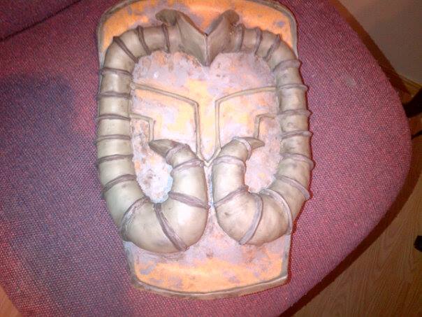

I glued the foam to the worbla and carved it all down. Unfortunately i was running to low for comfort on apoxie so i had to switch to a new clay.
new clay.jpg\
It was relatively cheap and got the job done but as it dired it cracked so ultimately i had to go back over with apoxie any ways.

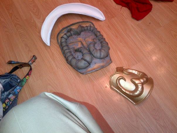

finally i built the third piece using all worbla it was surprisingly the hardest piece.

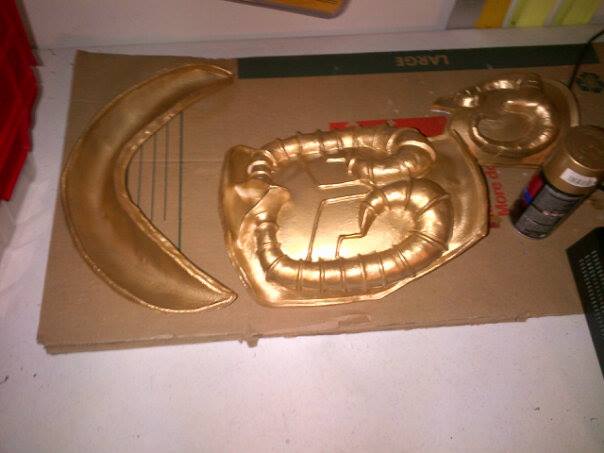

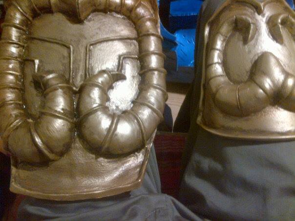

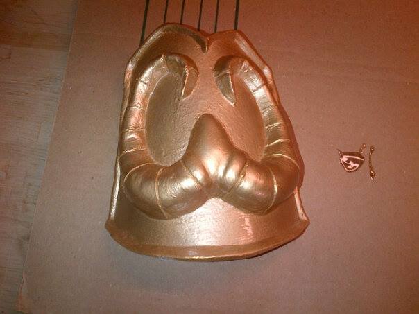

while I waited for the apoxie to dry on the horns of the big piece i decided to start trying different gold paints that were left in my garage from other projects. Fortunately i really loved the first one I tried.
Now i have coated the third piece in gesso and about to start coating the big piece. Everything should be done in the next few days.
