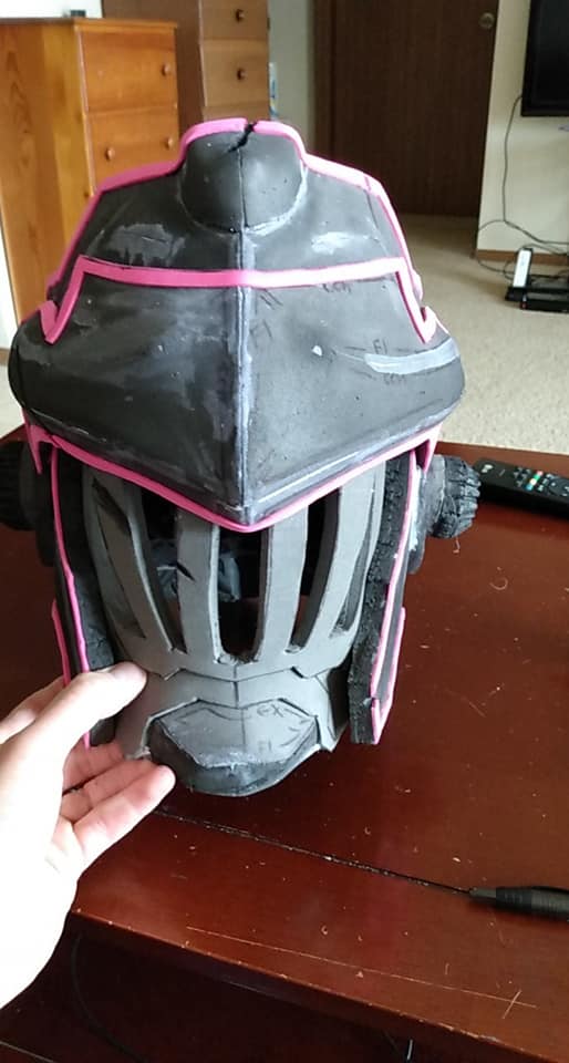

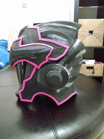

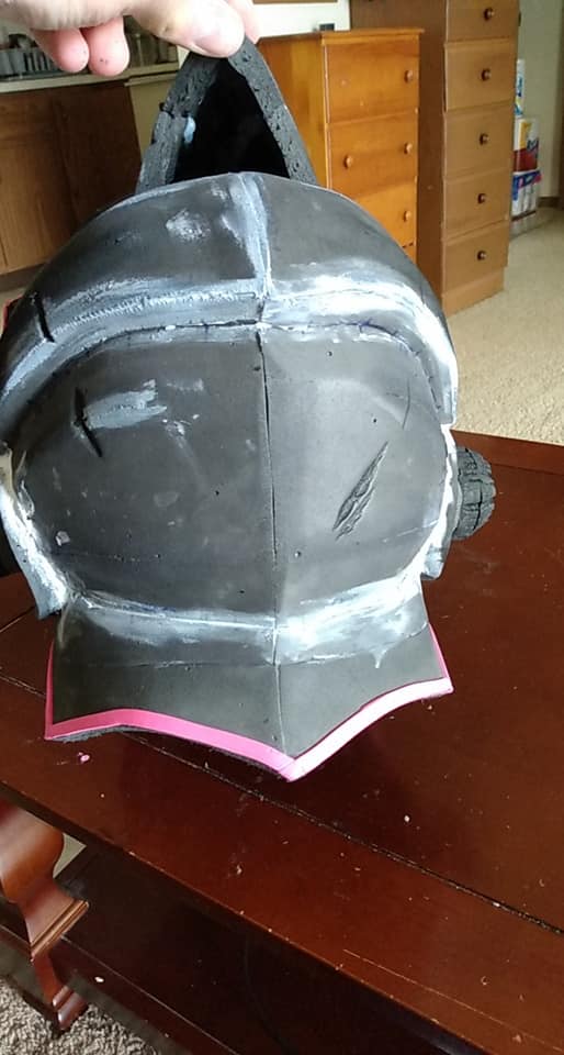

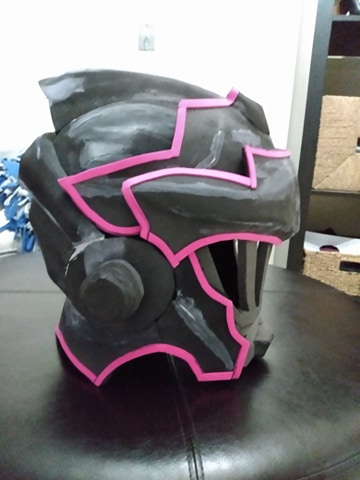

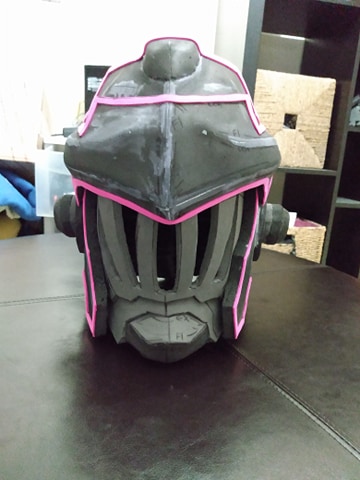

Okay, so now that I got the "MK III" suit for the ODST out of the way, time to get a new Cosplay fix. And this time I'm aim for something a little out of my comfort zone, but striding closer to my "Cosplay Goal." This time, I'm tackling the Silver-Ranked Adventurer known as Goblin Slayer, from Goblin Slayer.

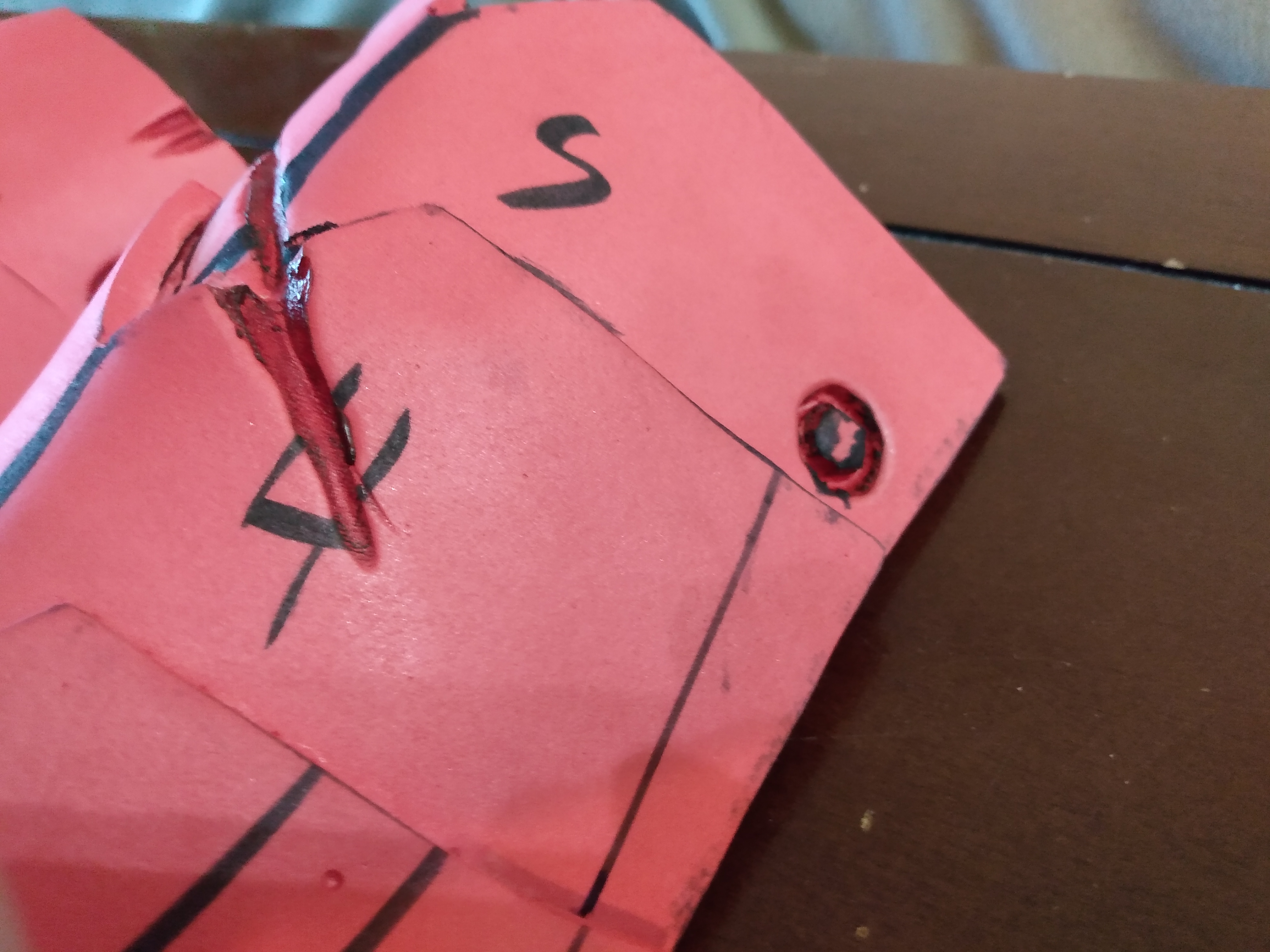

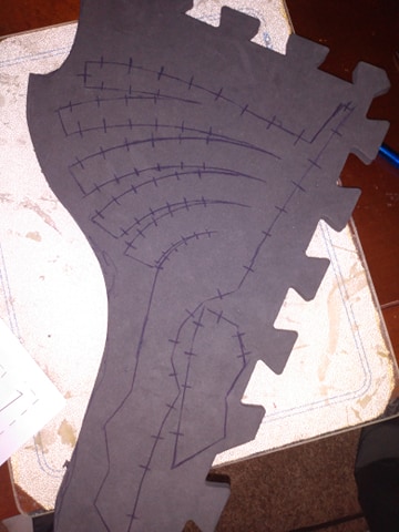

Alright, so to start off, I found this real neat program called "Armorsmith Designer" and it works like Pepakura but WAY more advanced. it helped me lot with my second prototype right here. Not only that, but it also has a...."Hashmark"....?...toggle that can be applied to the pieces!

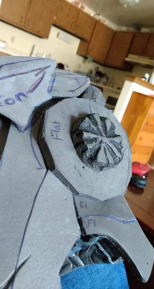

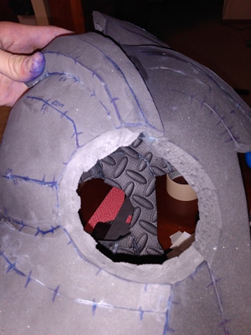

After that was completed, I built the rest of the helmet with these real thick gym floor mats that cost around $15 at Walmart, but found a cheaper set that was around $8 at Harbor Freight. I then had to stack 3 thick foam pieces on top of one another to get the broken horn thing he has on the sides. As for the Pink foam, that was with, I believe, 3mm foam that was superglued on.

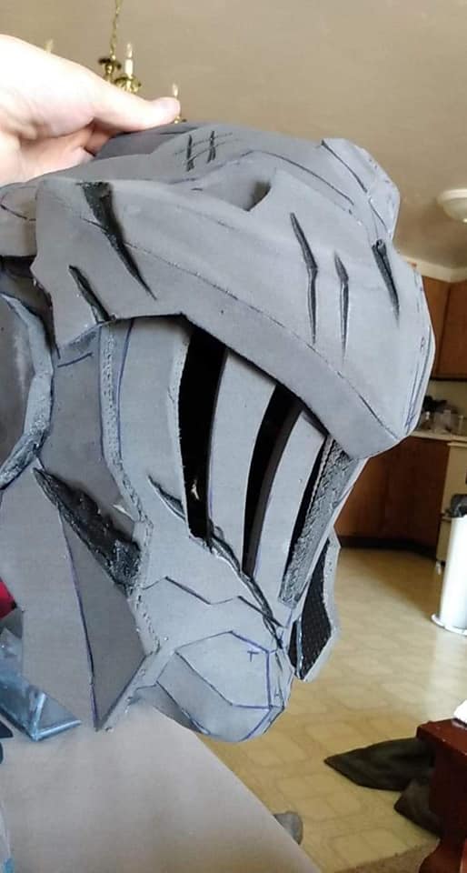

Now it came to the process of caulking/sanding it. after that I used a woodburning tool to add all the battle damage that this helmet might've been through. It was also my first time experimenting with such a technique that I would later find other uses for it on other suites to signify bullet holes or plasma burns. I was so surprised how easy it melted the foam that it also help me "Sculpt" the bone details on the sides as well.

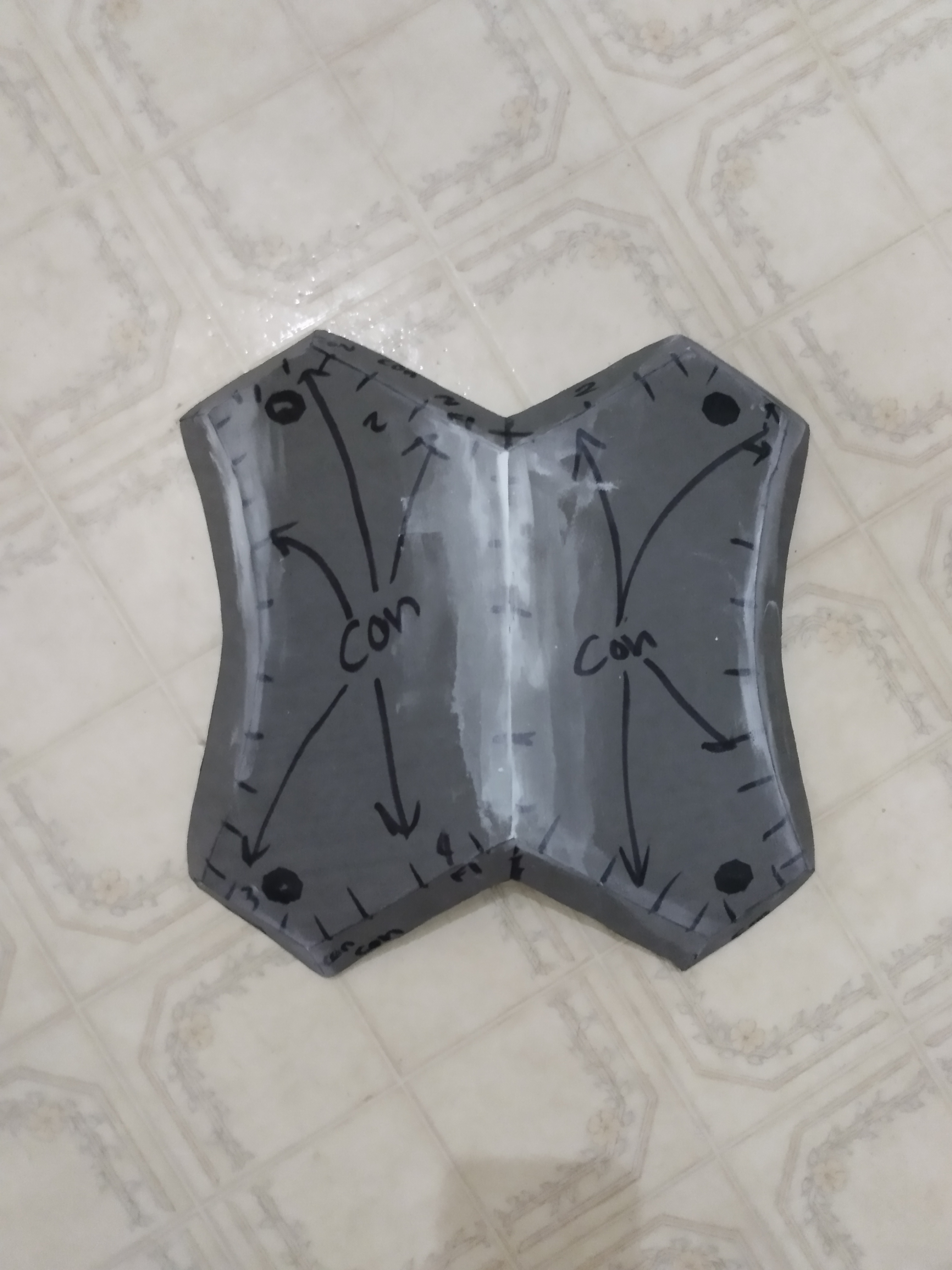

Okay, at first, thought ''Torso #2" would've been small, but after some thought, and cutting it out on foam, it seems to be the right size so far. For the pieces below, I cut out more surface material for the glue. Going to probably work on the back next.
IMG_20200406_191726487.jpg IMG_20200406_191733011.jpg IMG_20200406_191850385.jpg IMG_20200406_191911054.jpg

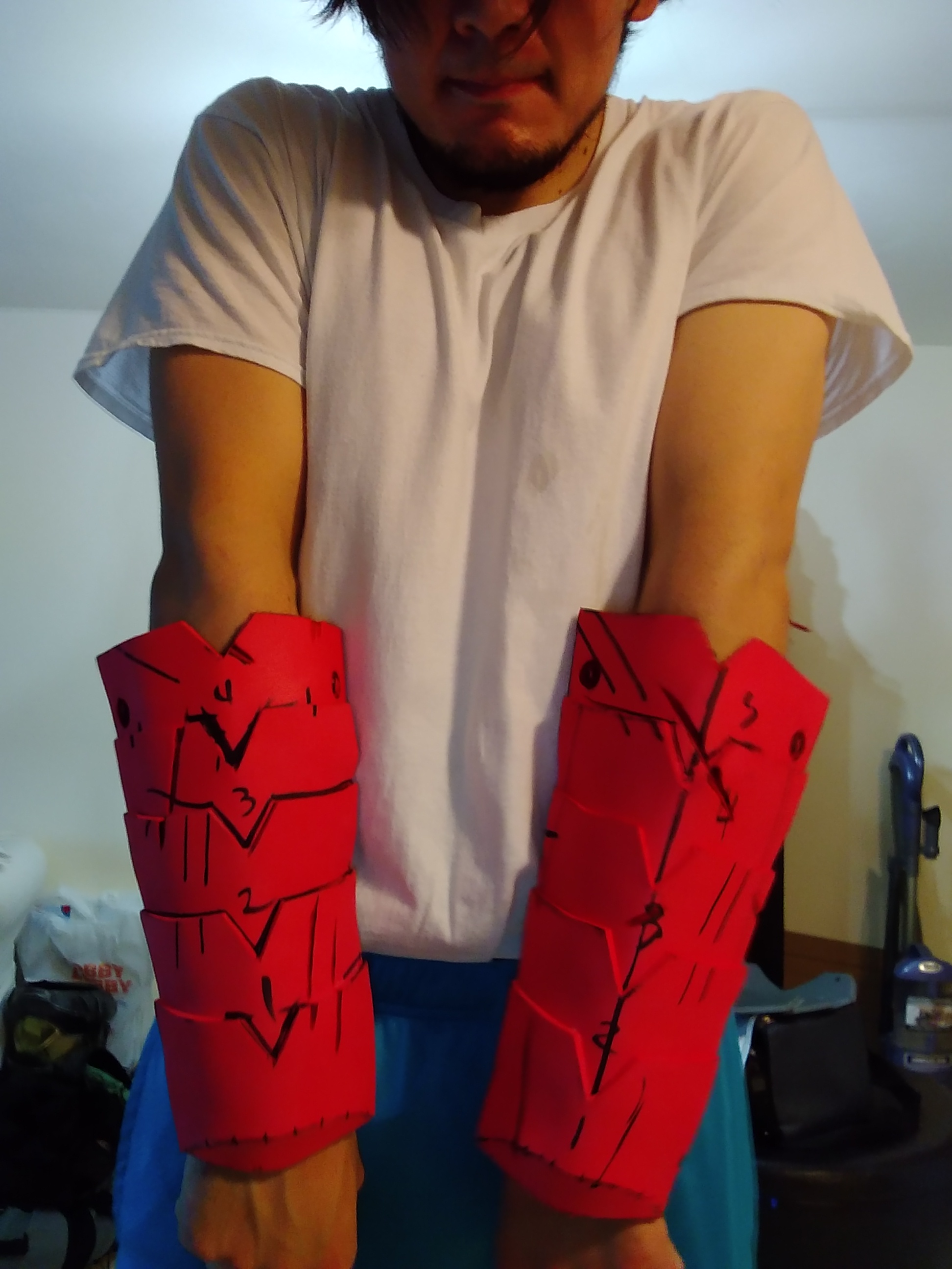

I finished both gauntlets and added some battle-damage on both. Gonna add some 2mm Eva to get more detail and make it look nicer, rather than have it look plane.

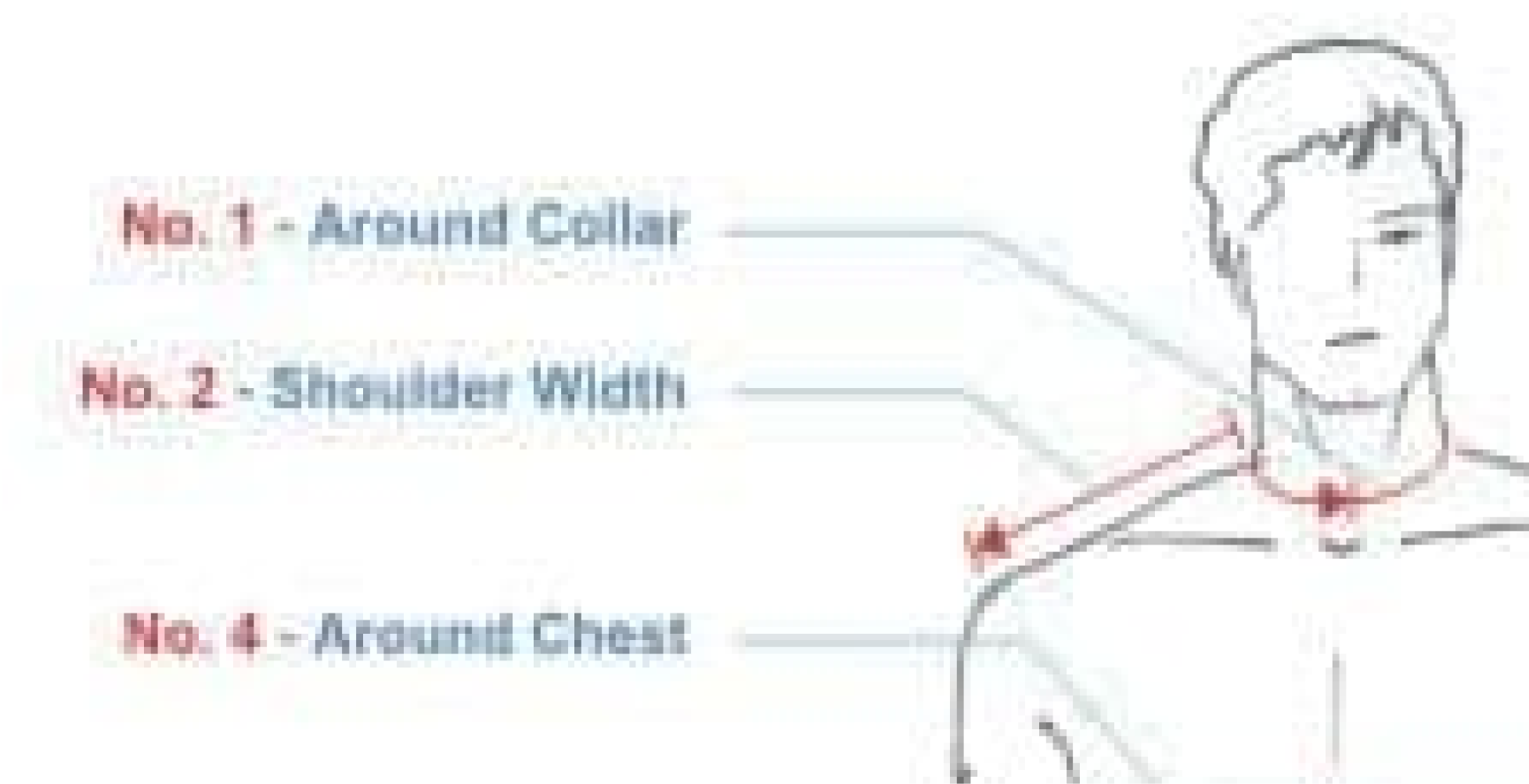

Sorry I haven't posted anything about any updates on the suite yet. Been watching videos on how to get this one measurement done. It's a male bodice pattern and what I've been trying to figure out is why the shoulder piece is about the same size as the chest, rather than having it be less so like every other bodice pattern.
Am I doing it wrong? Or am I measuring incorrectly? I'm measuring it based off of this.
Okay, so I made the "#01 Prototype" and that didn't work out so good.
Firstly on "#01" the chest was a bit too tight. Good for when I stood straight and when I breathed, but was tight when I lurched my arms forward in "#03."
Second on "#02" the Shoulder pieces are too long. Hanging right over, if not further, than the shoulders themselves. Need to shorten them.
Third, the draft needs to be redone. Here it is cut out and cut onto fabric.
And here's the fabric when they're held together with pins. Yeah, looks like a giant square, huh?
Luckily I fixed these problems in my newest "#02 Prototype."
Here's a bit of a detailed diagram of what I did to improve this prototype.
This is for the "Neck" and "Shoulder Slope."
Edit: I forgot to mention!!! When you measure your neck ("X")
- "X" / 2 = "Y"
*If doing half bodice, continue to next
step*
- "Y" / 2 = Target Measurement.
And this is for the "Armhole" and "Chest." Also, if you're wondering why I measured the armhole from around the shoulder area, but labeled it on the diagram to the "Top" of the highest point, my only answer is just to "See where this goes, that's what they said in the video."
And here are the fabric pieces cut out. I think that's a little better than before. Though I DO think this is a bit too big for my chest. I might shrink the sides down about .5cm on each, since that would mean I took about 1cm on a whole.
But yeah, that's my progress so far. I think I'm making some improvement and am hoping these diagrams work for ya.^^
