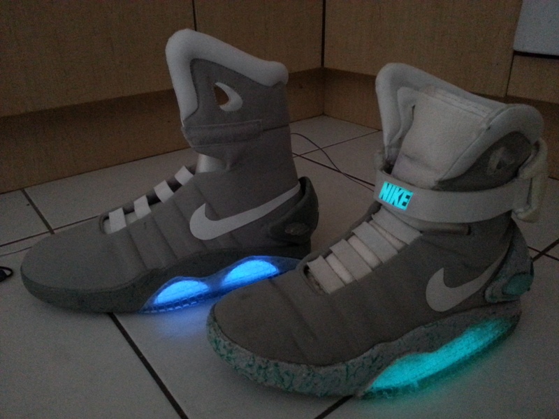

    I have not used the paints, but the powders are great. With the powders you can control the mix and therefore get the brightest light output by mixing to the maximum recommended per volume. In the case of the stuff I use that is 15%/Vol. The stuff glows bright when fully charged but fades out pretty quickly. Once it fades down, it glows at a constant level for several hours.
    [​IMG]
    In the photo, the shoe closest to camera is using GITD that has been mixed into clear urethane. The shoe behind is using EL sheet. As you see, it can be bright when mixed correctly fully charged.
    Green is common because green tends to be the brightest. I have both green and cyan (aka aqua) GITD powders in my stash.

    Cool Nike Mags.
    When it's not "glowing" what color is it?

    Thanks, I like them.
    Even though it was mixed into clear urethane, it changes the colour of the mix to a solid colour that is almost yellow.
    Note the bubble on the heel cup glows but now where near as bright? That was green GITD mixed at just 5%. I also mixed a bit of translucent blue into the clear for that part.
    The pre-mixed paints are said to be about 5% as well.
