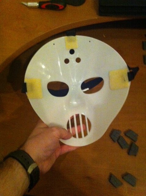

While I was trying on the mask, I brought the pieces of padding I had cut and placed them in-between my face and the mask. The pieces I used were not thick enough, so they fell through the mask. After experimenting, I wound up altering the padding thickness. I doubled the thickness of the forehead piece, and tripled the thickness of the cheek pieces. I used masking tape to test out the double and triple thick pieces and taped them in places using the same method.
Step 3. The Forehead
I chose to start with the forehead as the first padding point. I knew that to have the mask pushed evenly away from my face, I would need at least three cushioned spots.
I put the double thickness padding and lined it up with the central contact point on the forehead. I glued it and allowed it to dry.
Please allow plenty of time for the glue fumes to dissipate. I neglected to do this and found myself awarded a brief headache for my lack of patience.
Step 4. Lower Anchor Points
After the glue had dried on the forehead cushion, I tried it one with my ‘sports’ glasses. The contact point on my forehead was fine, but the mask was still pressing down on my glasses.

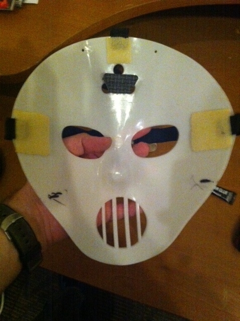

I tried the same thickness of padding for my cheeks, but it was not thick enough to keep the mask from pushing in to my glasses. So, I pulled off the mask and made a test piece. The triple thickness appeared to do the trick. So, I glued the pieces together and moved them around under the mask. I did this until they were resting in a comfortable spot that kept the glasses and mask from rubbing up against each other.
I would need to remove the mask to glue everything down. So, I used a sharpie to mark the position of the padding.
After I pulled the mask off, I glued everything down and this time I left it plenty of time to dry.
