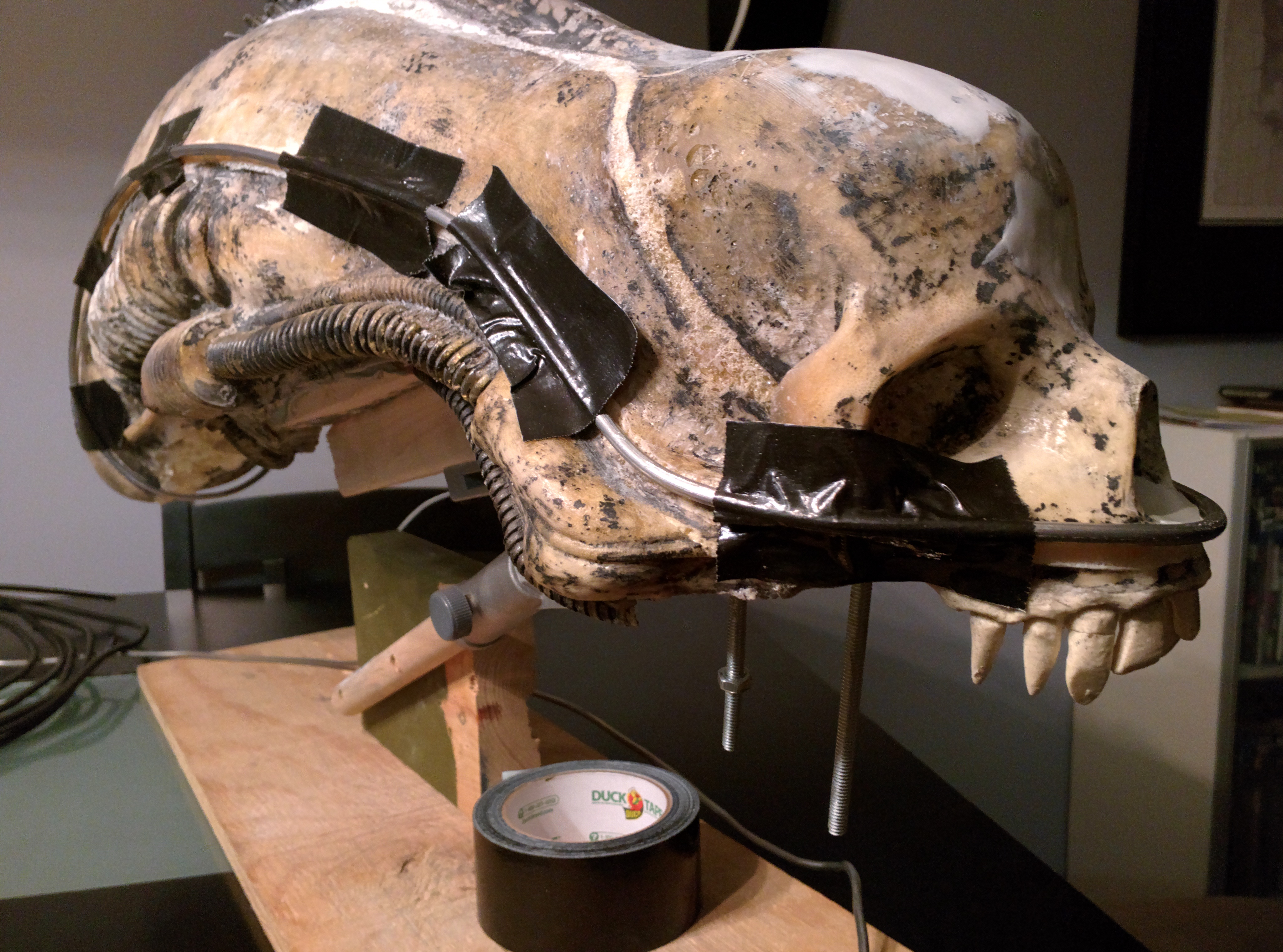

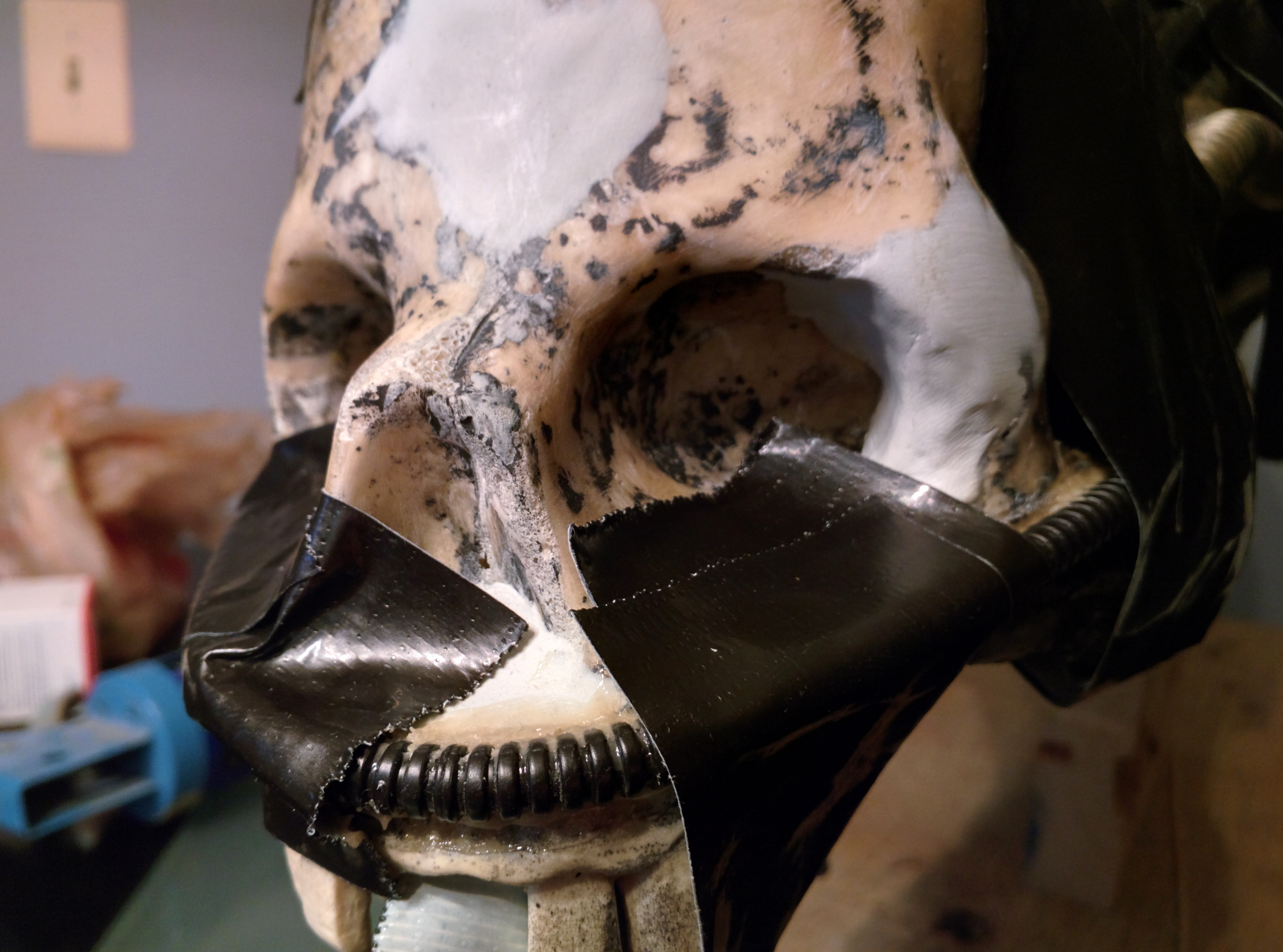

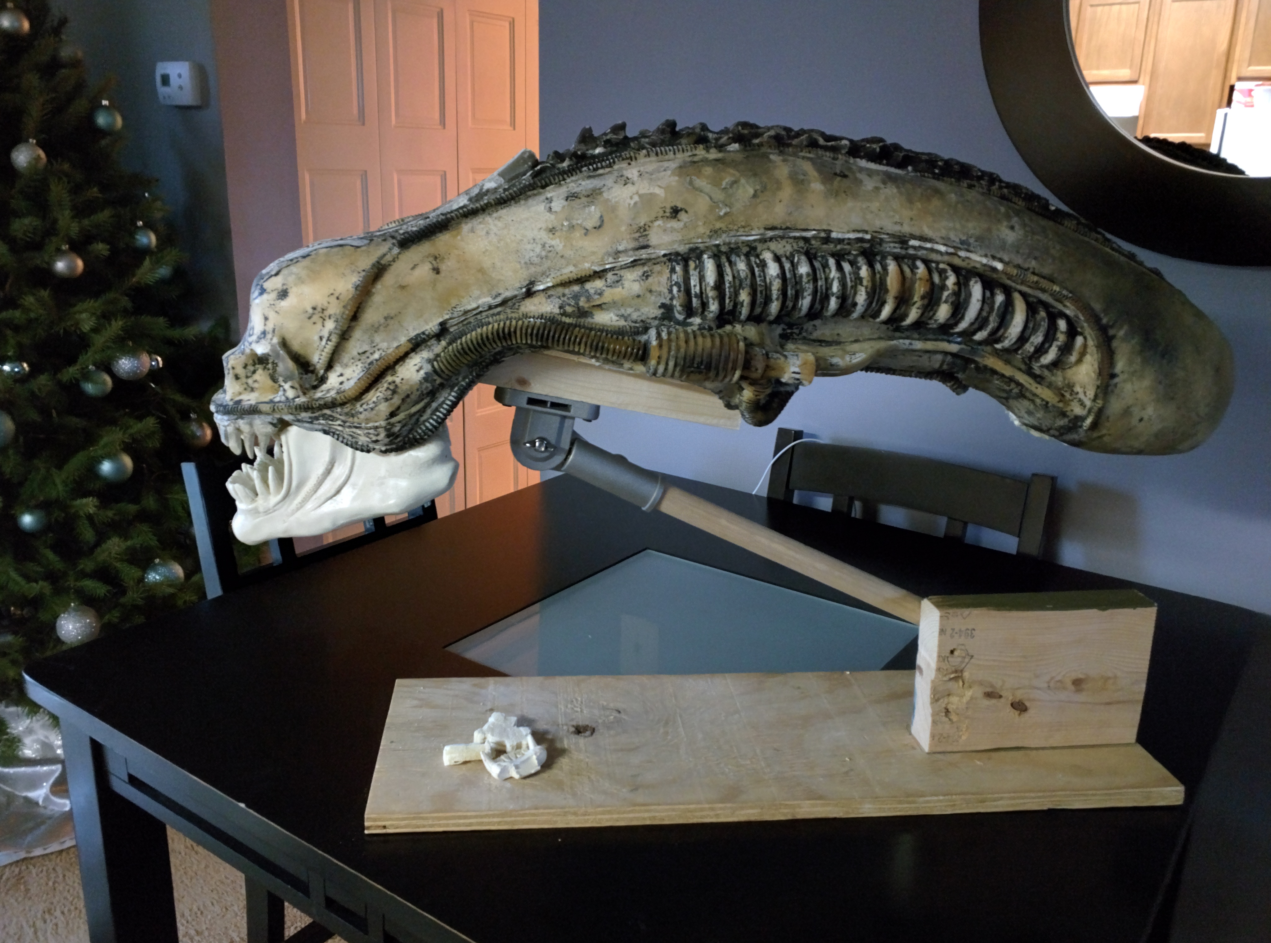

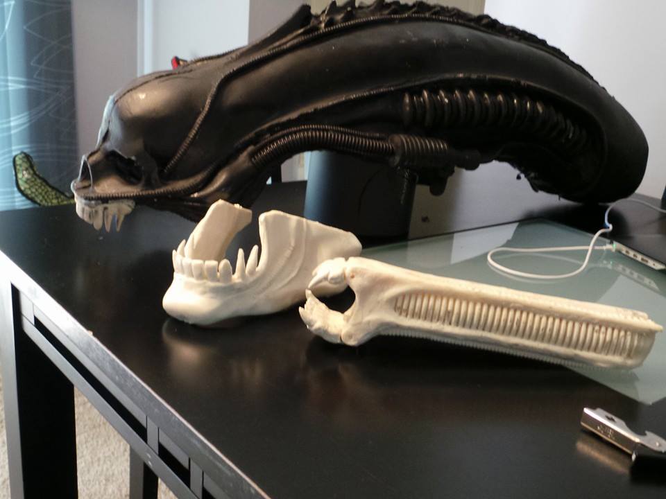

With the temp mount and jaw:

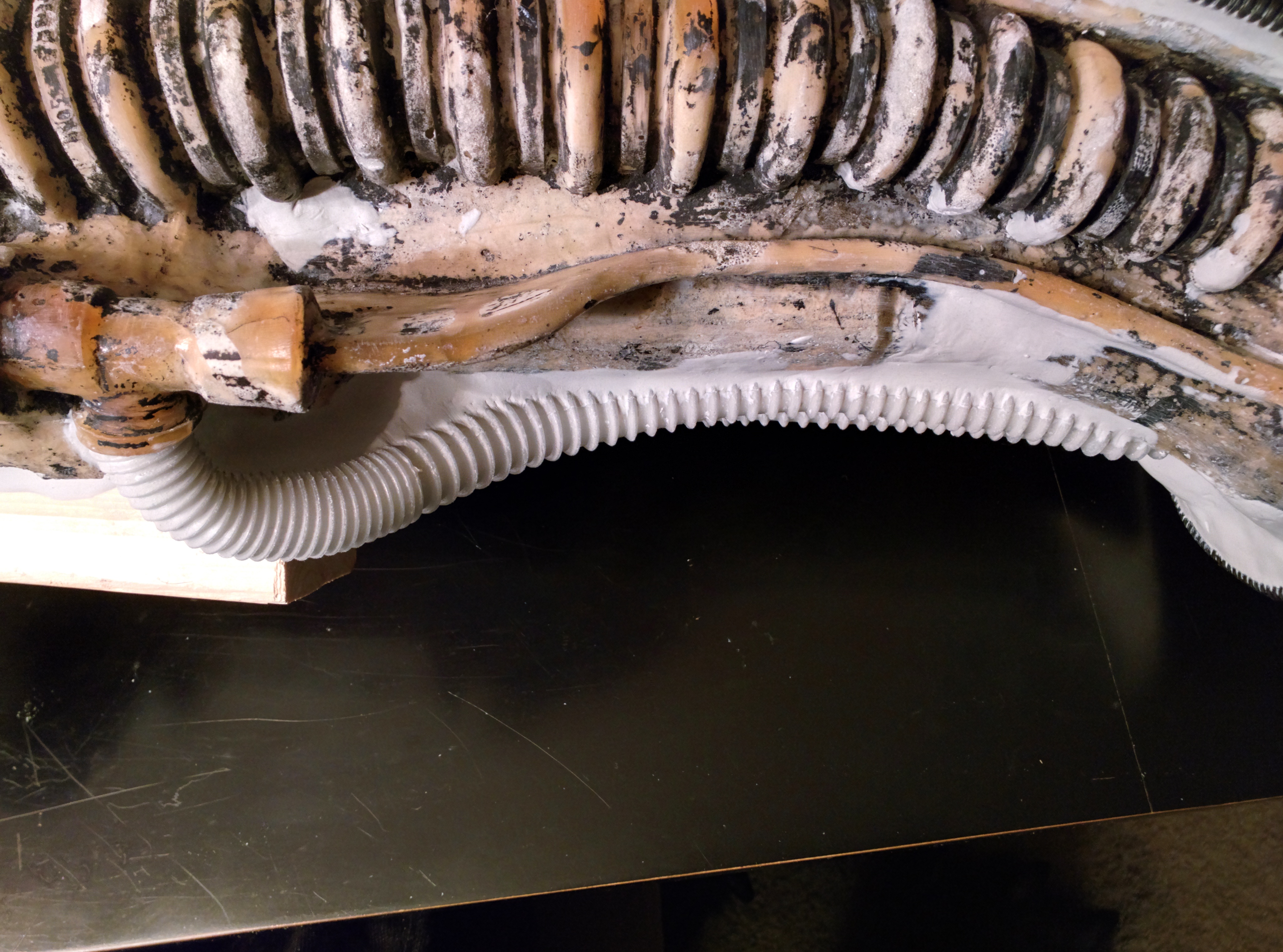

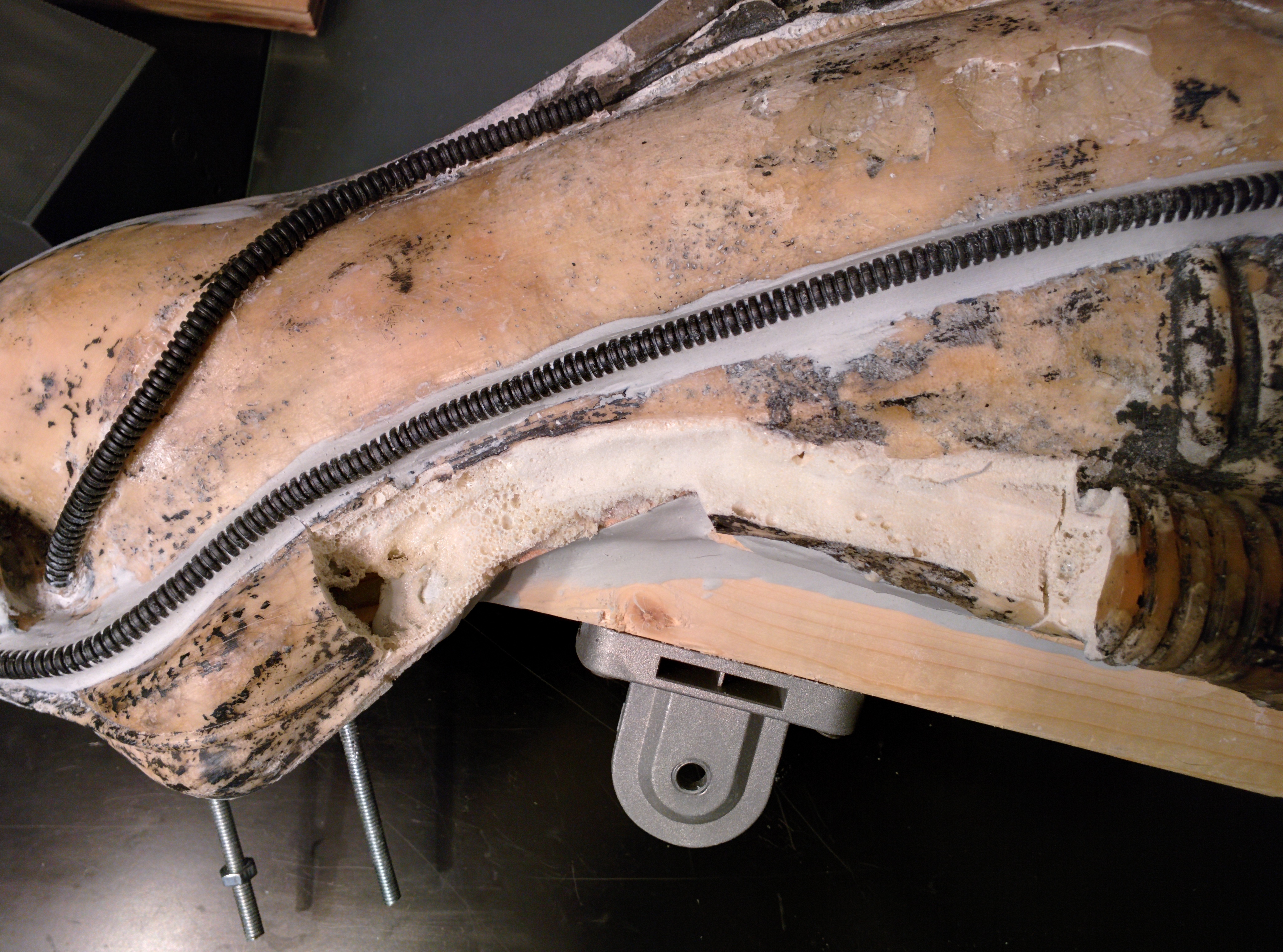

Hi Sleepybee,
It has been moving slowly haven't had much free time to work on it. i did replace all the 1/8 inch piping on the head there were way to many air pockets in the original cast to salvage most of it. I have used armature wire inside the tubing so it is nice and solid.
I actually have off from work tomorrow so i plan on getting some work done on it i need to sculpt the edges into the head currently it is just glued into place.
i will have some more progress to show this weekend.
P.s. Tape is only on till glue dries :p

Having looked at your cast plastik (& the moulds in the link above) it looks like the convoluted tube that runs from under the cheek to the back of the gums is mostly missing, do you plan on replacing this part? I believe the original was a length of metal armoured cable covering very much like the type found in phone booths. :)
Yes I will be replacing the tube, I'm actually replacing all the tubing, they were all in bad shape for the most part due to air pockets. I will also be redoing the spine at the top. I cut the rest of the tubes off tonight and plan on gluing new ones on tomorrow or the next day. I am filling them with rigid material also so they won't be flexible at all.

the outside diameter is uniform because i used 3/16" armature wire on the inside you can see examples in the above pictures, the diameter is also the same of what was on the head when i received it. Since i'm not making a mould and casts i am making everything solid. don't want hallow tubing on a display piece.

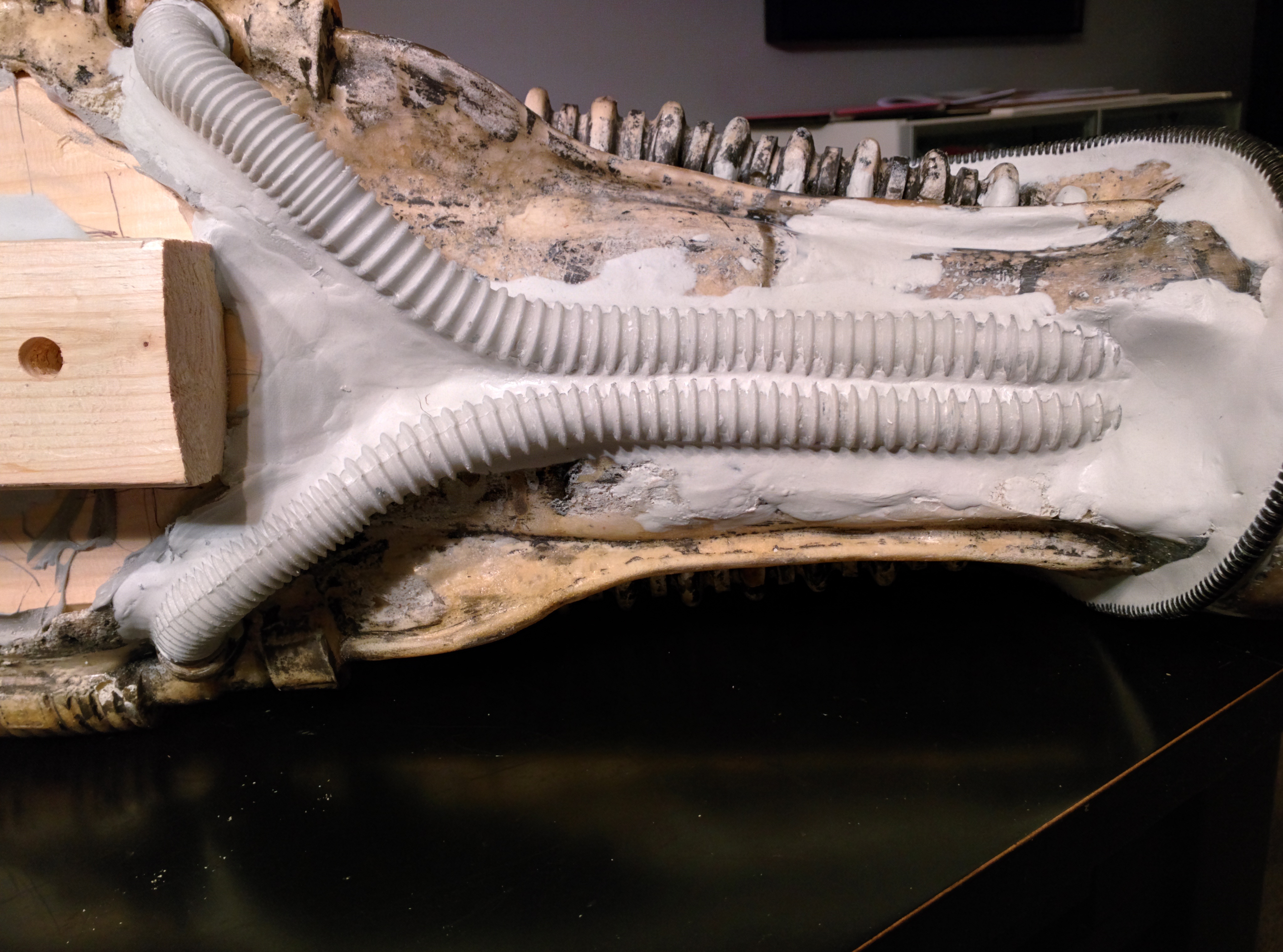

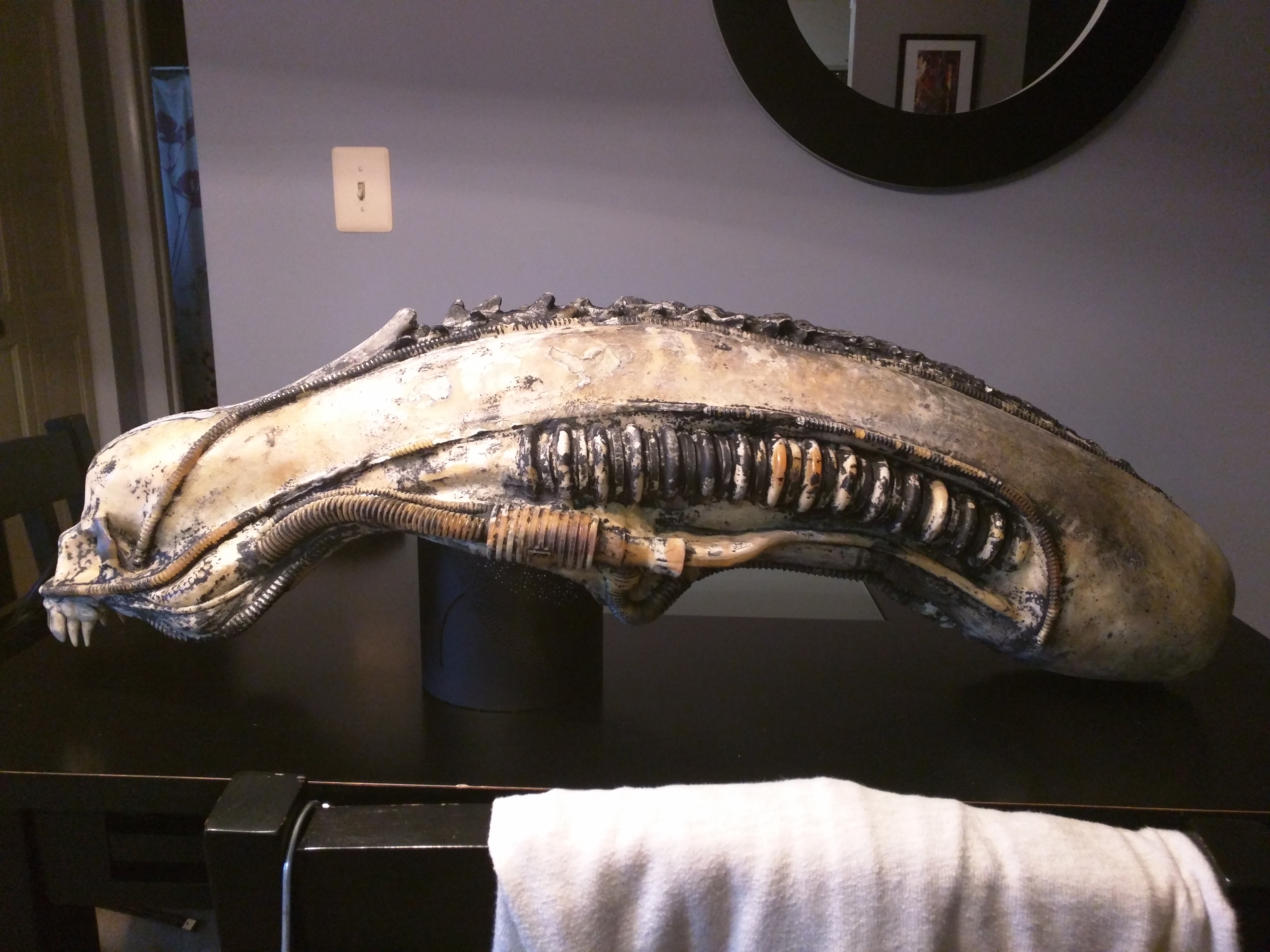

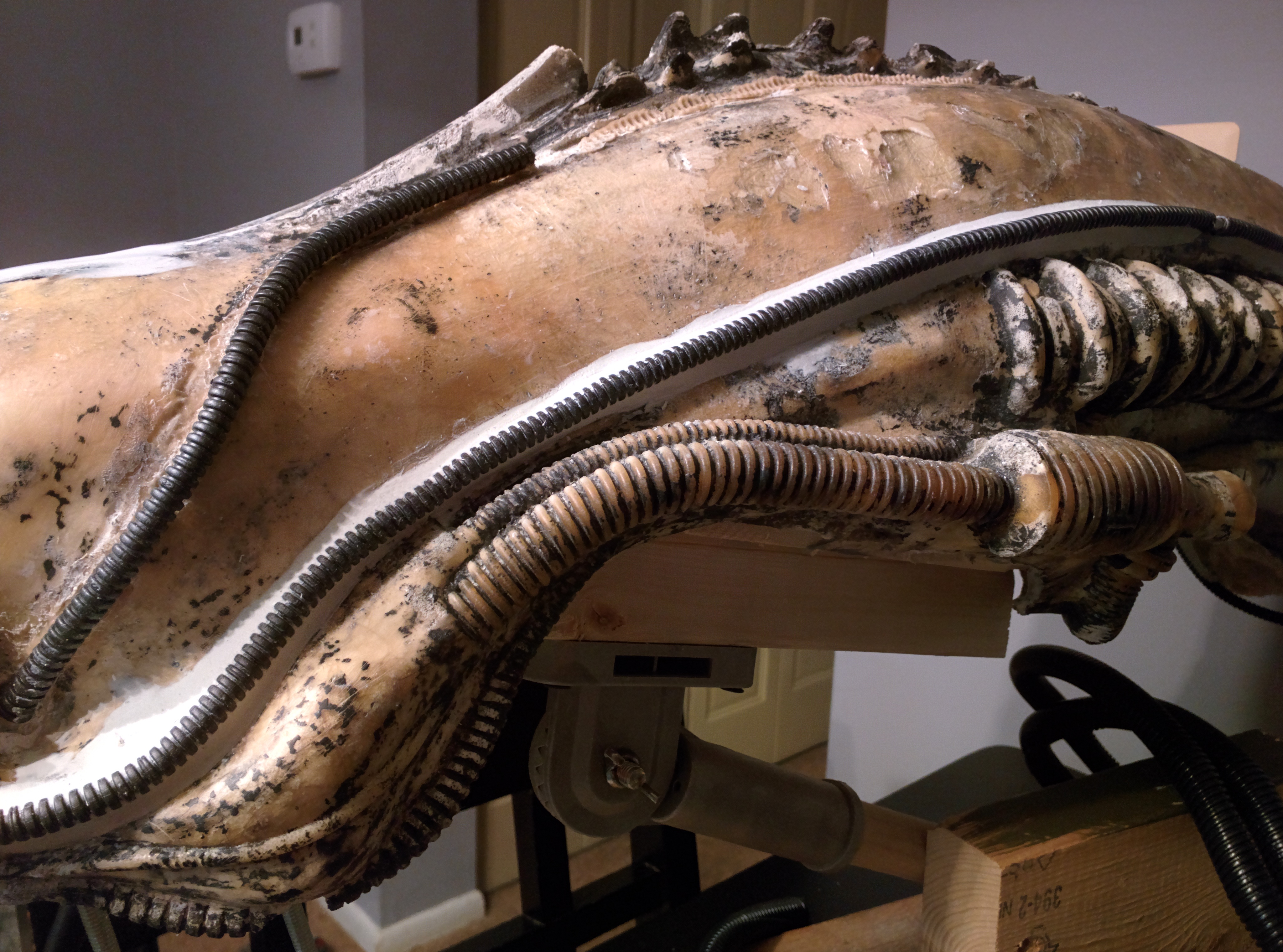

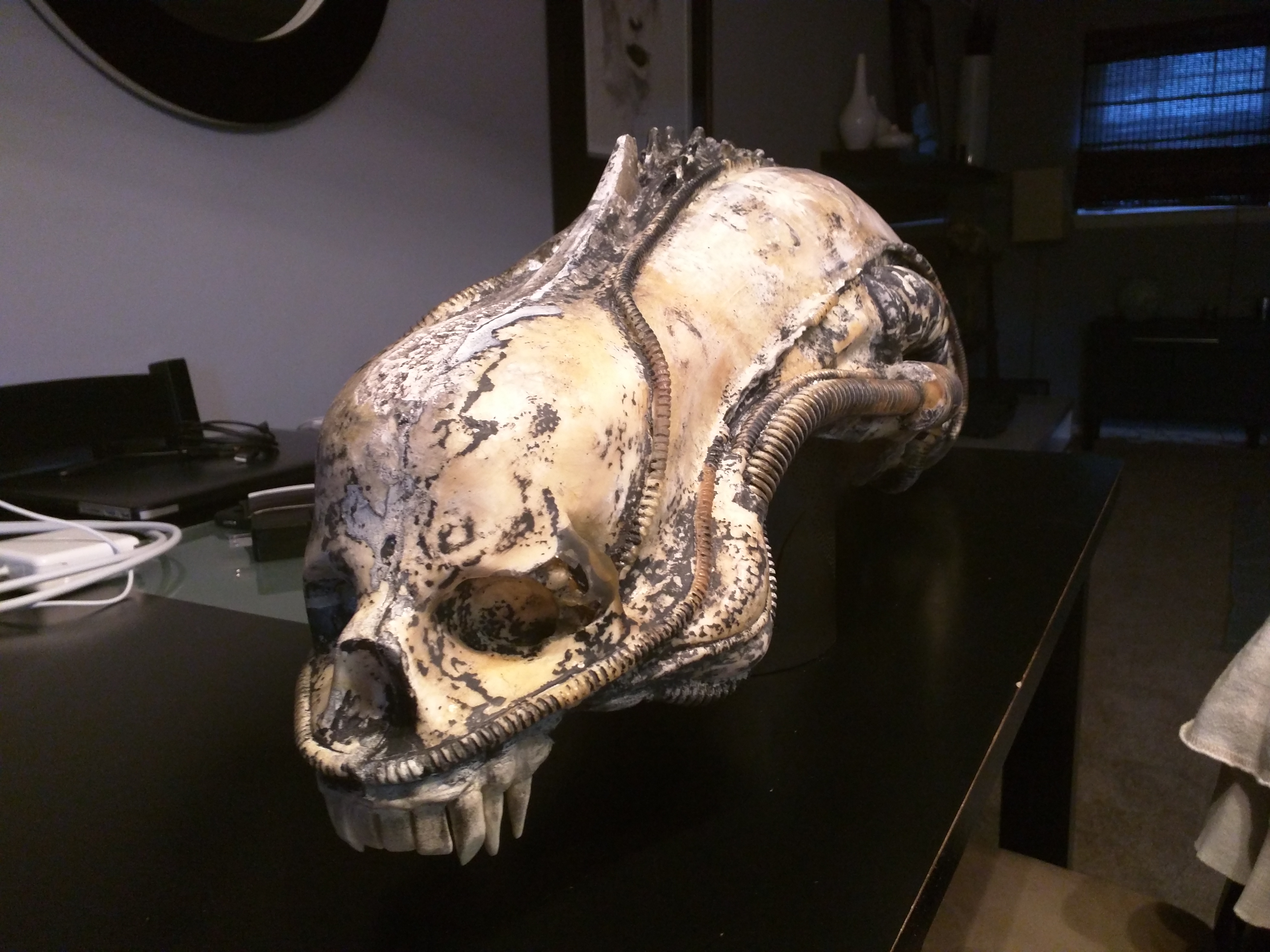

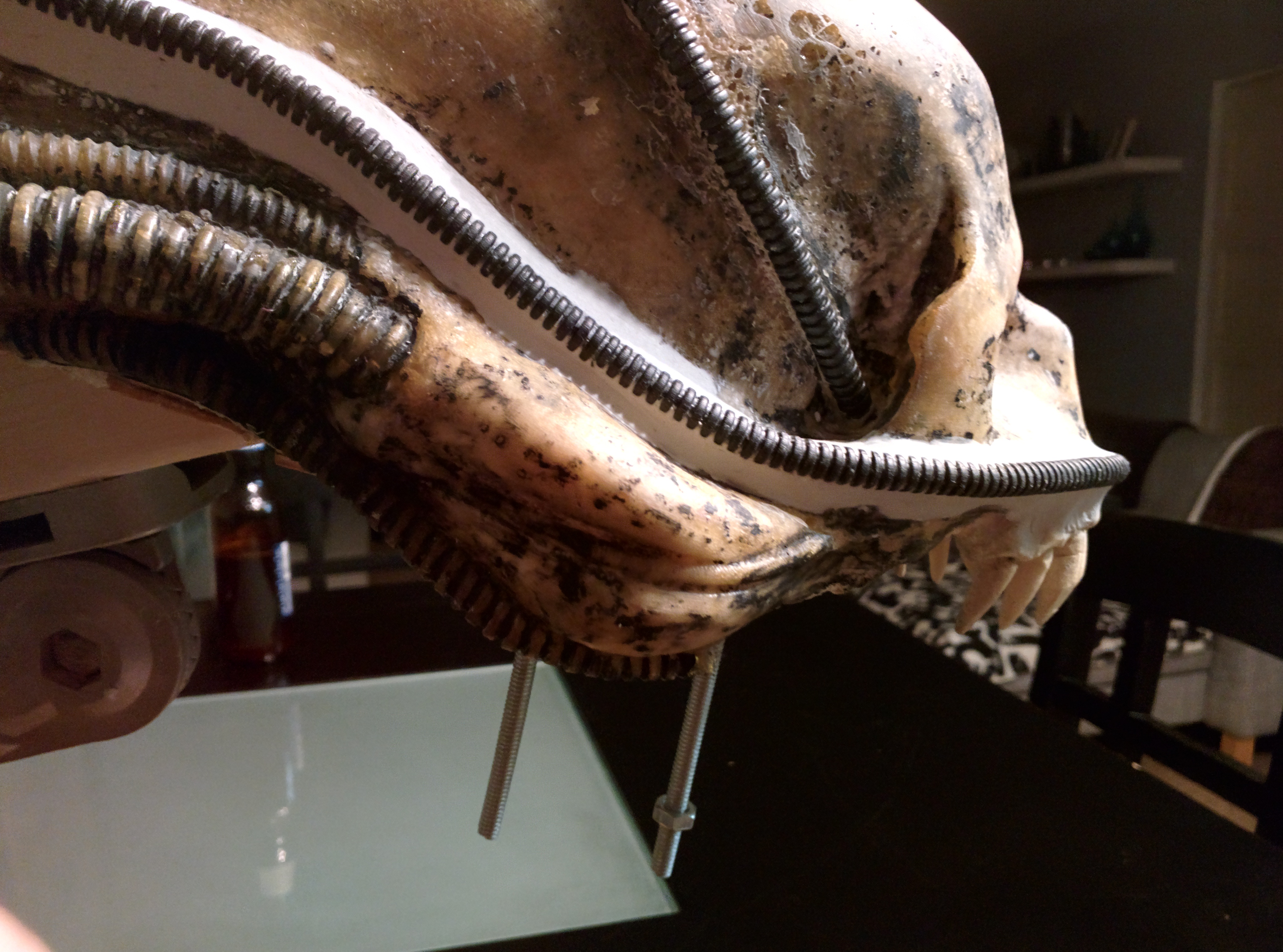

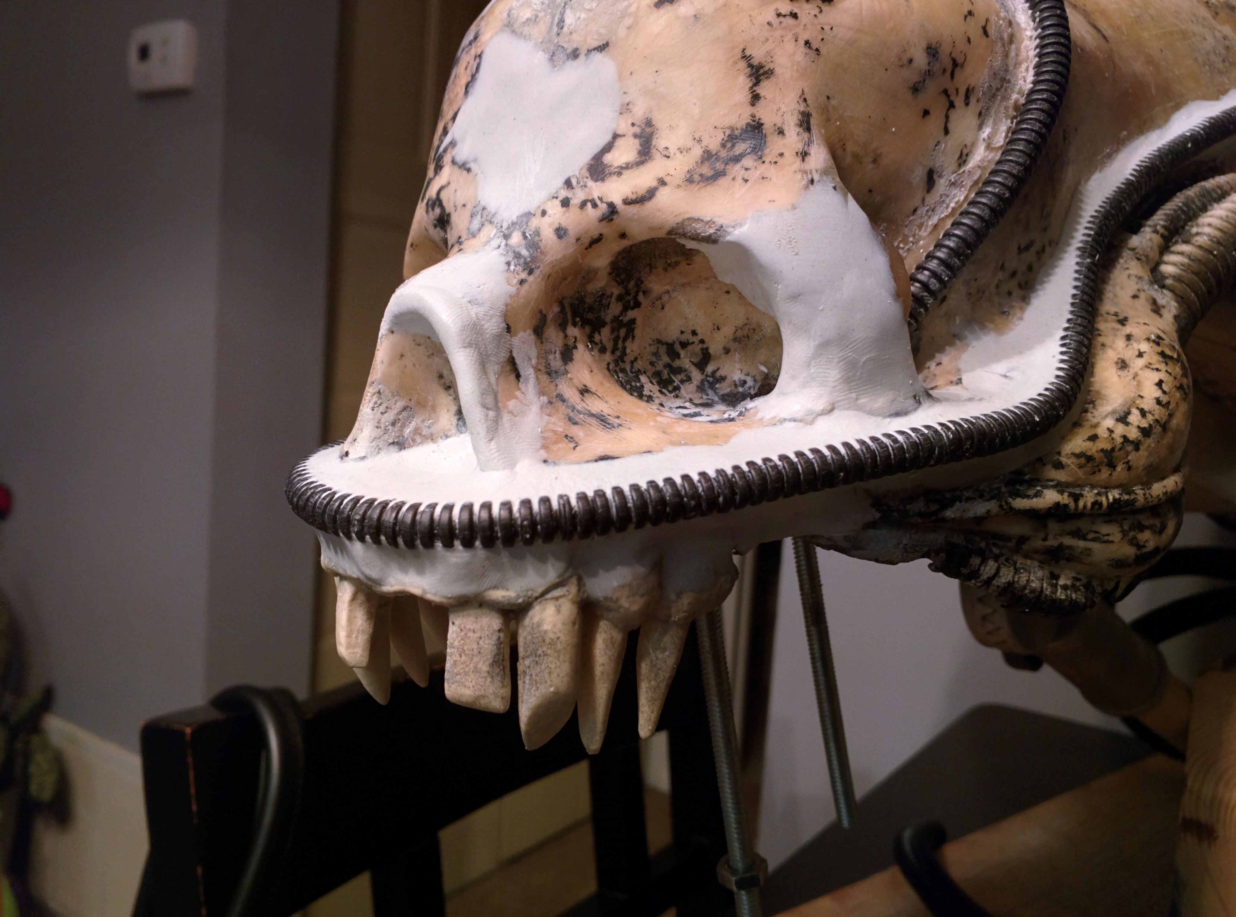

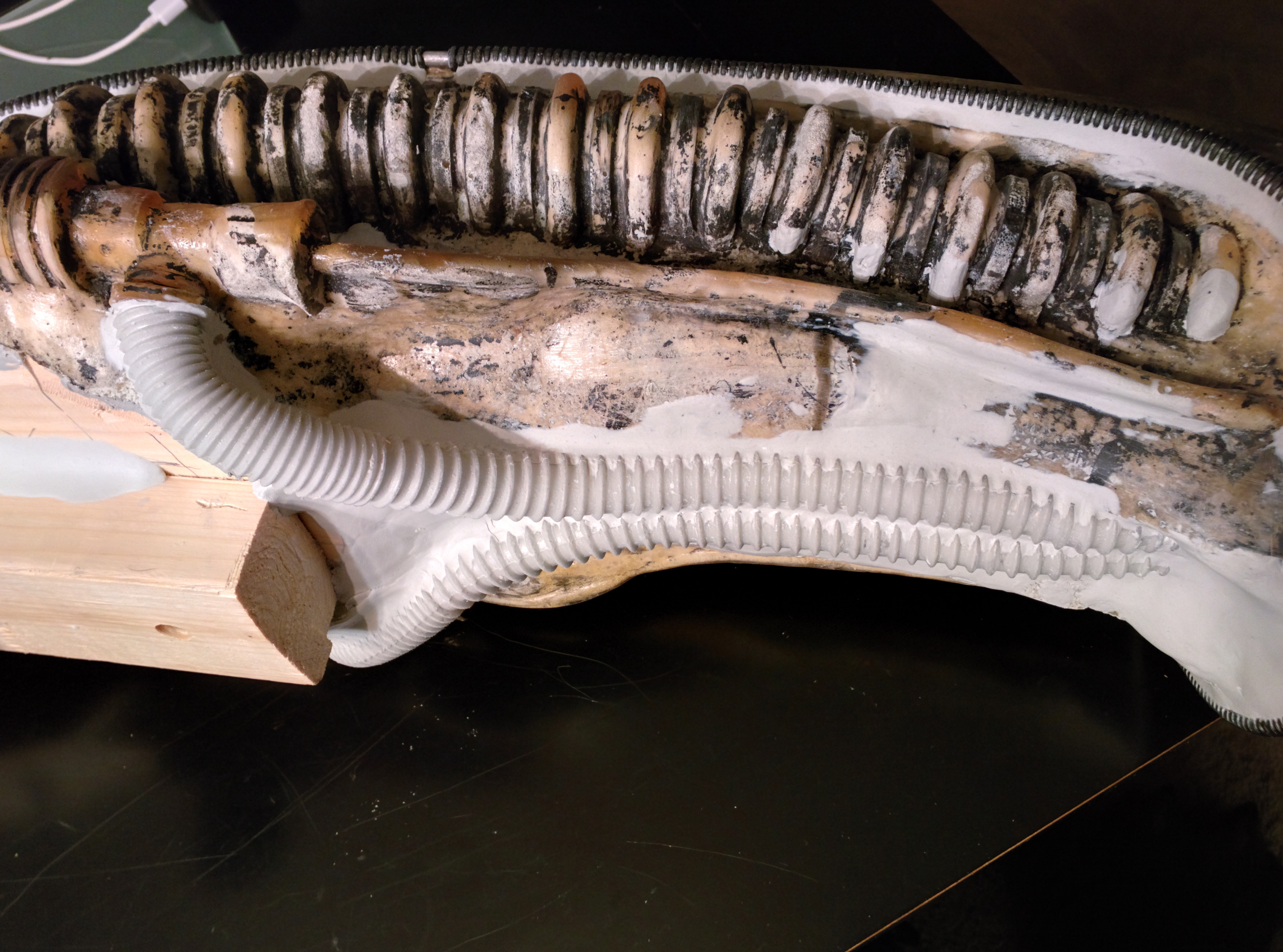

haven't got as much done as i wanted but there is some progress.
I ran into a problem with one of the new pipe for behind the cheeks, one of them is not shaped correctly so i need to make a new one.
i did get the new pipes under the head mounted and molded into the head :)
I'm still working on the shape of the head where the pipes enter the back.
Looking good :thumbsup
Those pipes under the back there may cause you some problems getting paint to stick to them, they need to be keyed well to get a good bond. Give em a good going over with some Scotch brite.
HTH :)
HTH :)
Thanks for the tip Leigh, I have already done this before gluing & molding them in :) I will be doing it again though just to make sure i get the best results.
