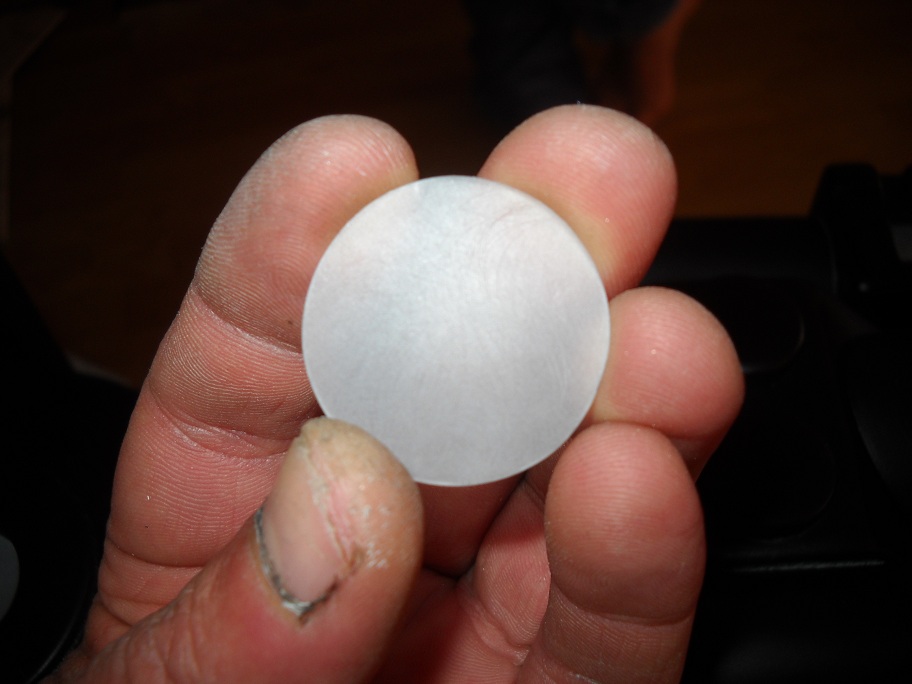

protongamer New Member Aug 28, 2015 #3 Ok, I post the building's pics. When I bought the proton pack(without electronics & proton wand), it was in bad condition. So it was the time to restore it. First I took off Proton pack's labels Second, I took off the rings(they was in cardboard), and I remade plastic rings.

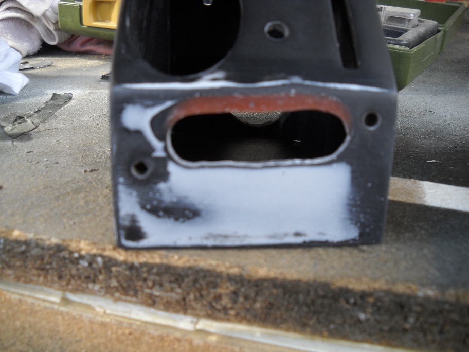

protongamer New Member Aug 28, 2015 #4 Well, Cyclotron's holes were too big, I finally put a wood plate and sealing plaster to stop up holes. When it dry, I sand down the sealing plaster.

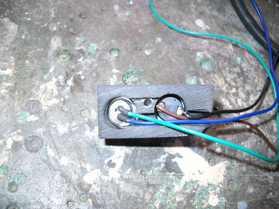

protongamer New Member Aug 28, 2015 #5 After that I put plastic rings and drill 4 holes. next I put polyester primer on the pack and I sand down it Between that, I started Arduino Electronics That was the power cell circuit. It was the sound font(Vs1053b of Adafruit) And the wand's bargraph

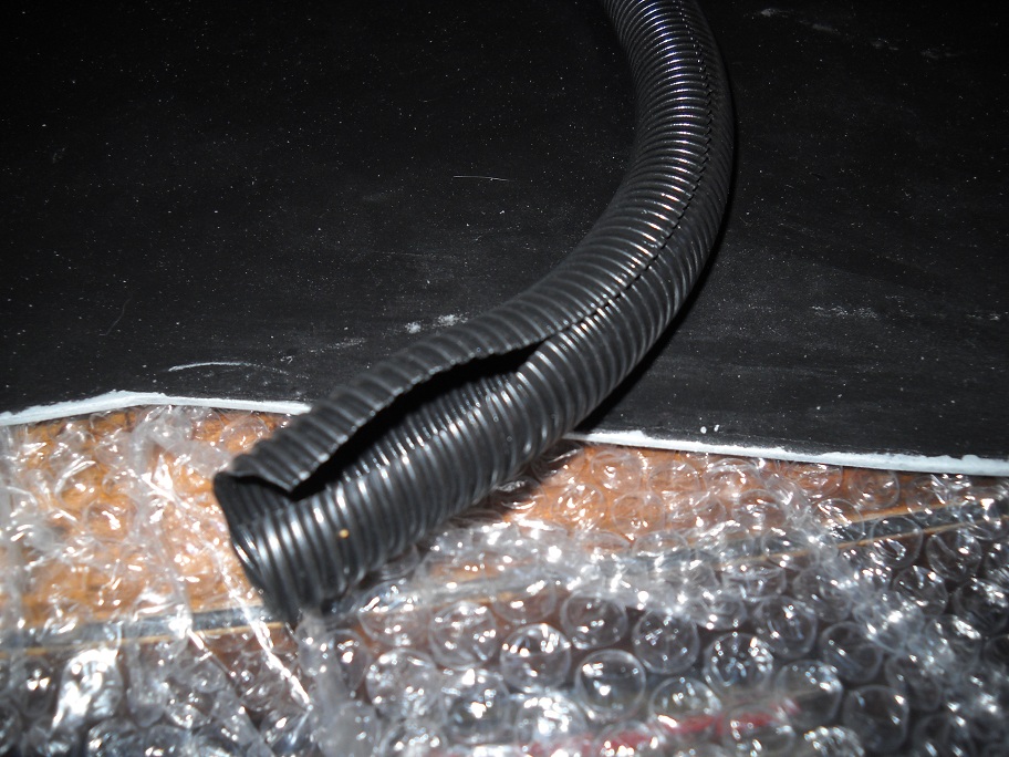

protongamer New Member Aug 28, 2015 #8 But it was not finished yet, i had to make the pipe it made with a rope, El wires, data wires(arduino to the wand) and hose plait View attachment 521012View attachment 521013View attachment 521014 Well and I finally put 3 Speakers on the motherboard View attachment 521016 View attachment 521017 And thought the Proton Pack was done View attachment 521018
