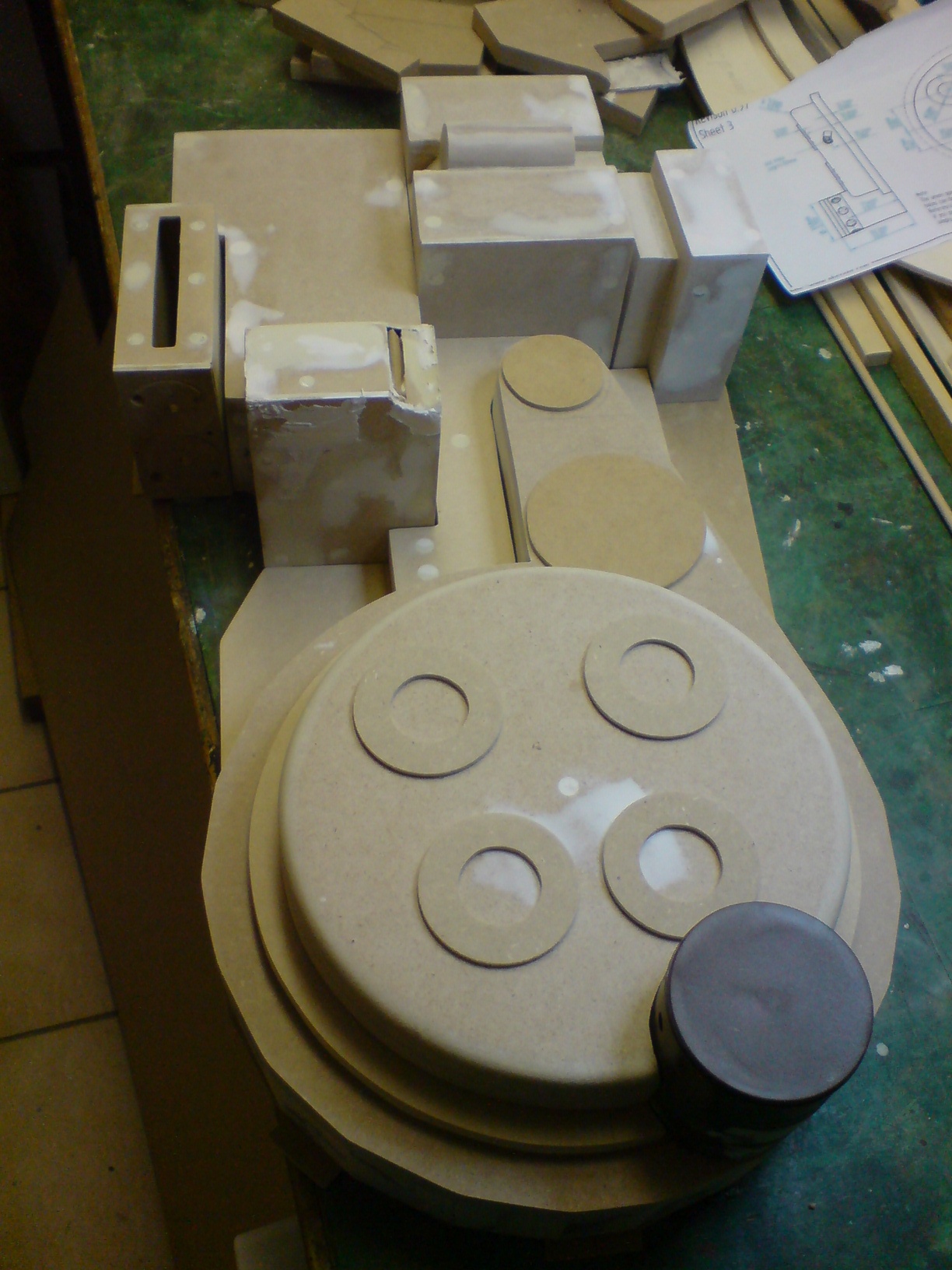

I just wanted to introduce you guys to my newest project. Some friends and I assembled GB-Costumes for Halloween four years ago and reviewing those pics I thought "Hey, why not reanimate the idea and go for a more screen accurate look this time?". Watch the pic and you will get my point...
So I started the project by registering to GBFans.com, studying screenshots and "Stefan's blueprints" and buying some light wood at the DIY-market. Until now it costed me about 25$ and circa 30 hours of work. Here are some progress shots...

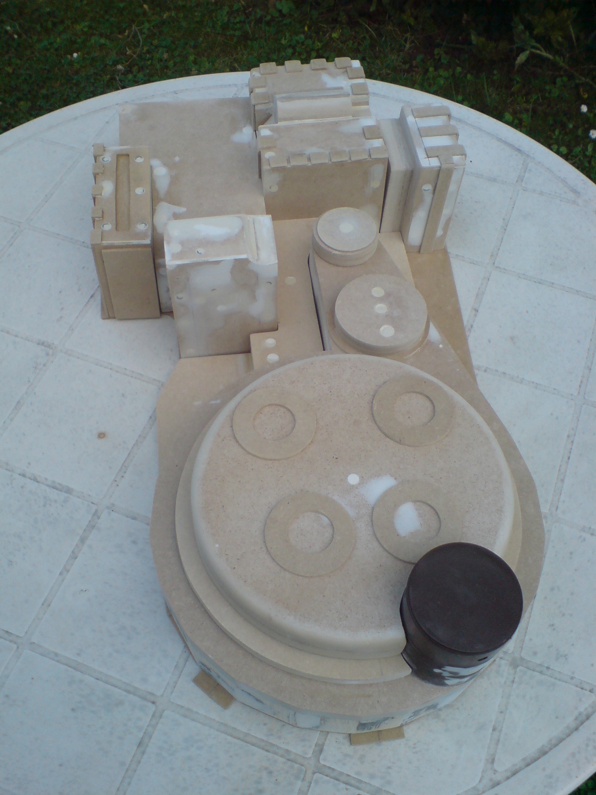

Here is a new picture. As you can see most of the simple parts are nearly finished. Next week I will start with the details:
As a matter of fact this baby weights a lot already and it is not nearly finished. So I'm beginning to think of ways to make it lighter... Any suggestions from your side? I thought about makeing molds for the separate boxes and casting them with a lighter material. What possibilities do I have concerning the casting material? I have to admit this is a new arena for me.

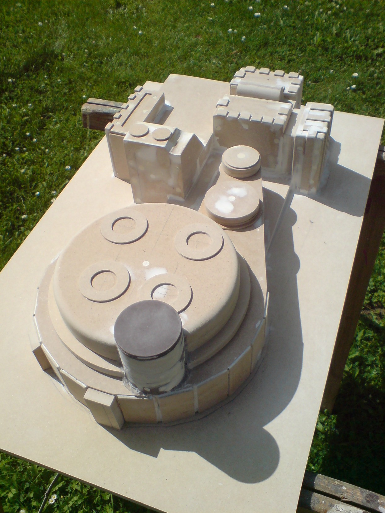

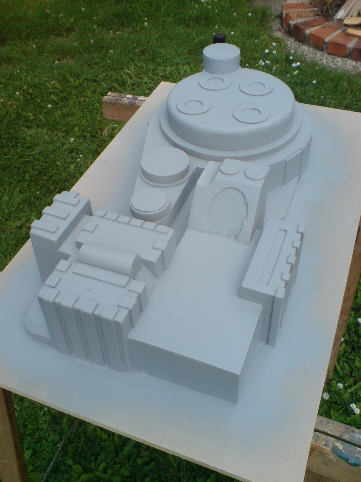

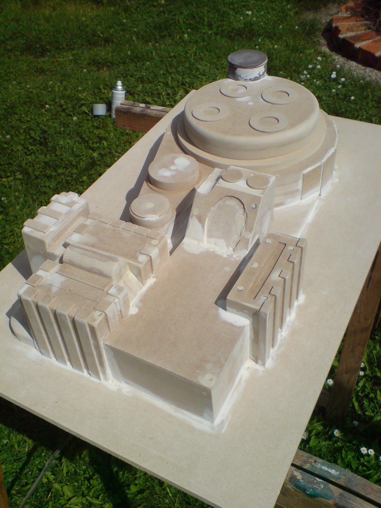

Yesterday I glued it on a stable board and filled all the gaps with putty. After a lot of sanding it looked like this:

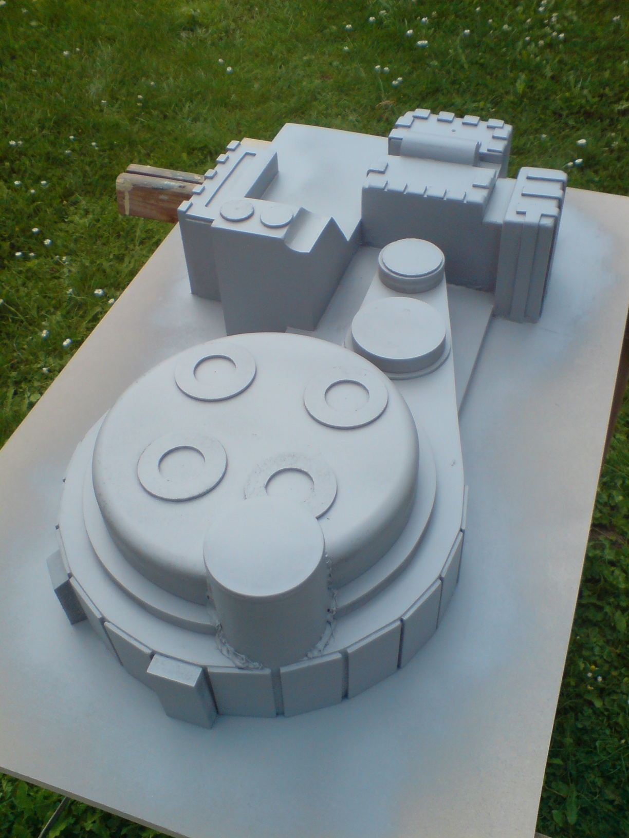

This morning I primed the whole thing:

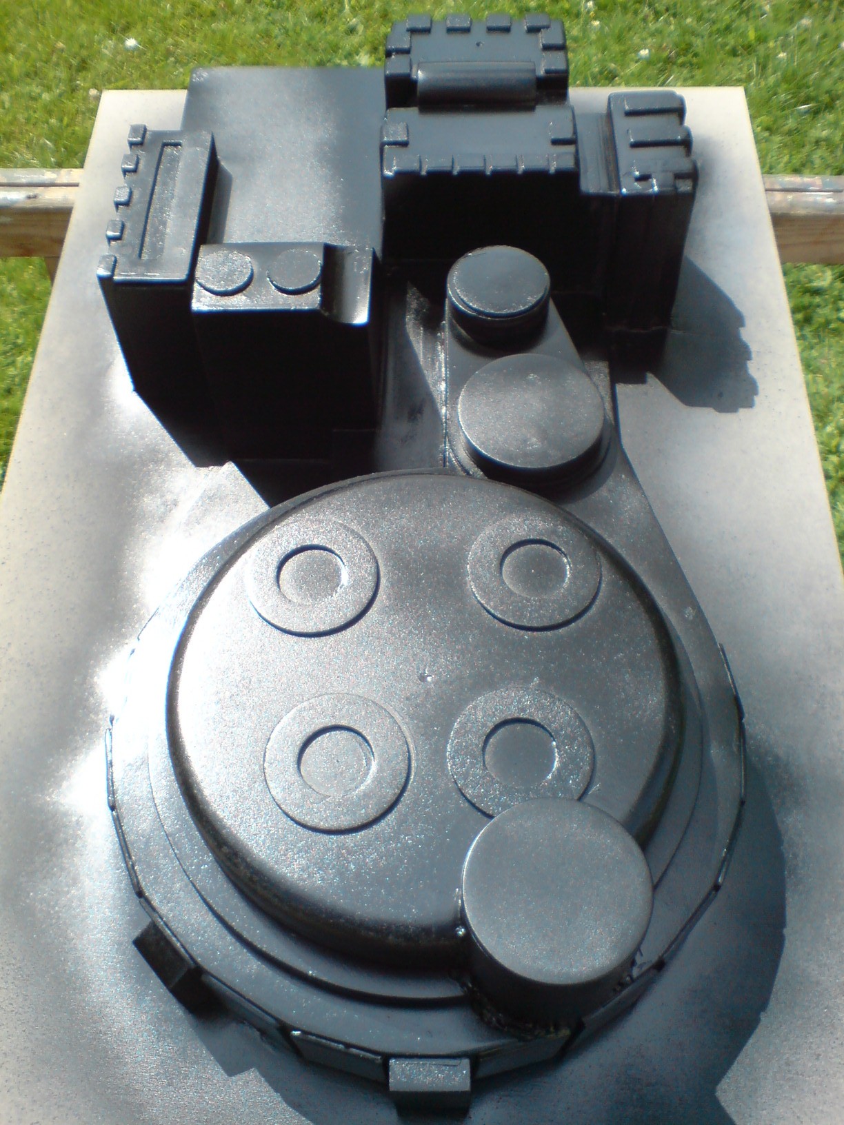

...last but not least I gave it a matte black finish just because I still had that can with black color staying around... I felt the urge to see my black protonpack master:
Now the construction is too heavy for me to carry during costuming events :lol That's why I'll create a mold. A resin/fiberglas-construction will be the way for me to go. Wish me luck :)

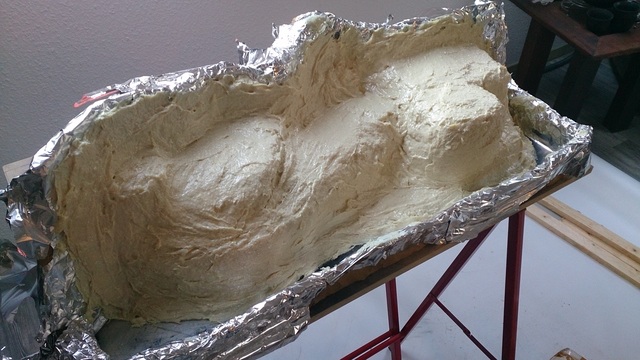

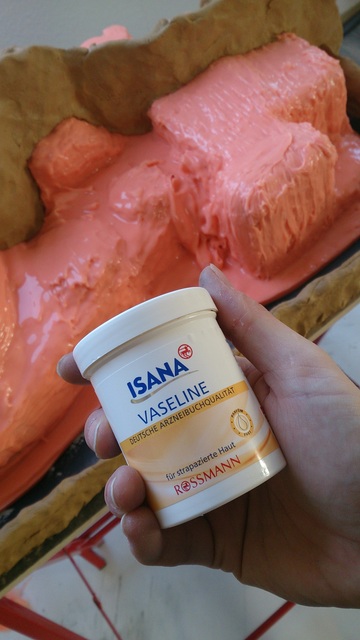

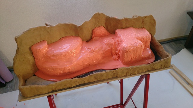

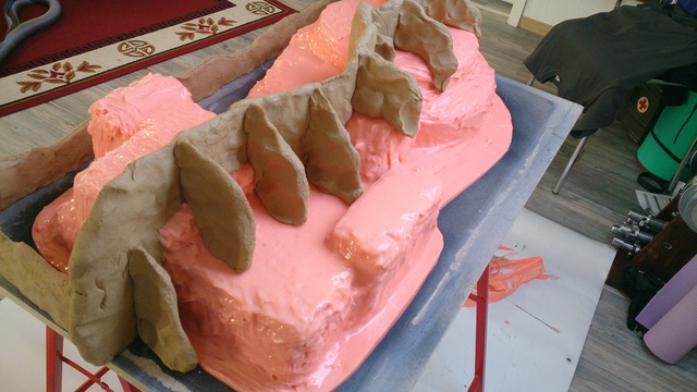

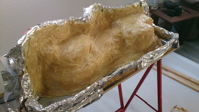

Today I built the support shell for the silicone:
I started by building a clay-wall. That way I can split the support shell into two parts later:
This wall was then covered with aluminum-foil. That way the fiberglas won't stick to the clay (hopefully...):

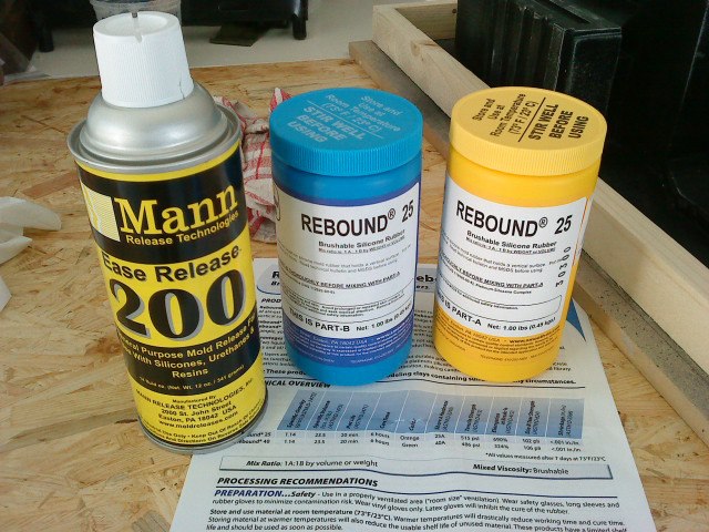

I covered the whole pack with vaseline and gave it a spraycoat with Ease Release 200. That way the support shell shouldn't give me a hard time coming off. We'll see tomorrow.

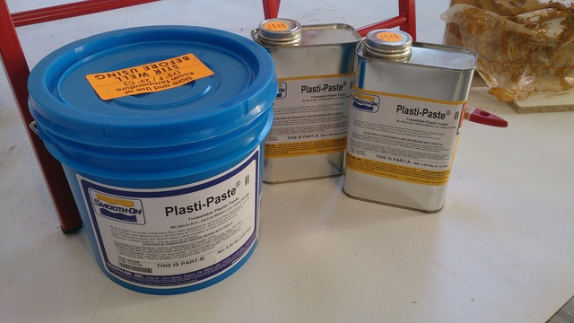

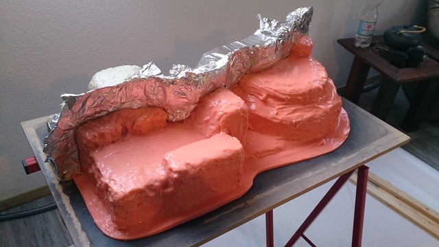

Then the chemistry started:
The product description said it would be ready for demolding 90 minutes later but it would take another 24 hours until totally cured. Since I am not in a hurry I decided to let it cure over night and check back tomorrow. I really hope it turns out the way I planned it. Fingers crossed :)
Wow, such familiar sights! I used the exact same molding materials on my shell mold. Hell of a project, isn't it? Looks like you're doing a great job so far. Making the first shell isn't easy unless you're very experienced with fiberglass (I wasn't) but the feeling of accomplishment is well worth it. Good luck and I looking forward to seeing more of your progress pics.

Thanks, man! This really pushes my self confidence :) I must say the choice of materials really didn't feel to bad. Everything was very easy to work with so far. Up to this point the project really is a lot of fun. Well, except for the one time I did not wear a long-sleeve and some hair on my arm came in contact with silicone. When I realized what had happened, the silicone was already cured (of course) and took me quite some time to get it off. Lesson learned, I guess :D

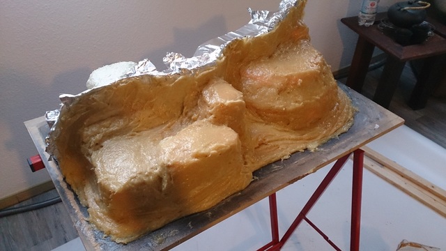

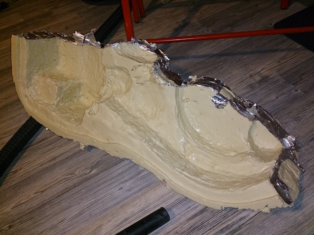

Small update. I took off the support shell:
Next step would be to clean all the edges of the support shell but since this is going to be a bit messy I decided to wait until tomorrow. That will also be the big day for the silicone-mold to come off the pack. More soon.
