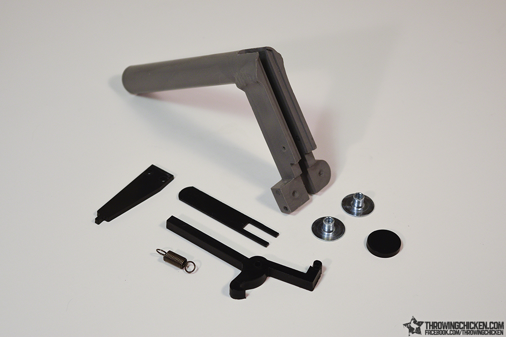

The trap handle is resin cast using TASK performance plastic for added durability. The lever used to release the spring-loaded cartridge is laser cut out of ¼” Delrin, which then sits within the slot carved out the front of the handle. A cover is included, which is to be glued down over the slot and the seam filled to hide it completely. All hardware to mount the handle is included, as well as the spring system for the lever.

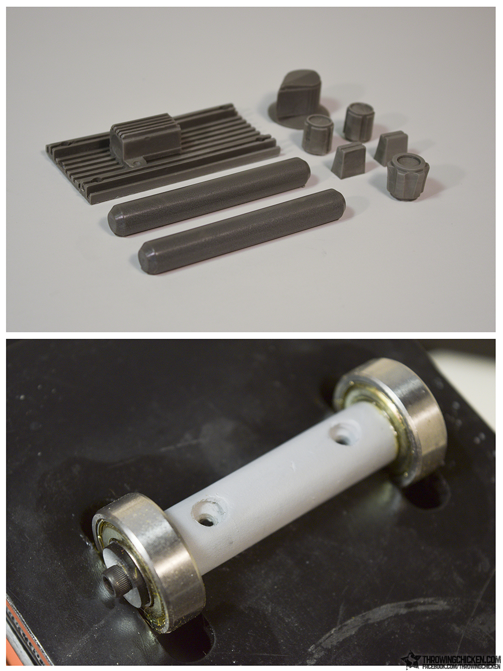

The kit includes resin cast versions of the vector plate, resistor, side rods, and all the knobs, as well as axles for the wheels and the bearings. Do note: These are not the final versions.

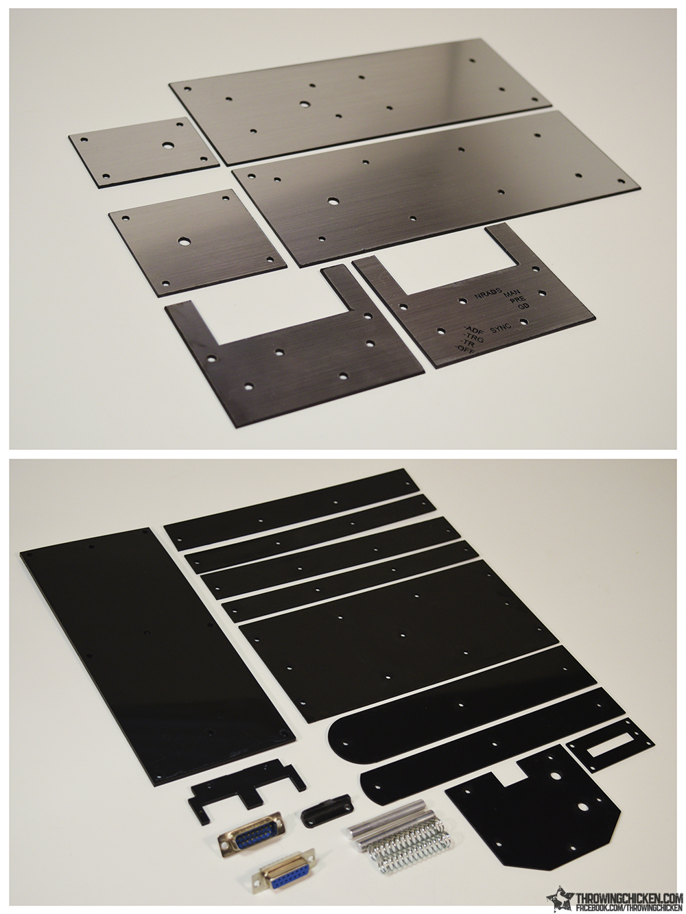

The kit also includes all the side plates laser cut out of faux-aluminum ABS, as well as all the plates needed for the cartridge slide system, servo mounts, battery compartment cover, and instrument panel cover. Also pictured here are the serial ports, springs and ¼” rods for the ejection system, and the catch for the latch. Note: The front aluminum plate comes blank by default (GB1 version), but is also available with engravings around the dials (GB2 version). The engraving will the black, but can be painted in red.
