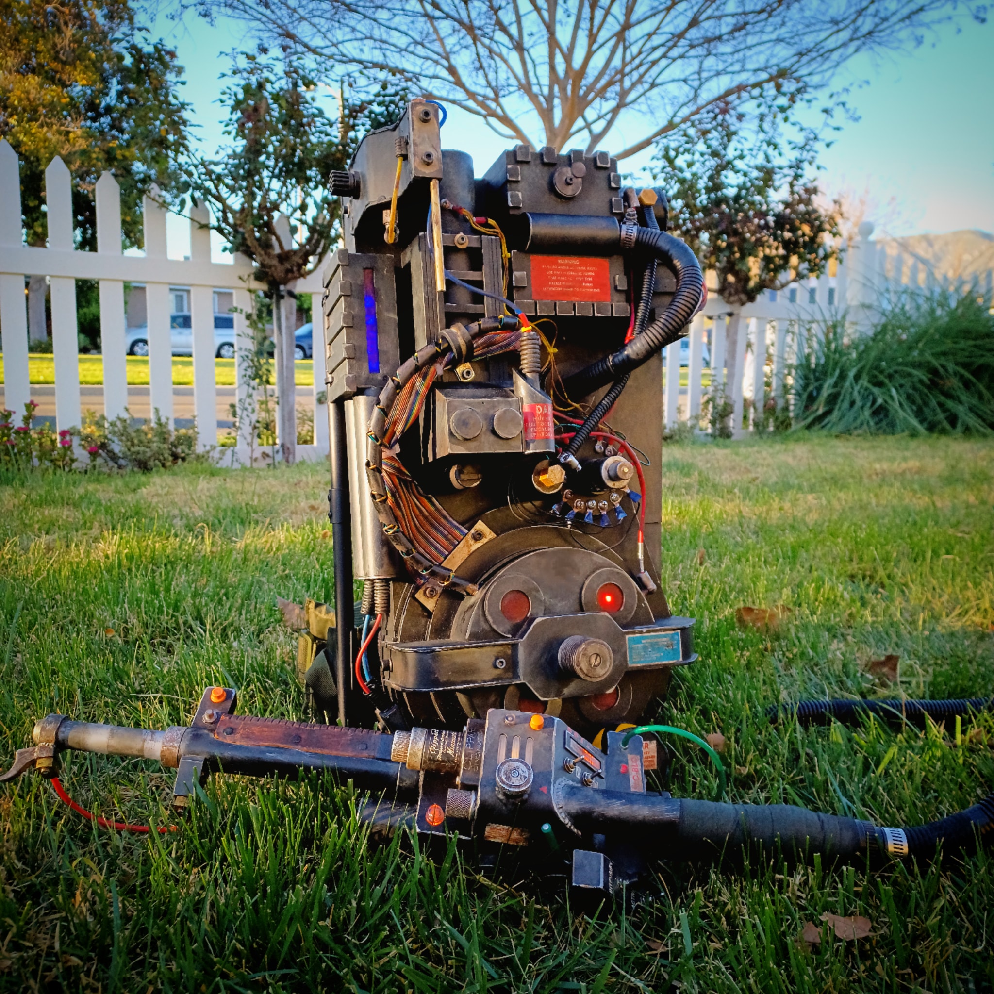

Ok, so I got bored, and decided to add the rest of the main elements seen on Phoebe's pack in Afterlife.
Used some old co-axial cable, with some spare yellow and green wire coiled around as the base for the new tube seen coming out of the cyclotron. Wrapped that in some spiral cable covering, and attached it to the pack! A few small holes (and some minor electronic speed bumps) later, and I think it really helps the overall look!
I also fixed the weathering to make it look like this thing had been sitting in a barn for a couple years. Just a bit of lightly dry-brushed tan, burnt sienna and black paint in the right areas!
Gonna try and speed up the Arduino code for cyclotron lights, if I can figure out how to do that without affecting the power cell speed. If anyone has worked with the code from the tutorial by Amanda's Prop Shop on YouTube, any help would be appreciated!

Here's some photos of the finished Afterlife mods I made to my Spirit pack!
DUDE! This puts my pack to shame! Since I posted this, I've made some minor updates to my pack, namely replacing the subpar ribbon cable with vintage Spectra Strip. I still need to add the tube that comes out of the attenuator into the booster tube.
