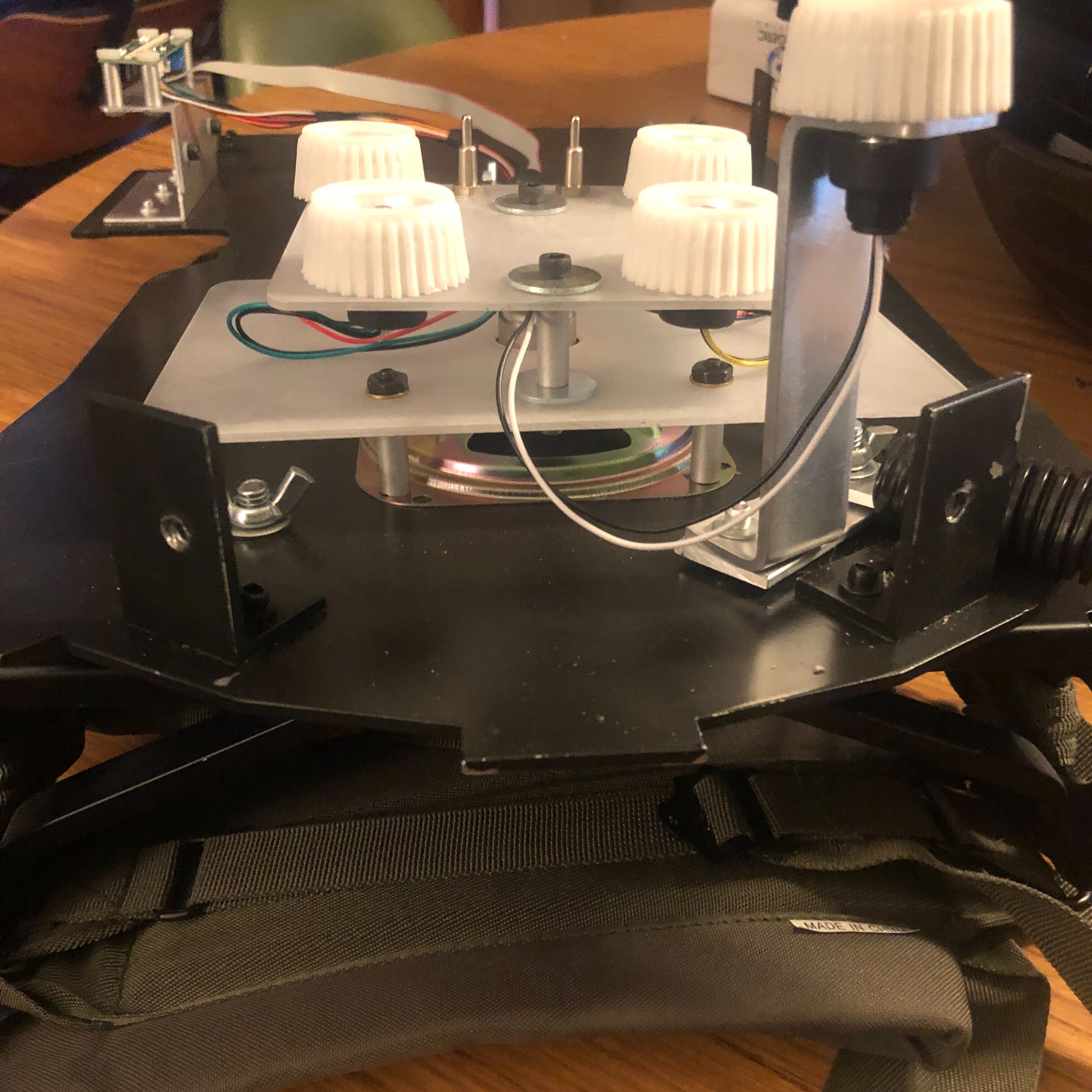

I have my shell completed. I have my metal Motherboard. How do I connect the two? I have looked at using angle "L" shaped brackets, but after I connected them to the metal board, I can't figure out how to connect them to the shell and still have access when I need it?

sorry these are so dark, but i think you will get the picture

These are awesome pictures and thank you for the response. So you don't need a nut or bolt on the other end of the screw? Does the pack then just stay "on" or connected through the friction of the screws in each bracket then?
pchrisbosh1
Attaching motherboard to pack shell w/pics - GBFans.com This Tutorial by Kind2311 will help you also. 4 L brackets in the correct locations one side on all four brackets is riveted to the aluminum motherboard with two pop rivets each and then drill and tap 1/4-20 once in each bracket for the shell to attach to using 1/4-20 socket cap screws....no need to bolt as the L-Bracket acts as the bolt since it's tapped. Follow the tutorial to your liking and you should be good to go!
