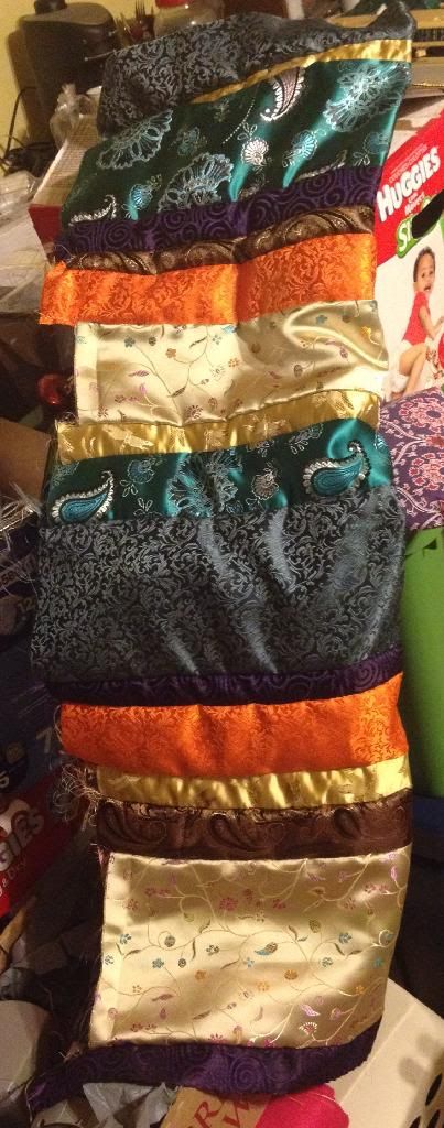

Project #1 is a 4th Doctor scarf, but my own spin on it - making it from strips of embroidered silks instead of knitting it. So it'll be a totally girled-up 4th Doctor costume. I'm thinking of using my semi-shiny brown rain jacket in place of the frock coat, and I already have grey pants and white shirt, so once the scarf is done, I just need a waistcoat (vest) and cravat. Oh, and an "Indy" hat (brown fedora, but since I live near Disneyland, the easiest one to acquire will be the Indy one)
Anyway, I'm about 1/3 of the way through the scarf, so here it is:
(note it's folded to give an idea of final width, actual width is 22"+, depending on the color. I made a point of lining up properly on one side so all the unevenness is on the other, which will make truing it up easier later)
I'm using the "Inches" directions on Doctor Who Scarf, for those who are looking for a guide. (It also has knitting guides, but obviously I'm working with fabrics here so I needed dimensions, not stitches and rows).

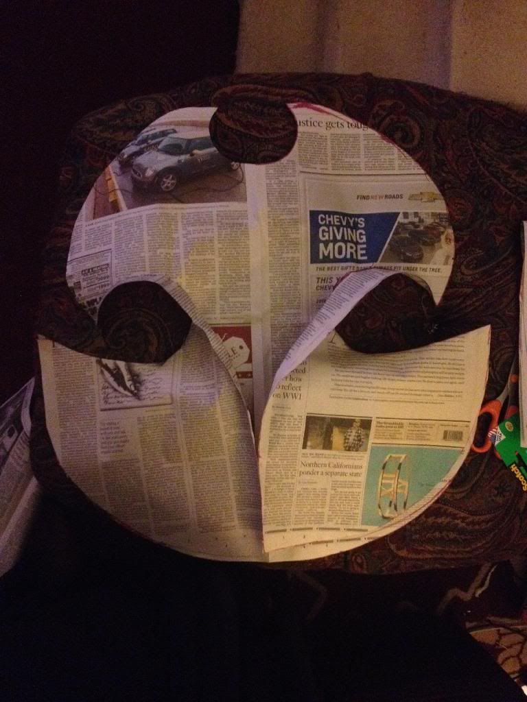

So somewhere around the third(!) iteration of the front shoulder piece, I realized I was totally justified in doing a paper mockup instead of a cloth one. #2 is on the left, #3 on the right. I think I still need to increase that outer curve and open up the inner curve a bit, as the back piece needs to lay flat, or even bend back a bit to allow my head to move.
Now the question is... final material? I considered buckram, but I don't have time to get downtown to the only place I know that carries it any more (technically I haven't tried our new Hobby Lobby because I won't step foot in the place, but let's assume they'd fail me too). I'm considering sticking with newsprint and laminating a few layers of it together with mod podge. But will that get me the smooth-ish paintable surface I'm looking for? Suggestions?

Things aren't going so hot on the headdress, so I've left off that for the time being. I may end up wiring the craft foam and painting over it, and just hope it doesn't look too bad. Was trying to do a paper mache, but mmmm.... it's having all the problems you'd anticipate with paper mache.

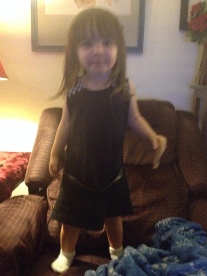

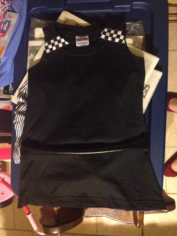

However, tonight I threw all that off to work on something "easy." My 2 y/o's "KissOGram Amy Pond" costume. I decided to dispense with the separate vest (because dressing a toddler is hard enough, thanks), and do the outfit as a single dress. I picked up a youth small t-shirt, which comes about to her knees, and then cut it down to shape. I gave the skirt a slight flare rather than a taper so it'll go smoother over her diaper.
For the "belt" I found some stretchy pleather fabric at Walmart that I decided to go with because I planned to sew the belt directly onto the dress and I wanted it to have as much give as the t-shirt knit. In reality, I ended up sewing the pleather into a tube, turned it (PITA!) and only stitched it to the dress at the hips. Fingers crossed that this works and my placement was right because I can only sew when she's asleep so I had no model to try it on. Also, I only went with the belt on the front side, saving having to match it up at the side seams, and because she'll be sitting in a stroller much of the time.
Found some checkerboard fabric for the shoulder stripes (and eventually the cravat, which I'll probably just attach to the collar of the dress, or at worst, pin to whatever shirt I put her in). For the shoulder stripes, I cut strips 3 rows wide, plus half a row on either side for stitching. This is where I got a little stupid fussy... I stitched right down the outer line of the three row wide section, trimmed it close (so SO close), then followed that up with a tight zigzag stitch to cover the extra.
I simply turned the armholes to the inside and stitched, no facings there.
KissOGram Amy Pond 01.jpg Reference: 2225075cc86a74479ef2eed8a680413e.jpg

Here's the KissOGram Amy Pond on, and the inspiration image I'll be using to finish the back of the dress.

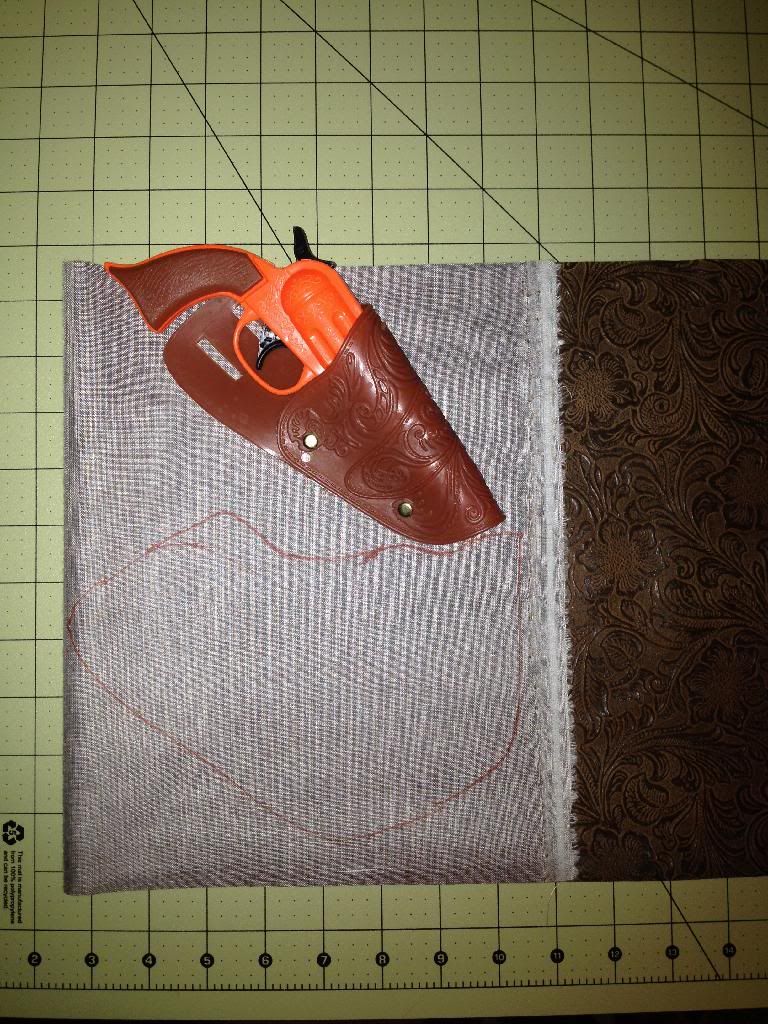

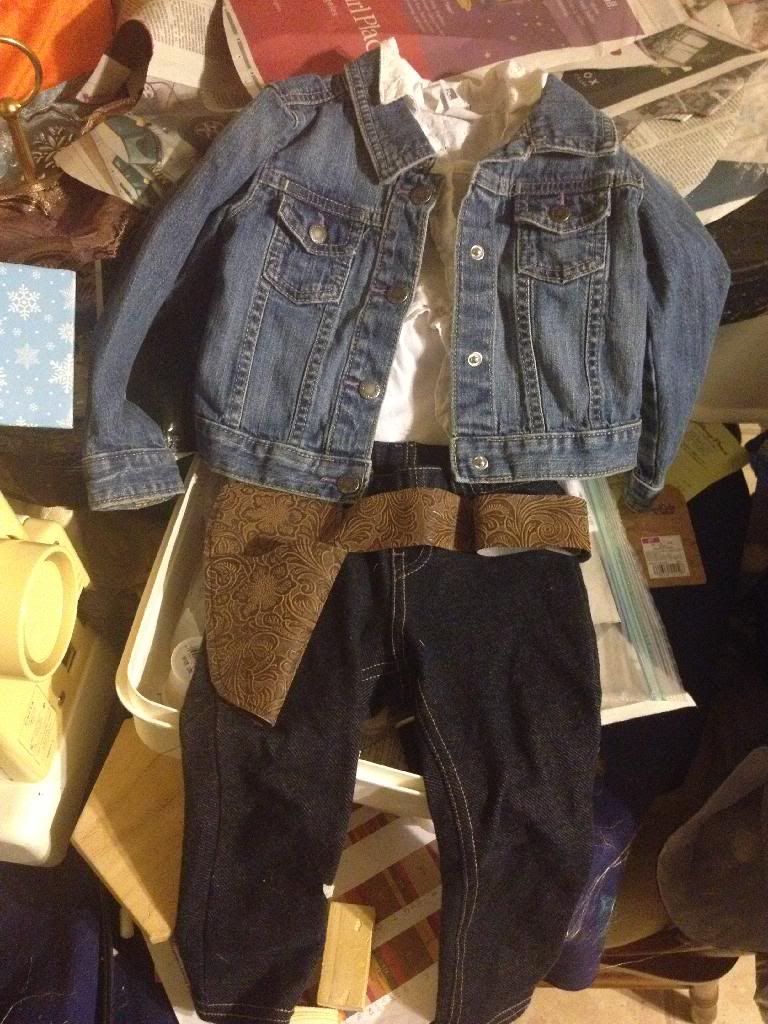

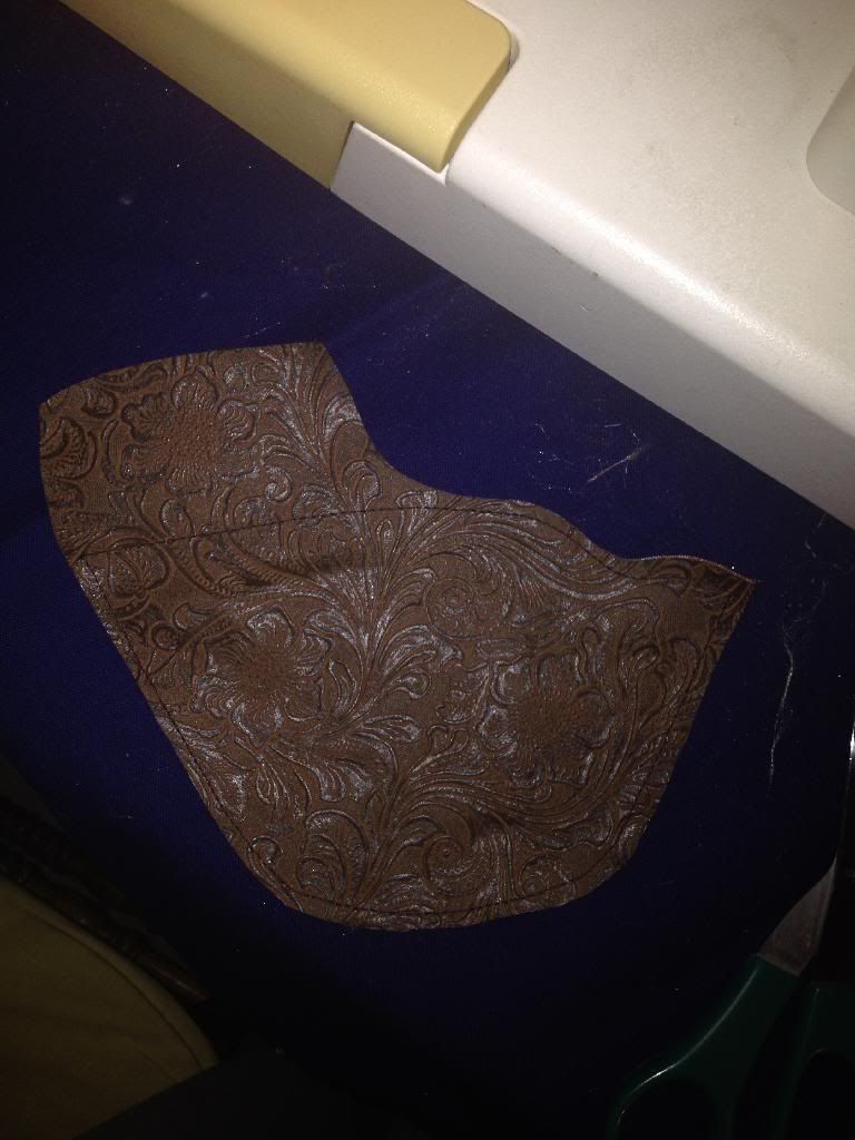

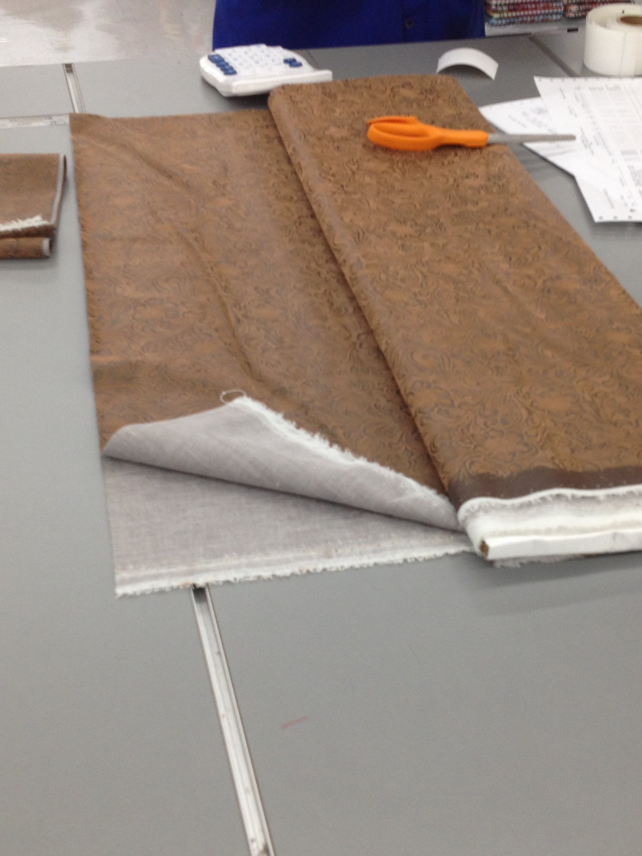

Just a few minutes after purchasing a cheesy plastic holster (no belt!) and toy gun at the dollar store, I ended up finding the perfect material to make her River Song "Impossible Astronaut" gun belt (and holster, because... cosplay).
Oh dear, the photo came out sideways, but you get the idea. It's fabric that resembles a highly detailed tooled leather, but the lady was able to tear it at the cutting table, so my regular machine should be able to handle it. $8/yd, but I only needed 1/4 yard of it.

The scarf is about 5/8 done... (Did I mention there are *53* strips of fabric in that thing?) I can't wait to upload a picture of the finished scarf!

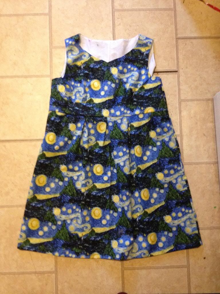

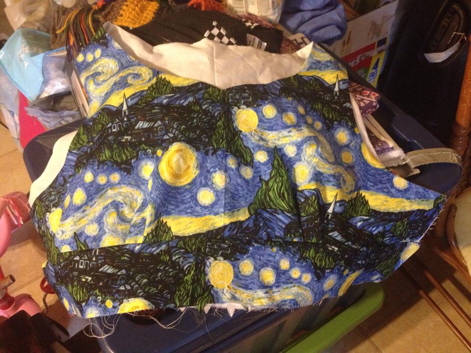

I also did some more work on the Van Gogh dress. Still have to do the skirt part, but the bodice is nearly complete now:

I have all but finished the Van Gogh Starry Night (aka exploding TARDIS) dress (skipping the zipper for now and basted it shut, have to finish half the hem from when my bobbin ran out).

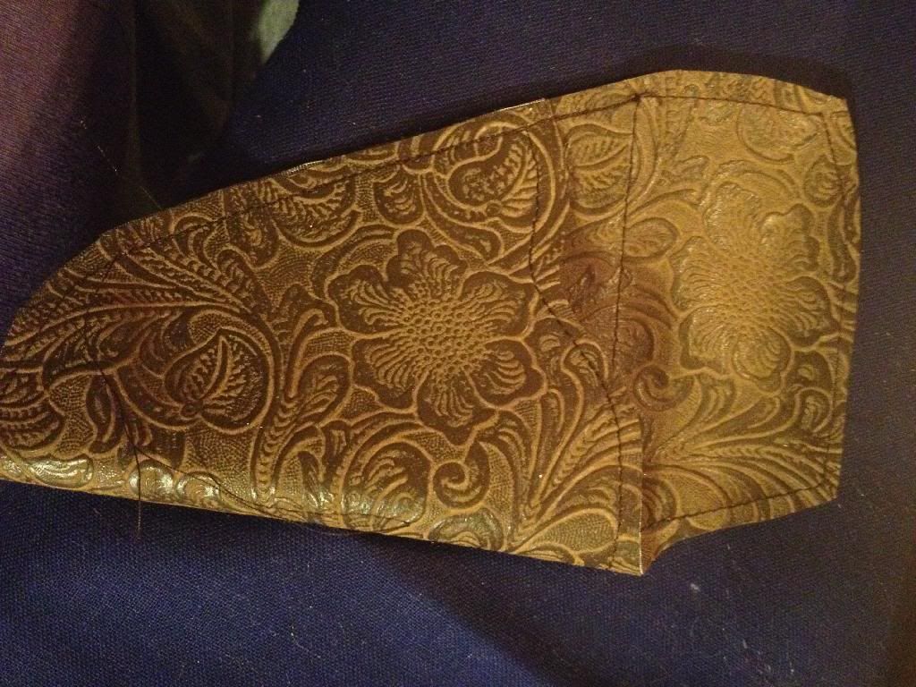

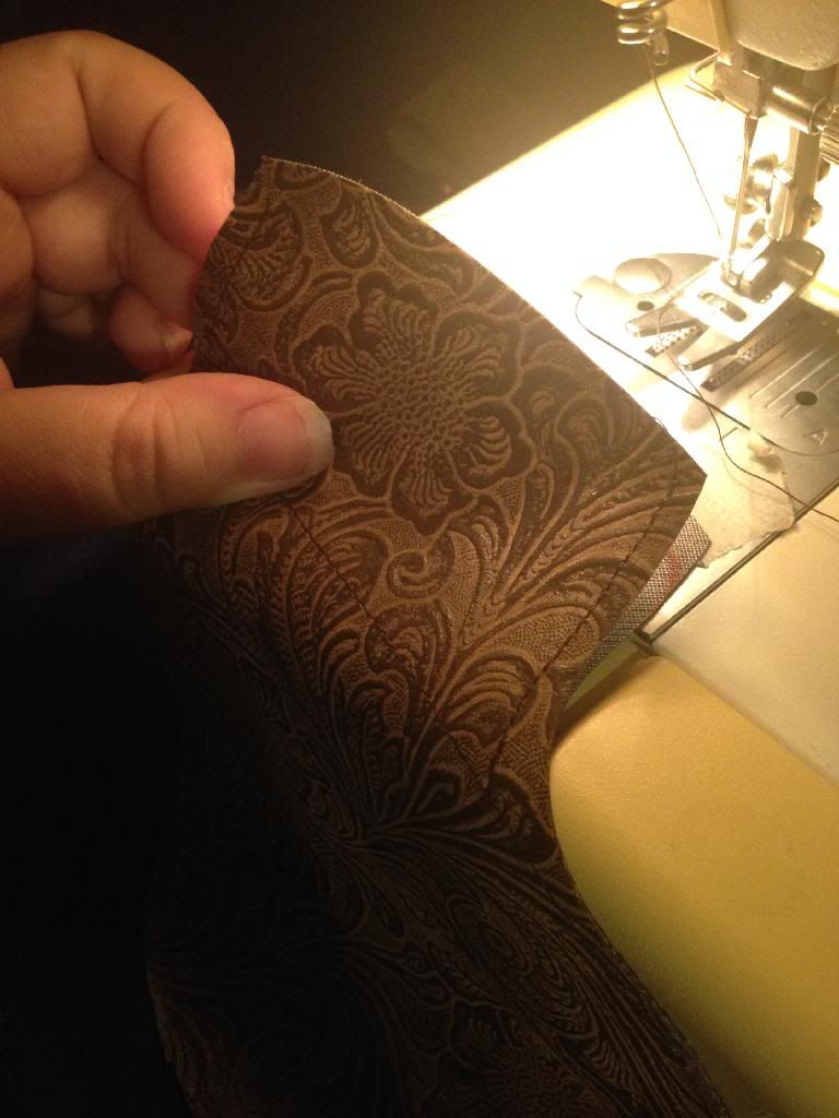

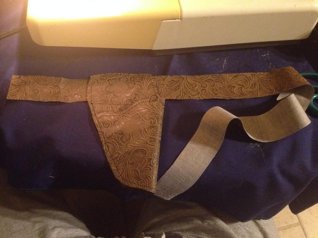

Since my black bobbin thread was wound over my dark brown, I promised myself the next time the black ran out, I'd switch over and do the western-style River Song gun holster ("Impossible Astronaut"). Now mind you, I'll be going as Amy Pond, and my 2-year old will actually be River Song, just to give you an idea of scale here. First, I had purchased a cheapy plastic gun and holster from the 99-cent store, and used that as my pattern, though I adjusted the top to be slightly higher. Because of the way it rolls over itself, I knew I had to do this as a double layer, so I decided to make the whole top of it a channel through which I would string the "belt". Below you can see the pattern drawn on the wrong side of the faux tooled leather fabric. I simply traced the outer edge with a sharpie, then rolled the holster over to finish the other side.
I didn't want a lot of shifting as I stitched, and pinning was likely to lead to a lot of distortion (and potentially holes, though after pinning the belt for sizing I found the holes disappeared reasonably well), so I took some tacky glue and very lightly glued both sides together (avoiding the top area), then I stitched around the edge of the same area.
This stuff doesn't fray, so those really are raw edges. Much like real leather, it looks fine that way.
I wanted to continue the look of the stitching up into the belt channel, so I separated the two pieces at the top, and stitched up each side just through the top layer. I could have done it all in one go, but that would have meant a second line of stitching across the top.
Being careful to place the needle right back into the previous stitching line, I was able to keep a consistent stitch all the way around. The final step was to fold the right side over the left and stitch it down. Here is the final holster:
I briefly strung it on (the wrong end of) the belt strip just to make sure it fit and see how it would look

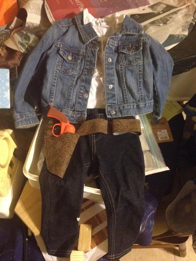

And here is the final costume with and without the toy gun in the holster. The jury is still out on how I will have her wear it... the costumer in me wants to paint the toy silver and stick it in the holster, but the mommy in me is thinking she can wear the holster empty. Opinions? I'm leaning toward empty holster unless talked out of it with a really good argument. But ooh, it does look cool!
The jacket I ended up finding is a bit on the light side compared to the real thing. (Realizing now that I'm pulling up the inspiration photo that the holster could have been done a bit different, but eh, too much length would practically drag on the floor. I have to consider the wearer.) I plan to dig through all her jean-like pants to see if I can find a pair with a lighter wash, so the jacket's lightness will be less obvious/contrasting.

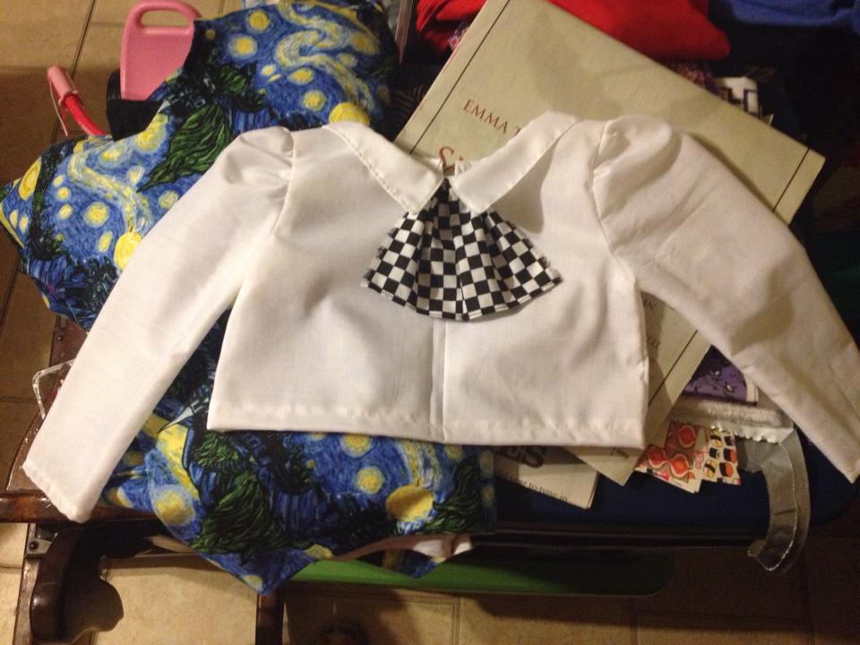

Because of entering the costume for judging, I decided not to use a purchased long sleeve t-shirt underneath, so Friday night I whipped up a little middy blouse in the space of about 2 hours. So here's that:
