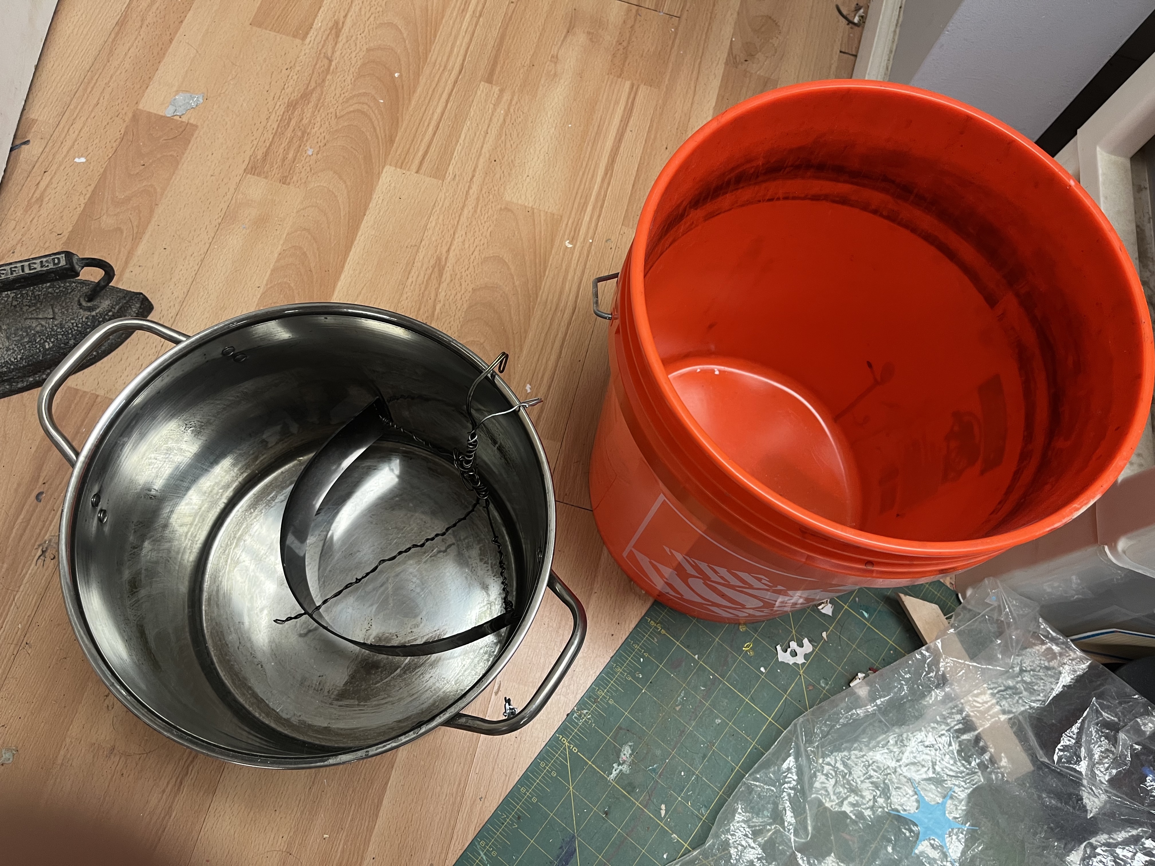

I've been using iDye Poly for visors. It works OK but I always have problems getting an even tint. Will try the tail light tint next time.
The problem I've heard with VHT is that it blocks light a little too well, to the point where it diminishes the look of the lights on the inside. I'd prefer dip dyeing it, as then its a lot easier to 1. Get an even finish, and 2. Control the darkness of the visor. I do have a can of VHT that's been left untouched because I'm a little apprehensive to trust my spray painting skills to be smooth on a visor, where mistakes are quite visible and replacements are $50.
Both great tutorials on how to dye petg plastic visors with Idye Poly. I have tinted my thomas helmet visor and with help from a member from the daft club was able to do with good results and think this is the one you must have sawn on the daft club regarding the Green and Black dye.
You can use RIT Black dye, I didn't for my visor since my buddy suggested instead you want to use Jacquard Idye Poly Black and Dark green dyes. That will help with making the visor less red and more darker overall. I used 4 packets 2 black and 2 green. I can't remember all the details he told me, but I know I have it somewhere. Let me see if I can find the info he told me and Ill summarize on here.
Found the info Still working on writing up the details and will post them here when Im done summarizing them
Alrighty sorry about the wait, but heres the instructions i was told for the process by my buddy, He's also on the forum. Hope this helps!
