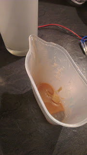

well here goes i started by taking a copy of my finger with a skin safe no water based silicone, you have about 5 minute work time with this so no need to rush just make sure you have a go coverage and no air bubbles....it will be set after 30 mins depending on which silicone you use, then i removed it from my thumb, i also did one of my finger as well.
i melted one block or cube of 300 bloom fx gelatine i got mine from mouldlife, but ive found what looks like a better gelatine from a company called nimbus creations which comes pre coloured in flesh which will make colouring easier next time.
with one block melt it in the microwave in small bursts of 5 seconds and stir each time. dont let it boil.
once melted and coloured , which after a few failed starts i found that liquid foundation and food
colouring is the best way to go i poured the gelatine in the mould then poured it back out to to make sure it gets a nice first detail layer......check for air bubbles then pour the rest back in.
i then stood it up in the freezer for 30 mins to speed up the setting and cooling time once out of the freezer let it warm to room temperature squeezing the mould gently and slowly pull out the finger and its ready for painting as bellow
