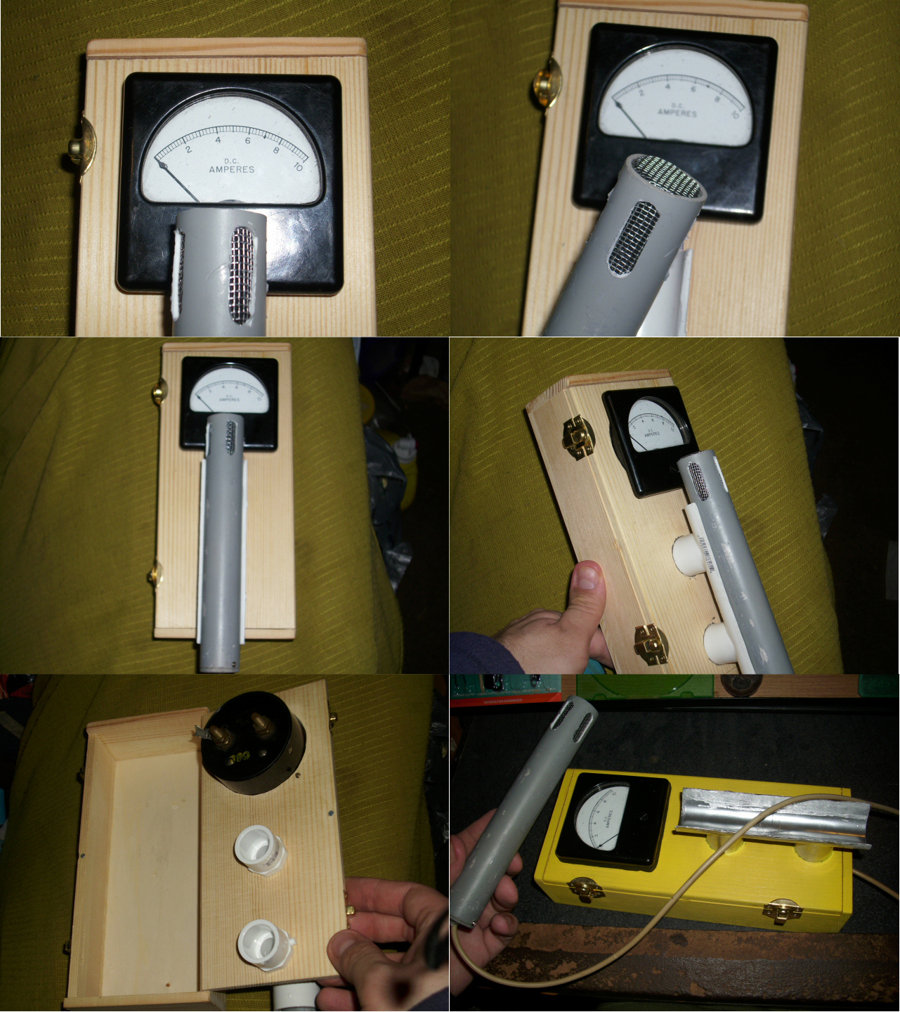

I need help on making a Geiger Counter prop like this.
I'm making this prop for my brothers Hazmat Halloween Costume.
It has to have a detachable microphone like tube from the handle. The Box can be plastic or metal, (cheaper if its plastic.) I looked for waterproof storage boxes but couldn't find the right type.

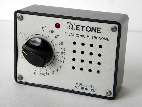

As for the sound & dile, I thought of using a Electronic Metronome Model 23F.
It has a speed dile, light indicator, & speaker with a clicking sound. I need to know if I can attach it some way to the dile, (what type of dile I don't know, maybe to a volt meter dial.)

Depending on time and money, you could pick a broken one up off evil Bay. Than add a gift card recorder, for different click sounds.
PVC pipe for the microphone like sensor & the box handle / sensor rest. Hobby Lobby Box, 9.25 in. x 4.25 in x 2.17 in.10 Amperes Volt, guage, dial whatever the name is.The grid for the sensor is plastic screen door, painted chrome & held in place with a wood dowel coved in electric tape.I cut the screen into a X to fit in the tube.

Is their anyone here good with electronic circuitry?
I bought a metronome off ebay for the Geiger counters clicking effect but, it's to slow & need help on what circuit to replace to make faster.
It's a simple circuit. (I'm reading the labels on the circuit at this time, I know nothing of electronics.)
It's 9v circuit that uses two pn 2907 transistors, (I think), a 10v 470uf capacitor, a 10v 33uf capacitor, (let me know if I get the names wrong), an on/off 10a 1000k ohm potentiometer, & a 8 ohm 0.2w speaker & red led, (I don't know the voltage on the LED).
You can lower the resistance or the 33uF capactior (assuming it is connected directly to said resistor).
See the link below on how simple metronome circuits work.
