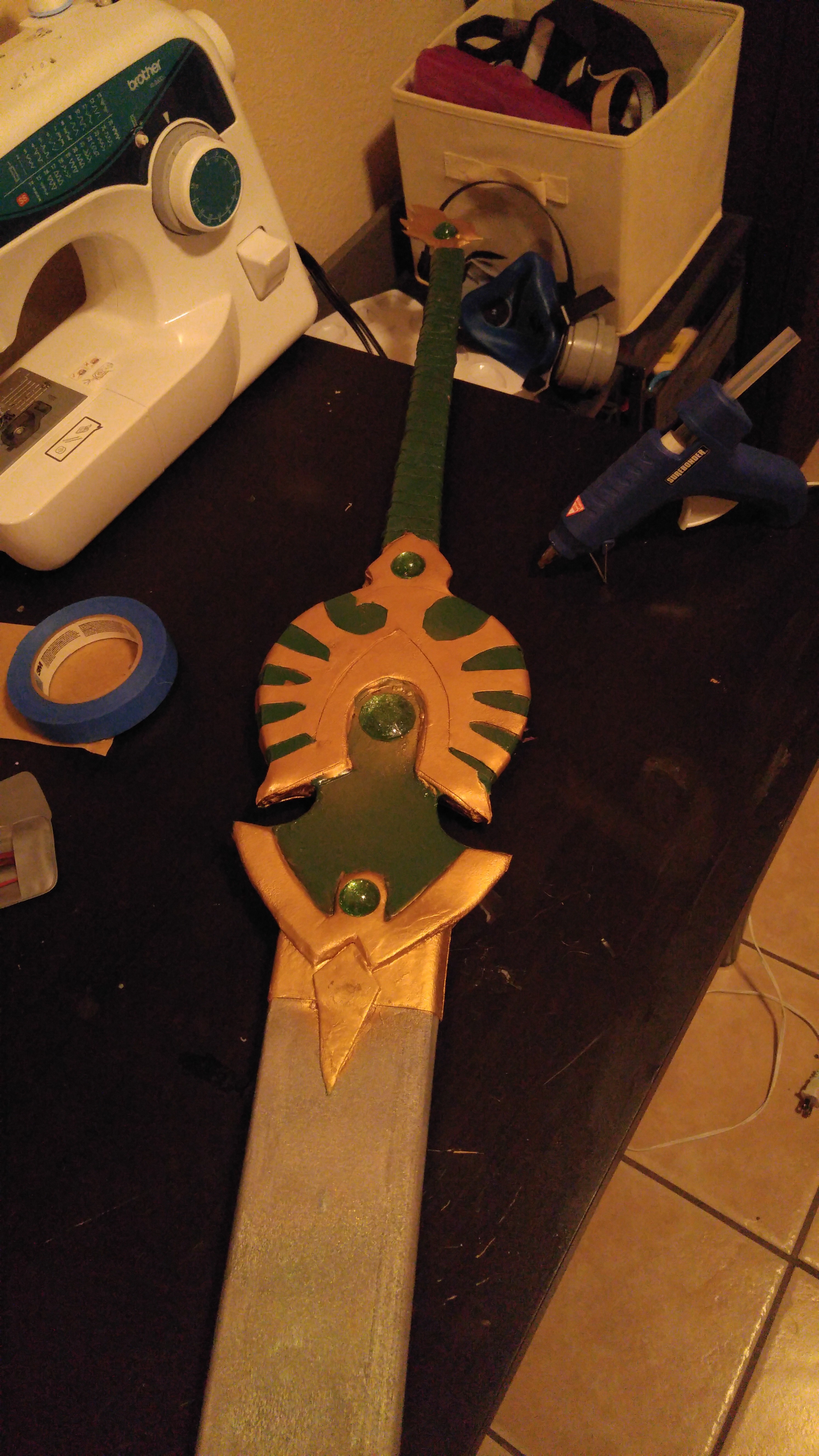

With everything complete I finally moved on to planning my sword. I started with insulation foam, a dowell rod and some carving. That failed. So then on moved on to cutting the ENTIRE sword out of insulation foam. To stabilize the hilt/handle/pommel I cut out pieces of Worbla and laid them VERY carefully onto the insulation foam (insulation foam is not heat graded - it deteriorates when extreme heat, like a heat gun, or paint is applied to it so BE CAREFUL). Some of the foam collapsed under the heat however; the Worbla was pliable enough and hard enough to accommodate this collapse, allowing me to hide the defect. I also used some Worbla to stabilize where the hilt and blade connected. The blade itself is just insulation foam. I intend to cover it in thermoplastic in the future but it held up really well at the convention I went to (NOTE: it wobbles so take care when posing that you do not put too much weight on it or it will bow). Another NOTE: Insulation foam caves under spray paint. If you choose to use this material be sure you paint it with a wood glue/acrylic mixture (one part wood glue, one part acrylic). The final result was most satisfying considering I had to remake this in under 10 hours the day before the event.
