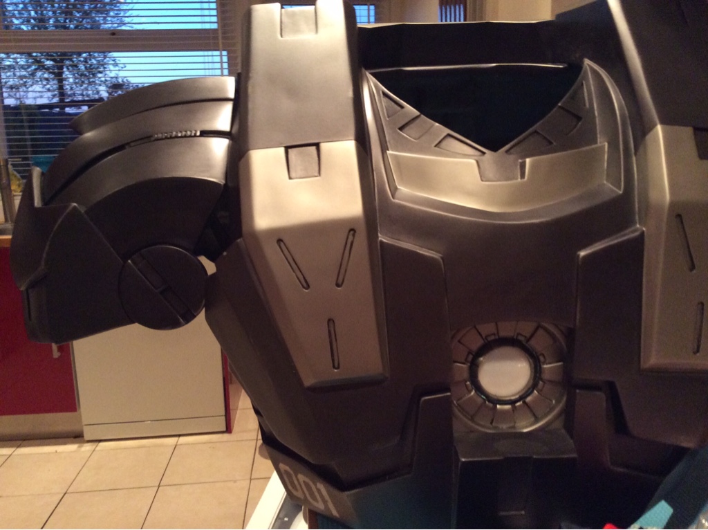

Little update now, but full one coming this weekend.
Shoulders attached.
Leg hinges made and ready to be attached.

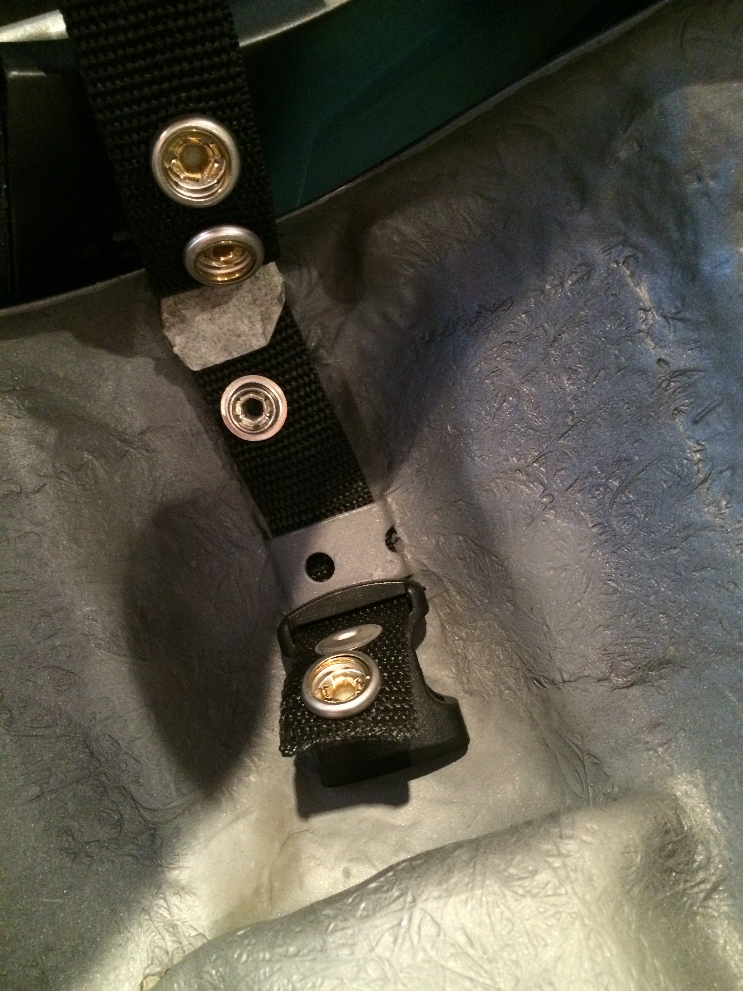

Bit more involved.
I'm taking all of RoboSteve's advice here and making this as wearable for events as possible.
That means comfort, mobility and then transportation and storage.
The idea is to have the arms and shoulders all attached to the chest, so that takes the weight
The first step was holding the shoulders up and marking onto the chest where the slit made by Leslee is
then a quick dremel and we have a slit for some webbing/strapping to go through

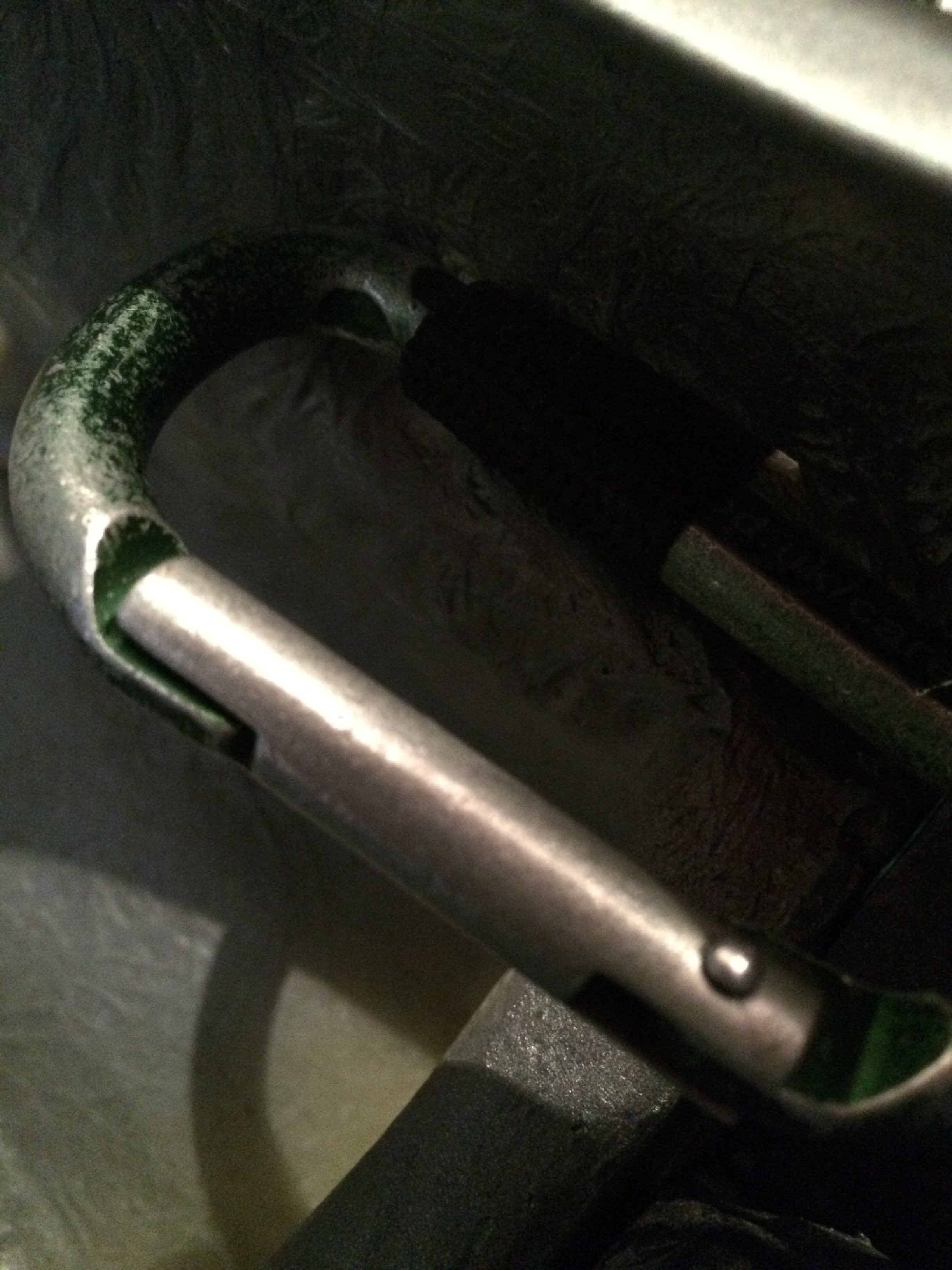

Then the idea is to have a piece of strapping that is secured inside the chest, holds the shoulder on and also has a point of attachment for the upper and lower arms
So, loop a piece of strapping though, then under the bracket on the shoulder, through a female clip and then secured by a snap.
then this loops around a carabiner, back onto the shoulder and onto a snap.
This is a bit of trial and error to get the snaps in the right place, but once done the shoulders are pretty secure, have some movement in them and there's only a small gap visible at the top

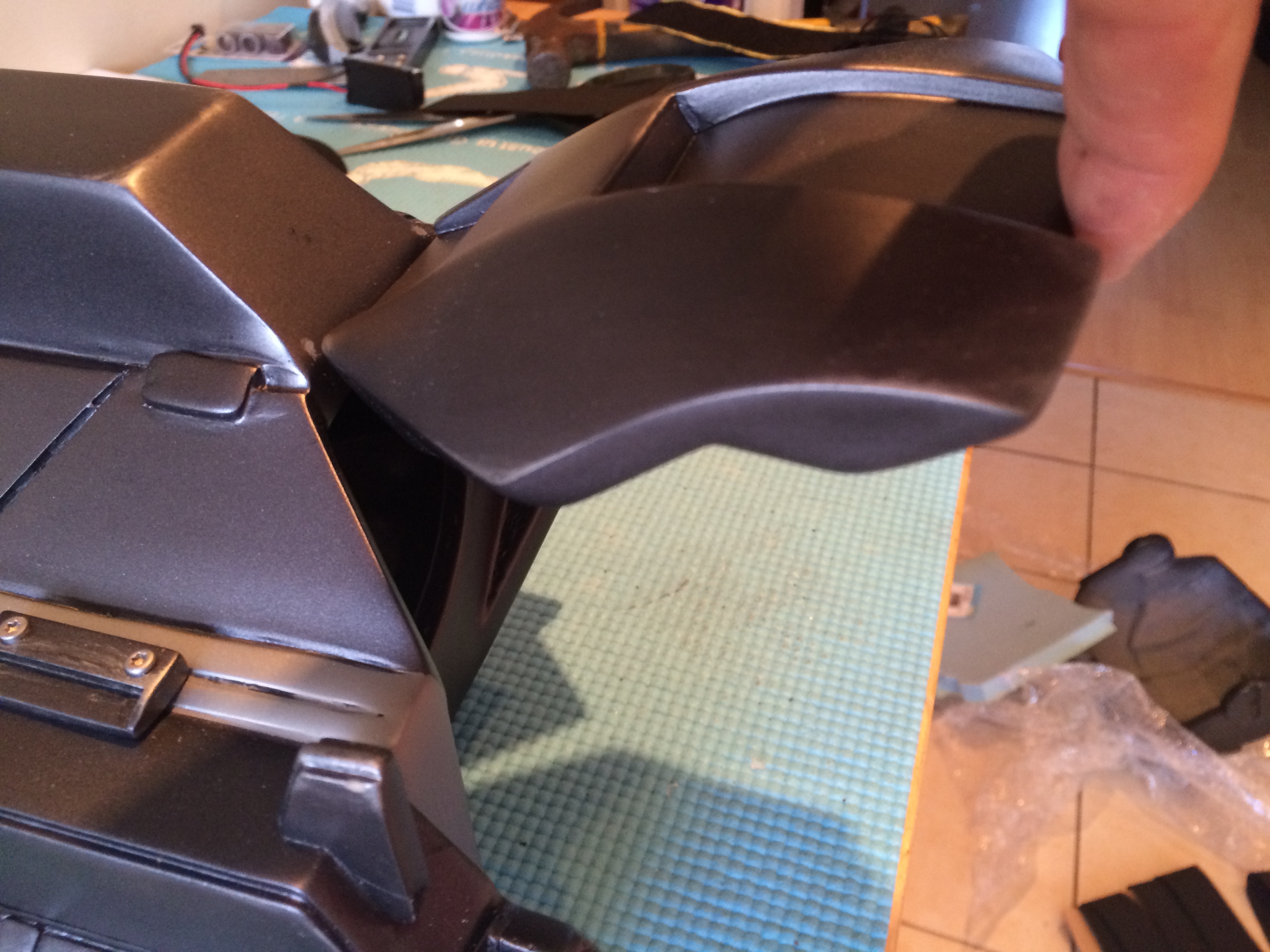

Re: Funkster's Masked Rider War Machine put together thing (ably assisted by Robostev
Couple of other bits.
The hand guards are only held in place by a flimsy hinge. Mine broke after about 30 minutes, so a piece of 1 inch elastic glued in place keeps it a bit more sturdy, but allows the guard to move backwards
