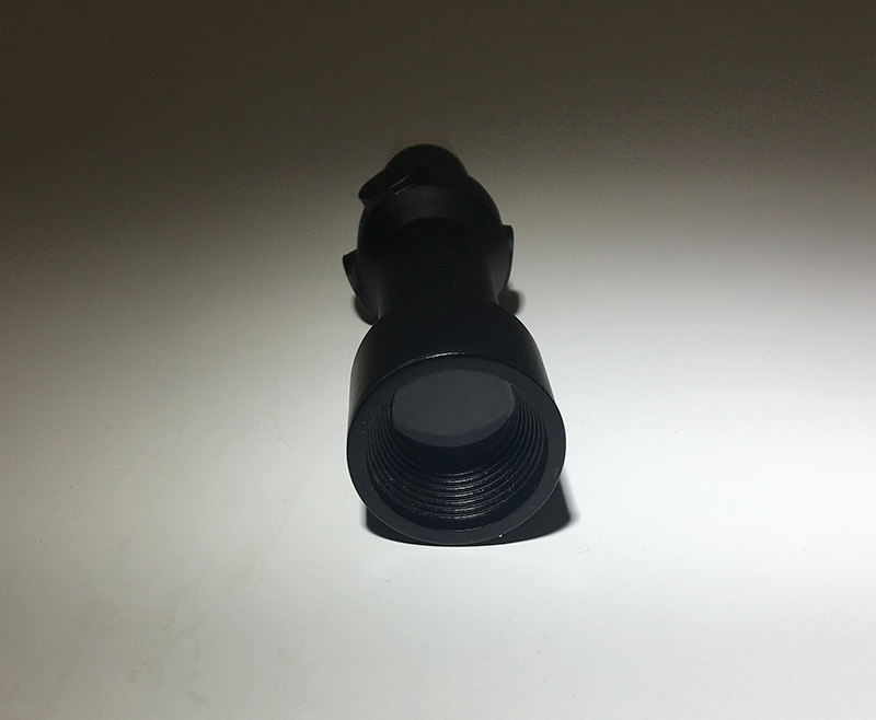

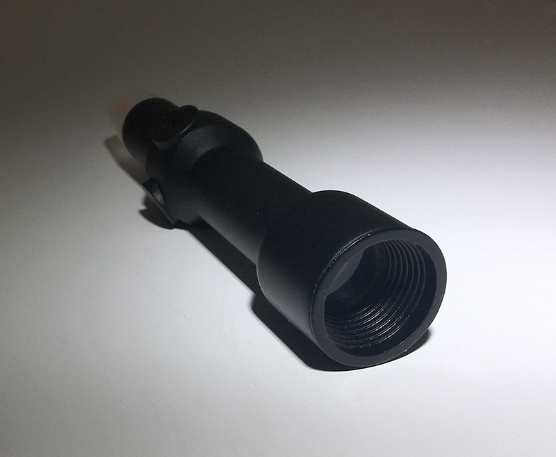

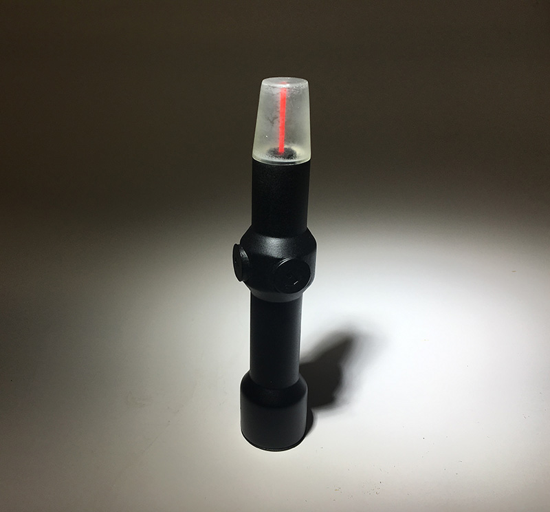

It's the 21st century now, so I decided to trying something new. I just drew up a Normark Singlepoint sight in Solidworks and am in the process of producing a working prototype sight on an FDM printer on the highest quality setting. Like my aluminum cast run, the sight body will accommodate a real fiber optic red dot rod. I painstakingly measured my sight to ensure accuracy, getting most all of the details you'd want from the original sight. It will have an acrylic lens for the eyepiece. The hollow conical tip will be produced on an SLA resin printer.

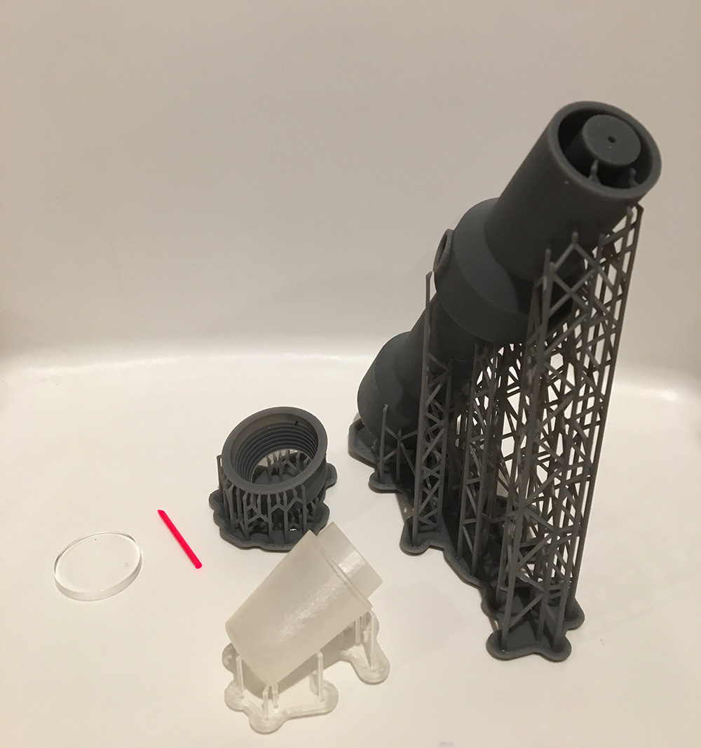

Here's the deluxe kit as it ships:
Here is the finished prop. This literally took 30 minutes of work....sanding, polishing, painting and assembly:
singlepoint2.jpgsinglepoint5.jpgsinglepoint1.jpgsinglepoint4.jpgsinglepoint3.jpgsinglepoint6.jpg

Complete Singlepoint sight produced entirely on an SLA resin printer. The conical tip is hollow and clear resin. I will sand the nubs off where the gates on the conical tip were, but you'll want to further sand the cone using progressively finer sand paper until you get the clarity you want. The body will be opaque and include an acrylic lens and fiber optic red dot filament. The SLA printer produces remarkable detail and requires very little finish work.

The kit would come with the red optic filament. The body and the eyepiece has been printed. I need to get time on my friend's SLA printer to produce the conical tip, so that will probably be ready this weekend. I'll take pics of the roughs as well as the finished when it's done. More to come soon.
