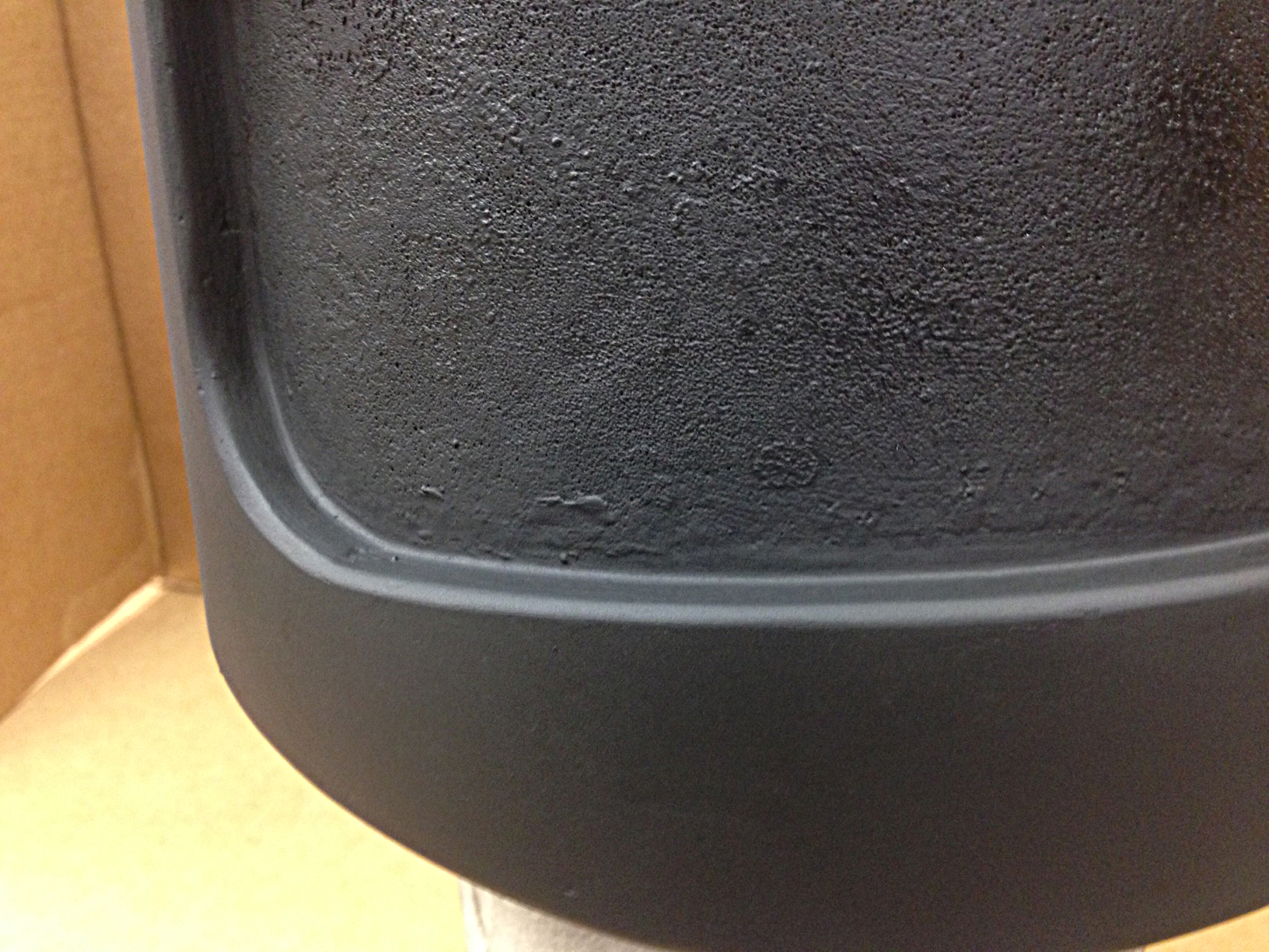

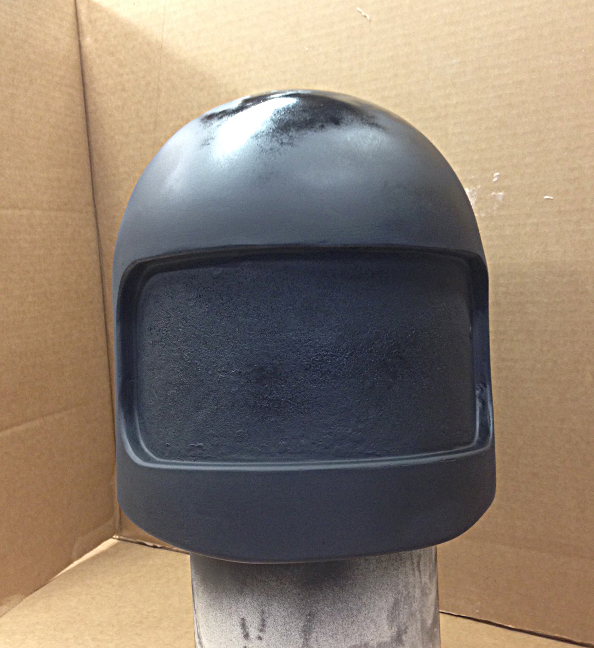

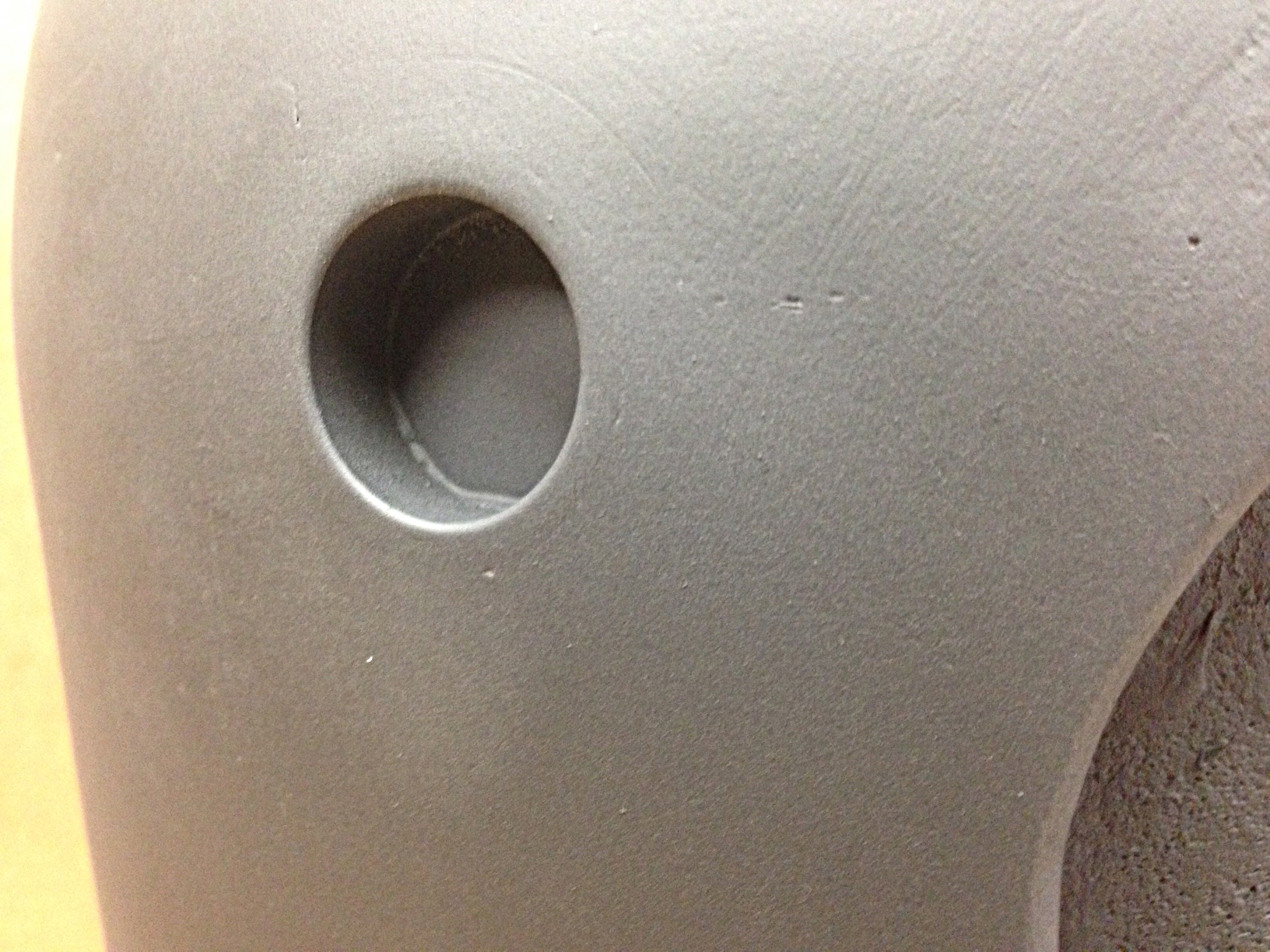

And some additional progress. Smoothed out much of the surface defects and inserted the recessed dimples.

I'm wrapping up primer before I seal it for molding. I did a quick photoshop of some color and a face to verify that I nailed the proportions. I'm pretty happy! If I have to nitpick, the "thickness" of my helmet could be proportionally thicker. Meaning I would need to cut out the opening and build the depth in. Not sure I'm concerned enough to do that.

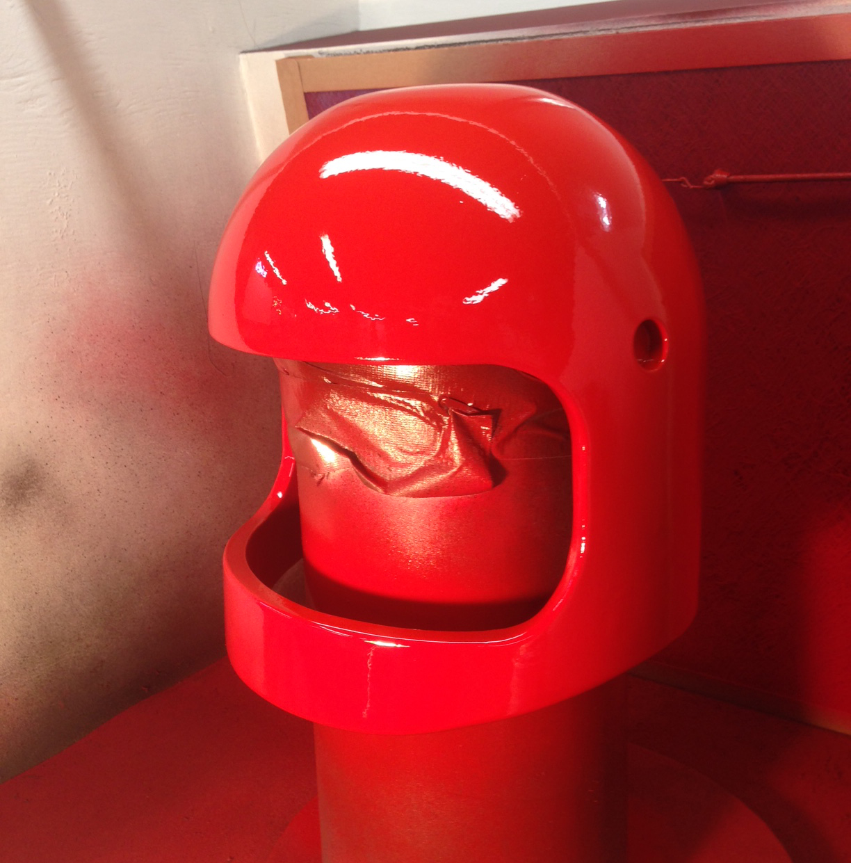

I think I finished the color coat tonight. I say "think" because this paint has been kicking my butt. I had several air bubbles pop up after I laid down the red. Off-gassing from the Bondo underneath I think. I need to work on my patience and let stuff cure before I move on to the next step. After a couple days I'll hit it with some clear then wet-sand and polish.
I love the red. I have some simple plans for a liner. Stay tuned.
