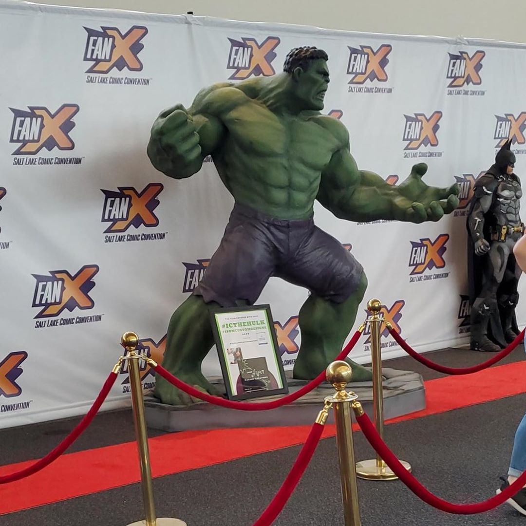

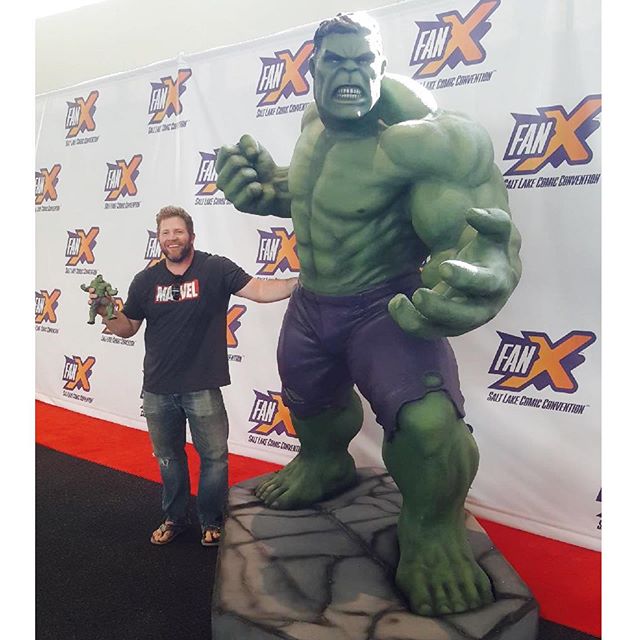

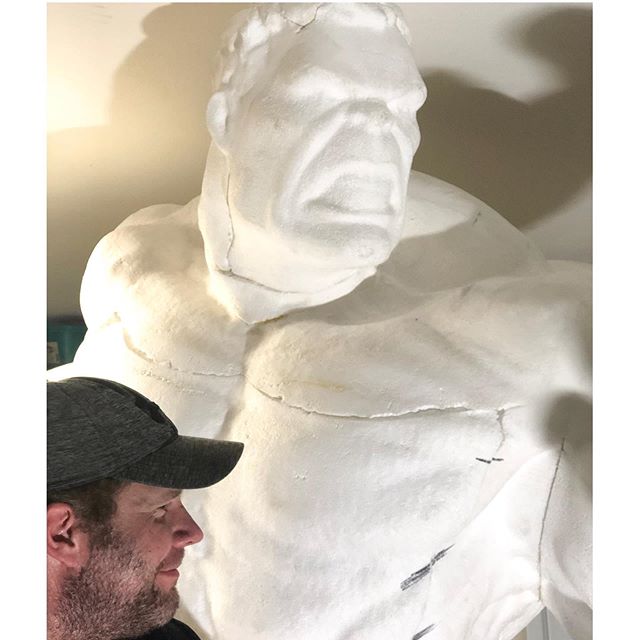

I thought I'd share a few pics of an 8 ft tall Hulk I recently made, using the Kotobukiya Hulk figure as my reference. I bought the figure on Amazon, and scanned him into my computer using a commercial grade 3d scanner with my previous employer. Later I found out that someone else has already done this scan, and posted it on Thingiverse... Oh well ... It was all part of the learning experience for me...

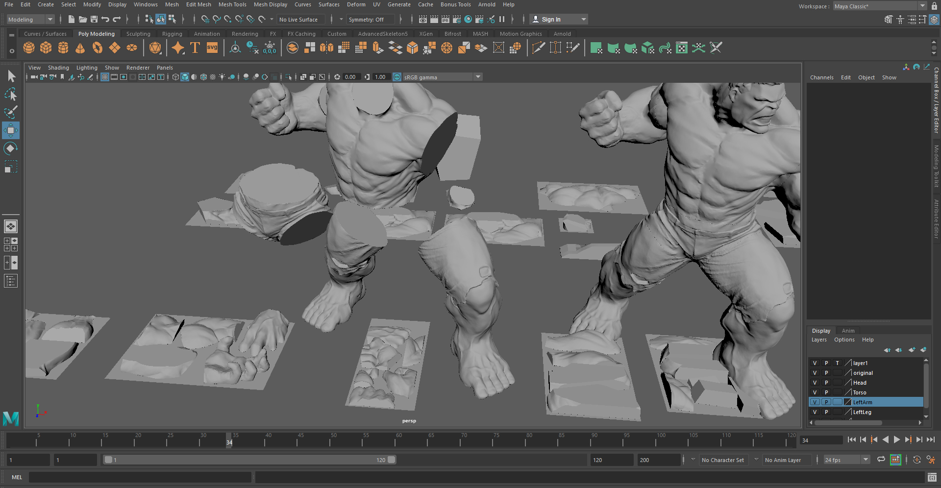

I used a cnc foam router to cut out the basic forms of Hulk. Since most of these routers only cut one direction (from the top downwards), I took my Hulk model into Maya and sliced him up into nearly 200 different pieces. I posted a screenshot of him in pieces in Maya.
Once I cut out all the different pieces, I spent countless hours sanding and gluing.
I used foam that was destined for a landfill. It was scrap from various projects my work had done. Since we were loading this scrap by the truckload and taking it to the dump, I pulled out various pieces that would suit the needs of my Hulk.
I liked the theme I had going with this project (recycling scrap stuff) so one day when a building next to my office was being demolished, I climbed through the rubble and pulled out a ton of old fire sprinkler pipes used in the ceilings, and used these pipes as an internal support structure inside the foam Hulk. I also pulled out pieces of rebar from the torn up building foundation to form Hulk's fingers, since the pipes were too big for his hands.
I didn't have any particular end goal in mind while building my Hulk. I was making him as my creative outlet while I have been dealing with some severe depression. So the very last thing I expected was to be asked to bring my Hulk to the Salt Lake FanX. A neighbor who knows the FanX head man, happened to take pictures while I was working on Hulk in my garage, and sent them to FanX with the words, "You need this in your show." The FanX folks quickly replied back, "Yes we do!"
