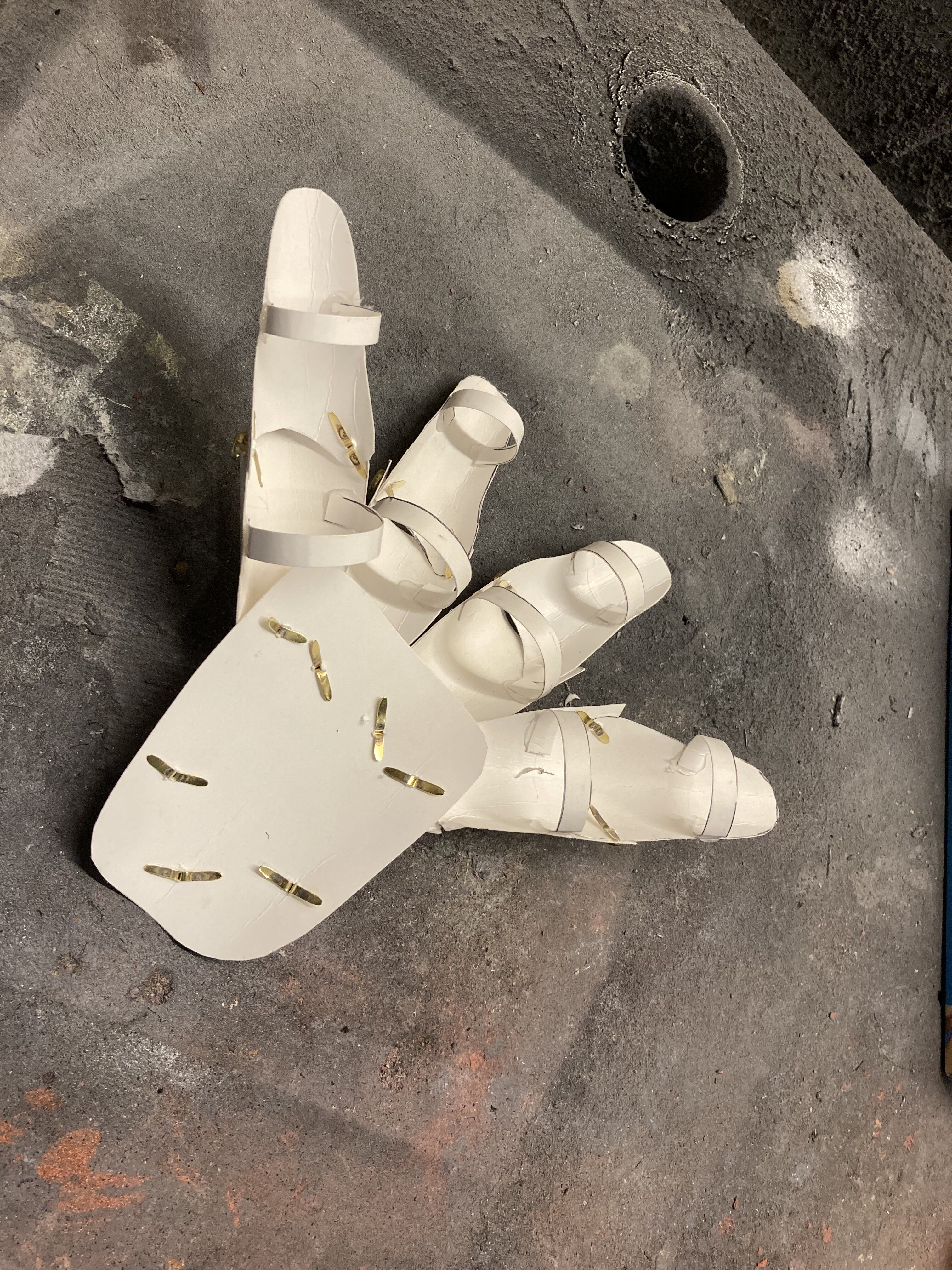

I have a beautiful metal glove made by a friend but it’s not Con safe. Using one of my old leather work gloves, we created quick paper templates then cut the glove elements out of poster board and connected them with art pins.

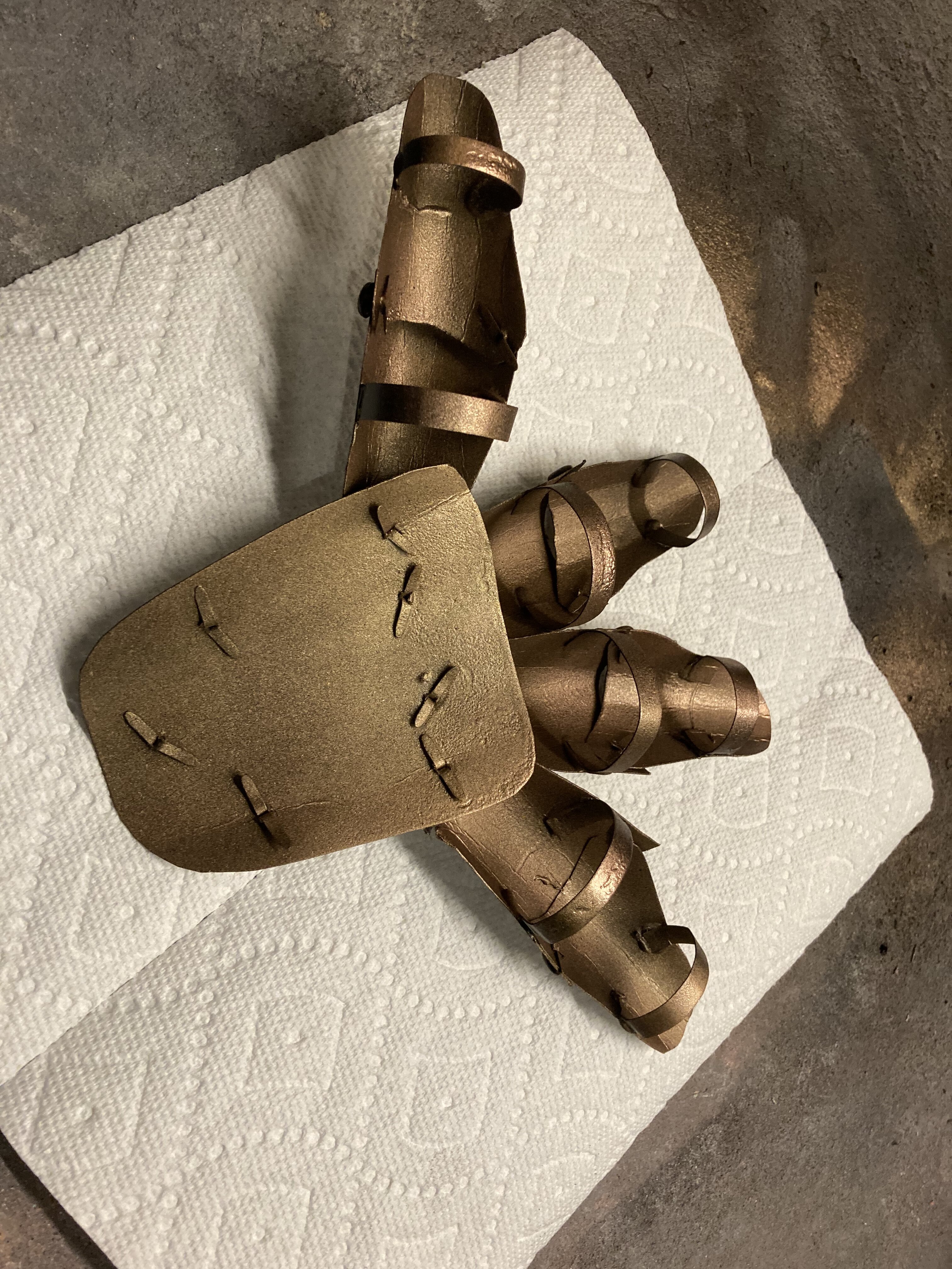

The plates were given a base coat of paint.

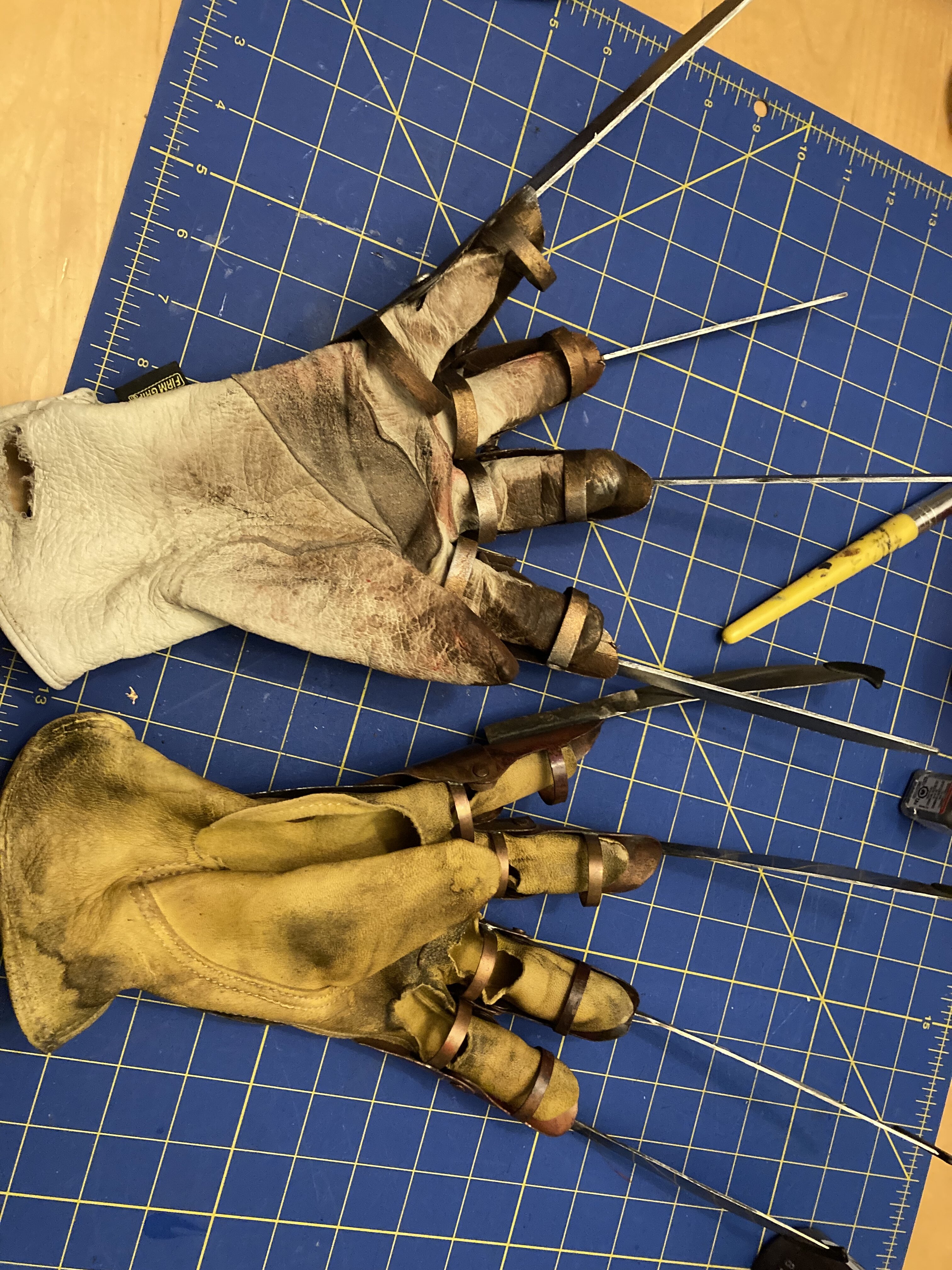

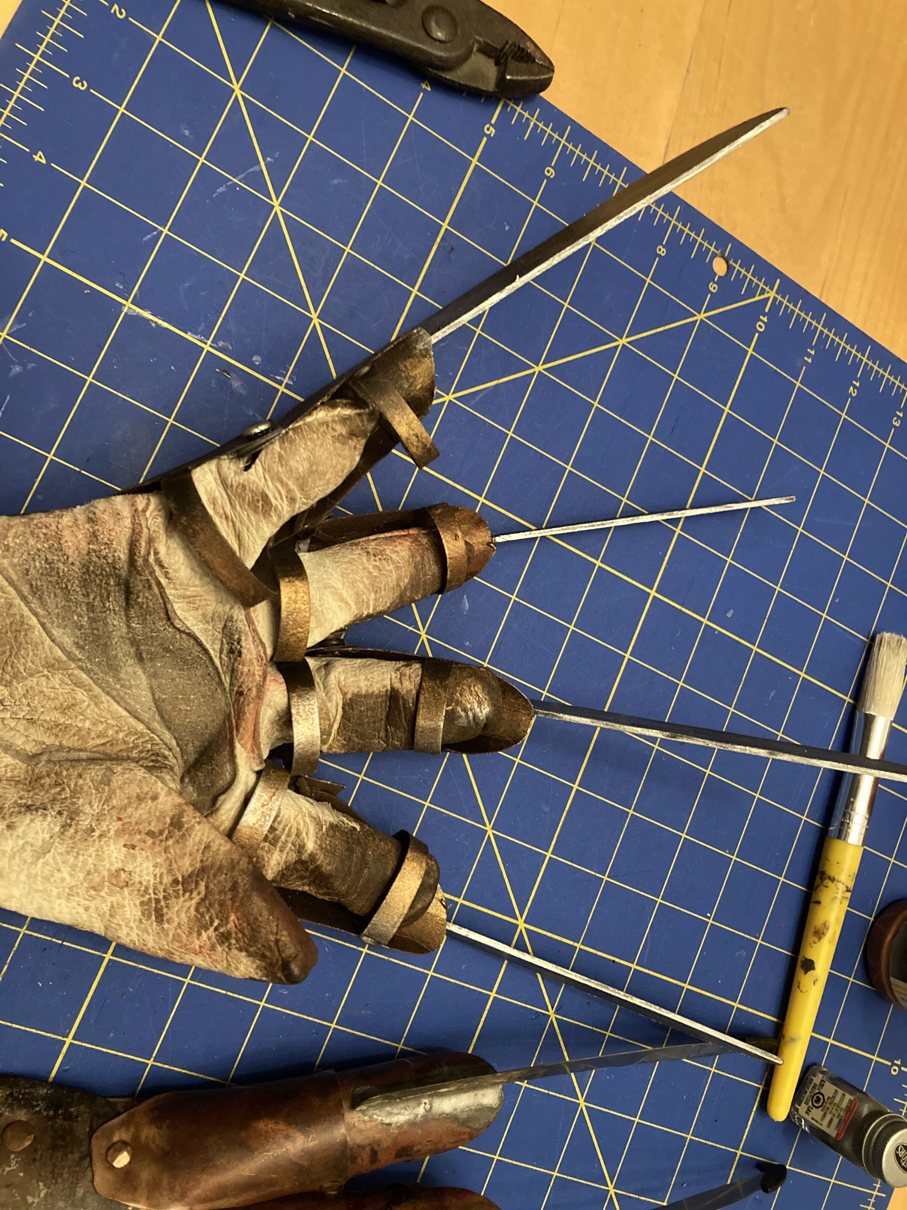

The blades were cut from scrap styrene and painted metallic silver. The plates were glued to the glove and the blades glued to the finger tips. Then the serious weathering commenced.
Here’s the final piece.

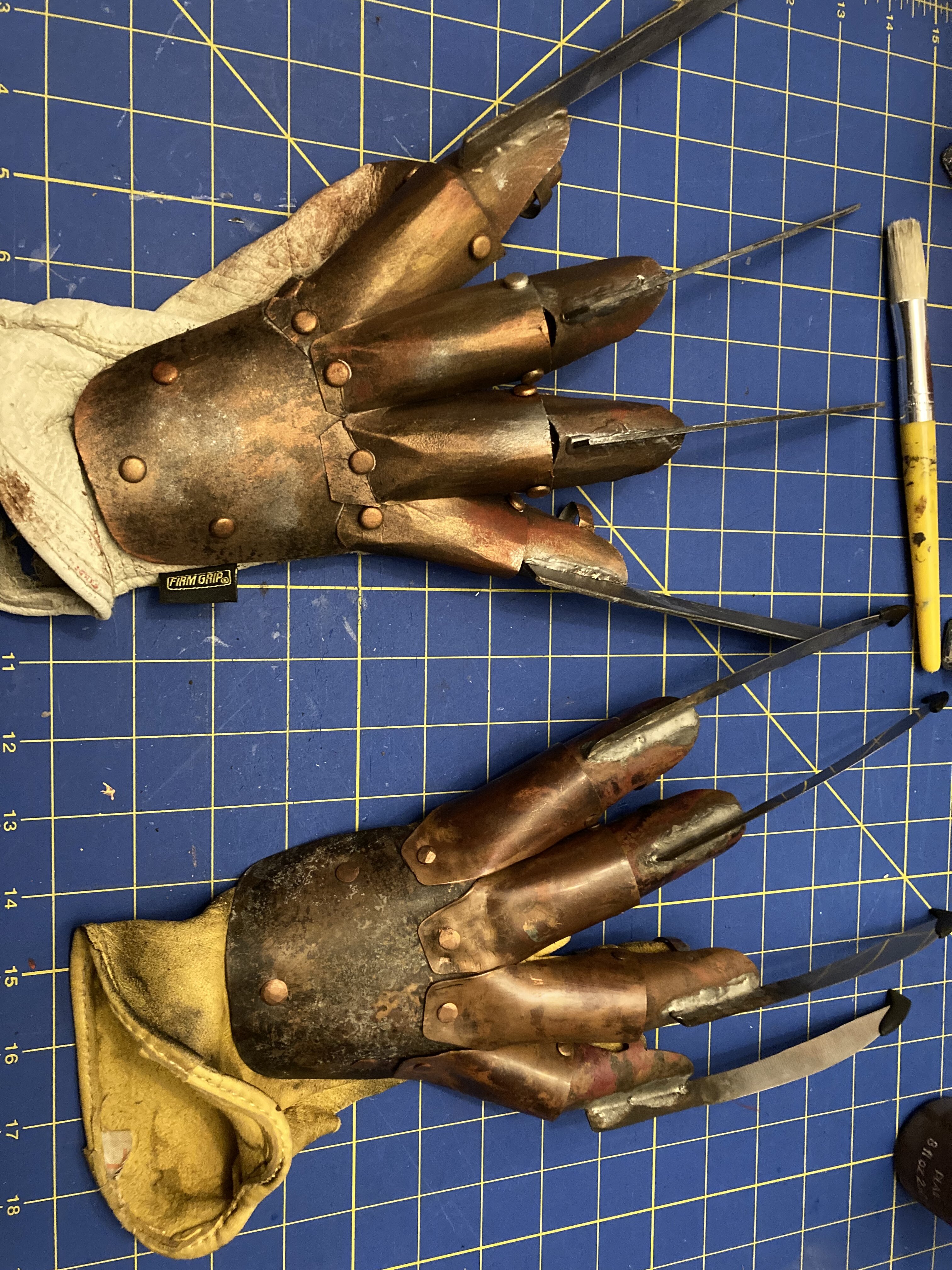

And here’s a couple of pics of it next to its metal sibling.
The total build took a couple of hours and used what we had in the house, so zero cost.

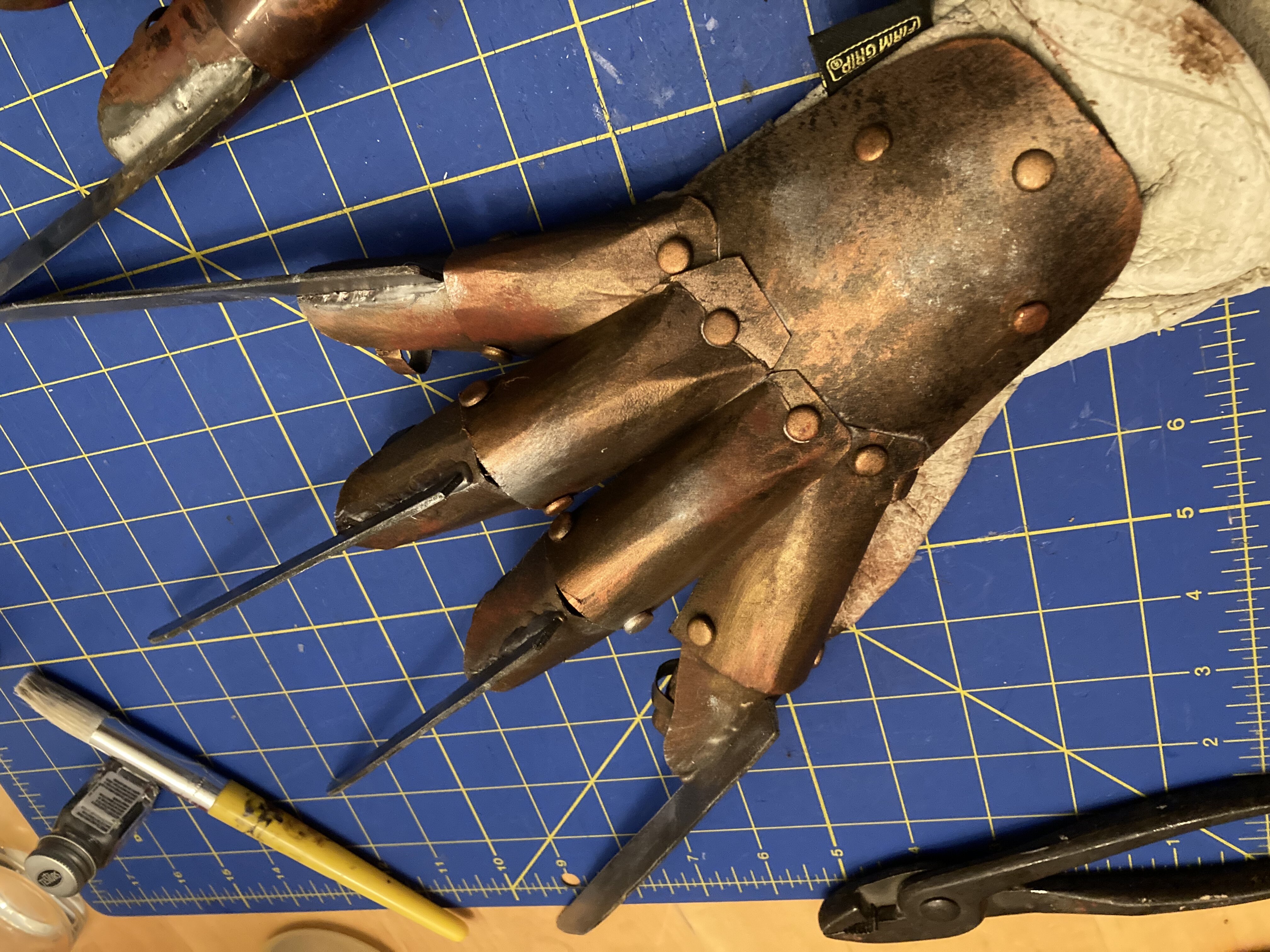

that is incredible. how do you do the copper style weathering?
Thanks, the copper weathering wasn't as challenging as it probably looks. It's mostly rattle cans. I started with a black base, then hit it with silver/metal, then a sloppy coat of copper, and finished with a dusting of gold. After the colors were laid down I misted with light black spray paint to bring down the "brightness".
I finished with a small (cheap) brush and used gold, silver, bronze, black and brown acrylic paints to add stains and blotches. Hit it with silver dry brush to pickup edges.
Hope that helps.
