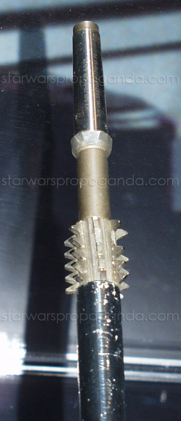

This top piece looks like a drill or gear of some kind. The collar at the top looks to have flat sides for a wrench. Then the tube going down to the teeth. It all looks like one piece.
Since it looks like it's just stuffed in the top of the pipe I am wondering what the part looks like inside the pipe heading down toward the handle.

The top may be what's called a "Worm Gear Hob". Below is a modern one. You can see on the brass one where the bottom part would fit into the top of the pipe and then it has the teeth, tube, collar, and then chrome top.

I was just thinking before I scrolled down it looked like a giant bolt with rows machined out... great find and good luck. Will be watching.
That may be the best real world find I've ever seen of this part.
Any larger pics?
Edit- Found this pic
OMG 1000% for sure that's what was used on the original ROTJ pikes!!!
Great find!
Now finding the correct one is going to be tricky.
Here is a decent pic.

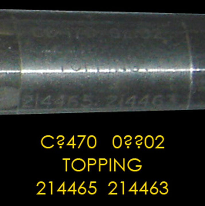

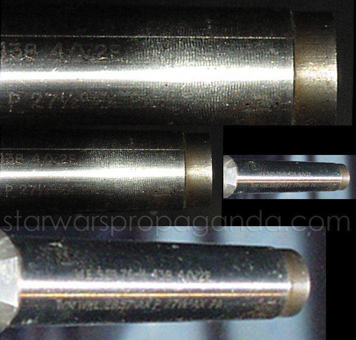

In fact here are some numbers found on one of the originals.
Hopefully they are some sort of identification #'s.
Did my best to make them out but hard to tell.
