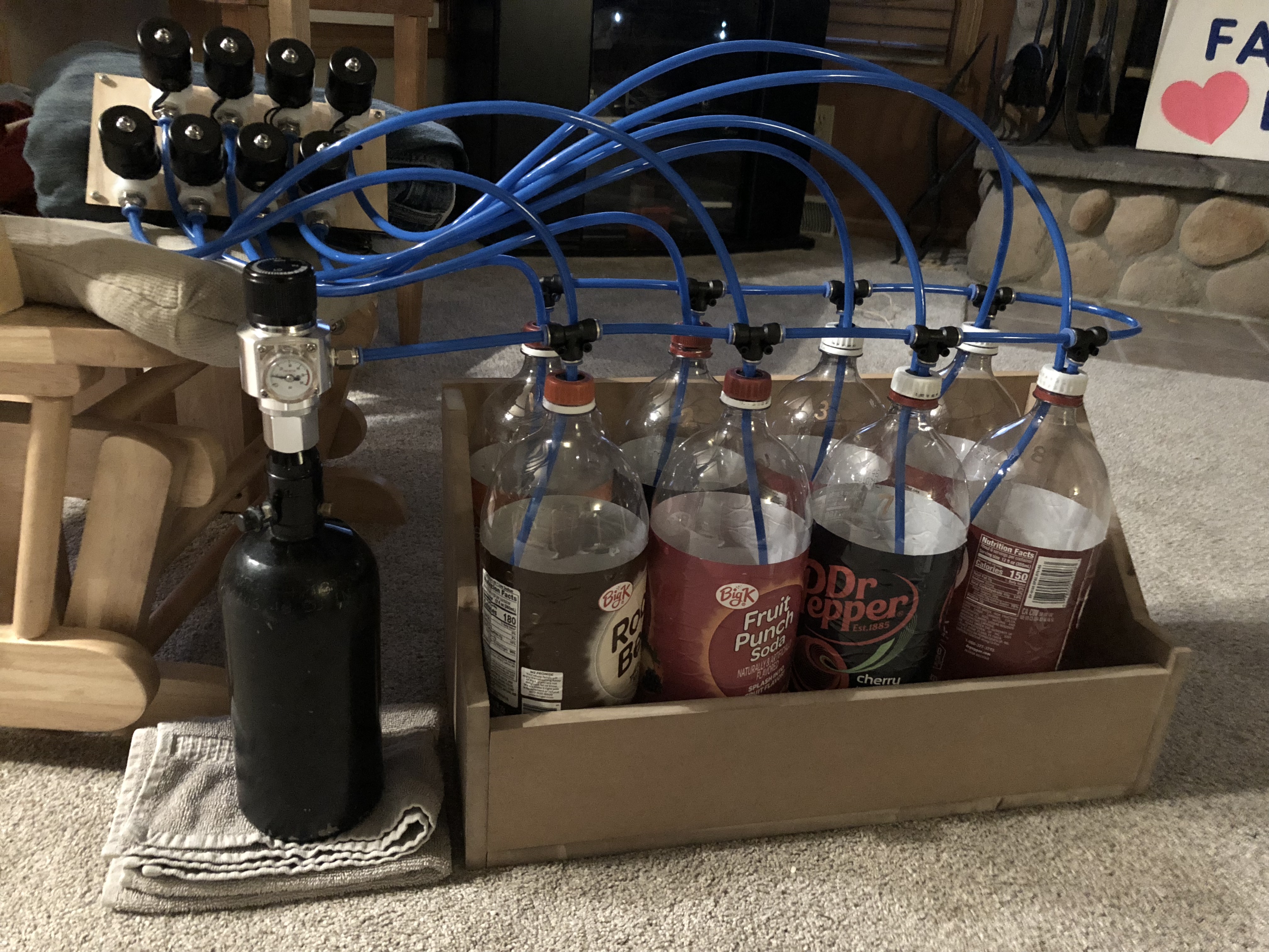

Its for a curent 'BarBot' (automated drink maker) project I have been working on.
My current pressurized dispensing system was a FAIL (had leaks)
that approach was using rubber cork/stoppers with 2 holes bored out and hose/line fed through it..
I'm not sure if the rubber is the fail point (leaking).. or if I actually got 6MM Tee push-fittings.. (instead of legit 1/4" push fittings)
So one line.. pushes the air in.. and the other line (which will extend into the bottle and into the liquid) then dispenses the liquid (through a code controlled electronic solenoid)
I am looking to make an alternative to the 'caps' I have in use now.. with a much better and cleaner (easier to access..etc) solution:
The fittings themselves are too 'wide/big' to fit into the default cap size (OD)..
I tried to add some 'hose/line' (as you see above) to accommodate for that... (still not a huge fan of this approach)..
would be nicer to just have 10+ 3D printed caps.. (unfortunately my Fusion 360 skills are basically non-existent!) LOL so its more of a learning curve if I have to do this myself.
