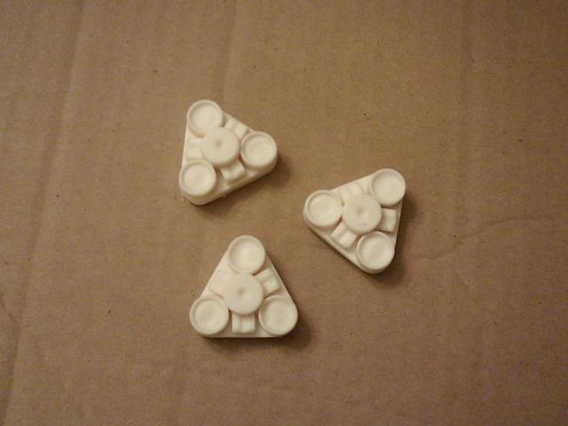

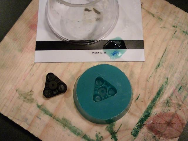

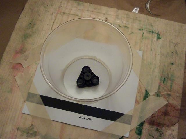

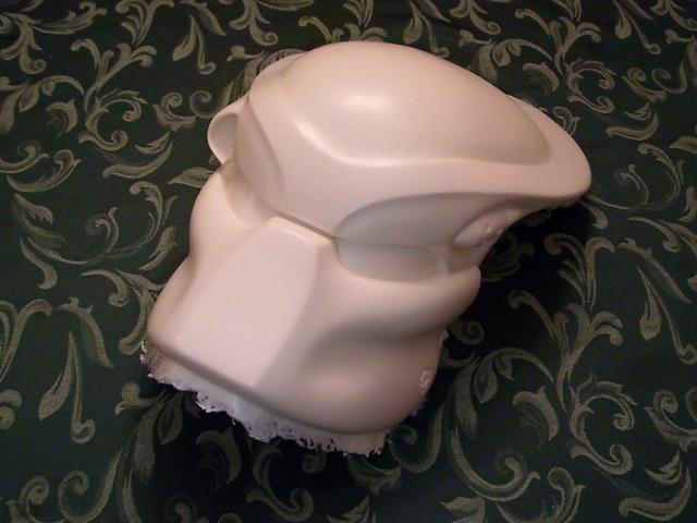

I got some more house keeping done over the weekend and made a quick silicone mold of just the laser housing as I will need to be able to cast this piece separate from all the rest of the pieces in the block mold for level 1 bios.

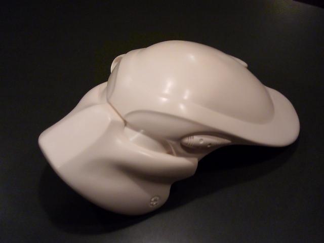

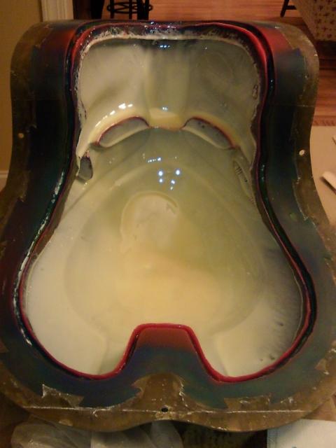

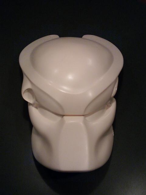

Speaking of which, I went ahead and made my first level 1 helmet. It came out pretty good and wieghs in at about 22 ozs. so it is definitely lighter than it's level 2 counterpart. To do this I had to re-insert the silicone plugs that I cut into the upper rear fins for pouring the resin and just used clay to hold them in place.

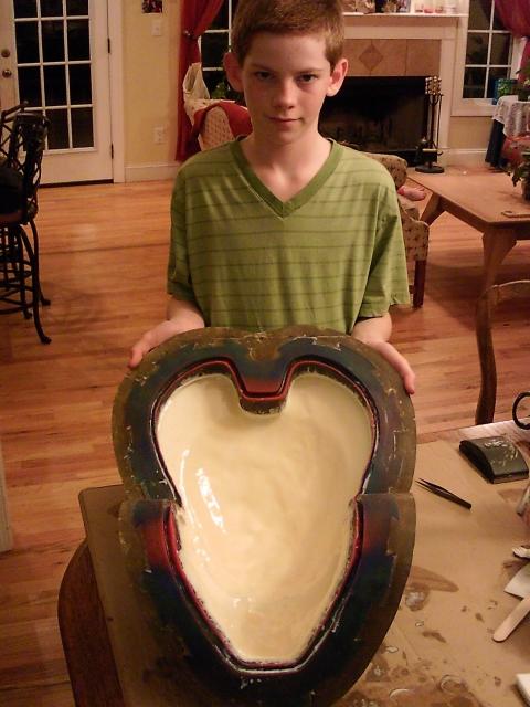

I even got my oldest son interested in wanting to help mix and spread some resin...
Fresh out of the mold...
Trimmed up and ready to go...

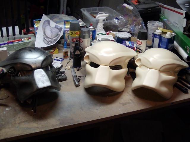

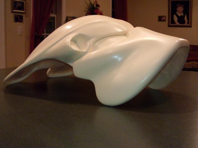

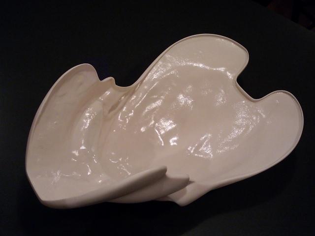

I also made another level 2 helmet and cast another full set of interior pieces. Just trying to build up a bit of inventory.
My leather skiver is on it's way and I should be seeing a few more of the things I ordered to create the next 'rung' very soon so I anticipate another big update towards the weekend.
Bios, bios everywhere...
So close....

The level 2 is definitely cleaner coming out of the mold and faster to make than the level 1 but the level 1 is lighter. They both have their advantages and disadvantages. The interior pieces take more time to clean up for the level 2 and the level 1 can't get them so those are the trade-offs. At Jason's and your recommendation I have ordered some Apoxie Sculpt which will help fix some minor bubbles in the pieces coming out of the block molds. I wish I had a pressure chamber for molding the interior detail parts in as I believe I could produce bubble free castings if I did. I wish I actually had a pressure chamber big enough that I could put my whole helmet mold in it as well. The level 2 castings come out clean but there are a couple places where very small air bubbles get trapped and it would be sweet if I didn't have to deal with them at all. They are just a minor annoyance though. Other than that they are relatively clean and ready to paint after the flashing is trimmed away. If anything they might need a thin glaze of some spot putty in places after a light sanding. As I work on the first one I am also preparing what I will need to get some kits put together and ready to go so hopefully I will be up and running when the first one is finished. By up and running I mean they would be available for anyone interested

Hey Clay, I am using Smooth Cast 321, about a 10+ minute pot life. Vacuuming could possibly help but I would probably need to go with the 322 if I do. Vacuuming will help get the air out and a pressure chamber compresses the air in the bubbles that may still get introduced with pouring. I can also try pre-mixing the resin parts without shaking them but instead stirring which may help as well. Still experimenting for sure and the casts are very useable as they are but just more time consuming to clean up. Perhaps that is something I can get one of my kids to work on. Thanks for the comments and insights from your experiences They are definitely a benefit to me.

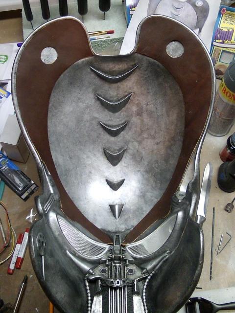

I was glad to get the leather skiver so I set to work on the leather pieces and again it has been a learning experience. The leather I have is probably not what they consider tooling leather and I believe that makes a huge difference in how well the skiver can cut the leather to thin it. I am still able to make it work but with a lot more effort. As a result I was able to get the two largest pieces cut and thinned (Skived) but it took me longer than I anticipated. Here is a shot of it so far.
I still have to emboss these pieces, cut and skiv the two lower pieces and glue them in. Perhaps tonight I will get it all installed.
