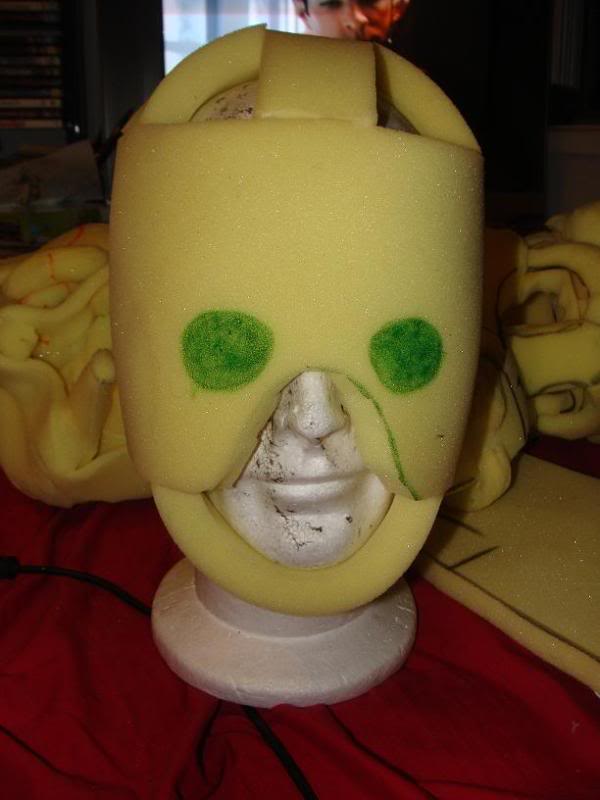

Start by making the basic structure, one wide strip wrapped around the head (from top lip to mid forehead), crossed supports on the top of the head and a strip under the chin
Cut out a triangle around the nose for comfort and mark the eye position but don't cut them out yet

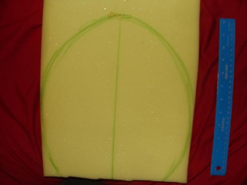

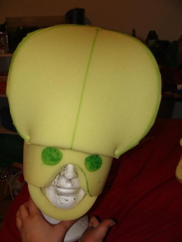

Next you want to mark out the dome of the head like so
Make it as big or small as you like, mine is around the 30X40cm mark which is a little small compared to the other masks out there I think??
Cut the dome out and glue it to the forehead of your basic mask structure, if you want to be sure of the shape and placement attach it with pins first and make any adjustments you need too before glueing it down.
Attach it fairly close the the eye holse you have marked as it will form part of the eyebrows.
Use a thin strip from the middle of the back of the dome to the base structure to determine the angle of the dome of the head and to hold it in place

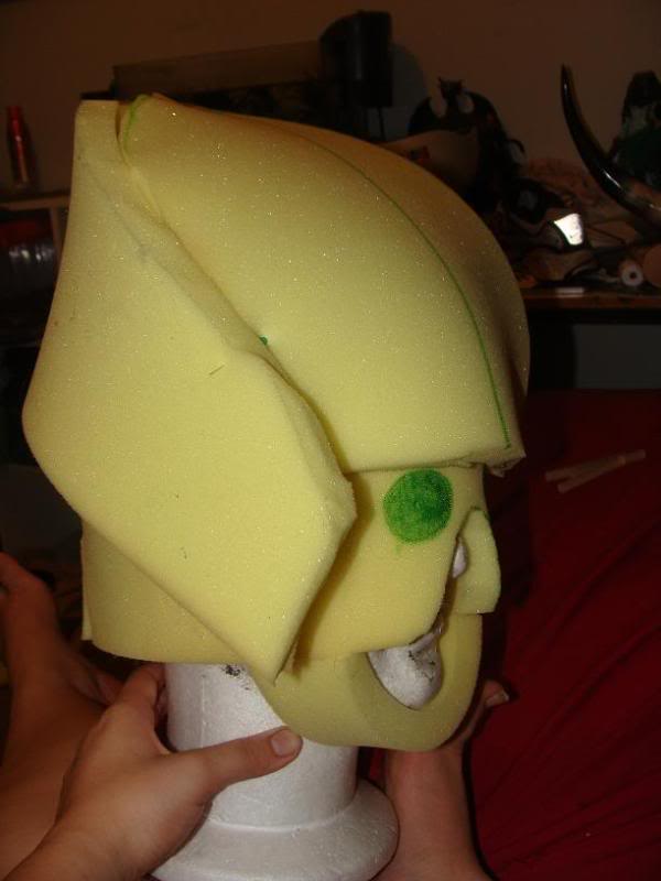

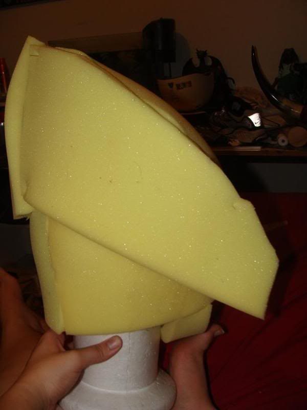

To make the sided of the head hold a piece of foam along the side of the head (parallel to the bottom of the base structure) pin it in place if you need too and mark where the dome sits. Make sure the 'point' of the piece extends past the face because this will become the top mandibles
Mark one side and trace the other from it to make it symetrical

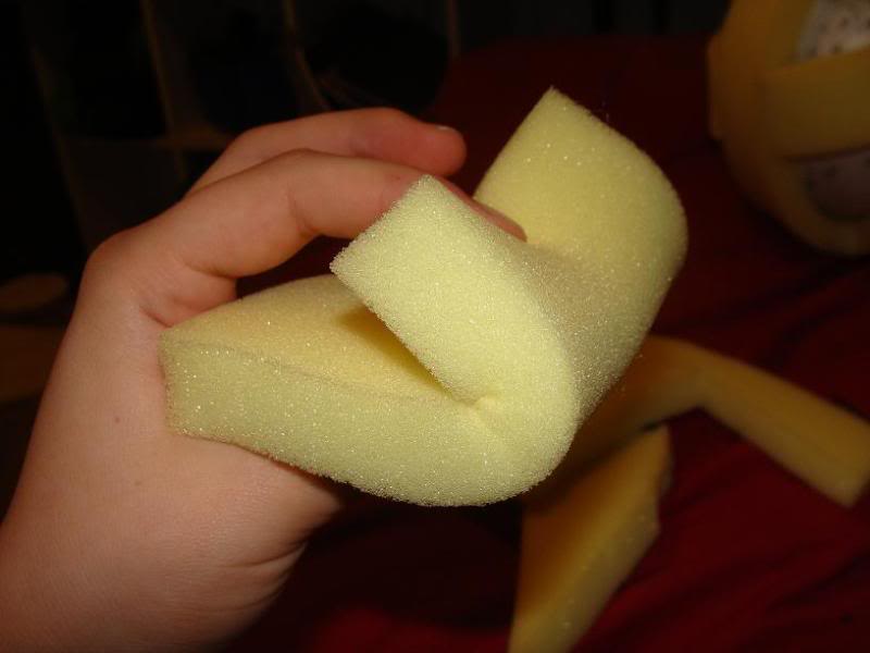

For the lower jaw cut a small rectangle of foam, fold it over one way then the other to make the jaw shape
Glue it in place to the back of the jaw is attached to the narrow edge of the jaw suppor of the basic mask structure

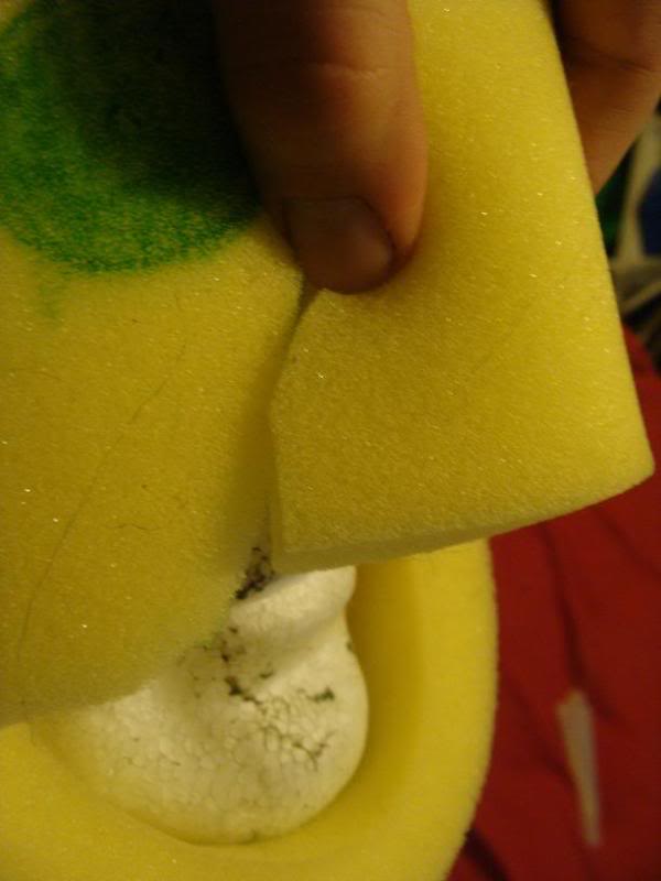

For the upper jaw/nose thing =/ cut a tapered rectangle and glue it over the nose with the cut edged glued to the flat of the basic structure

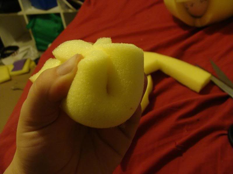

To shape the end of the mandibles put a stip of glue along both edges and down the centre like so
The squeeze the foam in your fist to make the rounded shape
At this stage you want to make sure the mandibles are symetrical and place them how you want holding them in place with glue and round off the edged by snipping little by little with the scissors.

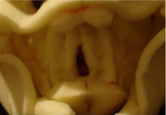

You should be left with a basically hexagonal shape in the centre of the face over your mouth, use some paper and trace that shape and cut that shap out of a piece of foam. Draw the design of the inner mouth on the foam and cut the detail in with the scissors, take your time with this step and cut little by little to avoid having to start over, once your done glue it in place.

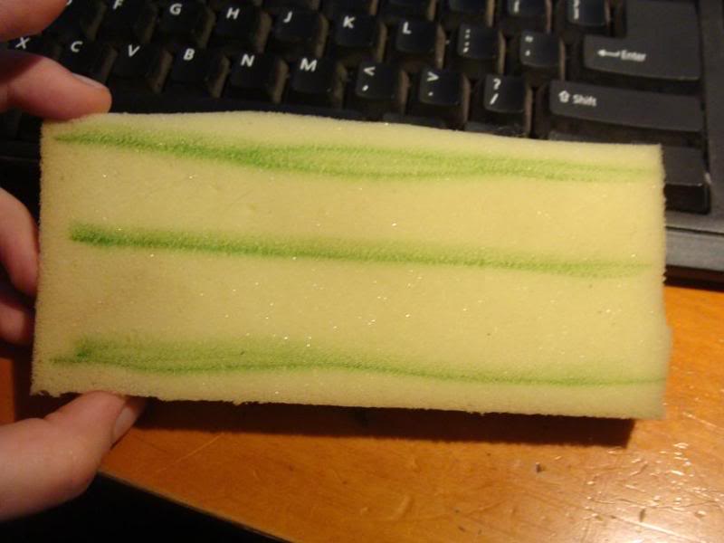

The membrane around the mandibles can be made by either glueing material (stretch preferably) in place of cutting 2 inch wide strips of foam, split the strips length ways so you have 2 half inch thick strips rather than 1 1inch strip (cutting the foam into 2 inch wide pieces prior to splitting makes it easier to split evenly) then glue the strips in place to form the membranes

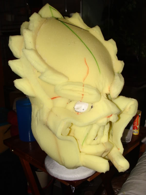

Now go ahead and add details buy carving the foam and adding things like eyebrows, head ridges and the crown spikes however you would like and then cut out the eye holes (keep them as small as possible while still allowing adequate vision to give the desired effect)
Here's mine so far

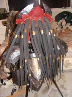

Start by making your pattern. Make a sort of elongated triangle shape the length you want your dreads. The base of the triangle should be twice as wide as you want your dread to be i.e. if you want a 1 inch dread make the pattern 2inches wide. Now I said 'sort of triangle shape' because to get the right look you want the first 2/3 or so of your patter to be fairly straight with just the last 1/3 of the total length tapering to the point.
Once you have your pattern made trace out at many as you need onto your material, cut them out and sew up the edges, leaving the top open.
Stuff the dreads with the poly fill, make sure you stuff them enough so they hold their shape but not so much that they don't move.
Sew up the ends (either by machine or hand and paint if you didnt use black material) and attach to your mask.
And there you have cheap, good looking dreads that swish nicely
