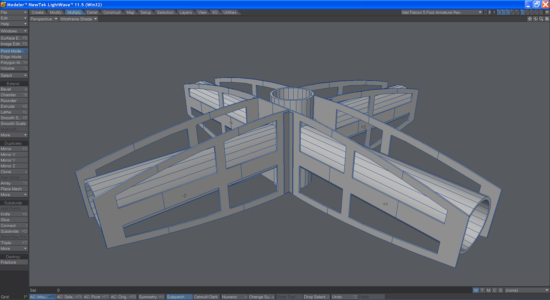

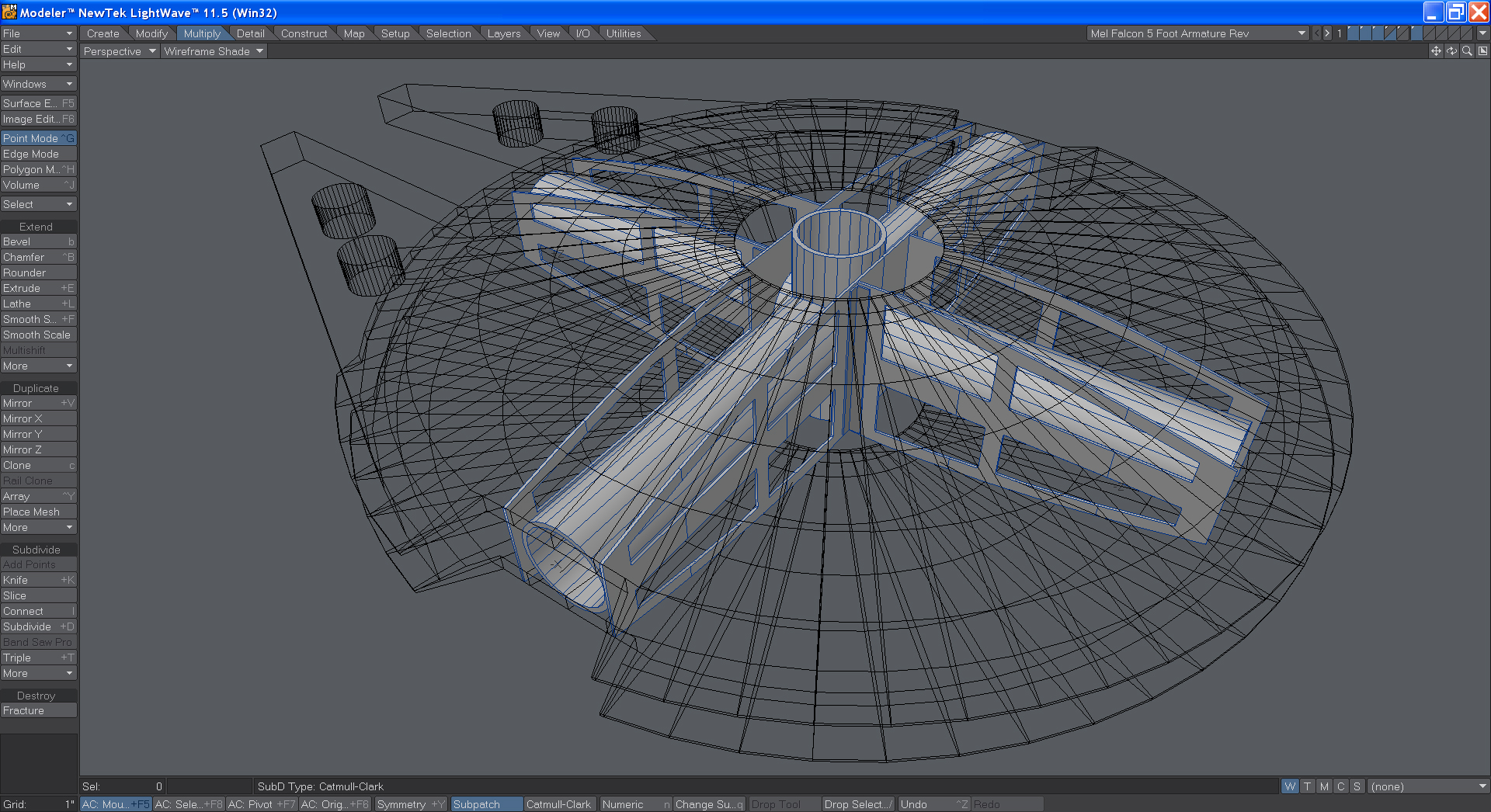

Hi Guys,
Didn't want to hijack the great thread of Andre and Maruska. Just been playing around with an armature design for the 5 footer. The pictures show 1/8 aluminum plate for the formers. They could be made from thicker plywood as well. I may need some diagonal formers at the intersections, but it may already be overkill, LOL. I'm showing 2 1/4 inch aluminum pipe for the mountings. It will allows the model to be mounted from 6 different points. May never get around to building another large model, but doesn't hurt to piddle in Lightwave a bit, :) I'm rebuilding the model that Andre provided in Lightwave format. It's what I'm used to using. These guys have been awesome in sharing all this great info. Just wanted to contribute a little if possible. Let me know how it could be improved, I ain't no engineer, LOL, Cheers,
Joe

It's a good thing I'm not sensitive to rejection, :( ............
LOL.
Hey Joe,
Sorry, meant to reply a while back, but yeah your armature is very interesting & yet another way of doing it.
There's just so much you could throw in this void that it is inevitable we will all come up with different designs. I do like yours though.
I'm trying to keep mine simple & at a cost that I'm happy with. Trying not to over engineer the thing too, which can happen real quick without realising it!.
Beautiful renders too Joe, me, cardboard mock ups, paper & my head, yikes!!.
Stu
Thanks Man, I was just joking around, :) I couldn't resist playing around with the 5 footer. I actually started working on a plug for the main body. I know I shouldn't start on this beast, considering the fact I'm building the Galactica. Oh well, I have more time than sense, I hope, LOL. As for over engineering, I'm the poster child for that, :) Cheers,
Joe
Surely you'd need the 'engine' side to be different/shorter and the front to have a couple of additional supports down the mandibles?

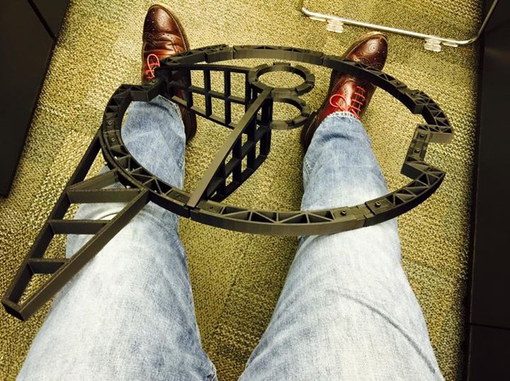

That's why I like the design on Jason's 32in McQuarrie Falcon framework because with a bit of tweeking it could offer a very sturdy, light weight frame. Not only that you can incorporate the holes to insert handles to move it just like the original model.
(Jason, I hope you don't mind me using this photo as an example)

Thanks for the input, I left out the wip notice in the post, ;) The engine would have lighting and the frosted shield back there. I totally didn't think about the mandibles. I guess I was thinking that they would be strong enough on their own to support themselves. But it would be easy to extend the armature into them. I was hoping to get responses like this, as they are very helpful. Still working on it. When I get the shell finished, then I can get my hands and rulers on an actual thing. Virtual things are great in their way, but nothing beats good ole fashioned hands on, Cheers,
Joe
Oh that is pretty ! I started with wanting to mount this huge model from six different directions. Then thought about the weight of this huge beast. I also considered the left over tubing I have from my Big G project. With those things I then just try to fit everything into the 3d model. Like I mentioned earlier, with the shell finished I'll be able to fit everything into an actual physical structure. I can go back and forth between the 3d model and the real one, tweaking both as I go. Not exactly Cad/Cam but a good process to get to the final product. Of course without
the great work by Andre and Maruska, I wouldn't touch this beast with a 10 Foot armature, LOL. Cheers,
Joe

Those mandibles could be secured to the main body using the cantilever principle (Google is your best friend)...economy of material while keeping the same type of design bwayne64 did in the first place. And yes, at least 4 mounting points should be the norm:behave
