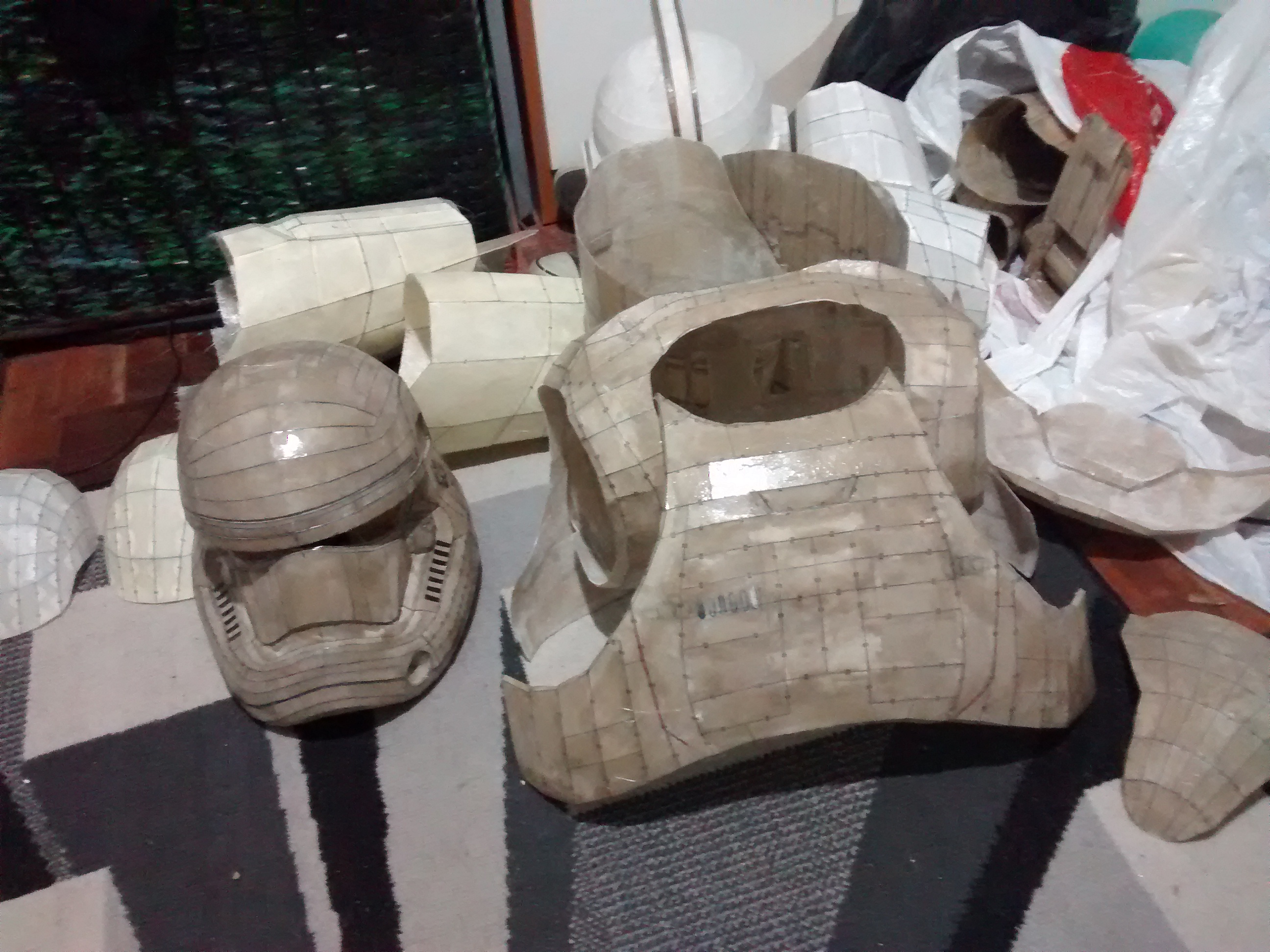

I'm building the new First Order Stormtrooper armor using pepakura. I just finished building the whole armor and now I'm starting with the resin/fiberglass process. It's been about 4 months since I started. So now that the models are ready I decided to post the files so other people can use them. Here are some images of the model:

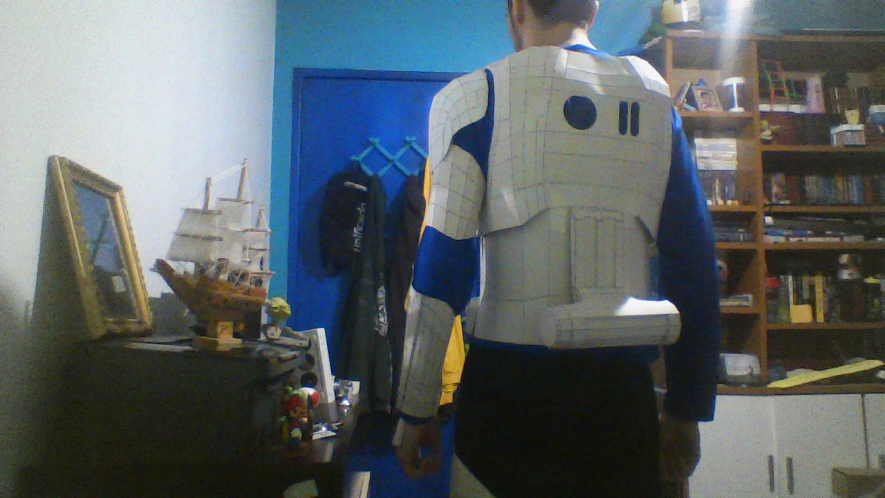

It was modeled (by my boyfriend) according to my size, so it might be necessary to adjust the scale of some parts. Also, the folder includes two different helmets, so you can choose which one you're gonna use (I recommend the second one, because it's much more detailed and looks just like the original).

And here are some pictures of me trying the armor:

Quick update:
We made some progress. We already started the fiberglassing on some of the parts. Unfortunately, almost none of them is in the right shape, so we're going to use a blow dryer to fix them. I hope it works fine. Next week we want to start with the bondo coat. We have to hurry if we want to finish the armors by the time of the movie release (to which we already bought our tickets to December 16 at midnight and later at the same day on IMAX!) :D Wish us luck!

Another update:
The movie is getting closer (only 18 days!) and I still have A LOT to do. I'm afraid that I might not finish in time, but I hope at least the helmet will be ready by then. I'm still trying to figure out the "bondo". I think I'm doing a good job considering it's my first time.
