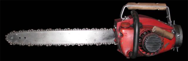

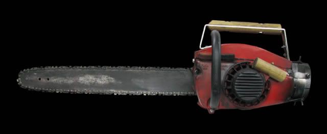

There isn't that mutch difference between the XL and XL2 as far as size and shape go with the finished saws. The XL are useually plastic body and easier to cut. I do like the way a XL-2 feels when finished becasue it is a metal bodied saw. Here are 2 saws I finished the first one is a XL the second is a XL2
Those saws look really nice... well, not "nice" since they're killing machines of spinning oily death, but you know.
