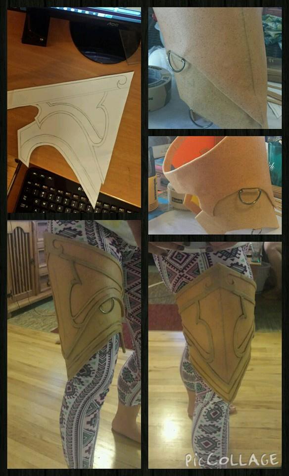

I first completely finished the top half of the armor before I started on the bottom half just to get used to the process and learn from any mistakes. Another piece of my armor making that turned out to be particularly difficult was figuring out how to fix everything to my body so that it would be stable and comfortable. The end result was lots of clips, D-rings and velcro:

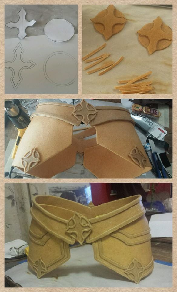

Next came the bottom half which was in no way easier to pattern than the top half!

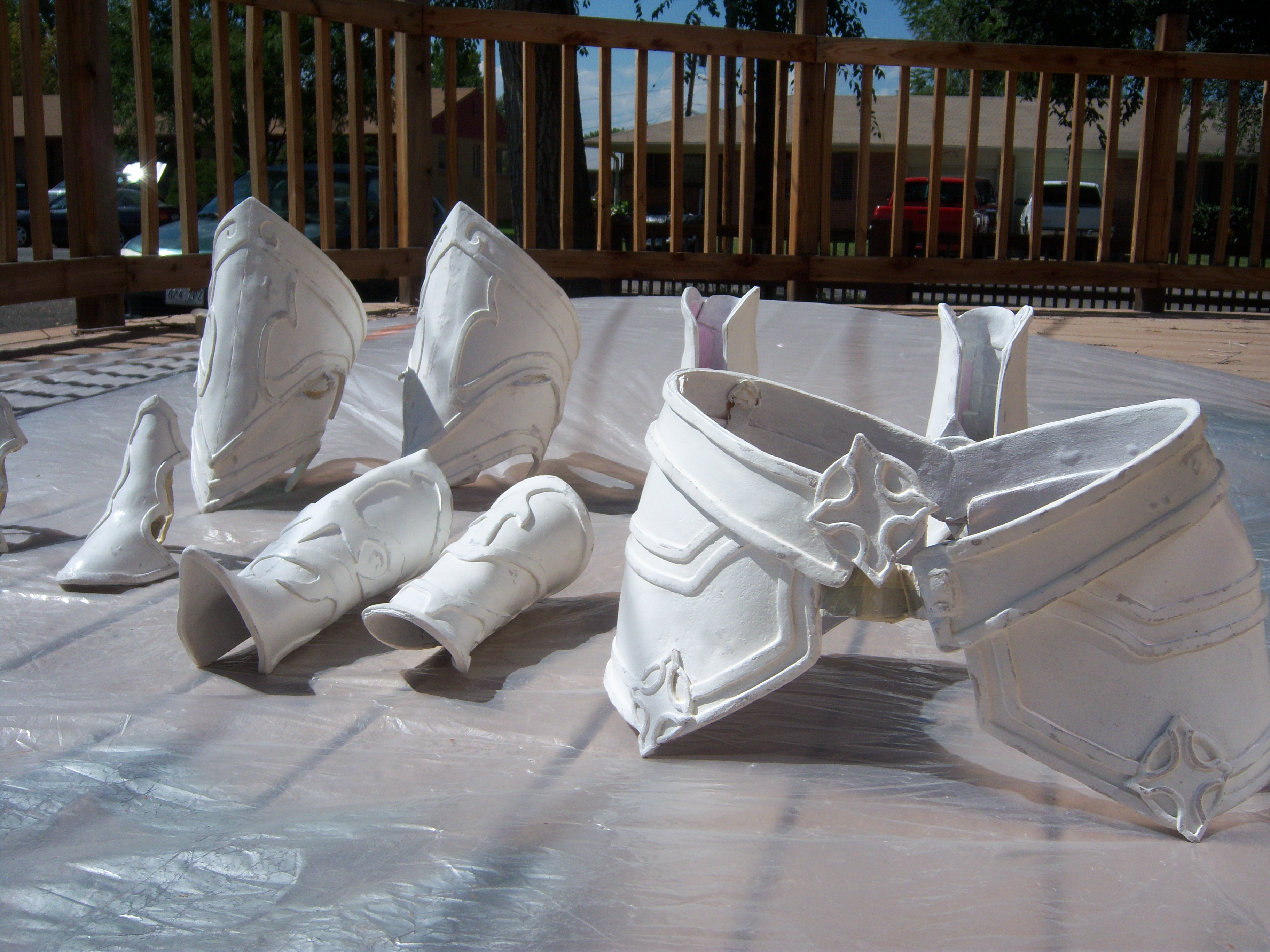

Again the long process of gesso, sanding, and wood glue followed by spray paint!

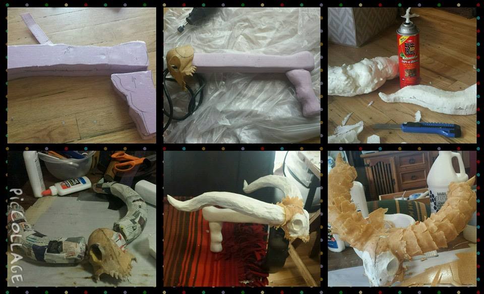

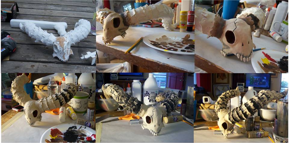

I also made a crossbow modeled after a picture I found on google but as you can see I changed the look quite a bit. The crossbow took two full attempts of construction. I got it right the second time I made it. I used two different types of foam, insulation foam, expanding foam (great stuff), and paper mache. I also used worbla, some LEDs and a wooden dowel.
The end result!
The end result!
