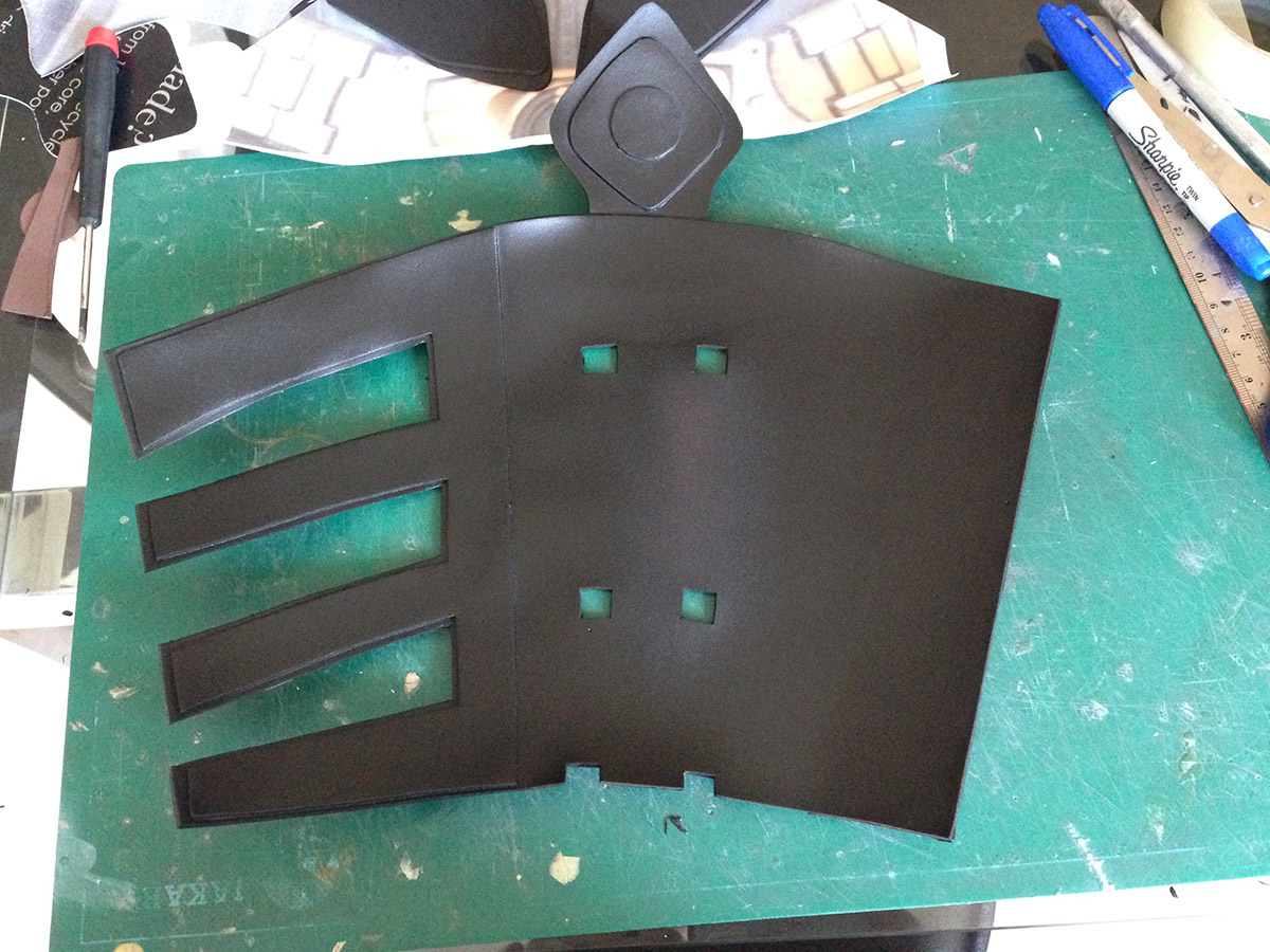

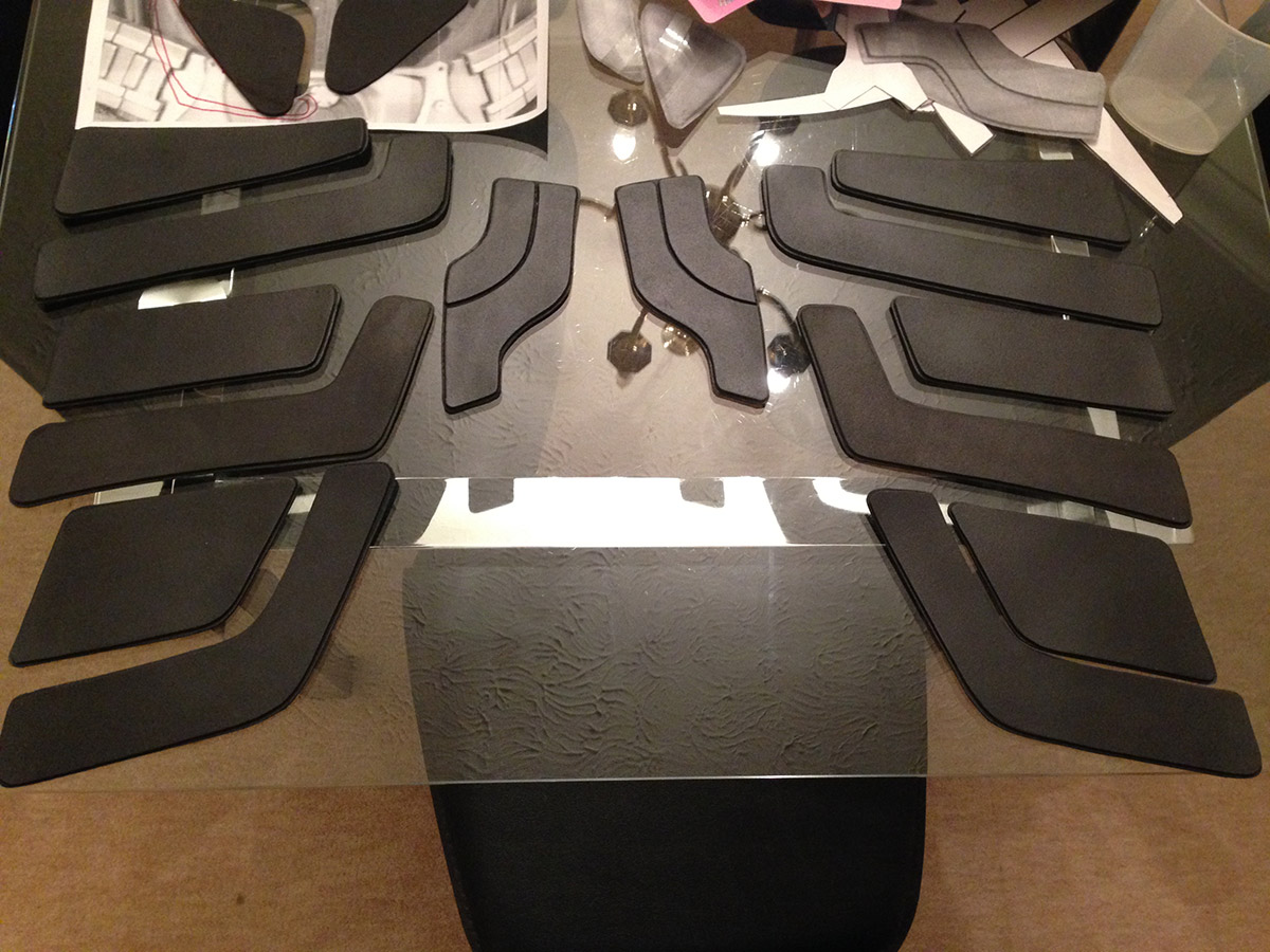

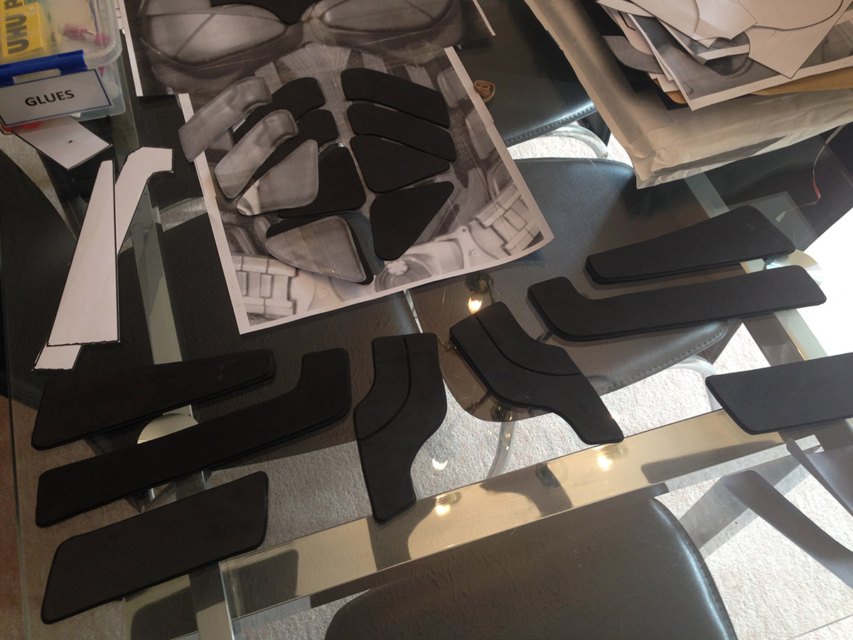

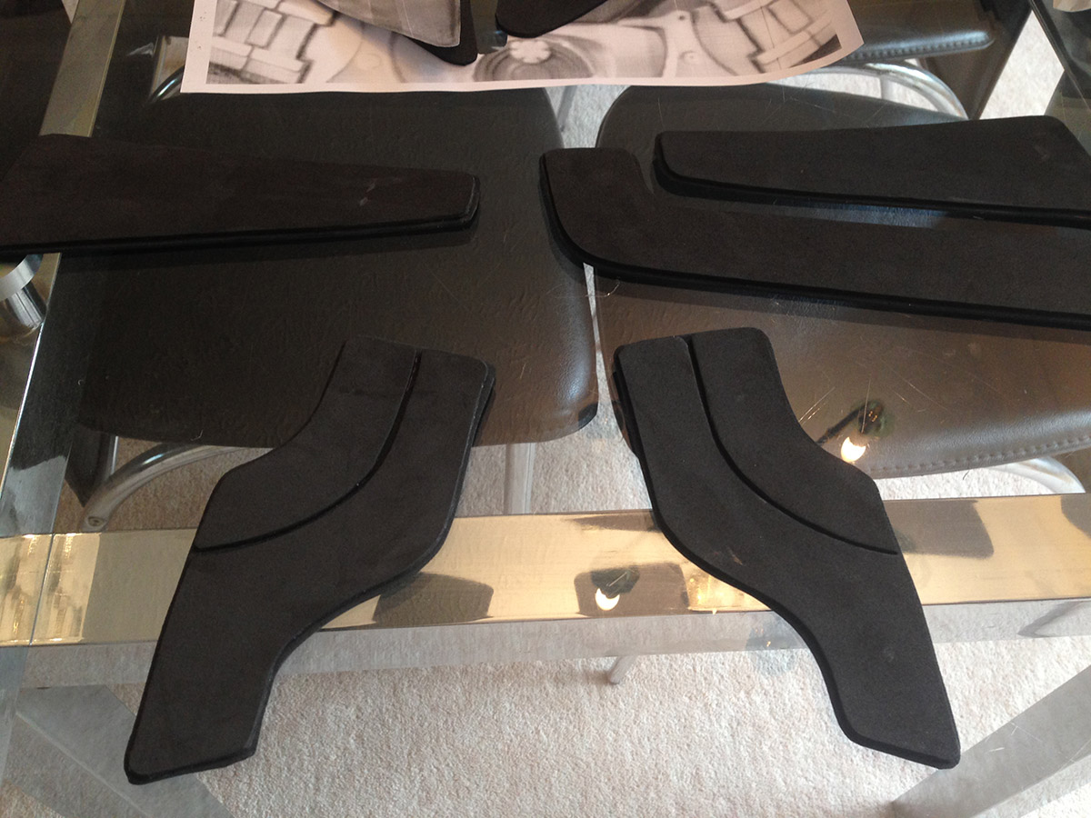

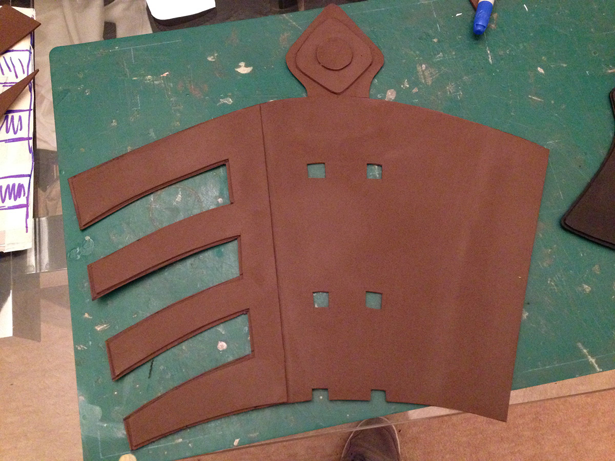

Where it all started, making the templates and began cutting out the 2mm craft foam. Doubled up on the leg armour to give it that more detailed look.
Took a while to get most of the leg armour cut and templates sorted.
Once cut out they were sealed with a warm iron just to flatten the foam a little, and then coated with two coats of plastidip. I kept them light coats to maintain the flexibility without it cracking off.

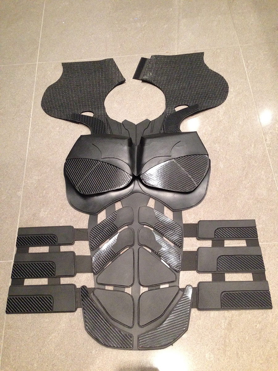

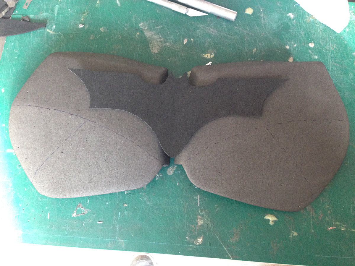

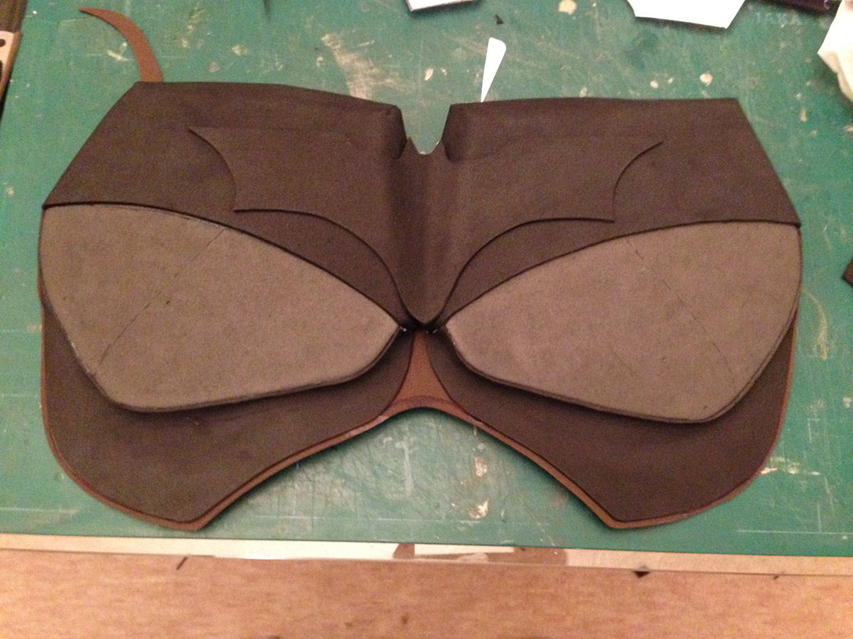

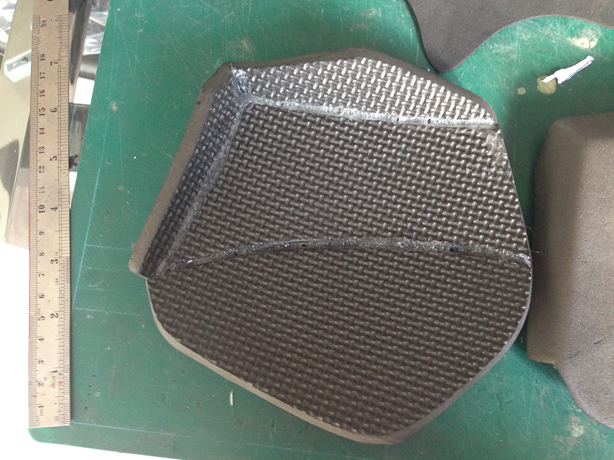

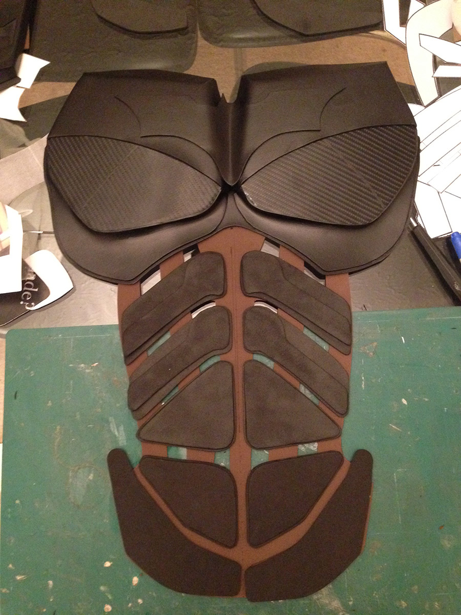

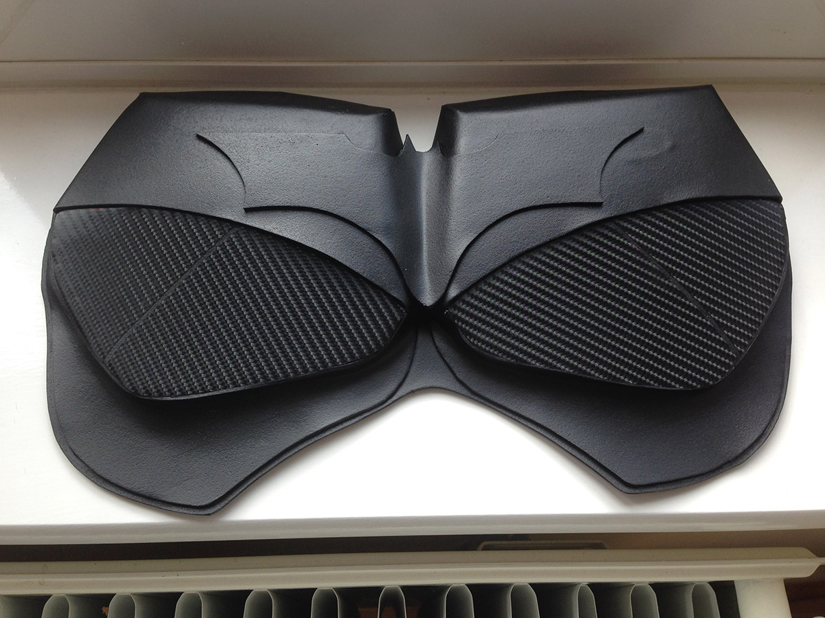

Next was to make a start on the chest piece. I used the same printed template for the pattern, got it right on the second attempt and used the method of cutting a V section in the rear then hot gluing to give it its shape. I also prior to cutting warmed it in the oven and shaped it by pressing into a saucepan lid to give it a little curve.
The fun bit was cutting out the bat logo !!!

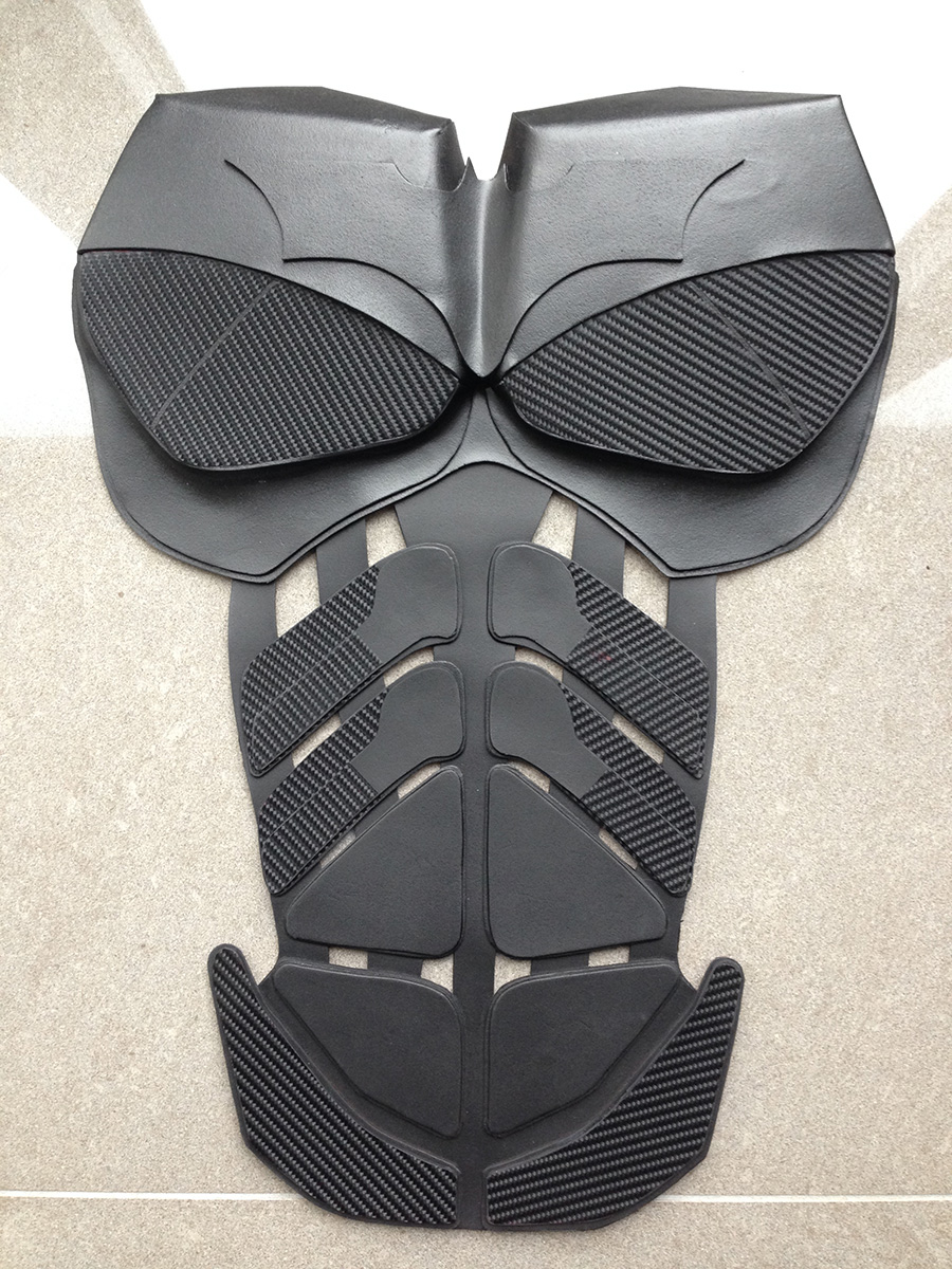

All plastidipped and with the addition of some carbon fibre look vinyl (4D car wrap off ebay) it looks a treat.

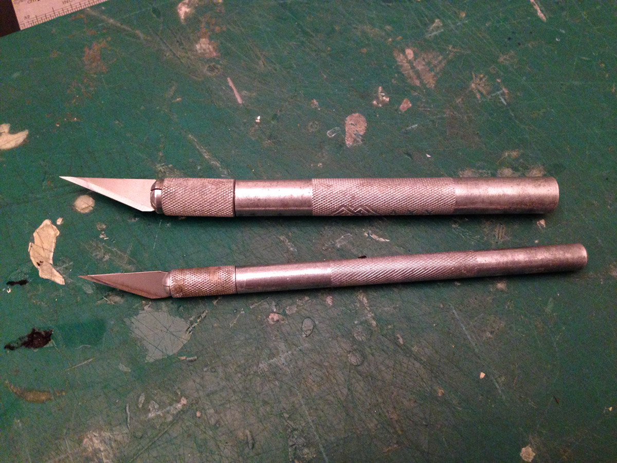

You are doing amazing work for your first time the cuts are beautifully done so clean. I can already tell that this build is going to come out Epic. Might I ask what you used to get such clean cuts?

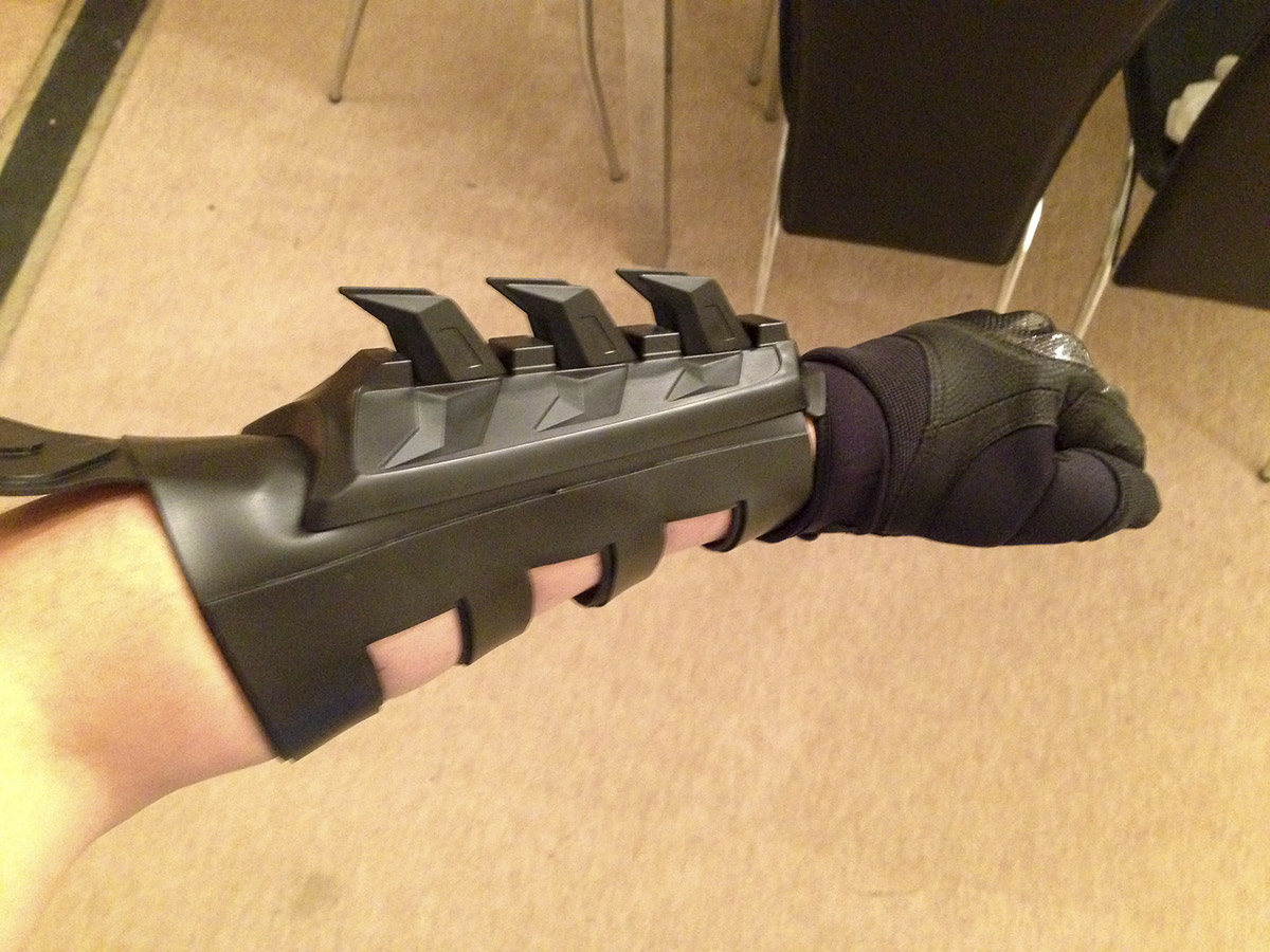

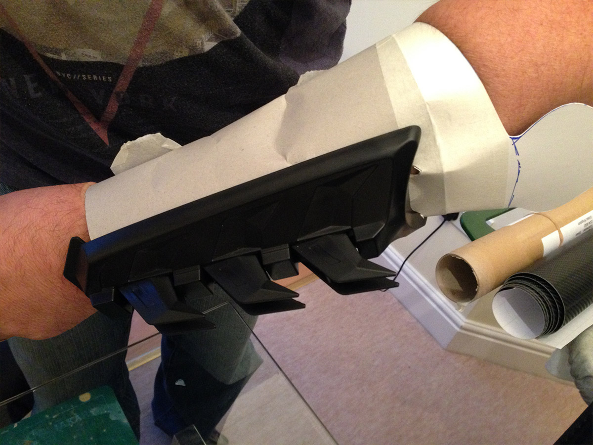

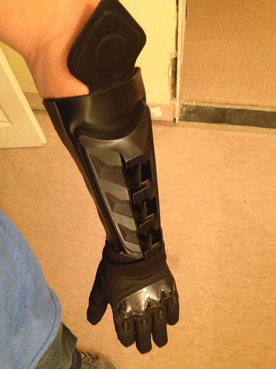

Next the gauntlets...and the discovery of the kids set on Amazon was a god send !
Started by making a rough template out of card, traced this onto foam, and doubled up to strengthen it and add features, once it was plastidipped and joined up it looked just the part, maybe a tad small but I can live with that.
Hi spazzman...sorry missed your post in between adding images. I cut out the templates and laid them on the 2mm foam cutting around the edge of the template a with hobby knife, kind of sturdy scalpel if you like, but kept fresh blades in as they soon get worn and start to snag. Some bits are a little rough as I'm pushed for time.
On the leg armour I cut around the smaller portion first (the bit stuck on top), then glued this to a fresh piece of foam using zap (CA glue) then cut around this leaving a border.
I found this much easier then cutting two separate parts , getting an even border would have been a nightmare.
I'll take pic of the knife if you need me to.......just let me know.

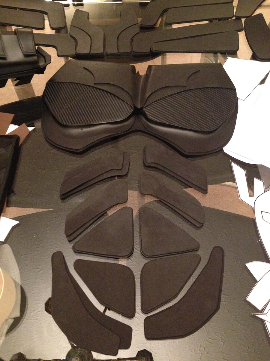

Next thing on the agenda was to finish the ab section.
Using the template I cut out the supporting foam that the abs get stuck too. This is where I'm at right now, need to finish that off tomorrow and also figure out how and where I'm going to attach supports to hold it in place around my sides.

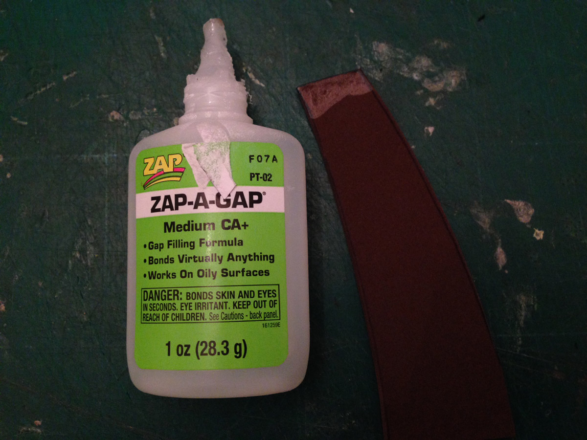

Very awesome thank you for such a fast reply I'll have to get myself a hobby knife now haha. Also just a quick question how fast does zap (CA glue) dry? I have been using hot glue and it is just a tad bit messy to say the least.
No problem.
Hot glue is okay i some areas but like you say its thick, and bloody hot ! I burnt my finger the other day.
The ZAP glue comes in different thicknesses, thin, medium and thick, the bottle colours respectively are pink, green and yellow. The thin stuff is water thin and good for wicking between surfaces, I use the medium, drying time states around 20 seconds but on the foam after about 5 seconds its on, so you need to align it carefully before any contact and lay it on. I usually lay it on dry, draw around the edge then use that as a guide to lay it on once glue is applied.
You could use the thick and I think that would allow you more slide time if you need to adjust its position. Its nice and clean though, and doesn't eat the foam.
To apply the glue a lay a bead around the edge of the foam to be glued, then use an offcut with a flat tip to spread it out and ensure a nice smooth even coverage. If it starts to go off a little thats ok, it still sticks like mad. Best to get used to it on some offcuts.

Finished the chest section, pretty pleased with how it turned out, the side bits warp round and are held in place by velcro on the undersuit.
Didn't manage to get the neck finished or in fact the shoulder armour :eek:(
Looks good though, hopefully will get a few pics later on in the suit.
