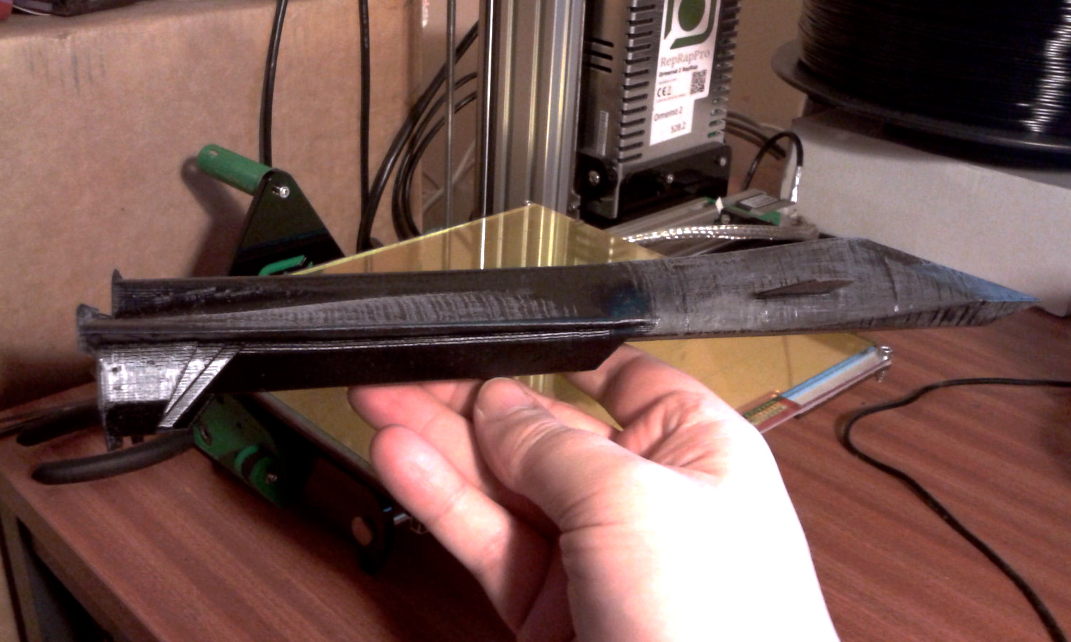

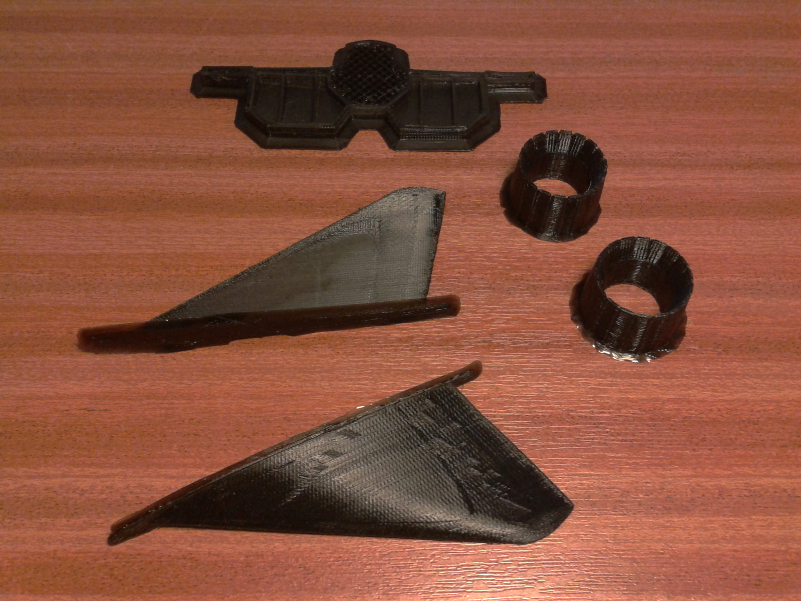

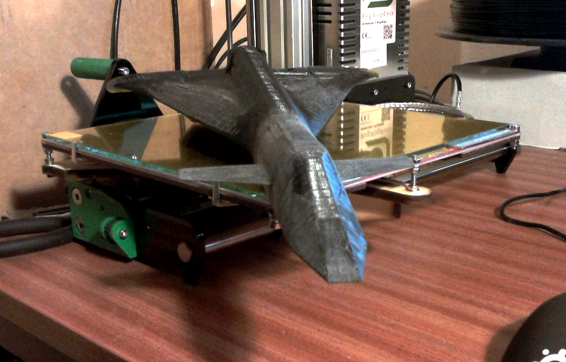

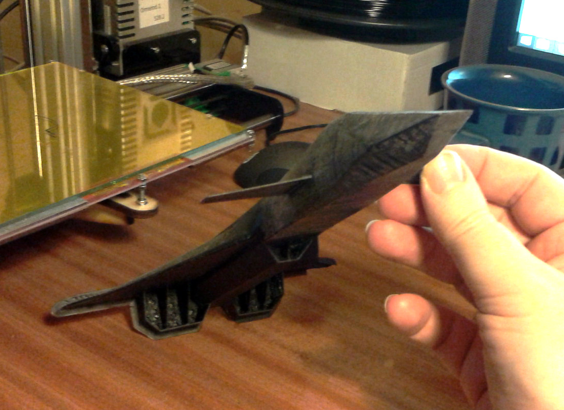

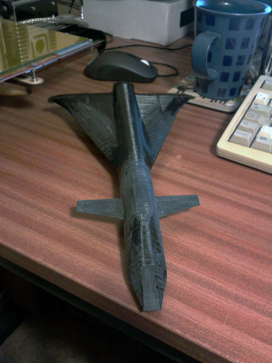

Spent most of yesterday breaking the model into sections to be able to print successfully. Have printed about half, these are rough and ready pics of where I have got to with a 1/48th test print.
2015-11-01 13.51.53.jpg2015-11-01 15.47.44.jpg2015-11-01 15.49.07.jpg2015-11-01 15.50.10.jpg2015-11-01 15.50.43.jpg
Realising for 1/48th small production I will have to get a master pro printed, the surface unevenness on what you can see is a fraction of a mm but still requires some work to get it perfect, black of course makes it look worse than it really is.
The co-polyester material does cause some weird surface artefacts that you don't get with PLA, however the parts are really strong and you can wet sand the surface. It feels like something between ABS and acrylic, and glues together brilliantly with EMA plastic weld.
Have yet to get prices, but have found a local-ish place that can do 0.016mm resolution in resin to cast from.
Printing wingtips now while working on finalising the engine section slice.

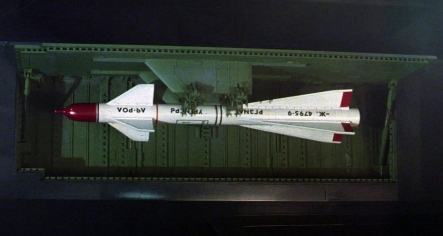

Missiles - I think they must have used some artistic licence with the missiles as they don't match anything I can find, the smallest Russian air-to-air missile is this:
http://en.wikipedia.org/wiki/R-60_(missile) but it is 2 meters long
The one being carried is pretty close to the correct scale size of about 1.2m long with the launch bay around 1.7m.
Yeah, missiles in movies have usually been made way too small or way too fragile looking (or the launcher is always way too close to people standing around if it's a ground-mounted missile). It's something that people into aviation always get ticked about.
I studied Soviet-block aerial and ground launched weapons for the DoD for a while. The missiles in "Firefox" were the creation of an art director, not anyone at the Detal design bureau.
Thanks for confirming my suspicion p51, I'm guessing they did the downsizing as otherwise it would only be feasible to have one missile in each bay, as it is the depth makes little sense as it impinges on where the engine should be. Would have made a whole lot more sense to have missile bays in the mid section under the fuselage when you think about it.

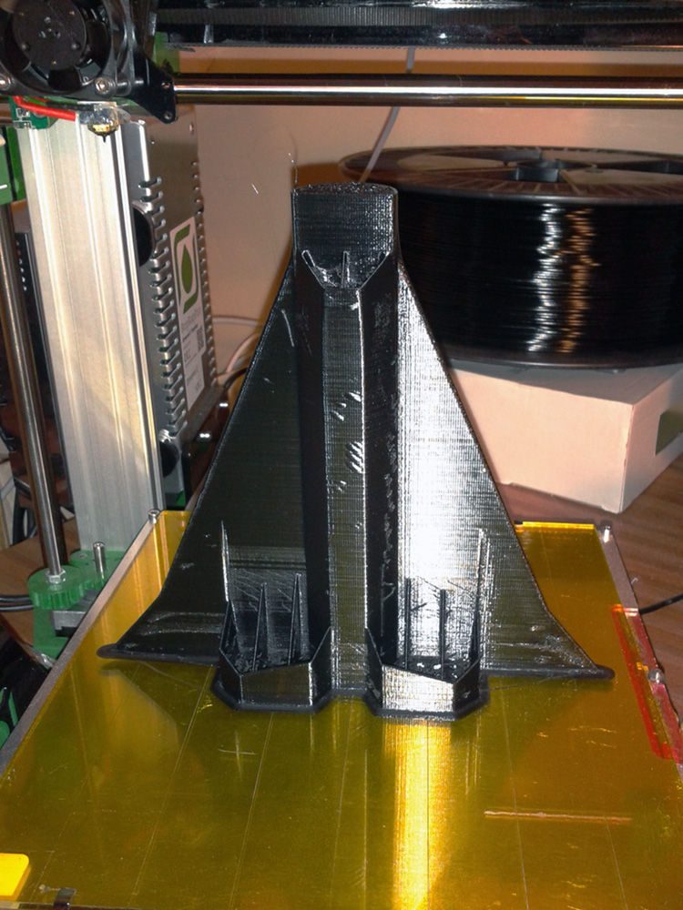

Yep you guessed it, now I have it in my hand in 3D I can see something I thought might be the case, it's not quite right, so fix and print again. Realised sectioning it slightly differently will help anyway, also have improved the print settings so I can print faster with less of the odd surface artefacts.
That main body section took around 10 hours, fine setting 0.12mm layers. I think I can knock at least an hour or so off that. Timing is a bit irrelevant as now I have ironed out a couple of bugs I can leave it printing overnight without the fear of coming back to a plastic horror show in the morning!

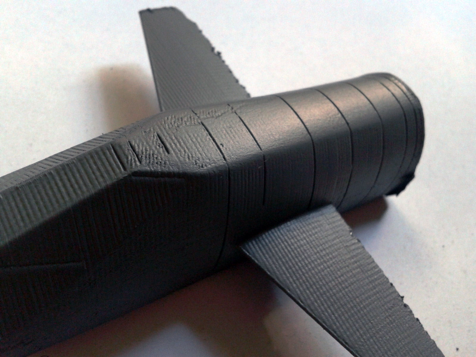

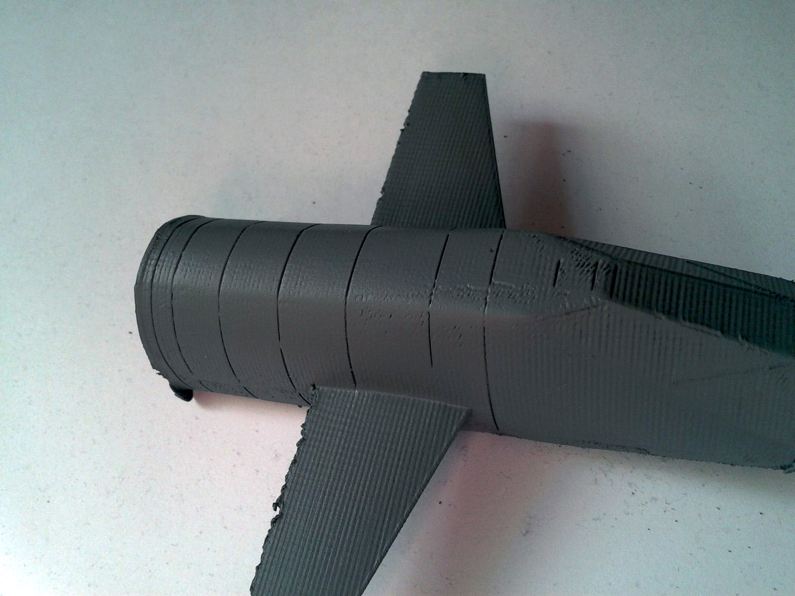

A Firefox nose with panel lines :D
Was a bit pissed off as the part came loose from the bed with about 5mm to go, hence no nost in the pic. Was my own fault as it nearly happened with the previous one, I had beefed up the under canard support but still not enough. Going to build a base into the model to ensure proper adhesion next time.
This is a very quick "pull part off bed, light sand, coat of plastic primer", so yes there is touch up to be done but really quite happy.
They are around 0.3mm at the surface V cut so I know I can sand a touch more before priming from this test.
The lines look more over scale in the pics than in real life. They will lose some definition in moulding and painting as a kit part so should be about right. I think any less and they either won't print right or will disappear under the paint finish.
No horizontal lines built into the print as when I tried it they don't stay sharp enough, easier to just do them by hand.

Quick update, spent most of yesterday working out panel lines, fixing the tailplanes so I can test print them attached to the model, and resolving the printing issues I have had.
Discovered as usual with complex systems it's a combination of things
1 Print head had dropped off vertical a tad due to a non ideal bearing adjustment arrangement, fixed with locking washers and a bit of 1mm hips to stop it moving again.
2 There is an optimum combination of maximum acceleration settings - set purely by testing as there is little documentation, fastest - which looks smoothest turns out is not always the best when the print turns more than a 45 corner, set this right in combination with a good print speed and corners come out significantly cleaner.
I'm guessing this is something pro machines have permanent settings for or they handle the calculations on the fly. I'm probably my own worst enemy here as I want perfection and the quality is still better than a lot of stuff I have seen printed on considerably more expensive printers.
3 If you change something important remember or make a note, otherwise you start a big print with too low a bed temp setting and your part comes off 2 hours in :facepalm see top of pic below

The wingtips were done with previous print settings, so they can be better I think. Exhausts are ok just to have a complete assembled aircraft, but needs pro printing really, or a simple printed support core to stick brass etched segments over, just brainstorming there.
Middle section currently re-printing as I have corrected (hopefully) the wing section, then get the engine section started over night, realised it makes sense to actually break it down into more segments so you can optimise the print settings.
The one that failed in the pic above was mostly down to a low bed temp, but realised the high cross infill in the fuselage section required to print the base of the small intake near the top of the part causes a tensioning effect as the upper part cools and pulls on the sides levering itself off the bed.
So printing that middle front part of the fuselage on it's own up to the rear of the canards, then rear of canards to nose separate so the canards bond to the bed and don't require wasted support material.

Have reprinted the main body section, found you have to print slow and enable settings which add more print time to get a better finish, took 12 hours, then another 3 for the front neck as I have called it.
Have spent an hour or so surface finishing what I have, looks like skimming the surface with the 3M red filler first is the way to go as it fills the small imperfections enough that one good coat of primer should do the trick.
The redone inner wing part is just about perfect now... finally. Holding it up to pics it matches about as close as I am going the get, especially as that feature does vary from model to model. There is just a little high spot in the geometry near the front, probably less than 0.5mm but it catches the light.

Jon, the 3M Acryl White Glazing putty is the best for this application as it is finer and tougher than the 'red'; it allows for an extremely fine feather and a great polish if desired. Used to be 'Acryl-Blue' but for some reason they left out the pigment and discontinued the blue formula... but same stuff otherwise. Granted, the formulas you have available to you in the UK may be different... I just found the red I could get here in the US to be a poor product for modeling work.
