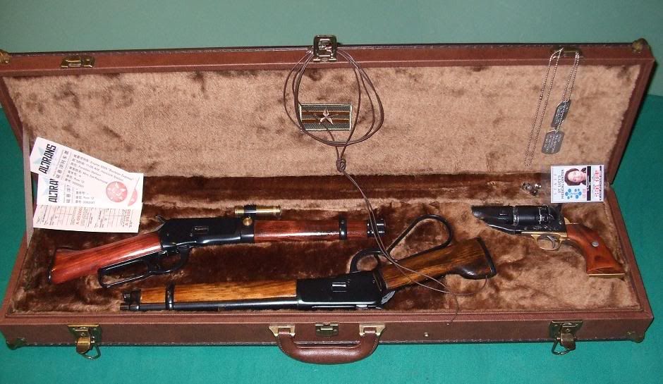

Because I'm taking some of my prop collection to the 2011 Browncoat Ball Prop Museum,
I want to have some nice displays finished.
One that I'm working on, when I can, is for Zoe.
The Zoe display will be a case for her three main weapons,
the Firefly Mare's Leg,
the BDM Serenity Mare's Leg
and the Firefly pistol she carried in the cross-draw holster.
This pic shows the foam "nest" I made, now I need to find matching brown fur to upholster it.
I've actually finished this, just haven't taken a pic, yet.
Mike
My Firefly/Serenity Collection:
SerenityMovie.net :: View topic - Firefly/Serenity Weapons Collection
I finished the Zoe travel case by sewing two pieces of the original fur together.
I couldn't find a close match, so I had to c-a-r-e-f-u-l-l-y strip the original fur off an interior panel.
I can see the seam, but it isn't real noticeable unless you know to look for it.
