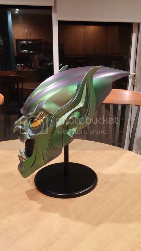

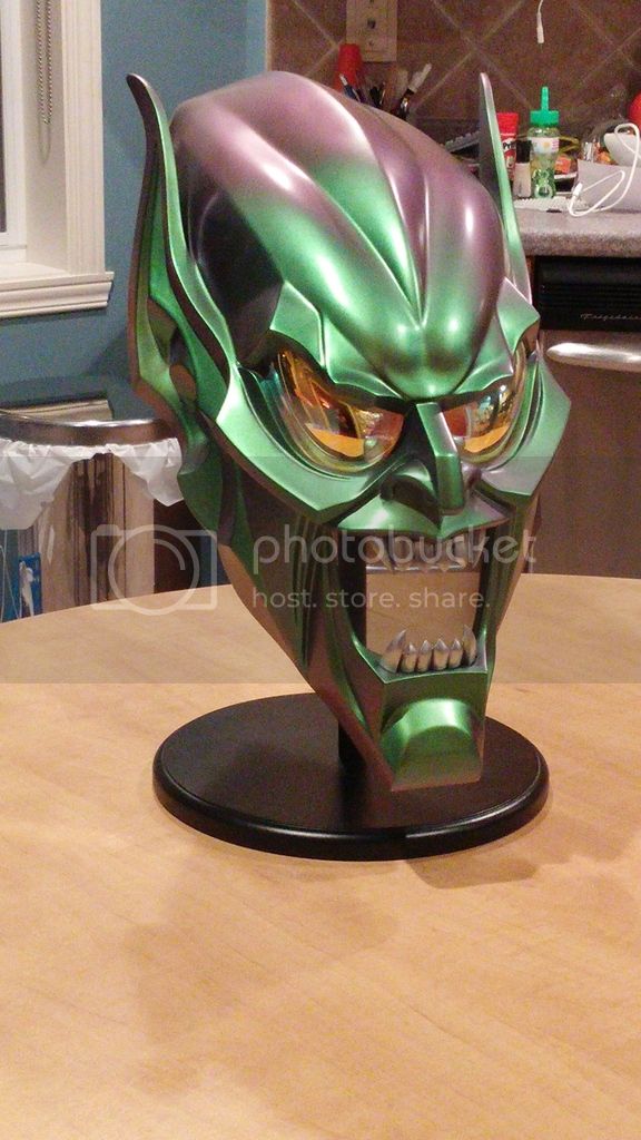

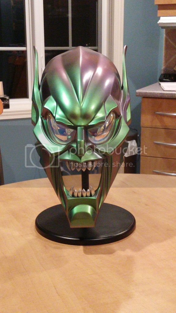

Here's my Green Goblin helmet with correct movie paintjob, this was by far the most difficult helmet to match the paintjob, the paintjob is what makes or breaks this helmet, I only seen a handful with correct paintjob, the paint alone costs almost as much as the helmet kit :(

GRINCH
Can you post what paint(s) you used? Also did you use a high gloss black or silver as your base coat?

Its been a while I dont remember the brand of paint but it was a shift color paint very very expensive, a small can just enough for helmet $300 applied very thin coats 10 total over a silver base coat, the paint is very translucent so you build up until you start to see color shift, the first 4-5 coats you dont see nothing as you apply you start seeing the purple/green colors amazing color shifet effect paint, once finished I sprayed whole helmet with a satin clear coat like movei original.
It was a Silver base, I had tried black but was way too dark totally different results, silver is 100% the way to go.
