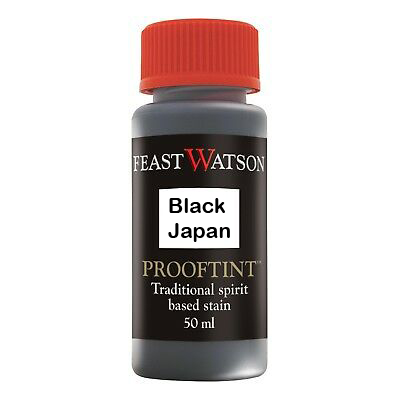

Jamie Staff I loved your videos. I watched the whole series during my Samaritan obsessive period. Thanks for posting that one. I'm super curious about the black japan wood stain. Do you have a source?
Thanks... It's a Feast Watson Prooftint Black Japan oil-based, I just got mine for my local hardware store, I'd guess that the brand probably wouldn't make much of a difference, providing it is oil based version. Do let me know if you need help.
