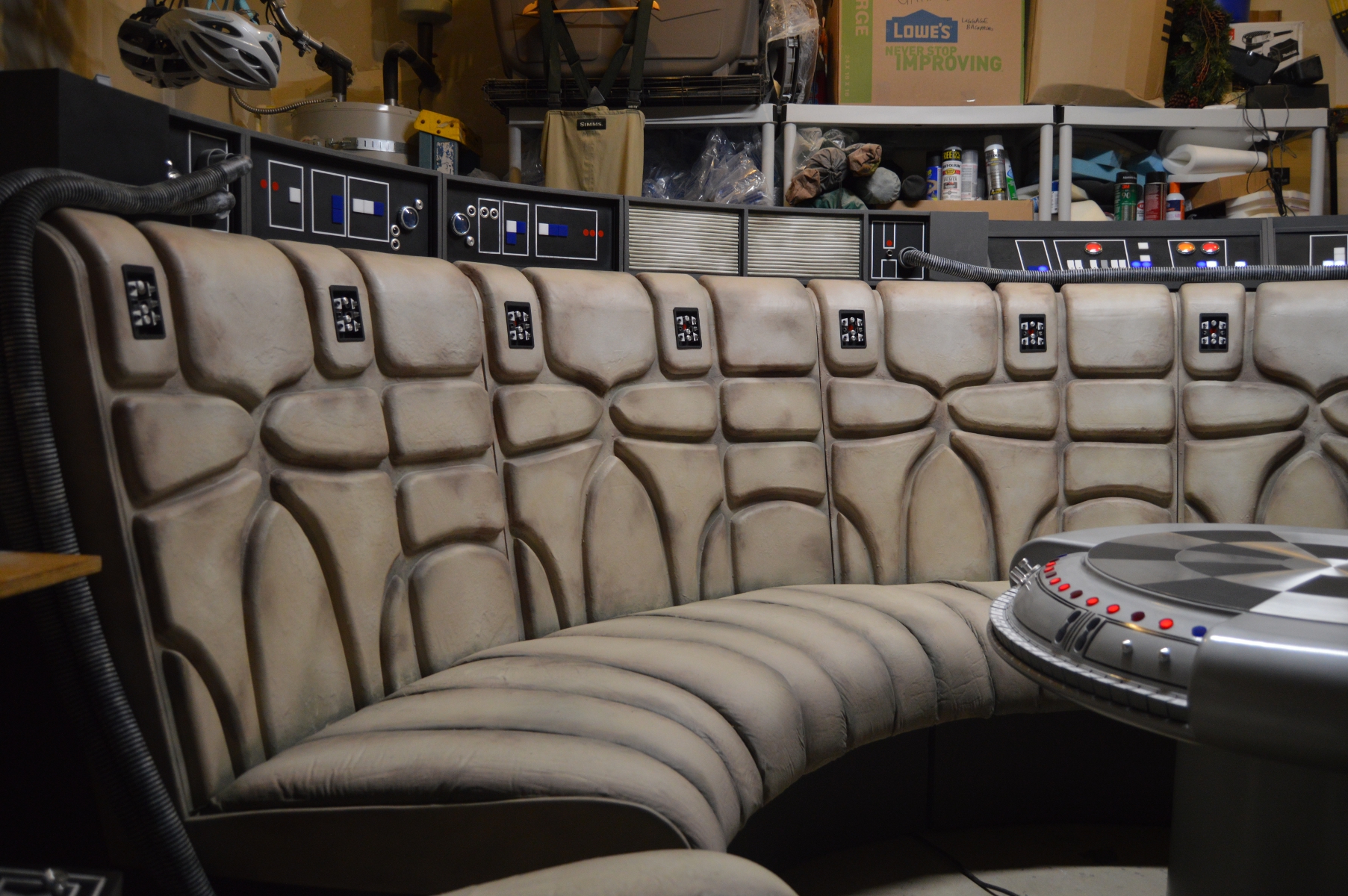

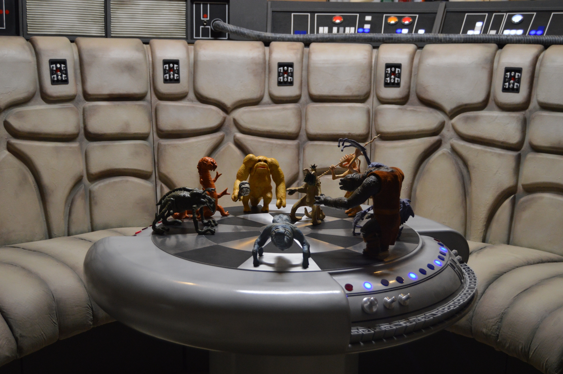

Alright, here's the finished product! I should definitely mention I could not have finished this bench without the monetary donations from the members of Garrison Titan and a good friend Micheal here in town who has spent nearly every weekend in my garage assisting with the project, usually being assigned with the not so glamorous stuff. He has poured so much money and time into this along side me, and I can't be more gracious.
Combine this with the "functional" table I created last year or the Augmented Reality application my friend/developer Adrien and I are working on, and it becomes something magical:
Thanks for following along!

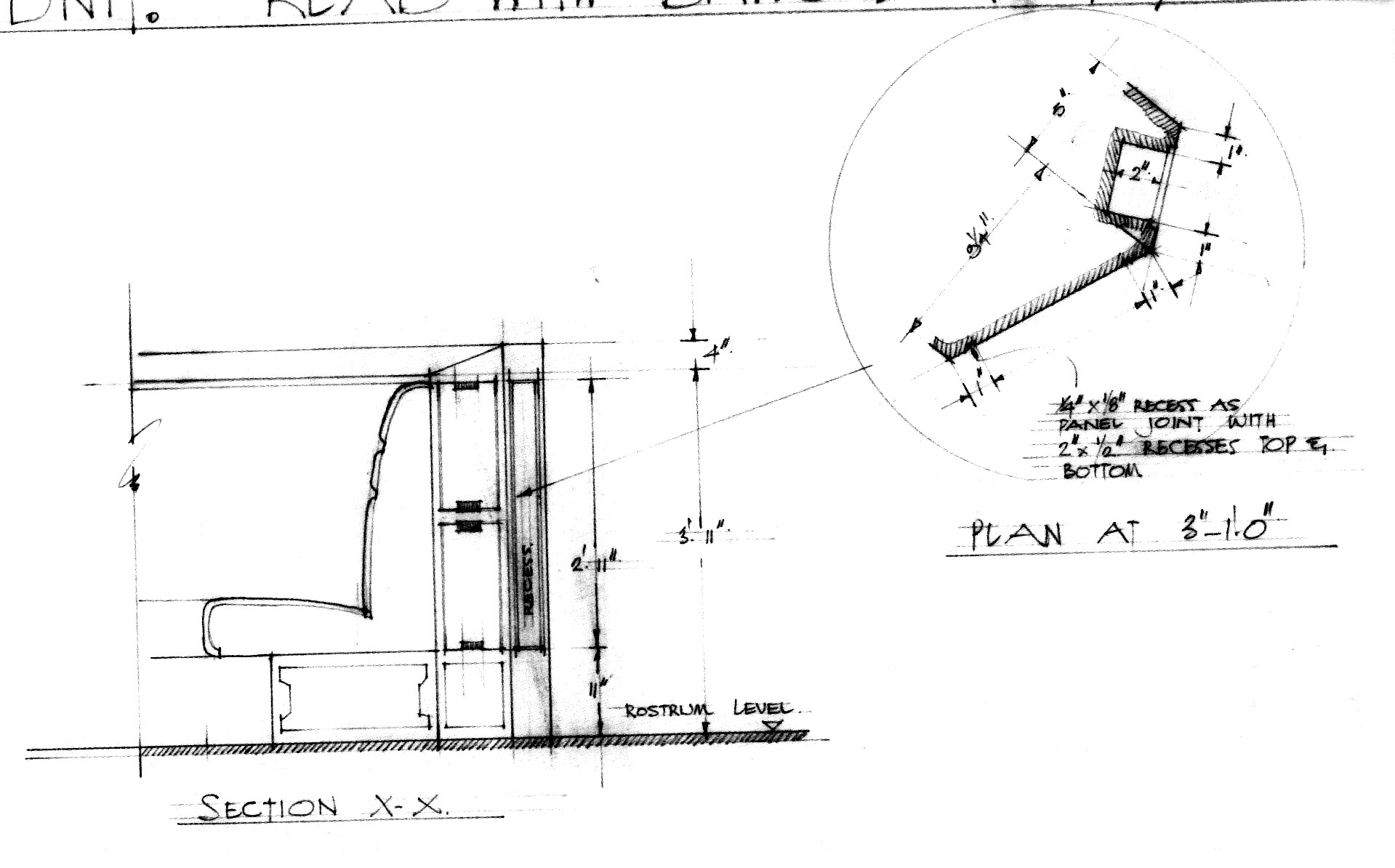

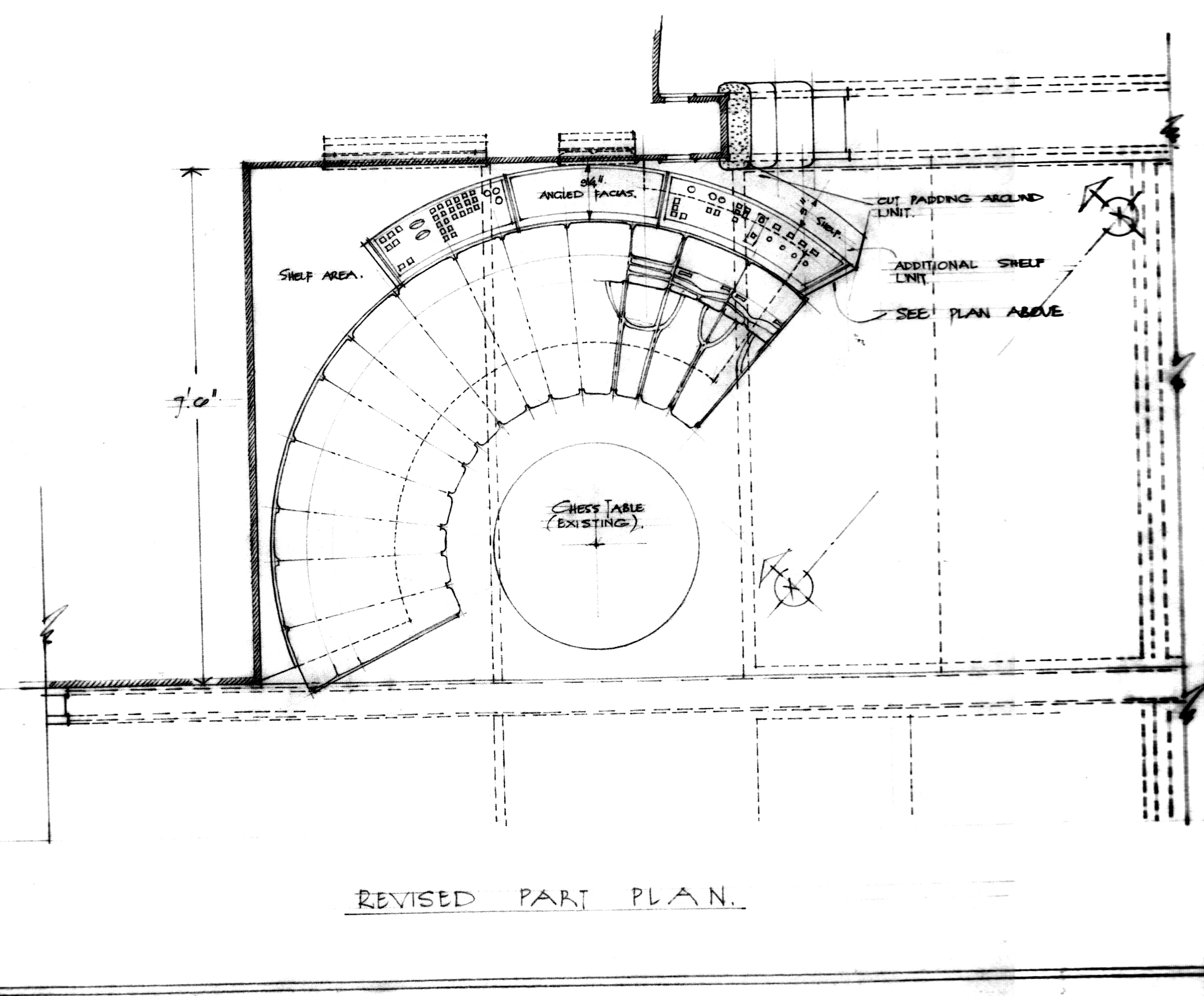

I'm using dimensions found in these blueprints (This thing is big):

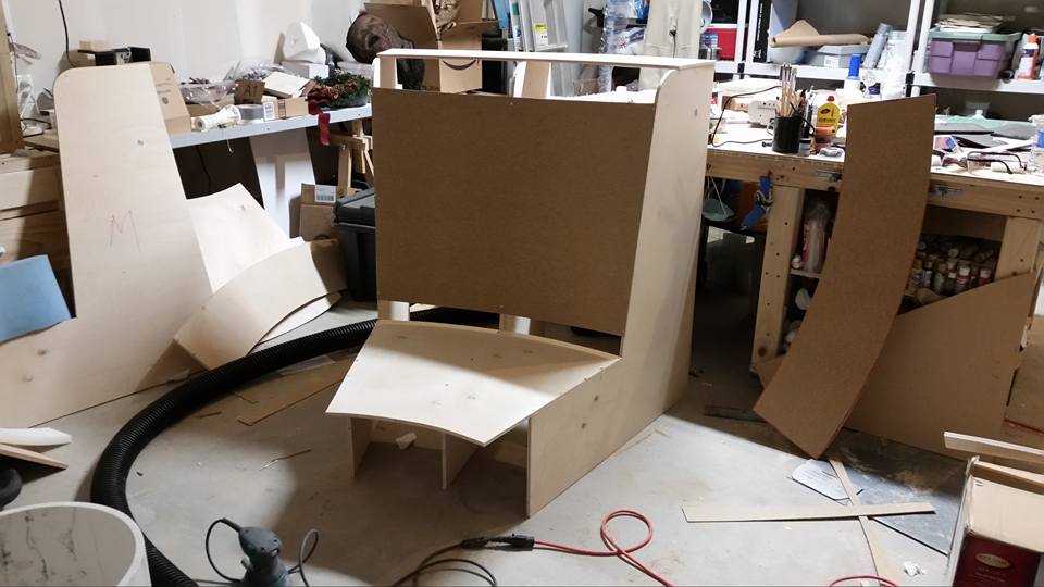

I've designed and started to build a basic frame:
falcon_bench_frame_model.jpg 7370_10156364724295527_6971345357263507048_n.jpg

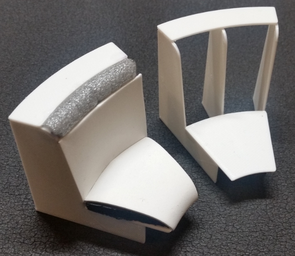

Making progress.
My printer was out of commission for a while, But I got it working yesterday and started prototyping the cushion greeblie:
Re: 1:1 Millenium Falcon Bench Build
very very cool! I am excited to see this come to life. Love the cushion greeblie, I have been wondering how to build those for my own bench, fantastic!

I've finished framing out the top boxes, and decided I might as well make the ottoman/detached section as well.
I've mapped out the greeblie/light placements and started drilling and assembling the lights. I've made some custom circuit boards and housings so I can program the lights.
I had a group of friends over this weekend to help cut out the remaining seat cushion parts. I use a 3D printed routing bit to shape the edges.
