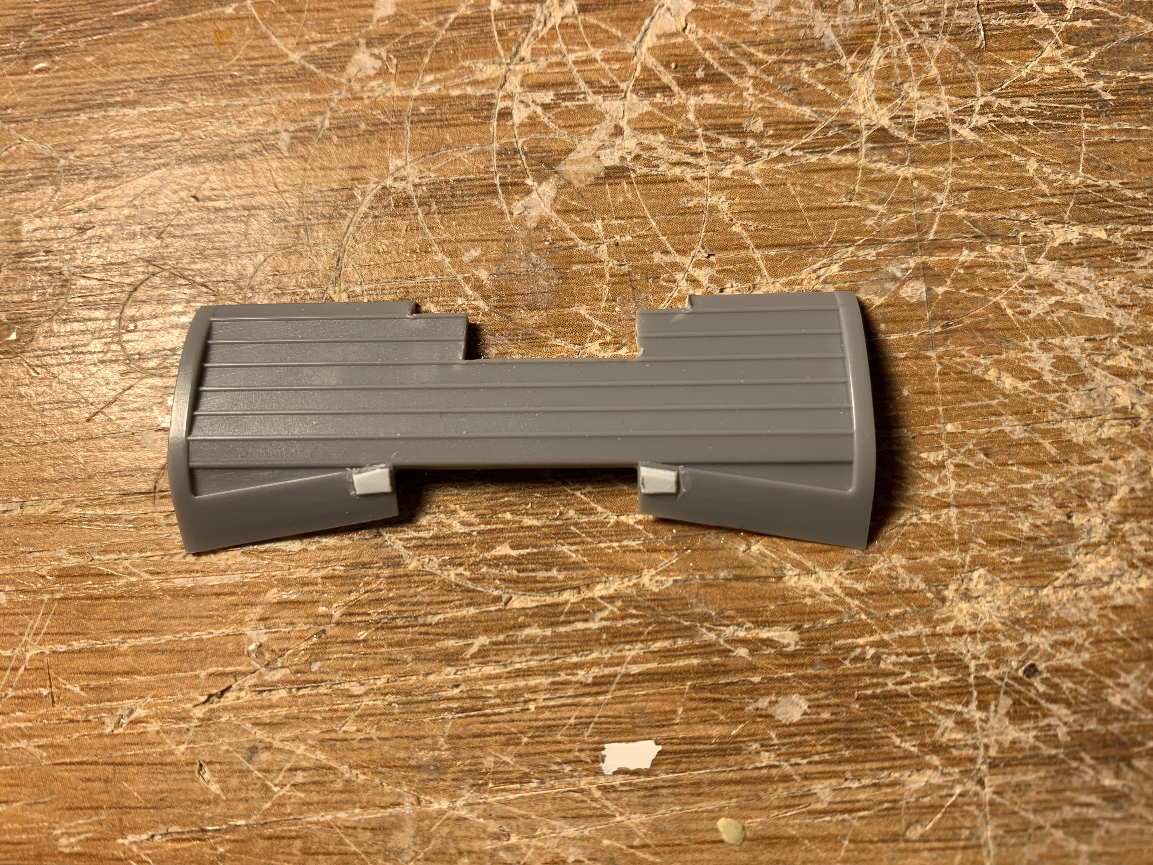

Here is the front stabilizer. I cut a larger notch along the top to better match the studio model and added the small bits on the bottom flares. There is a notch on the inside edge of this piece that is present on the studio model, but without heavy modification to this piece, I see no way of creating that.
