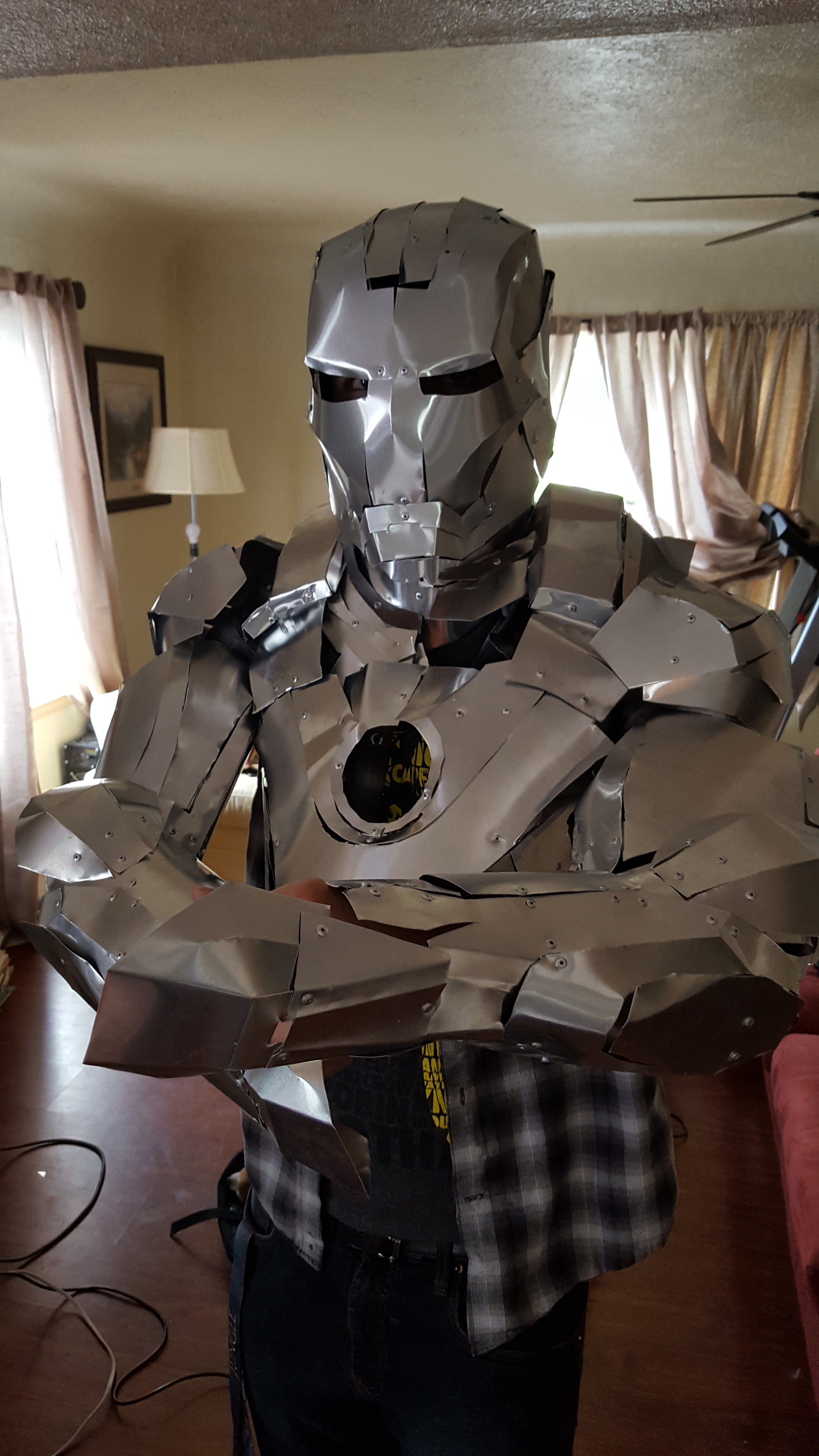

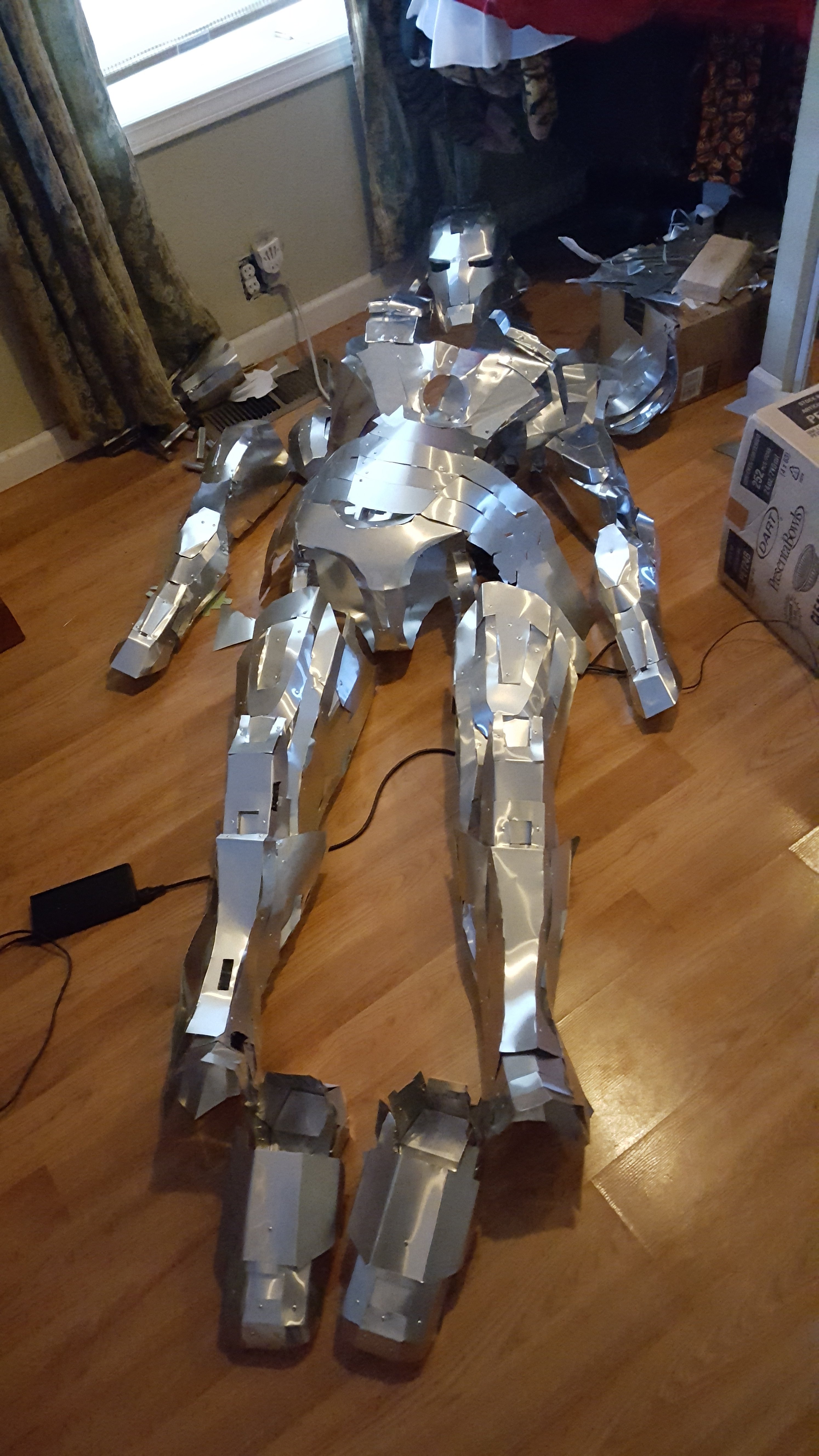

So decided to create this little info sheet to assists anyone in wanting to make a thin metal based suit that requires no skills, since I couldn't find one when I started wanting to make one. I like the idea of the costumes being able to last a thousdand years or so, sounds interesting. So while these can't compare to sand baggers welded suit I can't help but appreciate the shine that aluminum suits can have with minimal skills required.
First got to say thank you JFCustom for your quality work, ended up using your karol modified iron man build. Must admit I do regret not using a more detailed pep file about midway in due acquring a few skills/techniques that would allow me to make a more coplicated suit but chose the easiest build I could find and went with it when I started.

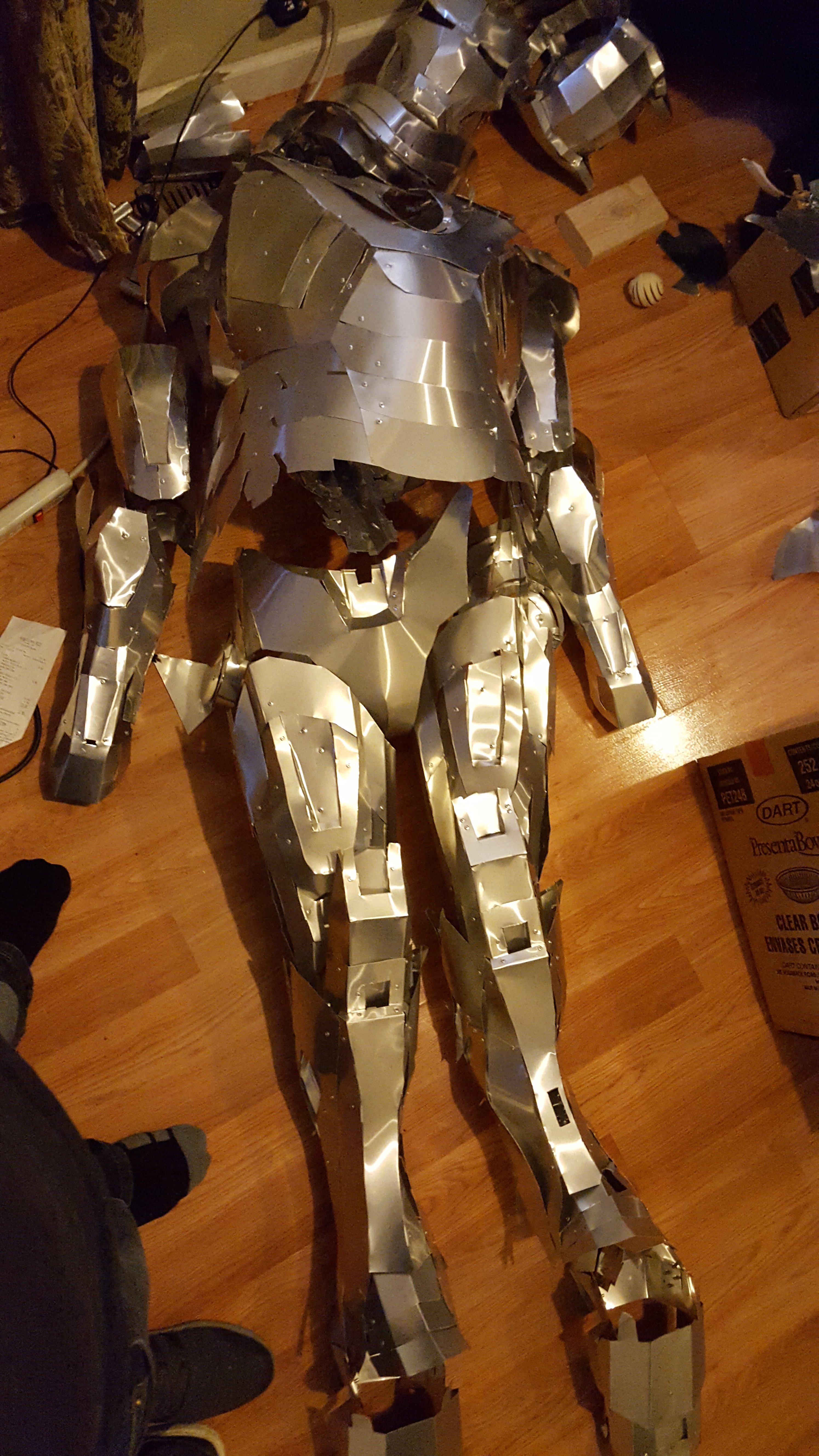

Just today I finished making the suit wearable, by combining the chest pieces together and putting on the peices I hadn't tried yet to see if it all fit. Had to modify the cod peice as my hips/thighs were larger than the unmodified version. Overall, this took me about 2 and a half months but largely only a total of 140 hours or so. And not including all the parts I ended up not using due to failures I spent about 100 dollars for the full suit. Even played around with some other projects in the mean time.

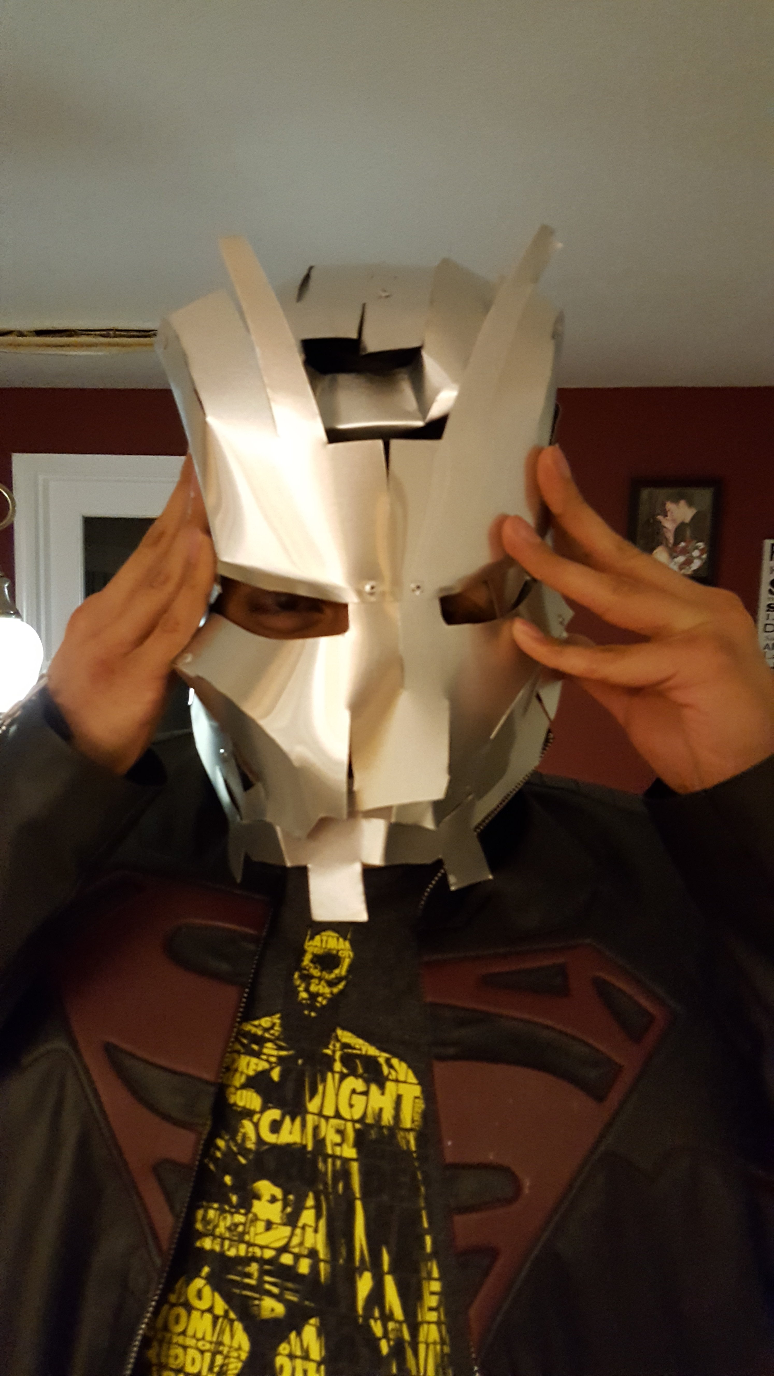

45 dollars amerimax flashing, the 9 thickness one, the 7 i tested for the helmet and it worked fine but liked the thickers feel, also bought some gilbraters aluminum flashing but can't help but notice that the parts made from these materials oxidized

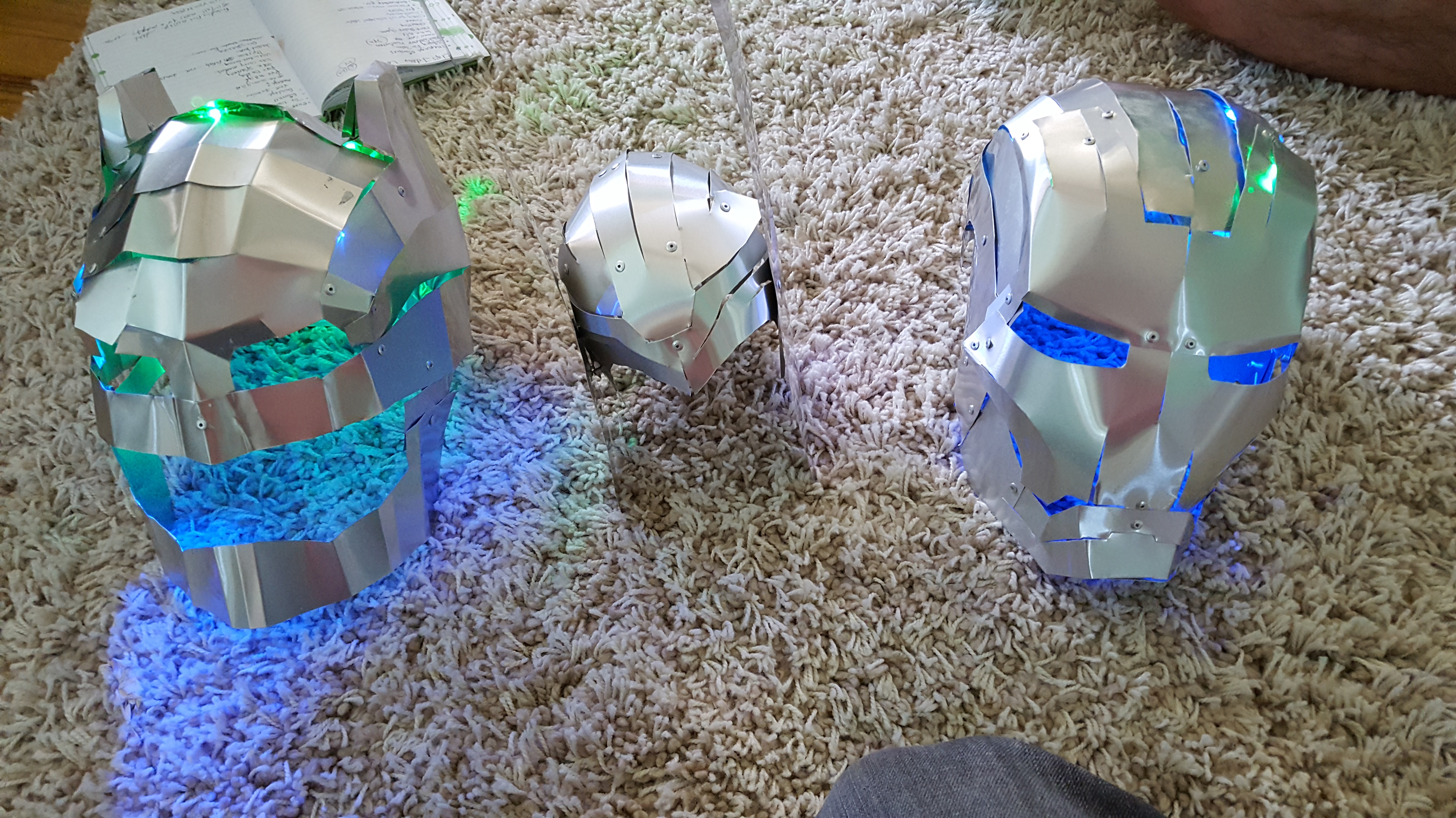

0 lights not necessary, thought they were fun, 5 dollars from amazon

At the moment I think thats everthing I used will modify if I think I missed something. Overall if having drill I expect anyone to be able to make a version for about 100 dollars out of aluminum.

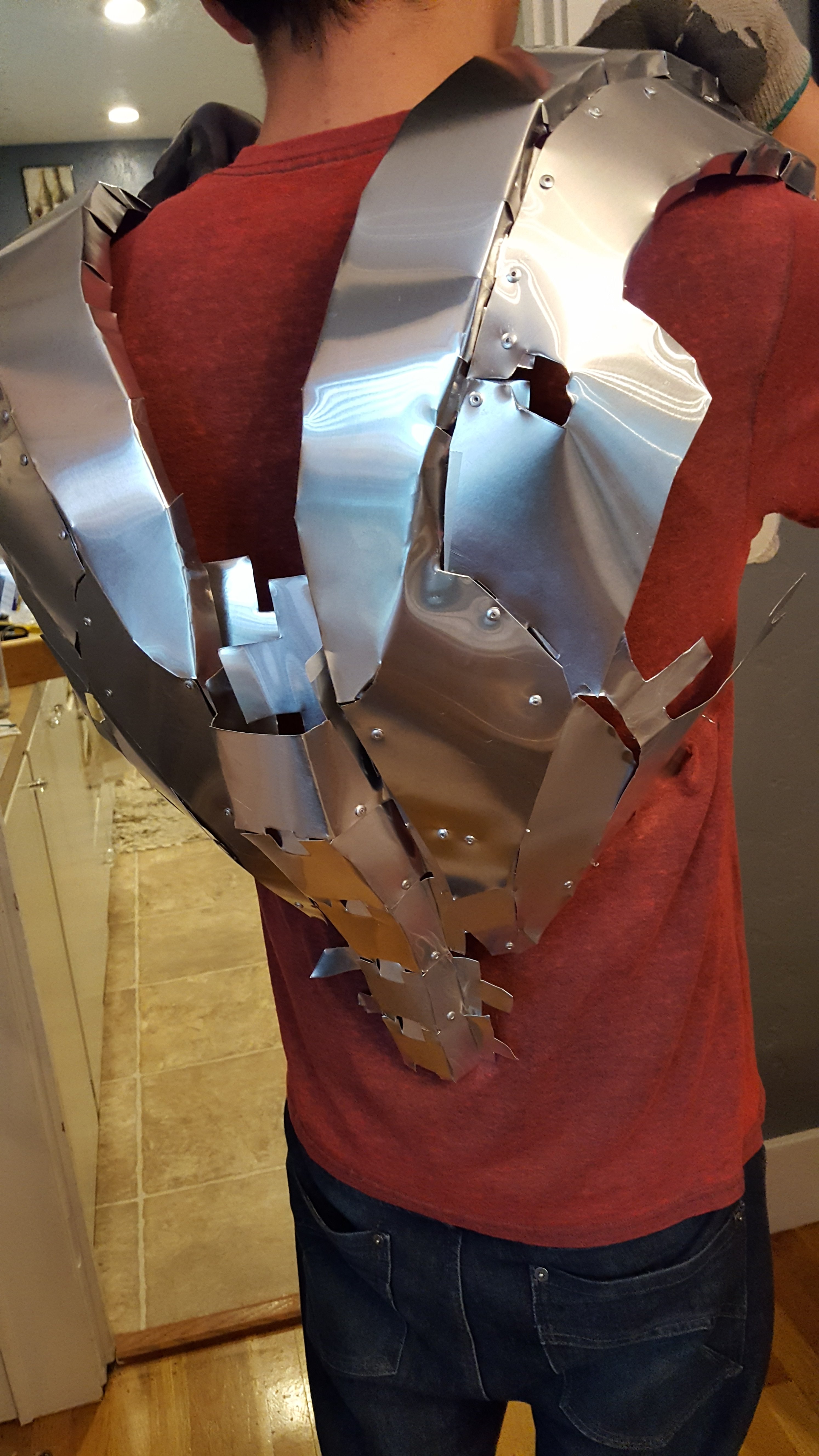

The crooked head of full build is the lastest image. To tired to put on full suit today, but wanted to post it after a long day of attempting to make it wearable, not just got to keep removing sharp edges where I find them.
Oh ya overall damage is not to bad when wearinga thick shirt and pants, just makng sure to grind down any edges with nail file and remove and jagged edges you making at the cutting step as soon as you see one, it will save your fingers, learned that after shredding my fingers.
Also, something I liked to do to make the work easier was modifiyng the files when in paper by adding small sections of to where that section conneced with another, far easier and faster then putting a new section in between both every single time, goes from 2 rivets 2 one and less likely to do a mistake.

Ha, ya managed to get quite a few nicks, with gloves on though generally no cuts happened. Managed to get about 10 cuts that bled in the end. Main thing I learned the aluminum is not that sharp once you made sure to clean up any jagged edges you make while cutting as you go, and to sand down/cut/bend any of the corners. As the actual edge is relatively safe, the neck piece is one I made sure to smooth out and it works well and can use it safely.
