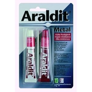

and for wider gaps that need structural reinforcement I first apply some two component resin glue
http://ecx.images-amazon.com/images/I/41znS4uUgkL._SL500_AA300_.jpg
the combination of those two realy work well for me, because the filler really likes to stick to this glue. But of course I don't know, if those brands are availible elsewhere.. ^^
