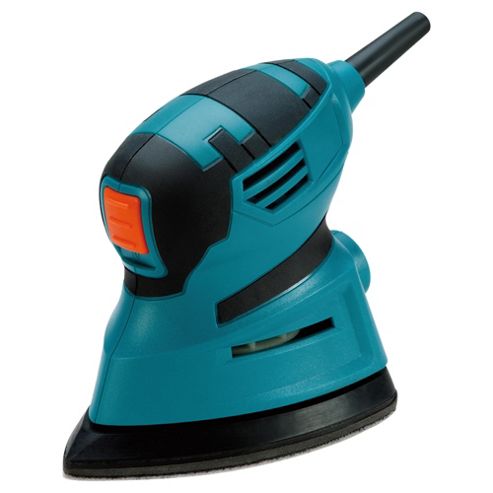

I had the same sort of problem with my space marine. Use latex caulk and just keep applying over and over. Just let it dry between each application. It takes quite a few layers to make the seam disappear completely. Just remember to sand the whole thing thoroughly before you start doing it. I used one of these sanders and it worked great.
293-3746_PI_TPS1406995
