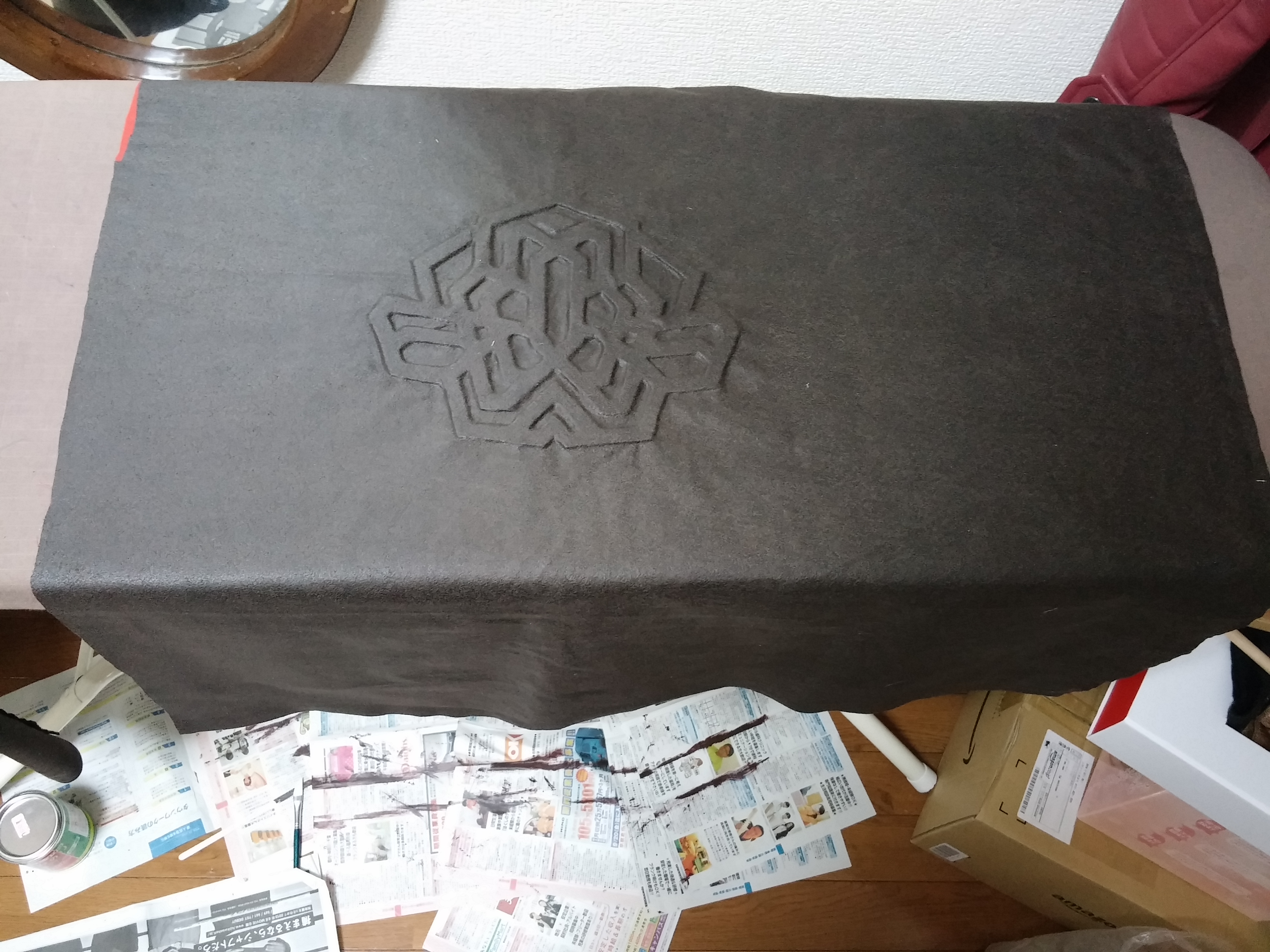

The big issue was that raised pattern on the knee. The movie costumers had a fancy set-up; they laser cut leather and sandwiched it to get the effect. There was no way we could manage that. What Feikoi decided to do was cut craft foam and sandwich it between two layers of fabric, using contact glue.
Here's the proof of concept test piece.
The sandwiching was done before the pants were cut out and sewn.

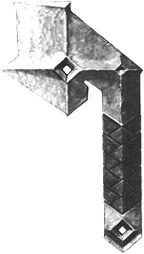

Fili's throwing axes are kept in boot sheaths, and the design again is easy enough to find on the web.

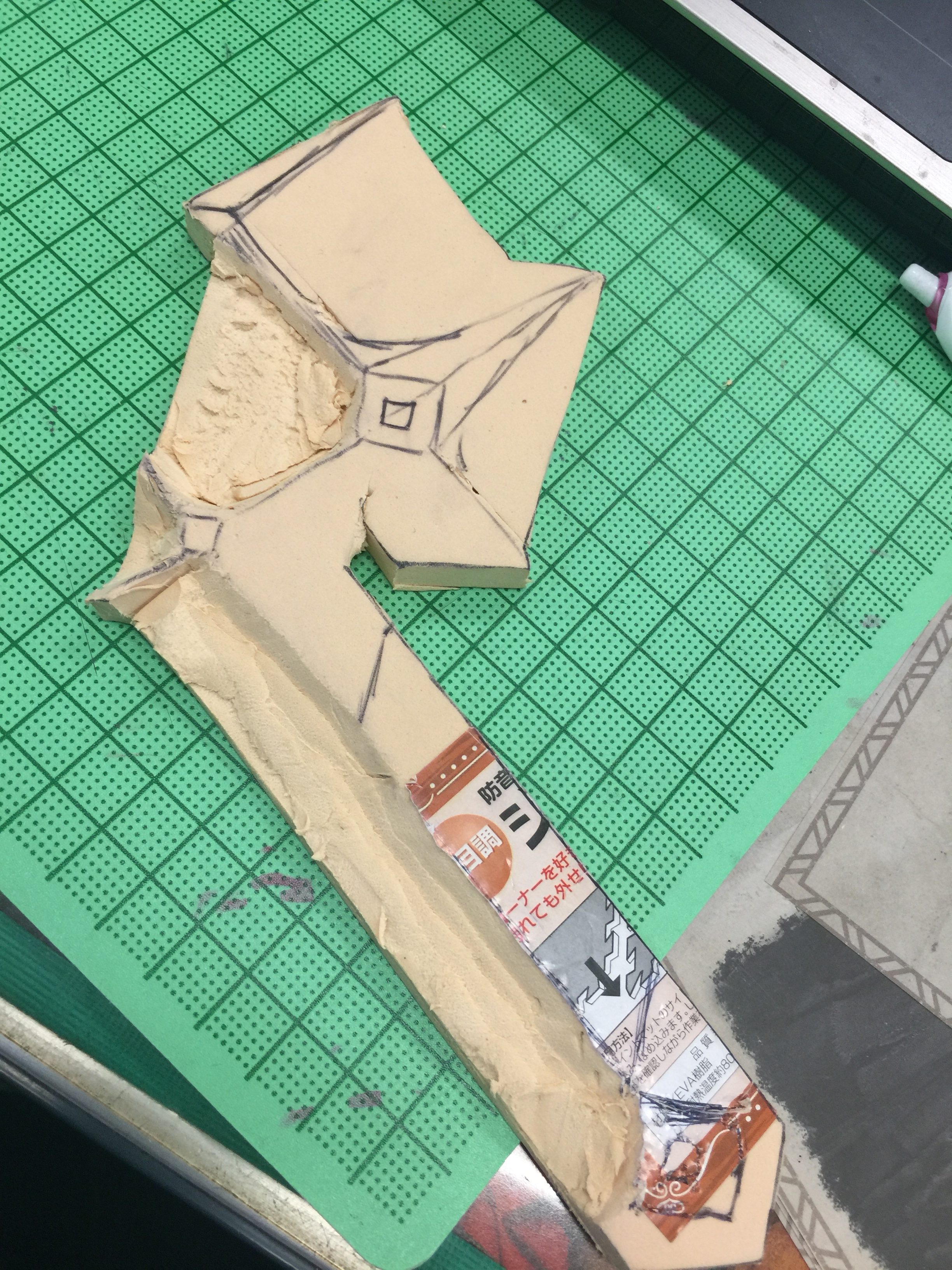

We had 3/4" floor mats and I attempted carving those with a craft knife (again, no Dremel tool at this point) and failed utterly.
With a 'screw this' frame of mind, I decided I'd cut them, do a little basic carving on the edges to make them sharper and just gessoed and painted them.

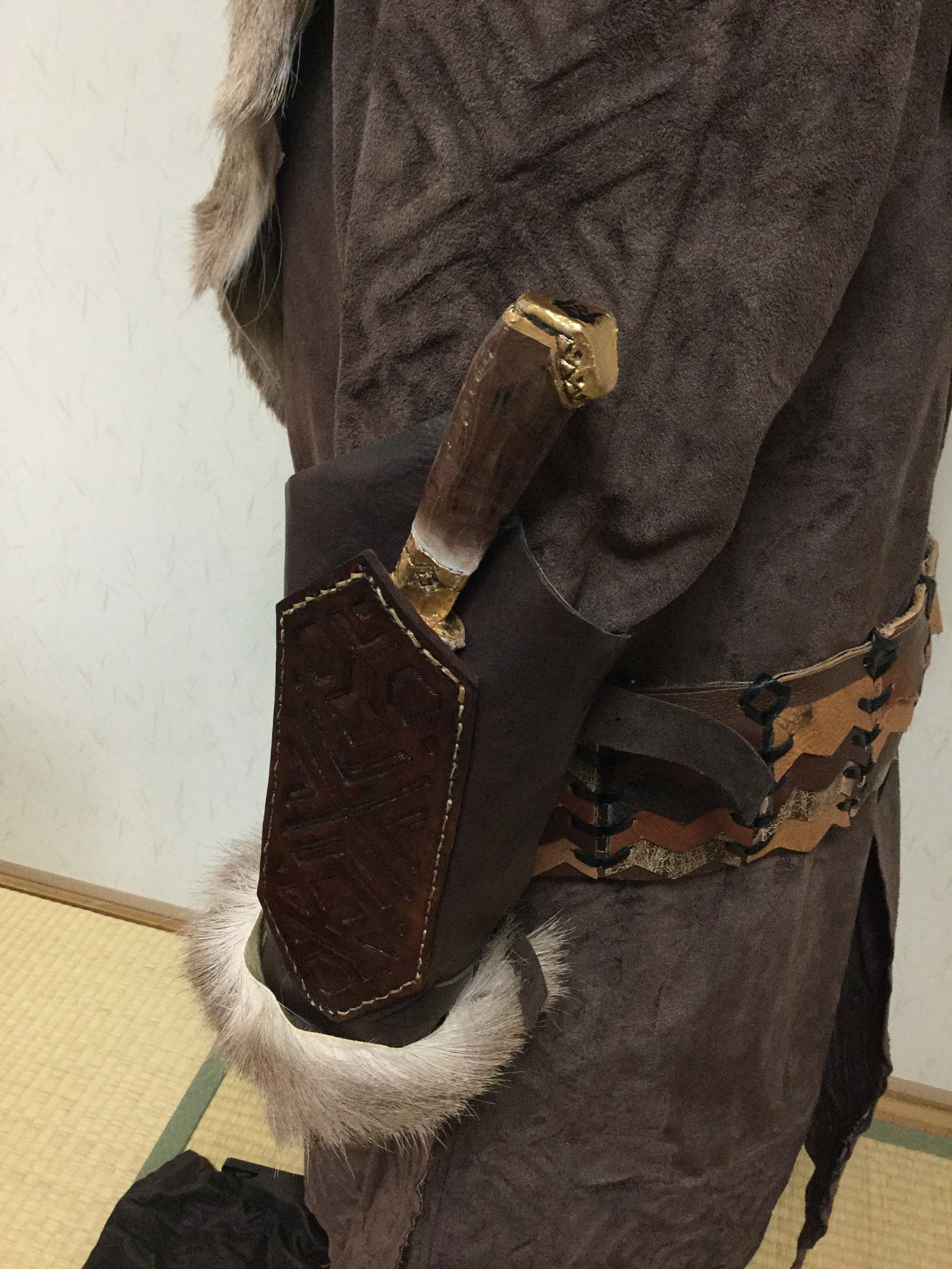

For some of the extra knives, pocket sheaths were sewn into the lining of the coat. We haven't figured out what to do with the leaf blade that goes under/in his hood yet, though.

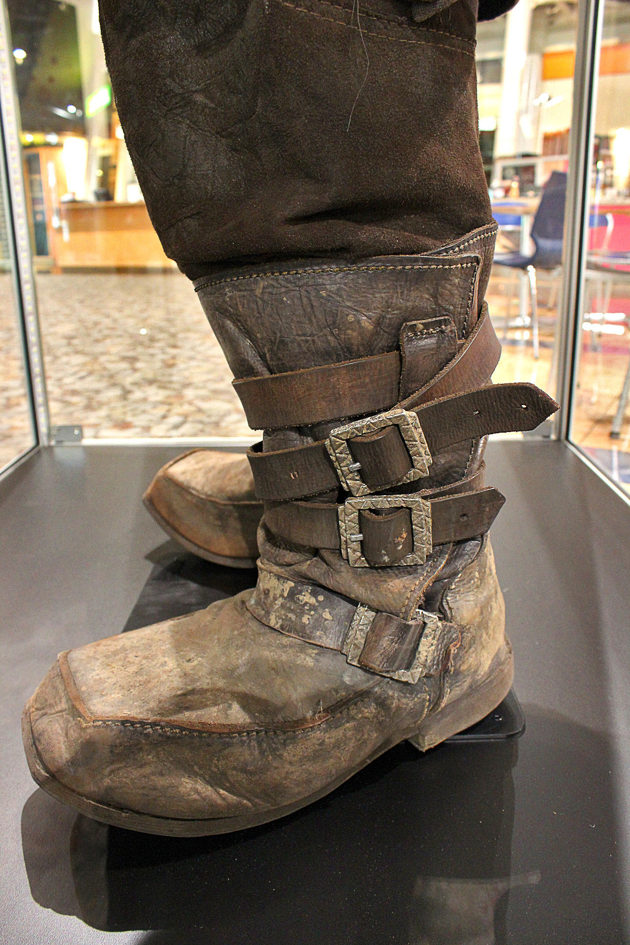

Production boots:
2014-12-29 15.07.11.png tumblr_nh48zgvp3z1r3vnt3o5_1280.jpg tumblr_nh4as93LJX1r3vnt3o9_1280.jpg tumblr_nh4as93LJX1r3vnt3o2_1280.jpg
Feikoi was lucky enough to find suitable boots with straps already in place in the States, so not much needed to be done to the boots aside from adding the axe sheaths. They were a touch tall, so the tops were folded in to correct height.

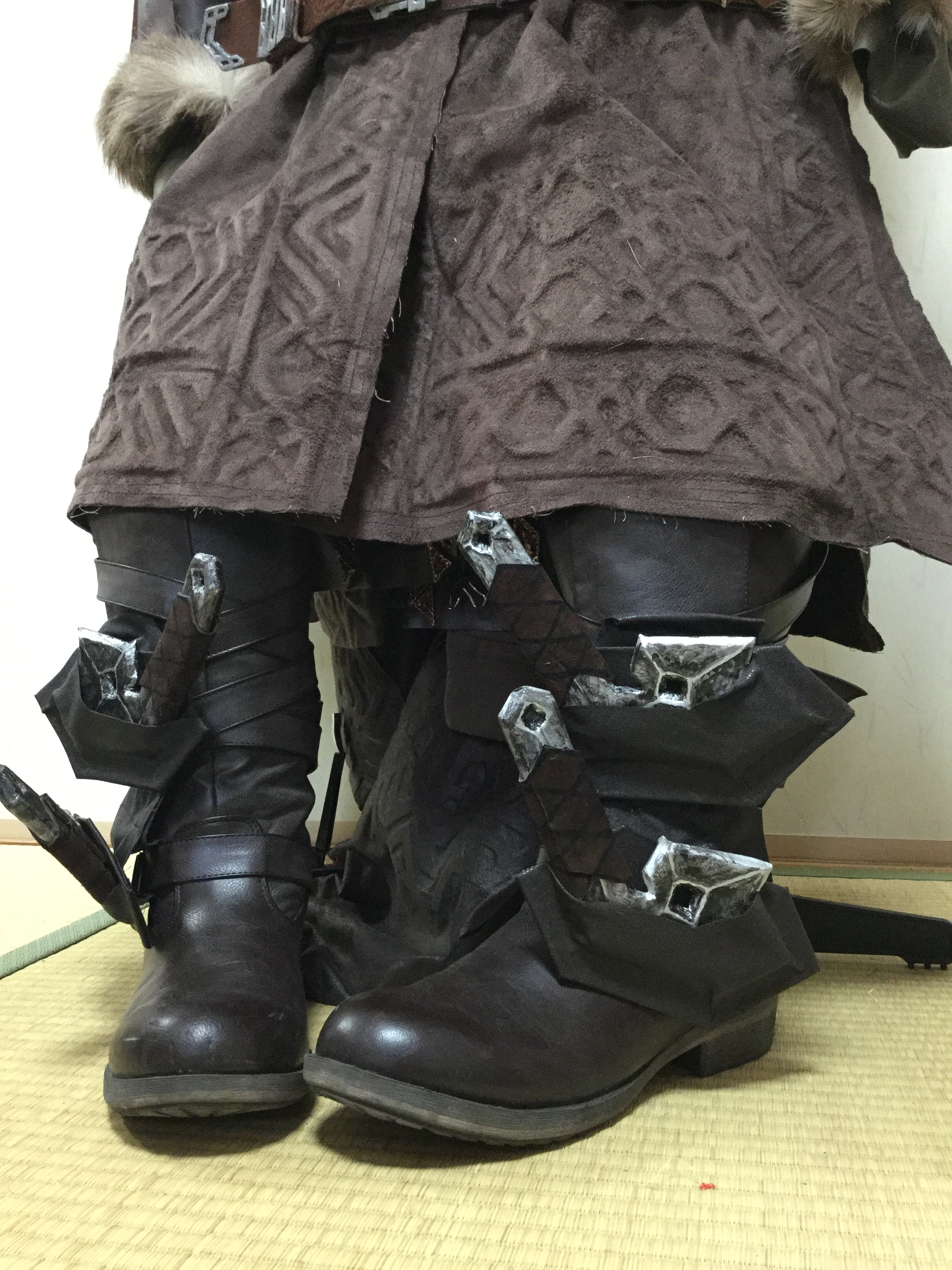

The axe sheaths were made last minute from a thin pleather with a backing of hard cardboard. A wide double leather back-strap connects the two sheaths, with stitching to make channels for the straps of the boots to pass through. (The boot straps were functional as well as decorative and could be unbuckled.)
Feikoi reports that the pleather fought hard, hated her sewing machine, slid and bunched.
On first wearing, the pleather's stretch wasn't enough to keep the axes from falling out when feikoi knelt or caught them. Small strong magnets were purchased from the 100 yen and glued under the leather handle of the axes and for expediency and speed, corresponding magnets were duct-taped to the sheaths.
Feikoi wants to make the sheaths again from something more substantial for the next wearing.

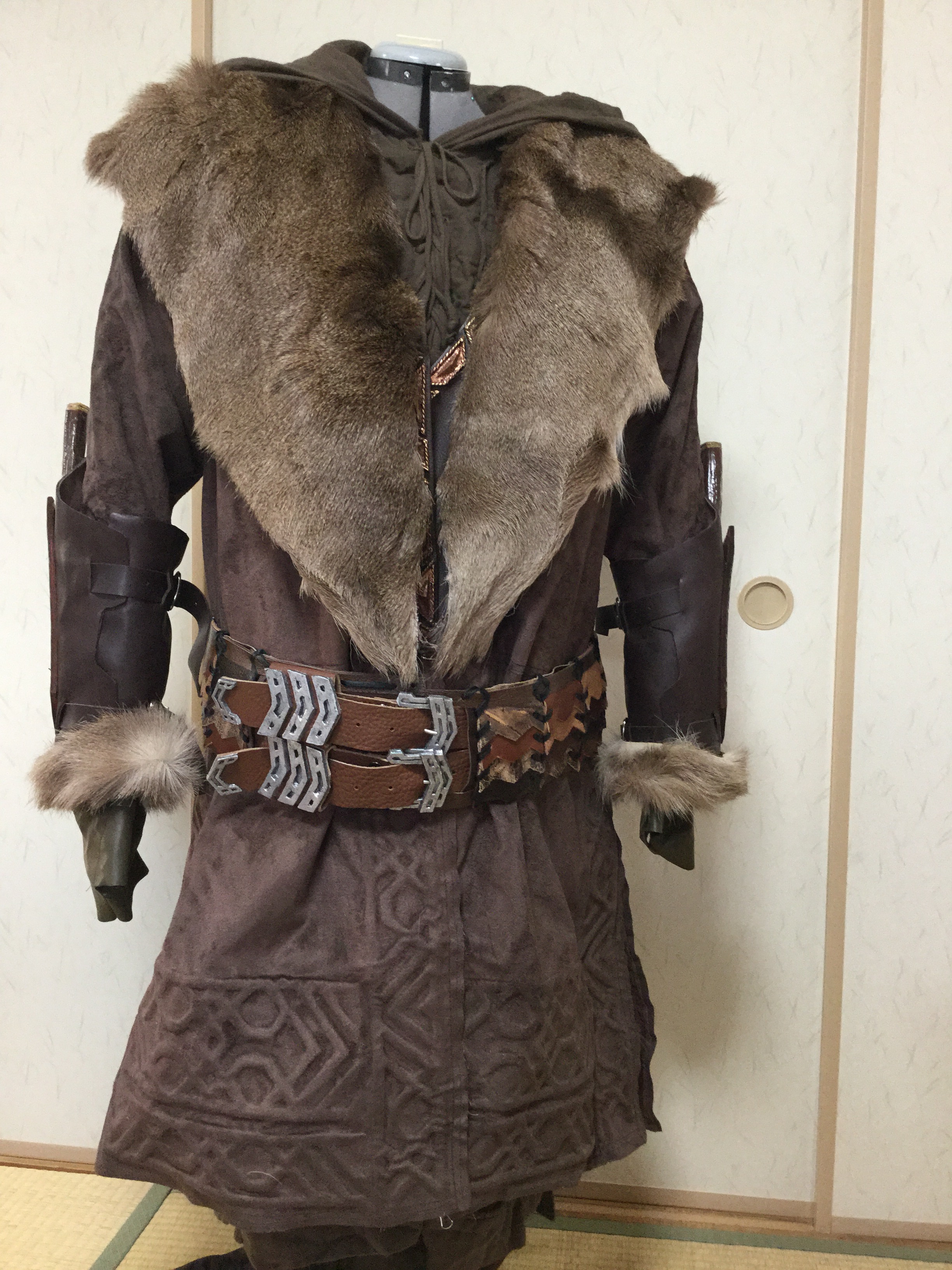

The most time consuming part of the build was the coat. Fili's coat is a heavy suede with patterning along the hems of the skirts, around the cuff and up the sleeve. The Cloaks and Daggers book says that they achieved the effect with laser cut leather pressed into the suede.

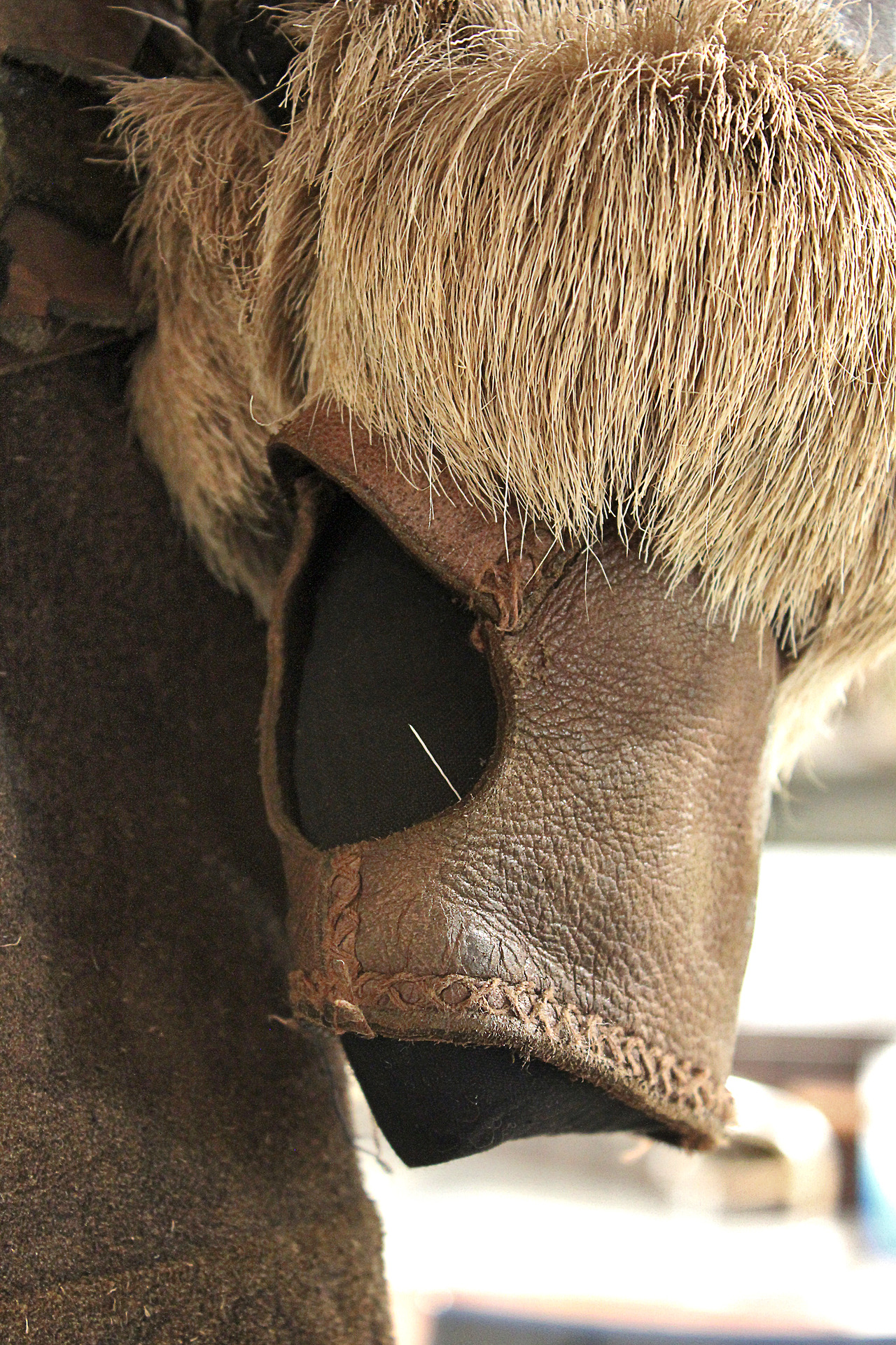

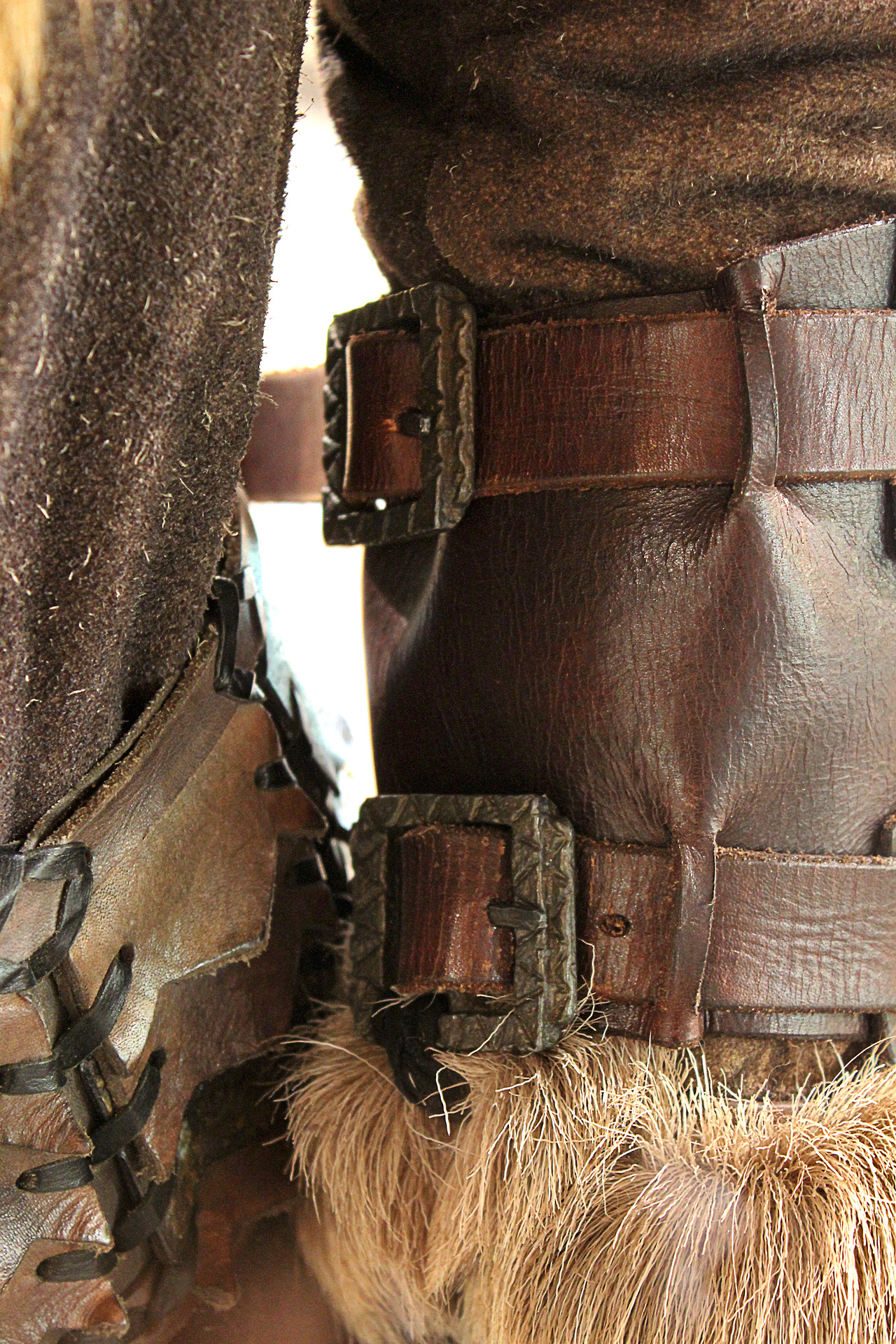

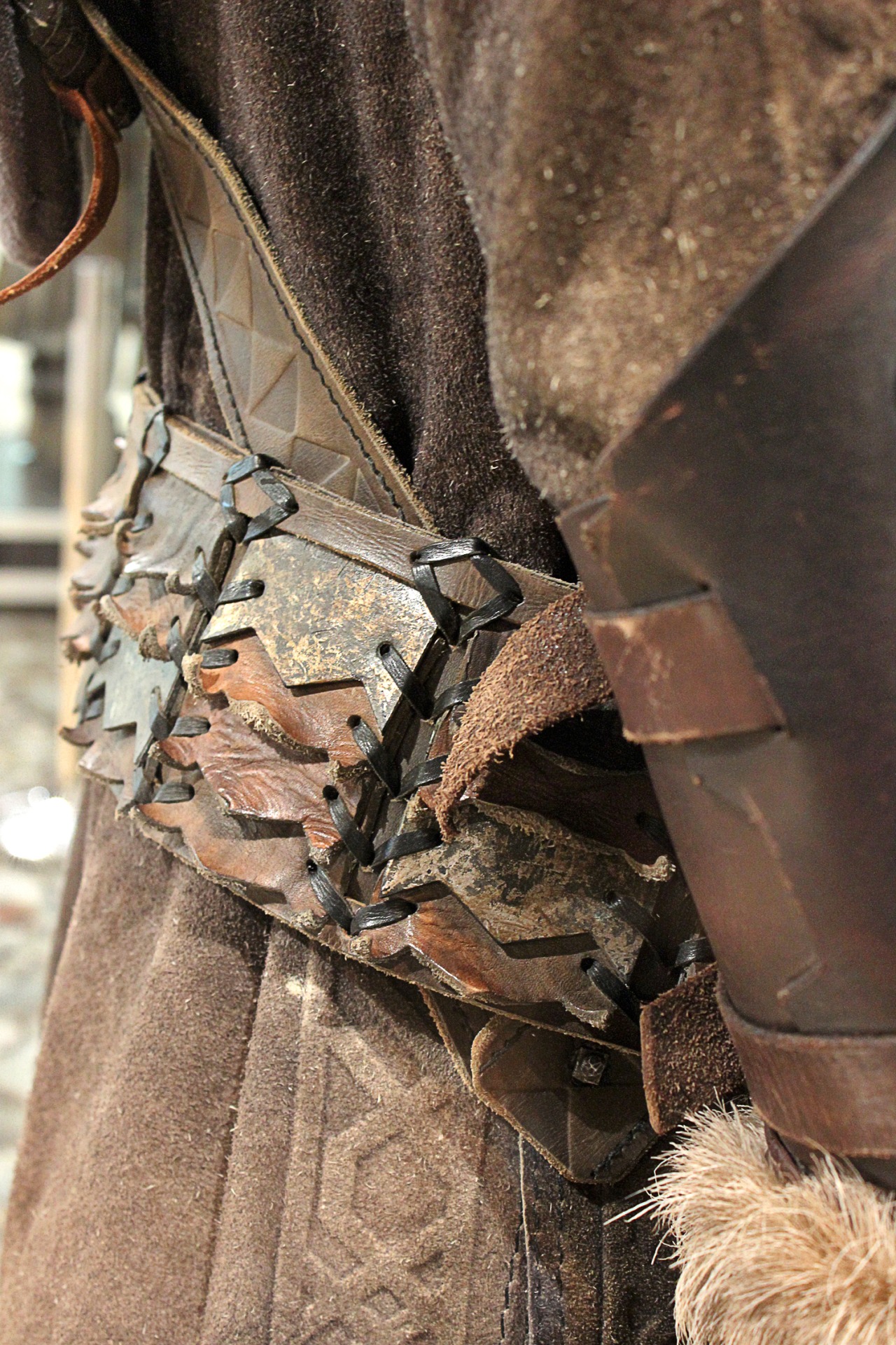

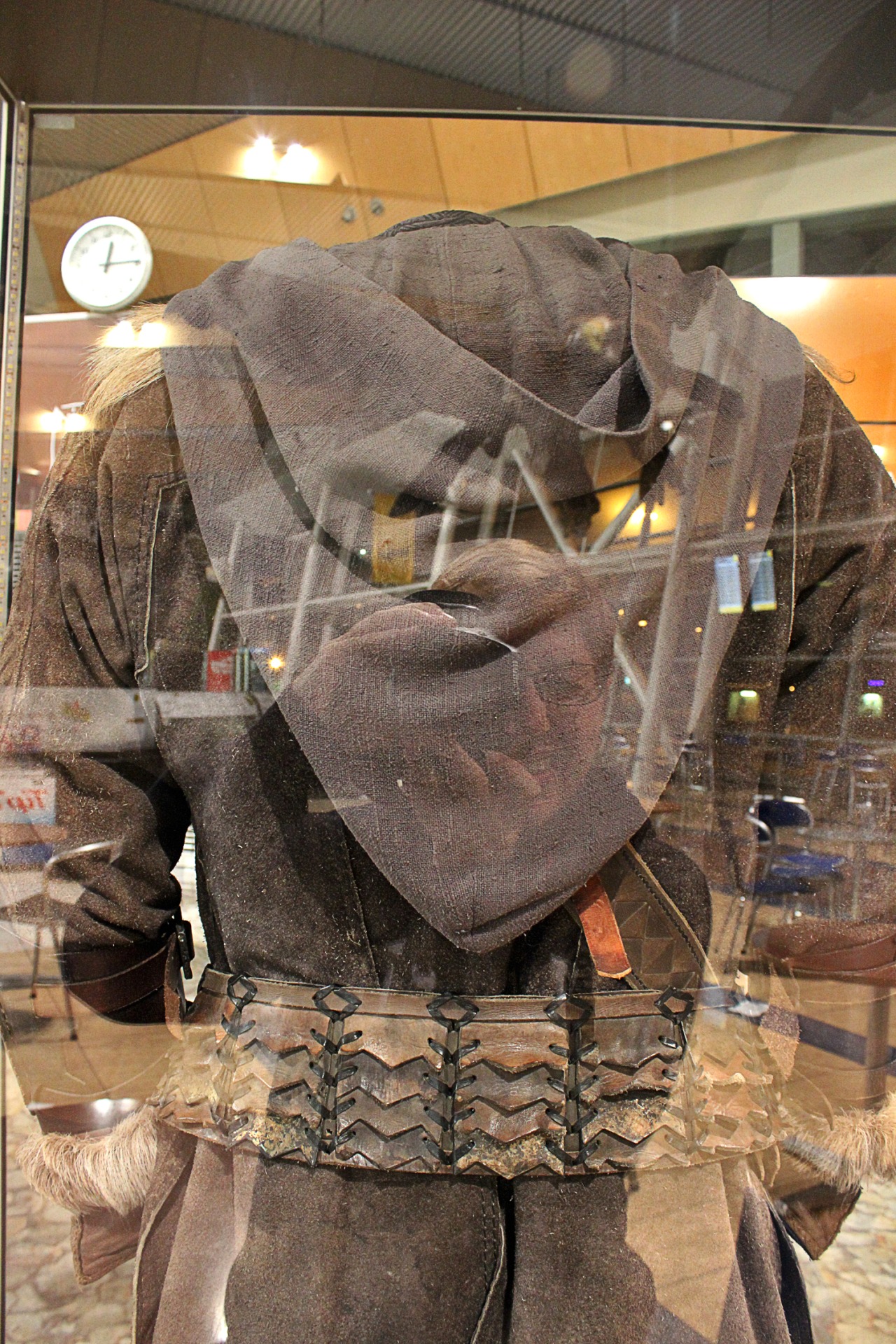

The Costume Trail pics show a lot more details. The coat has raglan style sleeve with the sleeve pattern disappearing up under the fur collar. The hems are stitched in a double row and the suede edges not turned under. The coat has a waist seam and a waist clasp of a fancy stitched loop and self-wrapped leather toggle. The wrist pattern is mostly covered by the turn-back of the fur cuff and usually hidden entirely by the vambraces. The 4 bottom panels only slightly overlap at the waist sides and back.
The seams were overlapped and double stitched in black, nothing turned in.
The fur collar type is unknown - Dean O'Gorman claims in the Cloaks books that it's some special kind of big cat, though he doesn't actually know.
Of interest to people who despise hot costumes - like so many of the pieces on the Hobbit (Bard's coat, Kili's, Thorin's brig armour), the sleeves are not completely attached and the armpit area is left open.
tumblr_nh4as93LJX1r3vnt3o6_1280.jpg tumblr_nh48zgvp3z1r3vnt3o3_1280.jpg tumblr_nh48zgvp3z1r3vnt3o4_1280.jpg

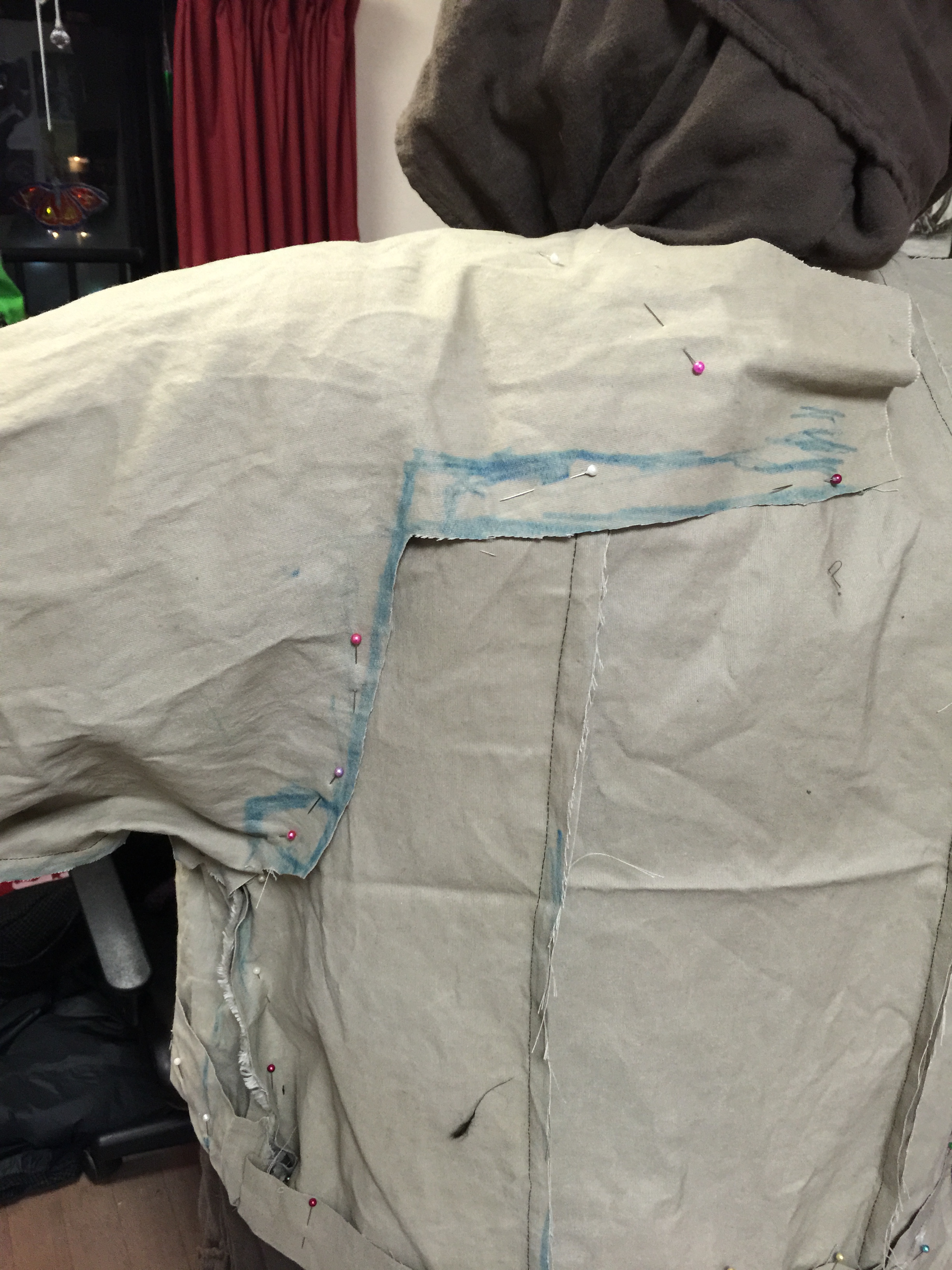

Fitting the arms with the odd decorative shaping on the shoulders was tough. It involved a lot of pinning and sketching based on eye-balling the original coat. Below is the toile test piece.

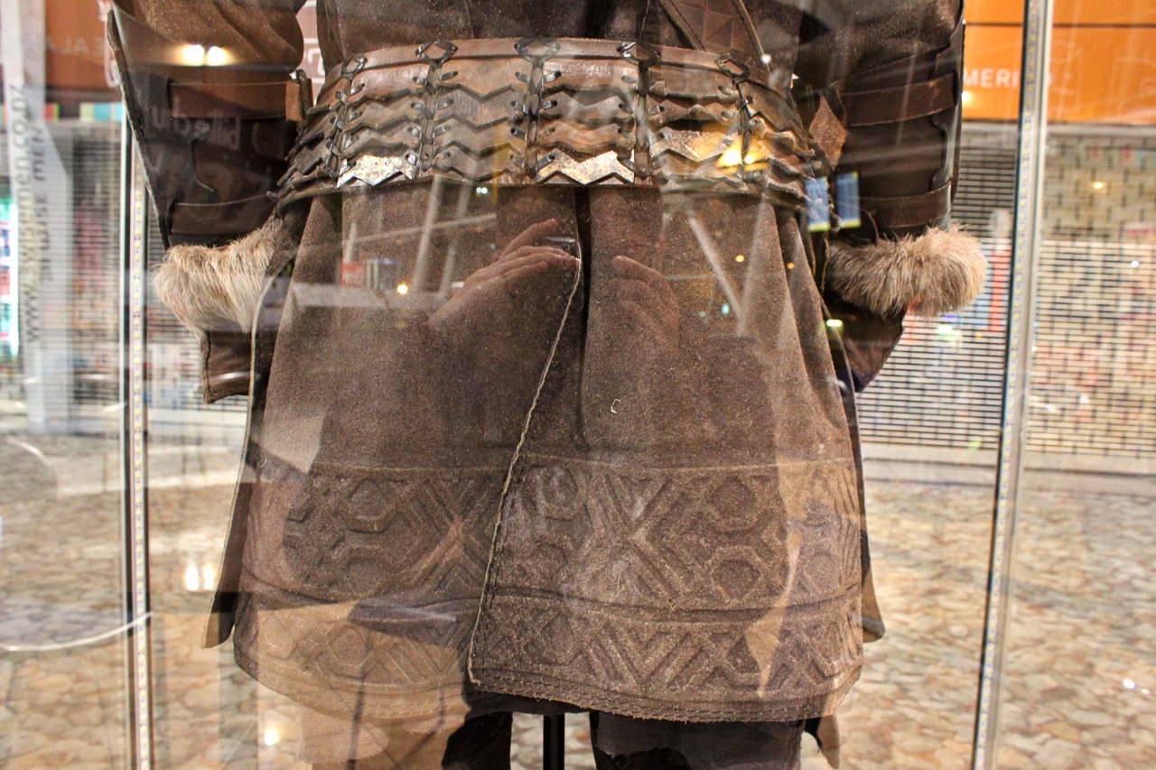

Then came the really hard part - the pressed leather look. Some people would have given up and just painted it on. Not Feikoi.
As she did on the knee pad of the pants, the pattern was sized from the production pic that can be seen up in the pants comment, printed and 2.5 mm craft foam carved with a craft knife. Due to the large amount of decoration this took some time.
The fabric she purchased looked like a very nice brown suede, and the lining was a cotton in a traditional Japanese ikat design she dyed brown. The craft foam was sandwiched between these two layers.
Because the pressed pattern meant that the width and length of the top fabric would shrink up when pressed into the crevices of craft foam, the pattern pieces could NOT be pre cut to the correct pattern size. The pattern was traced on the fabric with a decent amount of space between each to allow for the shrinkage and any mistakes, and the final trimming cut the piece to correct size.
The process went like this: a huge plastic sheet was laid on the floor and the cotton lining fabric laid on top, inner side up and the printed decorative side down. A spray glue was used to place the craft foam pieces so the pieces didn't slide.
From Feikoi's Tumblr post on the build:
"Technically, I used spray glue to attach the foam patterns to the lining fabric, but the rubber cement (ゴムのり) I used elsewhere would have been more secure. When attaching the outside fabric, the rubber cement was applied to the lining /around/ the foam in a small section (usually diagonally, following the lines of the foam piece) and allowed to set to become tacky. Having the glue on top of the foam as well isn’t necessary – probably doesn’t hurt anything, but it’s easier without, oddly.
After that, the suede fabric was lightly and loosely laid across the glued section, and pressed carefully into the recessed areas with fingers and the wooden sticks. I would go back and jam the fabric tightly into the edges and corners with the sticks again every so often, as the glue set more. It was pretty easy to tell how it was working, since all the pressing would ruck up the pile of the suede cloth, and lightly smoothing along the top with my hand would make the raised sections stand out in color.
Warning – this may take you ages. Each of the four skirt panels took 3-5 hours to glue, and the sleeves took an hour and a half each, I believe (I did them last). This does not include the stencil design and cutting (there are three types), or the foam tracing and cutting time. The panels were laid flat and allowed to dry/cure overnight. I used 2.5mm soft eva craft foam (not lion board)."
Feikoi took as much care as possible to avoid egregious wrinkling, and this process went on over days. The bottom panels alone took 3-5 hours a panel. They were first pieces done, and feikoi got faster as she went on.
2015-02-08 18.01.30.jpg 2015-02-08 18.01.37.jpg 2015-02-08 18.01.41.jpg 2015-02-08 18.01.42.jpg
Above - two finished panels before trimming to size.
Keep in mind that the pattern was on four bottom panels, the length of the sleeves and she even did the cuffs though they were not likely to be seen.
If you go this route, it'll take a while. The craft foam is flexible but gave the fabric a certain weight and stiffness, which was not unlike the actual production coat's heavy suede.
Finishing the coat: Feikoi was working on another part of the costume, so I took up the final construction phase.
The fur I used for the collar was a smallish, cheap elf or caribou hide that seemed an appropriate texture and colour. I had to jigger pieces carefully to get all the collar and cuffs done, though the cuff fur direction ended up going sideways instead of up.
Fili’s coat seams are laid over each other and top stitched in two rows with thick black thread, so that's what I did.
Some pockets for knives were attached to the lining, with plans for more to be done later. Since the cotton lining is effectively glued to the suede fabric, the hems were not turned under, just cut and edged with stitching. The glue will prevent much fraying.
The fur collar and cuffs aren’t backed with anything - the leather was thick enough it didn’t need it - and are only zigzag stitched on at the moment.

The Coat Part 3 - Finished (for the time being)
Done posting for the night. Next - the inner belt, the outer belt, wig, moustache and beads (we cheated on beads) and final cosplay pictures. Probably not all in one night.

The good thing about the axes - we talked about molding them. This cheap option of foam worked well - if we lose one, it's no great matter. (I made six just in case we did.) And they are light weight. It would be terrible to have the trouble of sculpting and molding the axes in plastic or even wood only to lose or break one. Also, with the magnets in them, we use them on the fridge.

I just ran out of mock-up fabric (I found cotton broadcloth on sale for under $2/m a couple of years ago, and bought 10m, but I finally used the last of it on Bilbo's vest) so I'll have to keep an eye out for more. Luckily, it's getting into yard sale season here so I will have to see what I can find.
I'm building this particular bodice mostly over top of an existing corset, and most of it will be covered by detail/armour(ish) pieces so hopefully it won't be too tricky. But I do need one sleeve, and to figure out how to attach the sleeve to the rest of the bodice. I will have to do some tests. But it's not urgent - if I can get it done for the next con I might wear it there, but my priority is my husband's Baymax (the white inflatable version). I have no idea where to even start with that one, lol!

This is a piece rarely seen, as it's over the shirt and under the vest, coat and the other belt. The pattern for it can be seen in the book page below in the middle above the vambrace pattern. It looks like a thick woven piece and has a pattern, possibly painted upon it.
Biwz3sNCEAAu9_l.jpg large.jpg the_hobbit_braids_dori_fili_nori_ori_1920x1080_38500 - Copy.jpg Untitled-1 (2).jpg
A cheap canvas belt was purchased and painted brown. Feikoi cut a stencil from cardboard and painted the pattern in black acrylic. From her blog post:
"As for the belt stencil, a word to the wise – enough paint will eventually make your stencil very soggy, even if you use cardboard like I did, so make multiples or maybe even coat it with something waterproof. In the stencil pictured, I used the pattern on the right, simplified to remove the dots inside the triangles and connecting the crown points to the diagonals. I then cut and removed the white sections, leaving a somewhat delicate stencil (hence the disintegration)."
For wearing, the modern buckle was moved to the back so as not to be seen.
The Belt
Production Costume Belt below
Thanks to the Costume Trail pics, you can see the belt quite clearly. All different types and shades of brown leather, laced down to a backing of thin leather and each other with thin strips in black. A section underlaps in the front while the double belt tongues overlap and are tucked into decorative loops. The buckles and findings are dark silvery metal, pitted.
tumblr_nh4as93LJX1r3vnt3o5_1280.jpg tumblr_nh4as93LJX1r3vnt3o7_1280.jpg tumblr_nh4as93LJX1r3vnt3o10_1280.jpg tumblr_nh48zgvp3z1r3vnt3o8_1280.jpg
