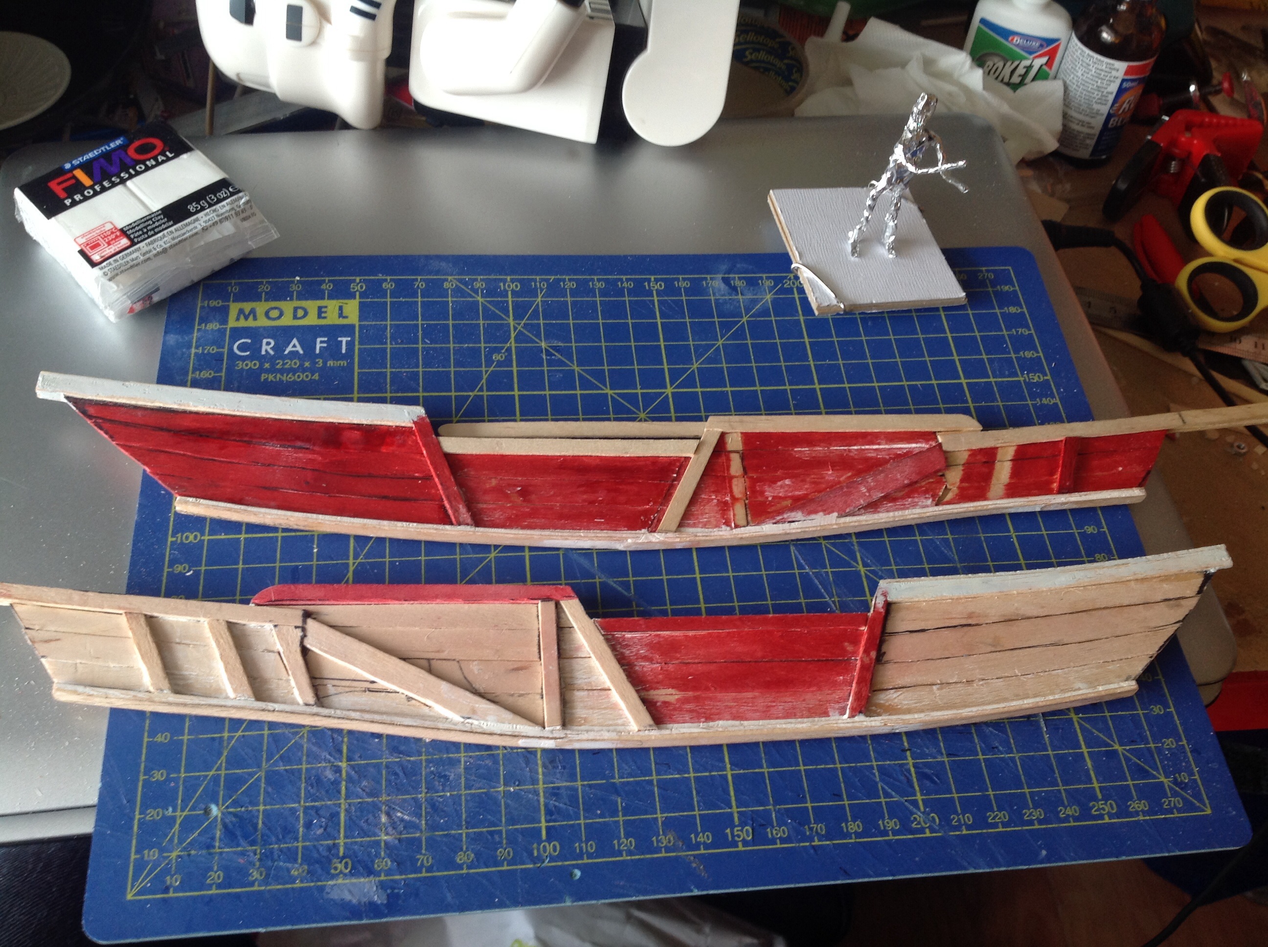

I finished two sides and the front. I cut lollipop sticks into widths that matched the planking on the junk, there are a few different thicknesses required so initially I used the very with lollipop sticks sold in bulk in art stores.

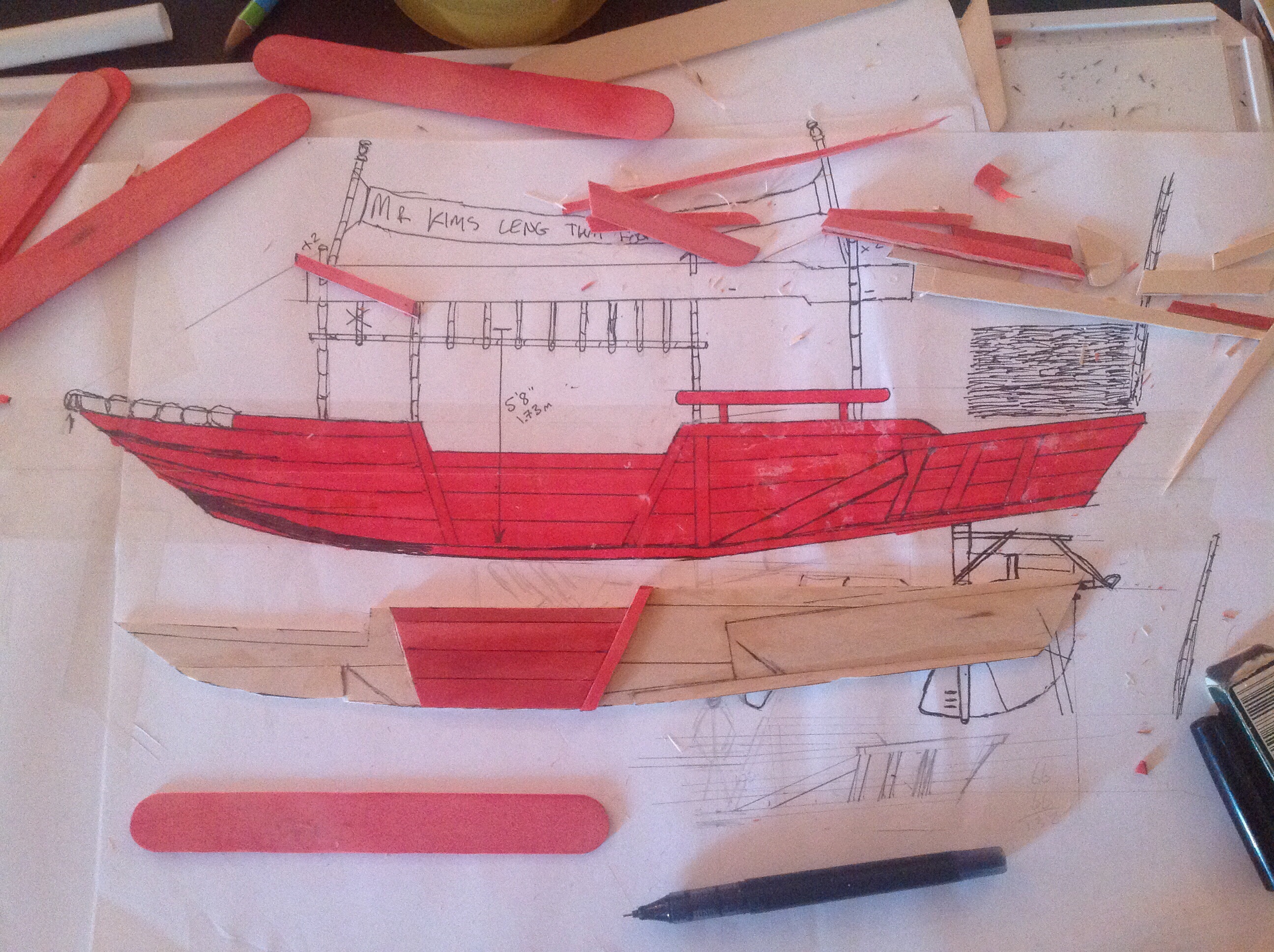

i had drawn up a drawing , initially too small for my liking, which I changed and now the model will be approx 1:24 scale looking at Kim chan's height 1.73 metres against the set.

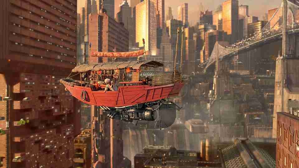

the junk in the movie was only ever a full size set comprising of the junk which was mounted on a gimbal, the engine details were added afterwards I believe.

I reproved a lot of the details where there was narrow planking, I had found that the narrower stirring sticks supplied in coffee shops were the exact width I needed for some of the planks. So I removed a few of the ones I felt I had not done correctly and redid with cleaner sticks.

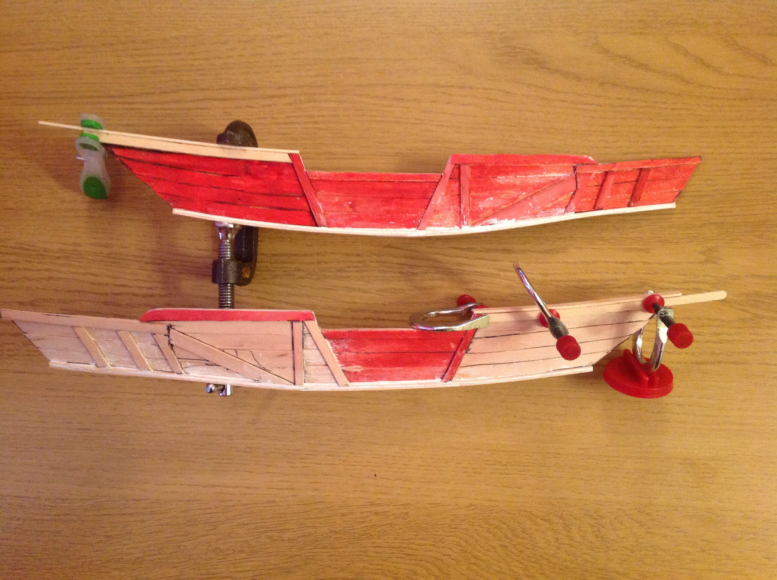

here she is after second fillers have been applied and newer sticks being held in place by clamps.

originally I thought that the junks narrowing at the front and rear (I know Prow and Stern) were angular , but having looked and gathered multiple screen grabs the side walls of the junk are curved.
My original reason for using lollipop sticks was to give the correct scale texture to the boat, and the fact of cutting the actual planking would add to the believability however I am now faced with having to deal with this curved side issue.
to that end I think the only solution is to create silicone moulds of the sides and cast them in resin.
i can then heat and set them on a curved former to shape the correct side profile.
I am covering some new skills here having never done any castings before, and also not knowing the limitations on resin being able to take this type of reforming , can any one see any difficulties I might have ?

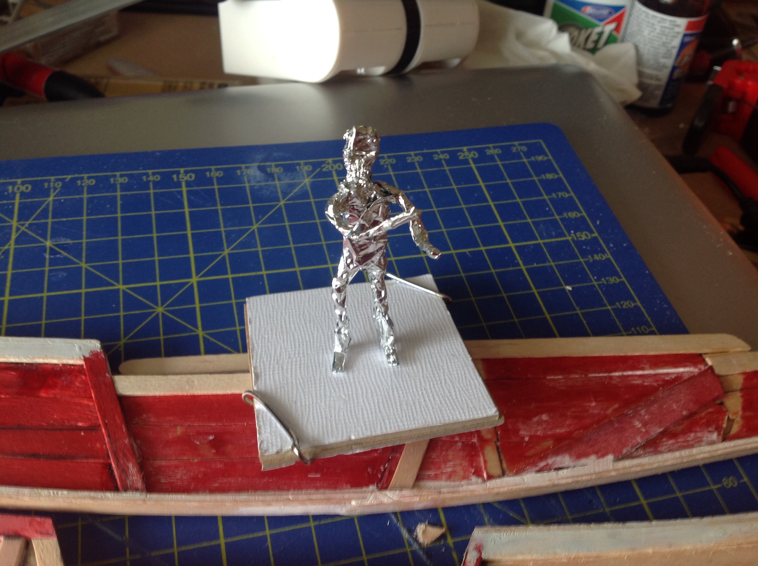

Not happy with some of the planking so going thorough it again to make sure I am satisfied, also started my first ever sculpt , mini I'll admit using wire from a whisk and aluminium tape
still looking to mould this so trying to ensure junk is as crisp as possible .
