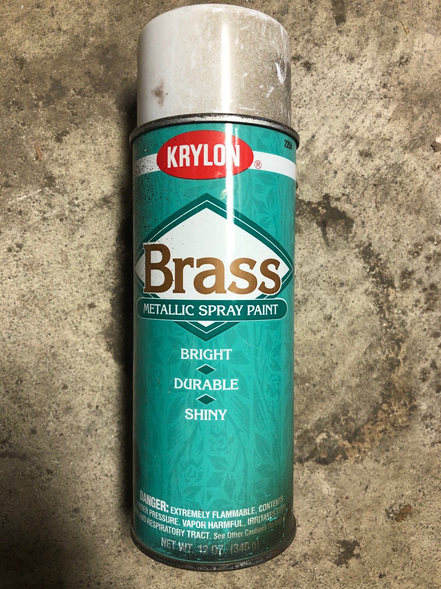

robstyle
the original can of paint used for the Serenity film to base paint Mal's guns and extra "clips"
and that single original hard casting made for the film to see the layers of toner and color. Some of the colors are extra dark walnut, cherry, light oak and raw umber, then some areas were hit with a clear finish called "gun oil". All from Mohawk.
