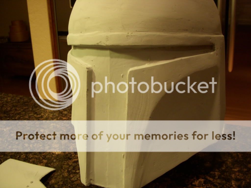

and here's where I am at tonight!
I'm having some trouble figuring out how I want to do the ears and rangefinder so for the moment I just decided to patch them up for fiberglassing.
I've also patched the dent as this will be a more generic Mandalorian.
Before I start glassing and bondoing, I have a small concern:
This area of the ridge above the visor isnt quite the shape it should be, it needs to be more of a 90 degree angle, and not slanted up.
If anyone has any tips or tricks for glassing the insides, fixing the warped area a bit, or tackling the ears and rangefinder that would be awesome to hear! Thanks for looking!

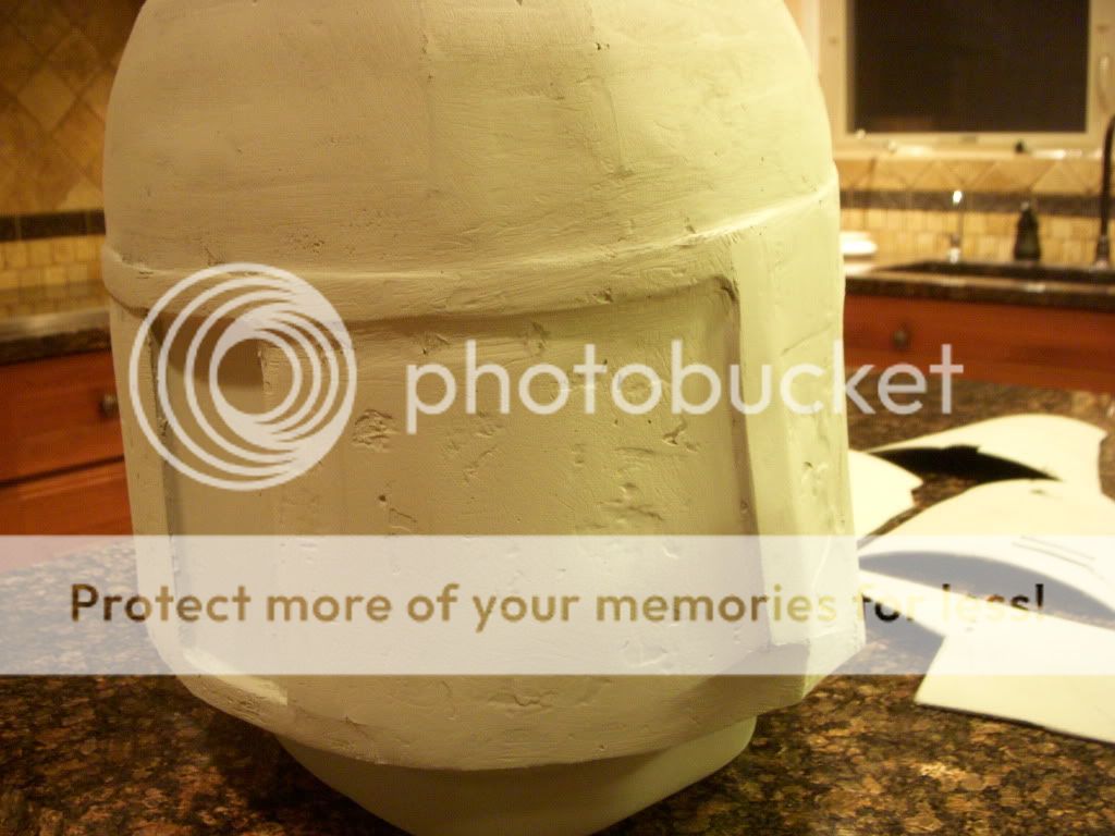

Alright I got a camera working, here's after I glassed the inside
and then bondo'd and sanded roughly (keep in mind I have little clue what I am doing)
Then I went ahead and bondo'd just a TAD bit more and decided to hit it with some primer to see how bad it was for my next bondo.
With flash it doesn't seem so bad
but without it you see all the crap

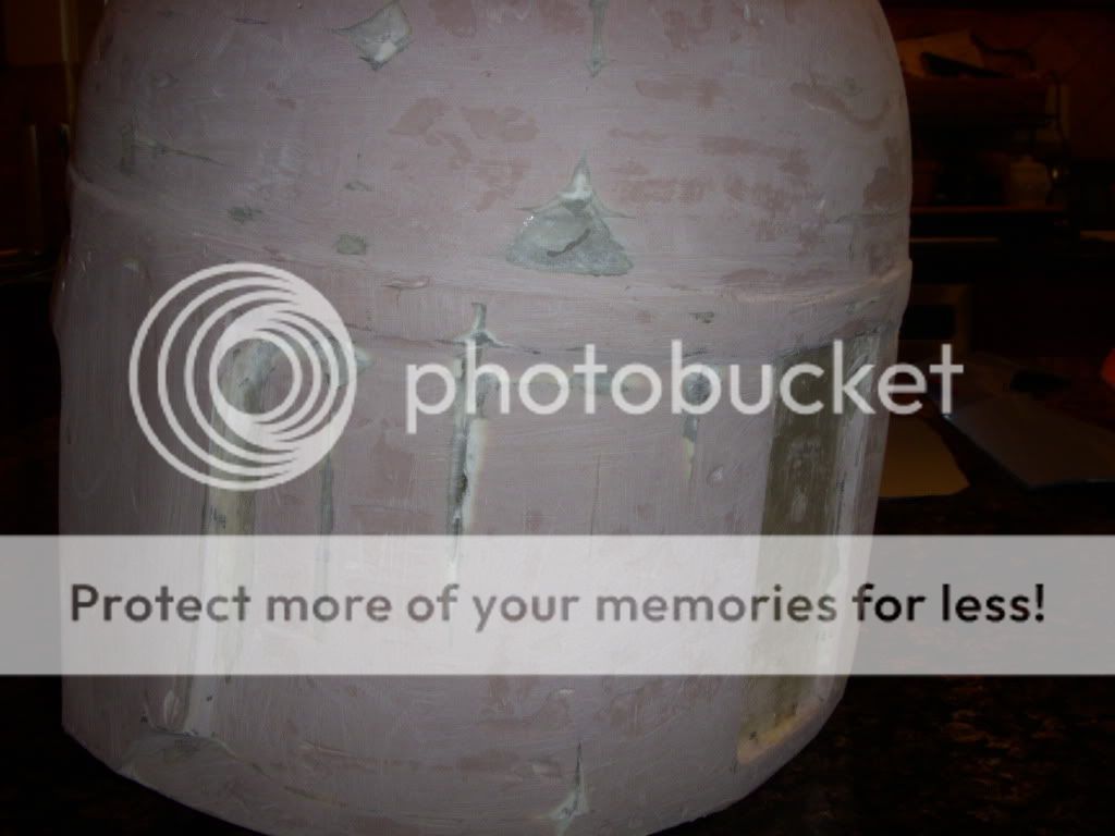

Here you can see where it's worst, I really need to fix those
And here you can see some problems I am having with the dome.
Until next time I guess.
and I thought the cutting and gluing was hard...
Re: First real attempt at costuming- Fierfek's Pep Fett (UPDATED W/ PICS)
for someone who says they don't know what they're doing, you're doing a bang up job! It looks good, be proud. As far as the little nicks and scratches, you can use Bondo brand finishing putty. The putty is ready to use(you won't have to mix anything, yay!) and fills little imperfections easily.

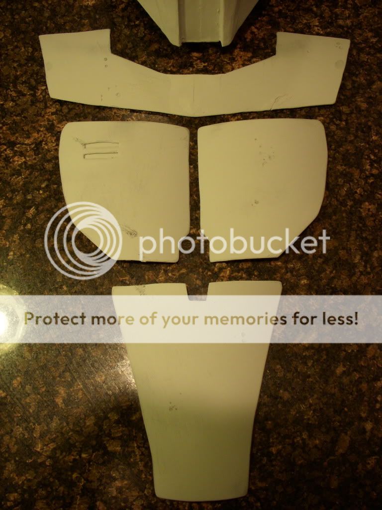

Here's where I'm at.
It's made from $2 lowes buckets, weathered just a bit with some scratches, pockmarks, and small blaster marks.
excuse the with/without flash pictures, some show certain details better.
and an overview with the helmet, all primed in grey.

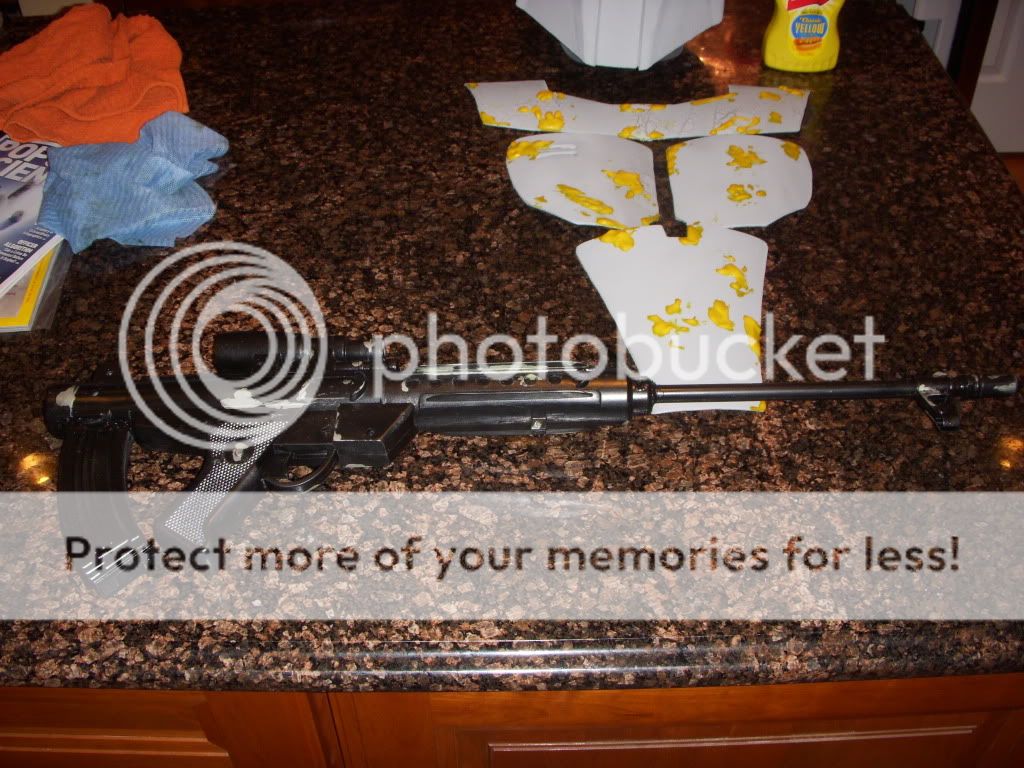

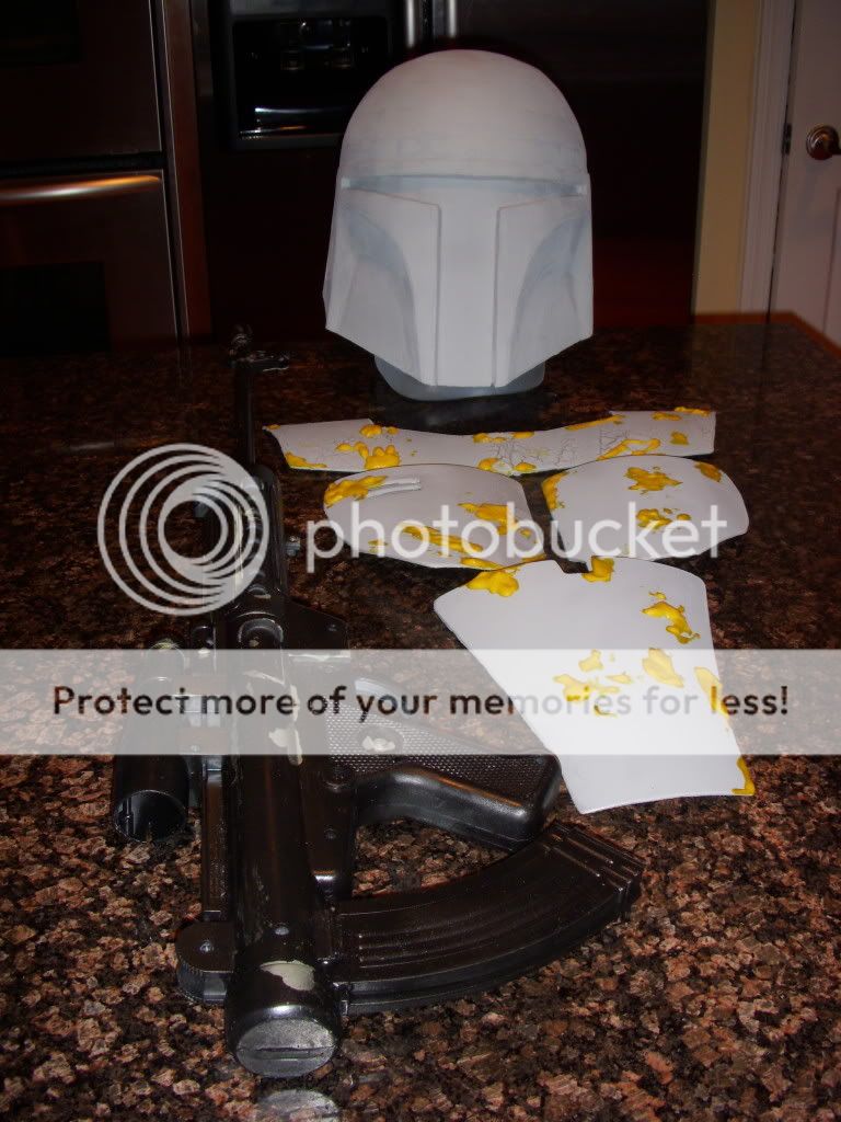

I painted each armor piece with a basecoat of silver, then applied mustard to the battle damage to mask it off. I then primed the piece with grey primer again and mustarded again a little bit larger area to simulate different paint layers. When I get the paint I will be using I'll paint over the new mustard and then rub it off when the paint has dried.
Here you can see the armor so far, and also you can see the handle of a gun I'm working on. It's just a cheap build, but it's kinda cool.
and here's everything I've got so far

im waiting to see how this mustard idea pans out, what did you make your armour plates from, pep files, if so, whos? or another way perhaps?
Re: Fierfek's Pep Fett, custom armor, and blaster (small update 10/18))
though personally I am not a fan of the custom mando - I applaud your build.
as for the mustard idea, it work! The Cloners have used it before over on Ct.net. Most thick-ish condiments work. Mustard is better then most as its less running then ketchup generally.
Nate
wow, never tought about using mustard, I wonder how good it works
