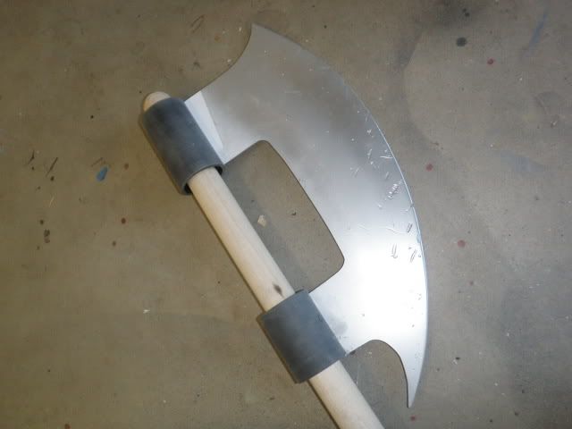

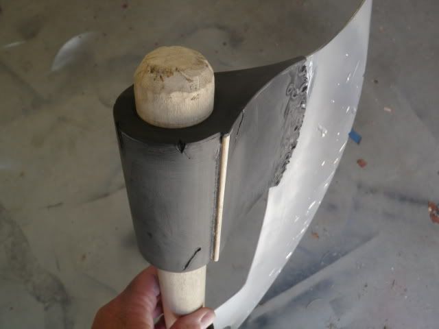

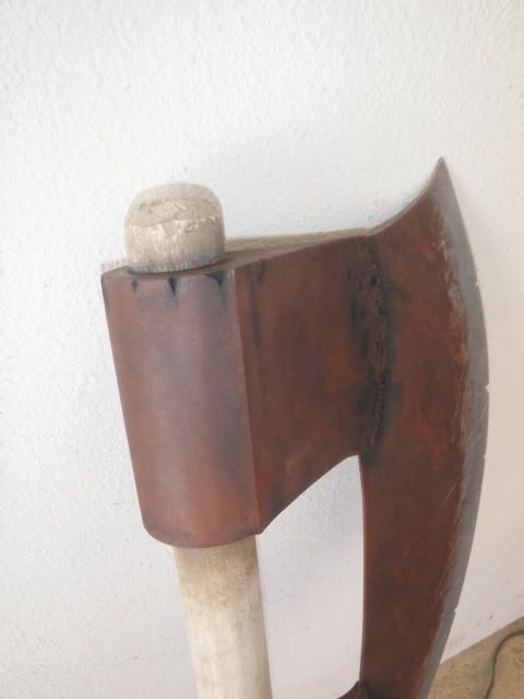

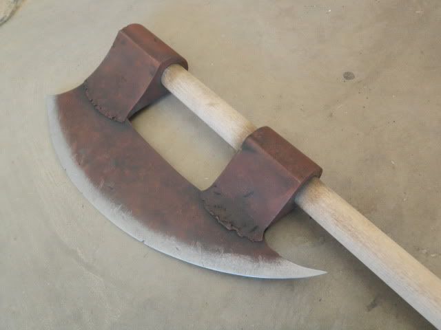

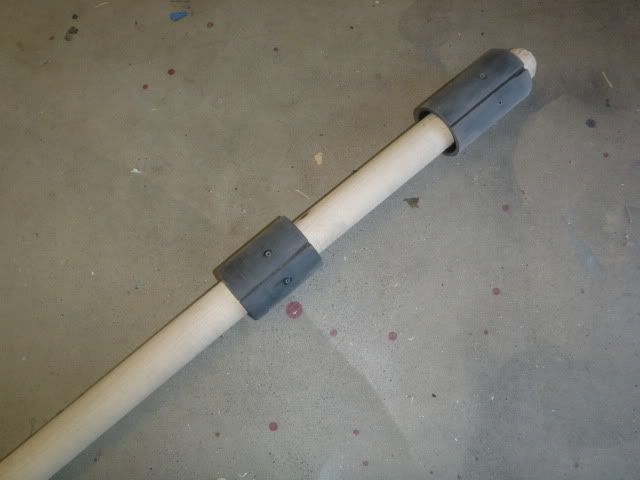

Which axe are you making? I just recently finished mine. Handle is 1 1/2" poplar, about $5. The blade is styrene. The round mounted area is 1.5" black ABS pipe inside a 2" black abs pipe. I did run it on a table saw to give the edge of the styrene something to grab to. Cover the gap with styrene. Made a little raised edge like it's suppose to have, and did some minor filler work to the seam.
The very same you made! Love it! I was going to use a Cardboard cut out of the blade and then fiberglass it to give it structure, but I may go your rout. Looks very nice!
